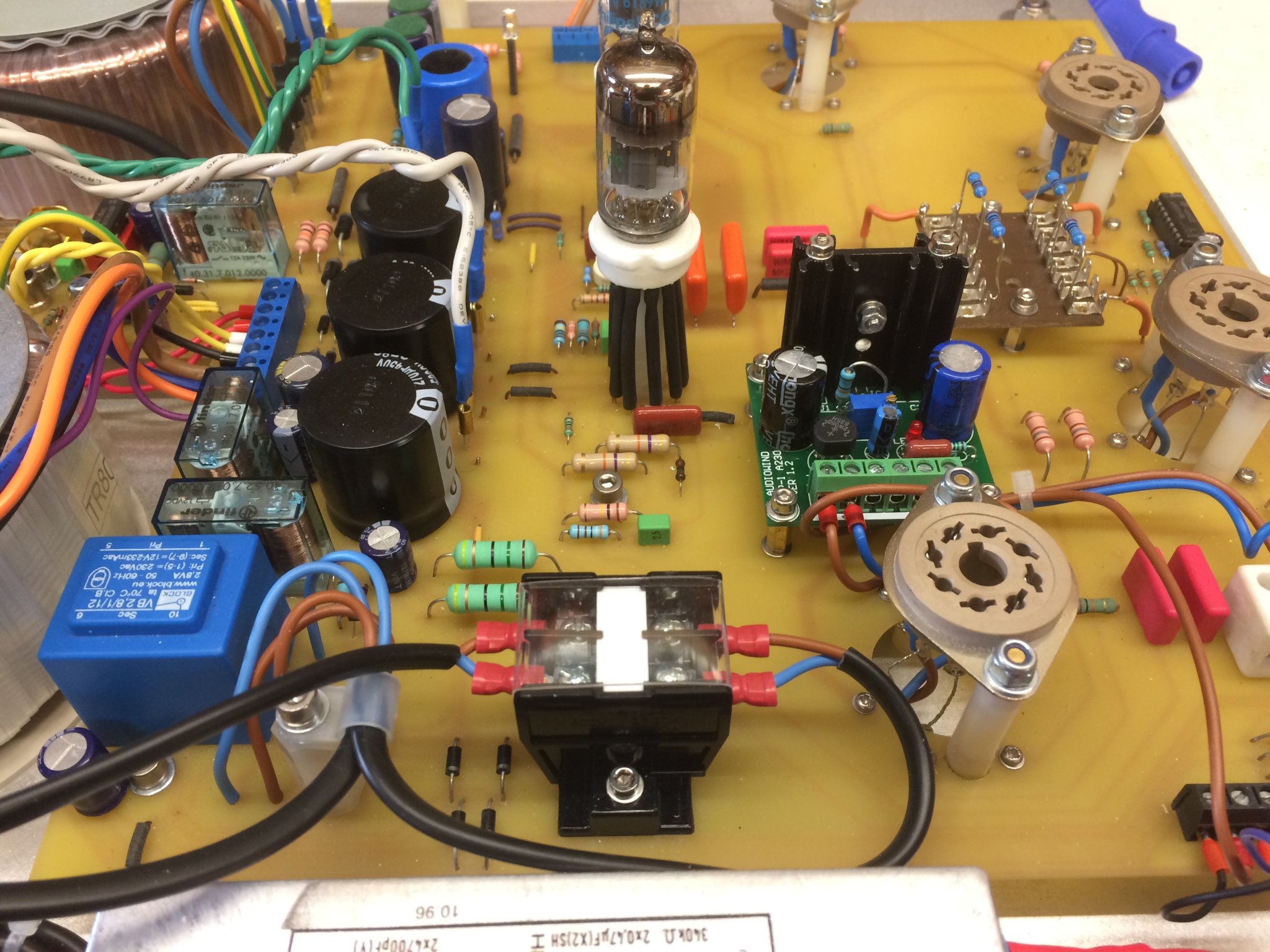

anyway some of my other construction skills .. purely done by feel and the good old fashion eye ball
A EL34 valve power amp one channel shown as they are mono-blocks
1st 15w in pure class A
Reactions: decramer

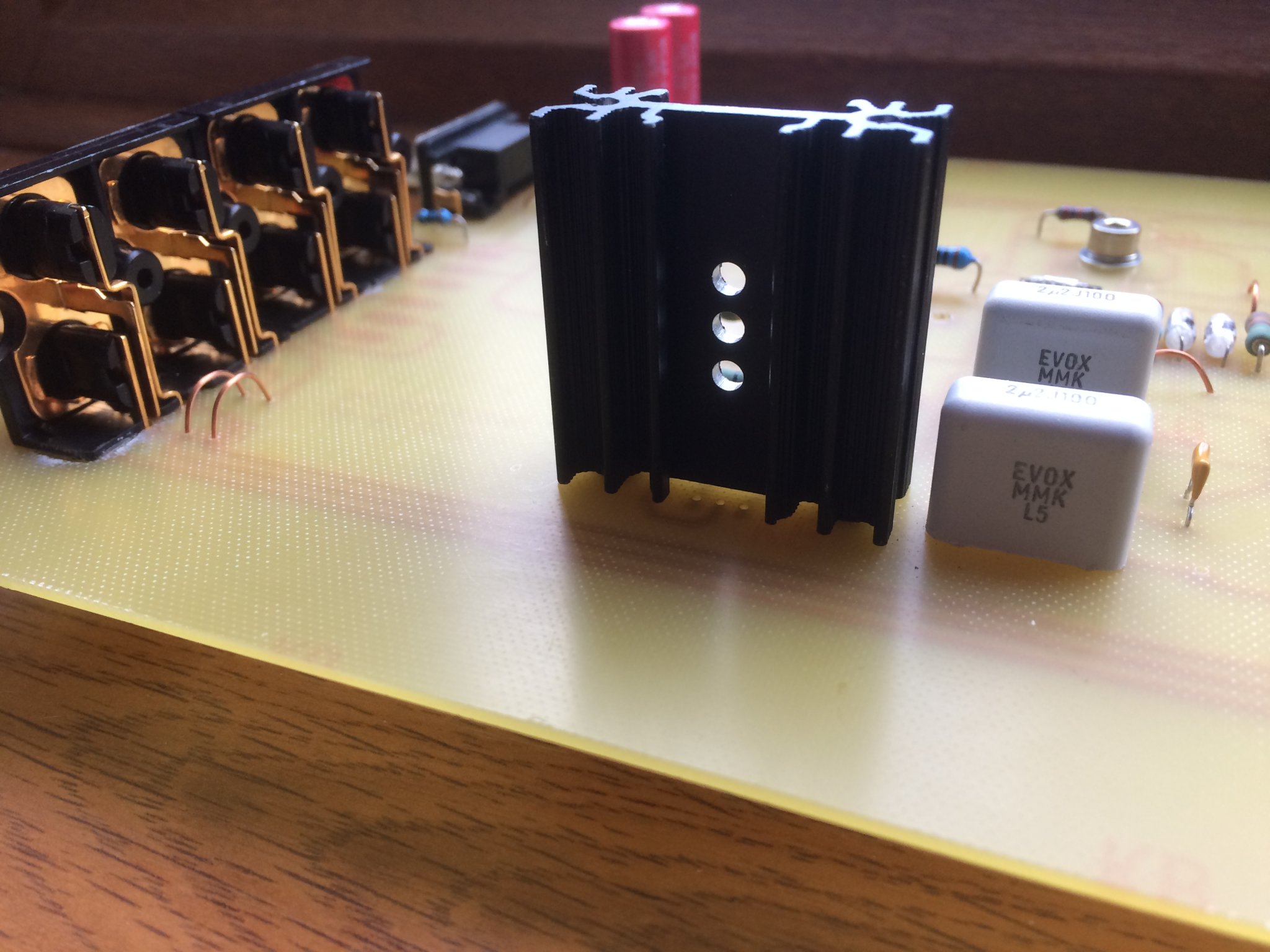

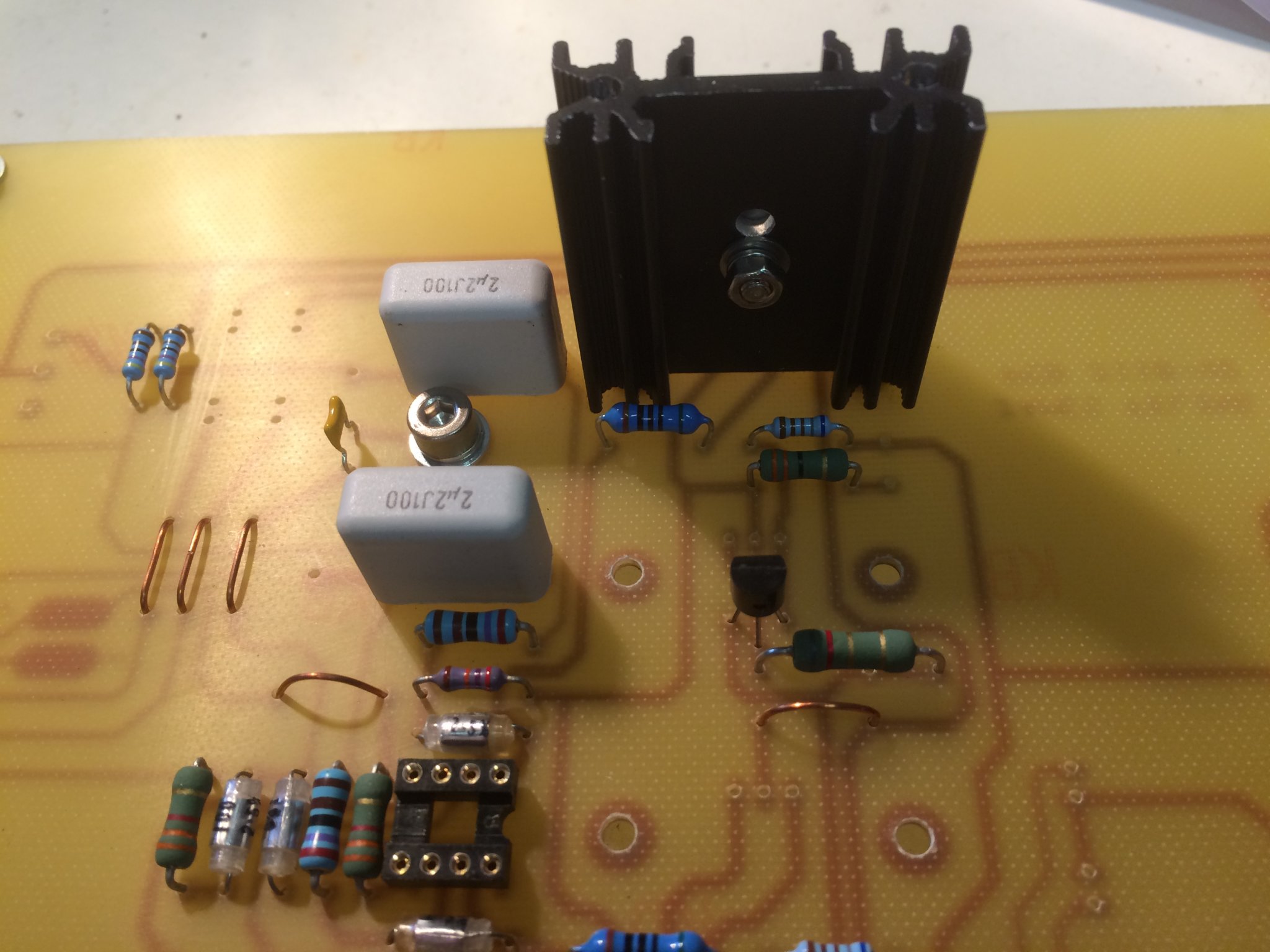

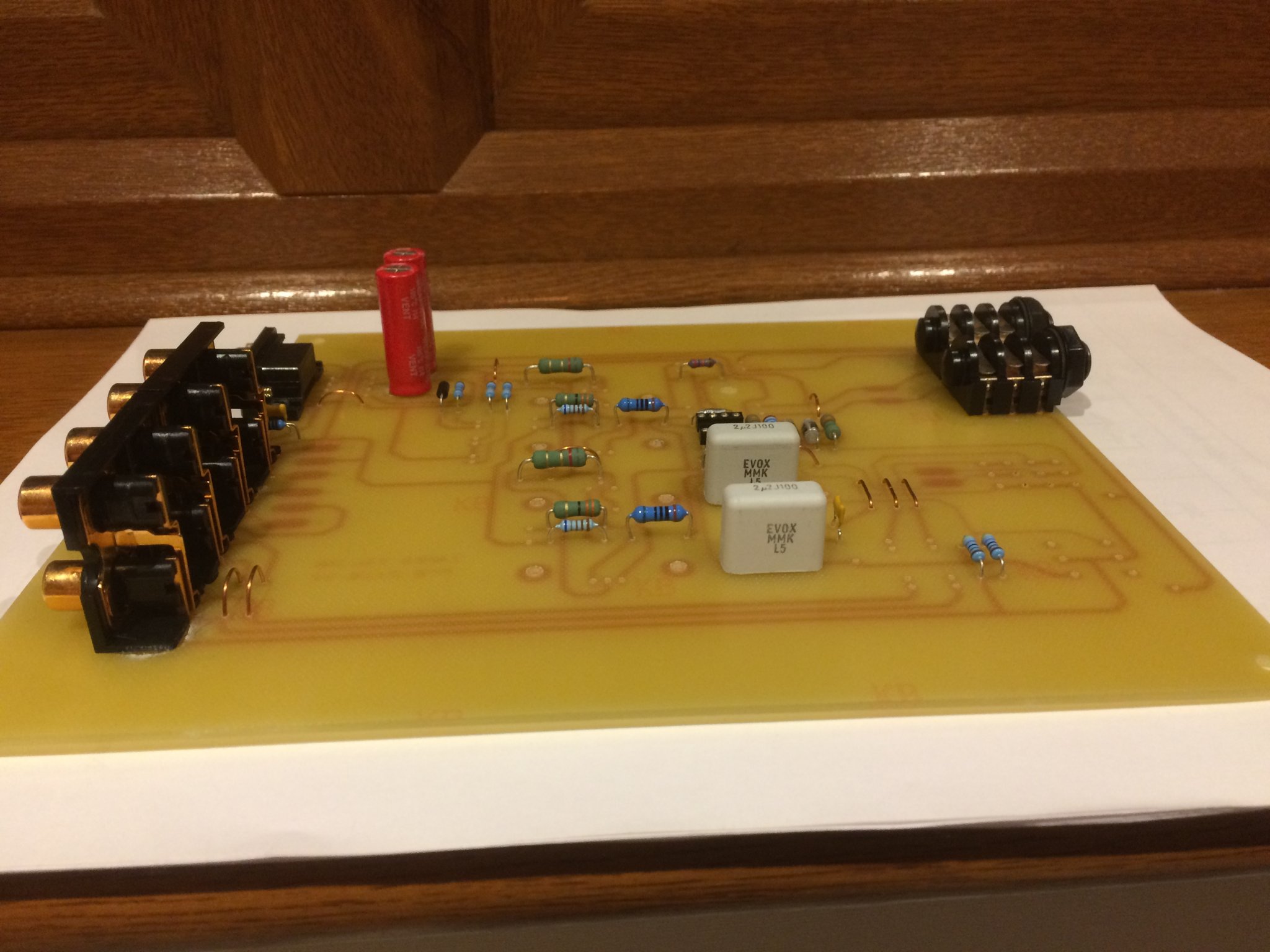

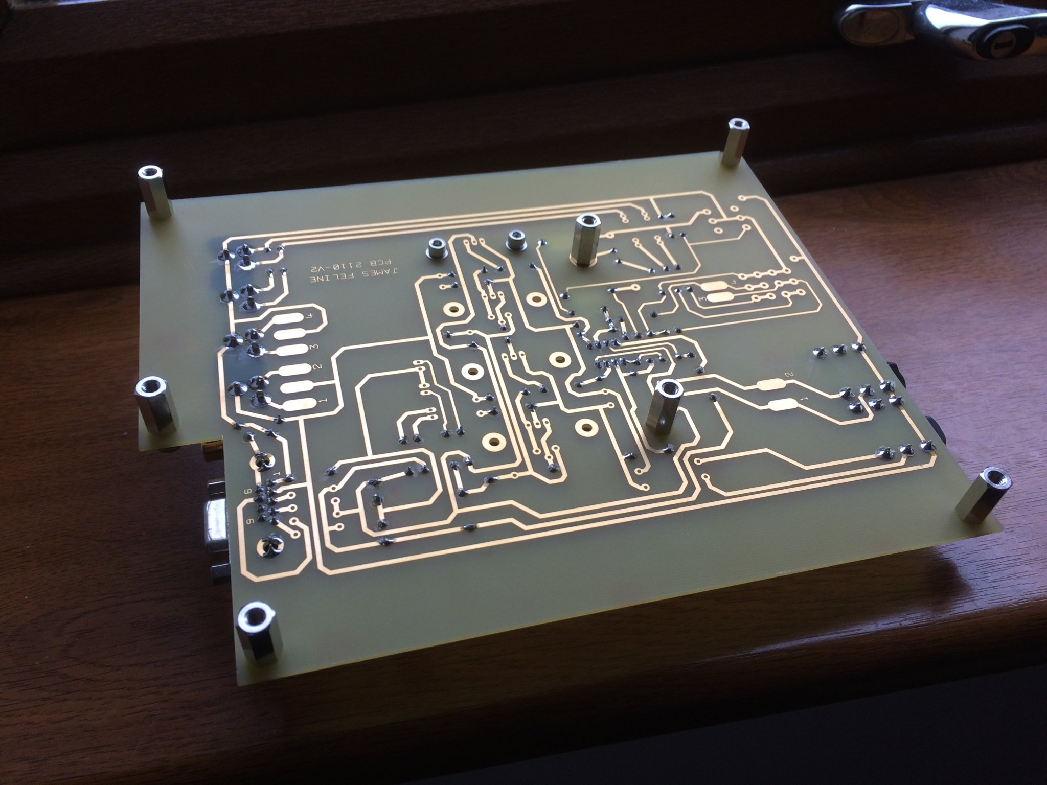

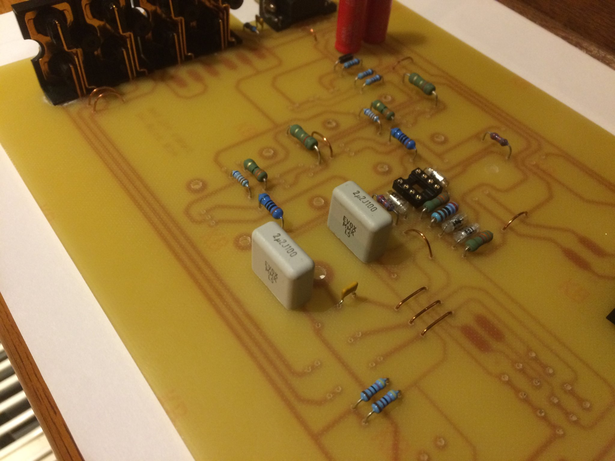

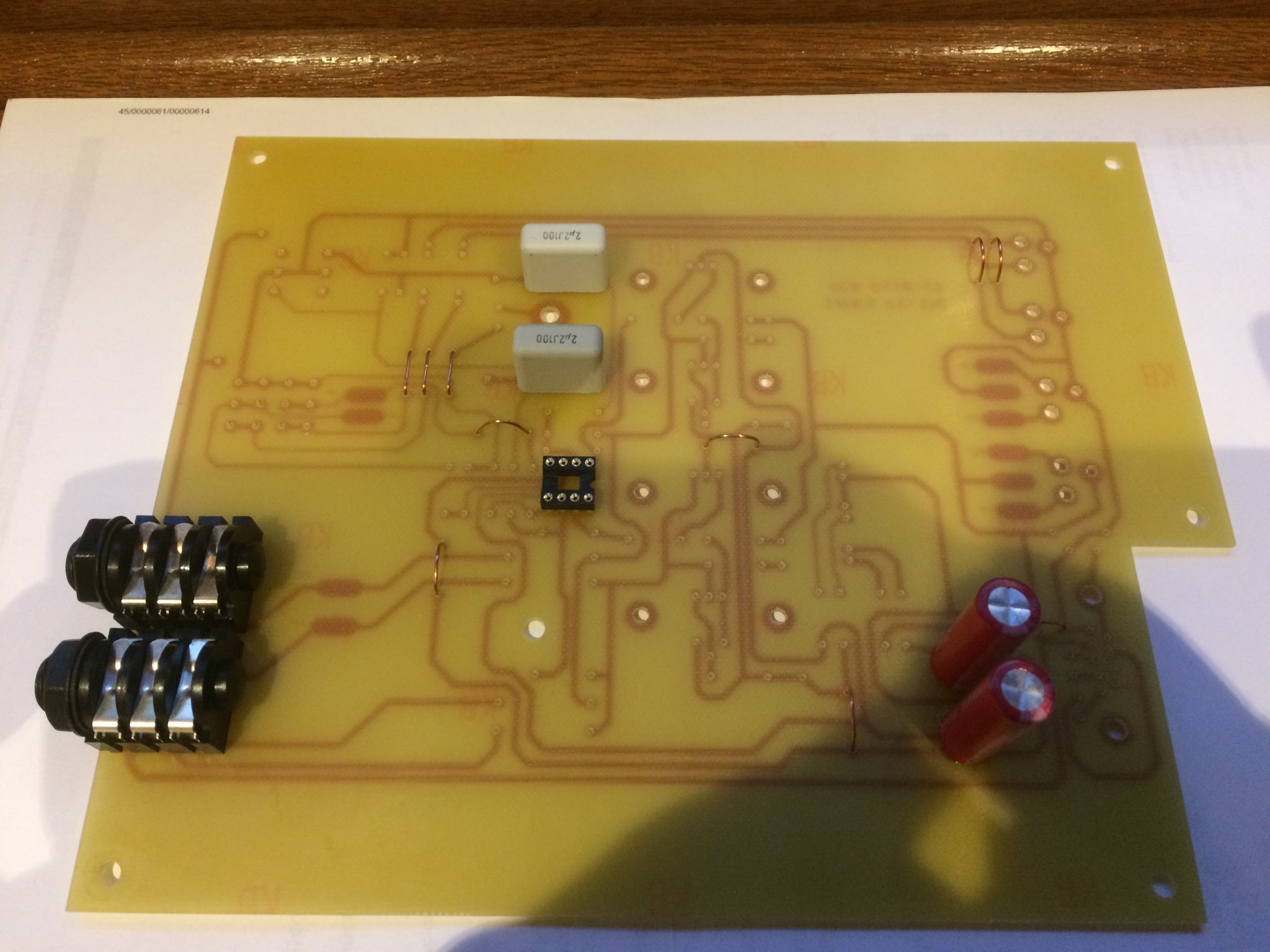

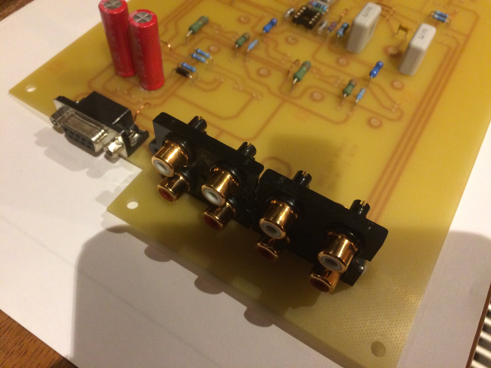

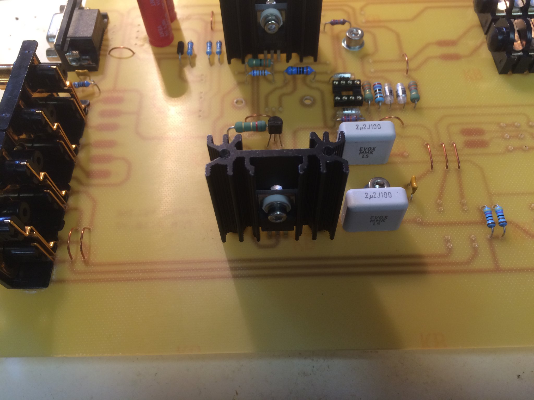

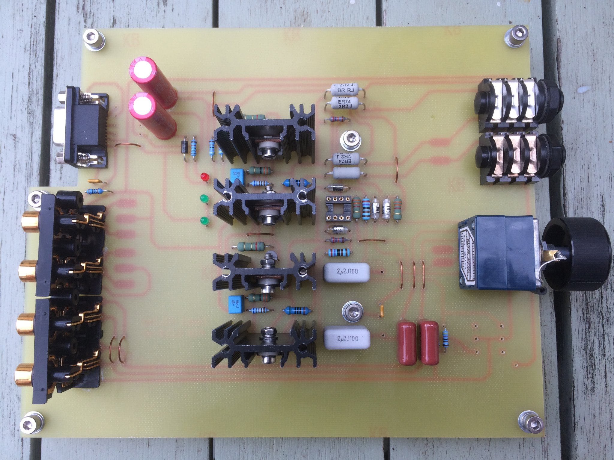

few more pics of my progress for the JLH class A headphone Amplifier
Reactions: decramer

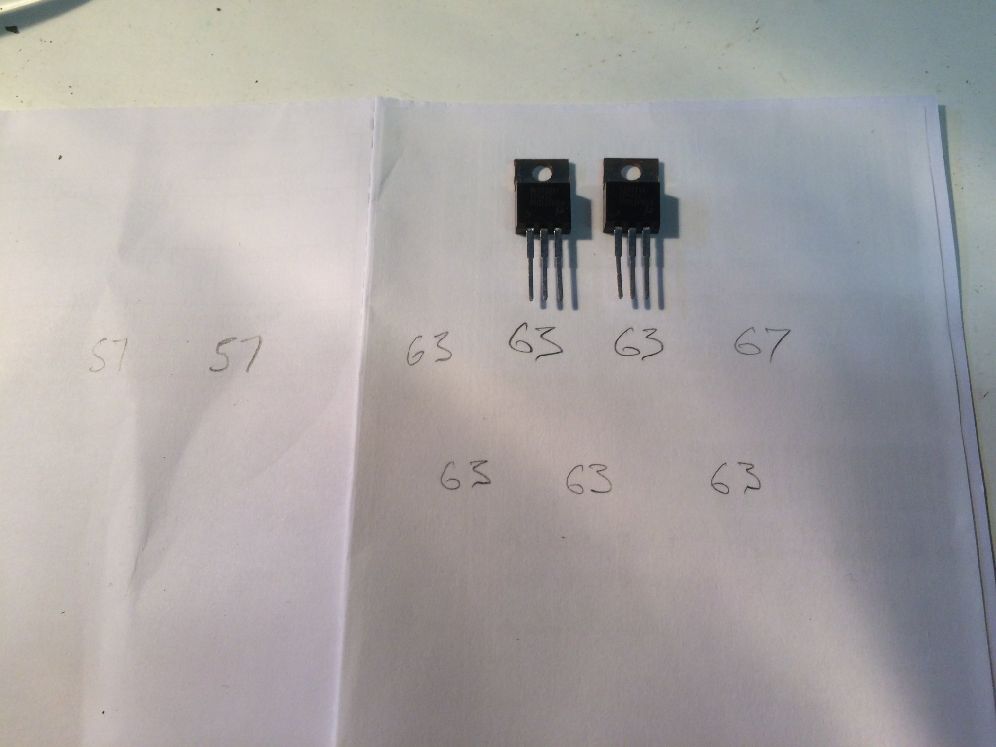

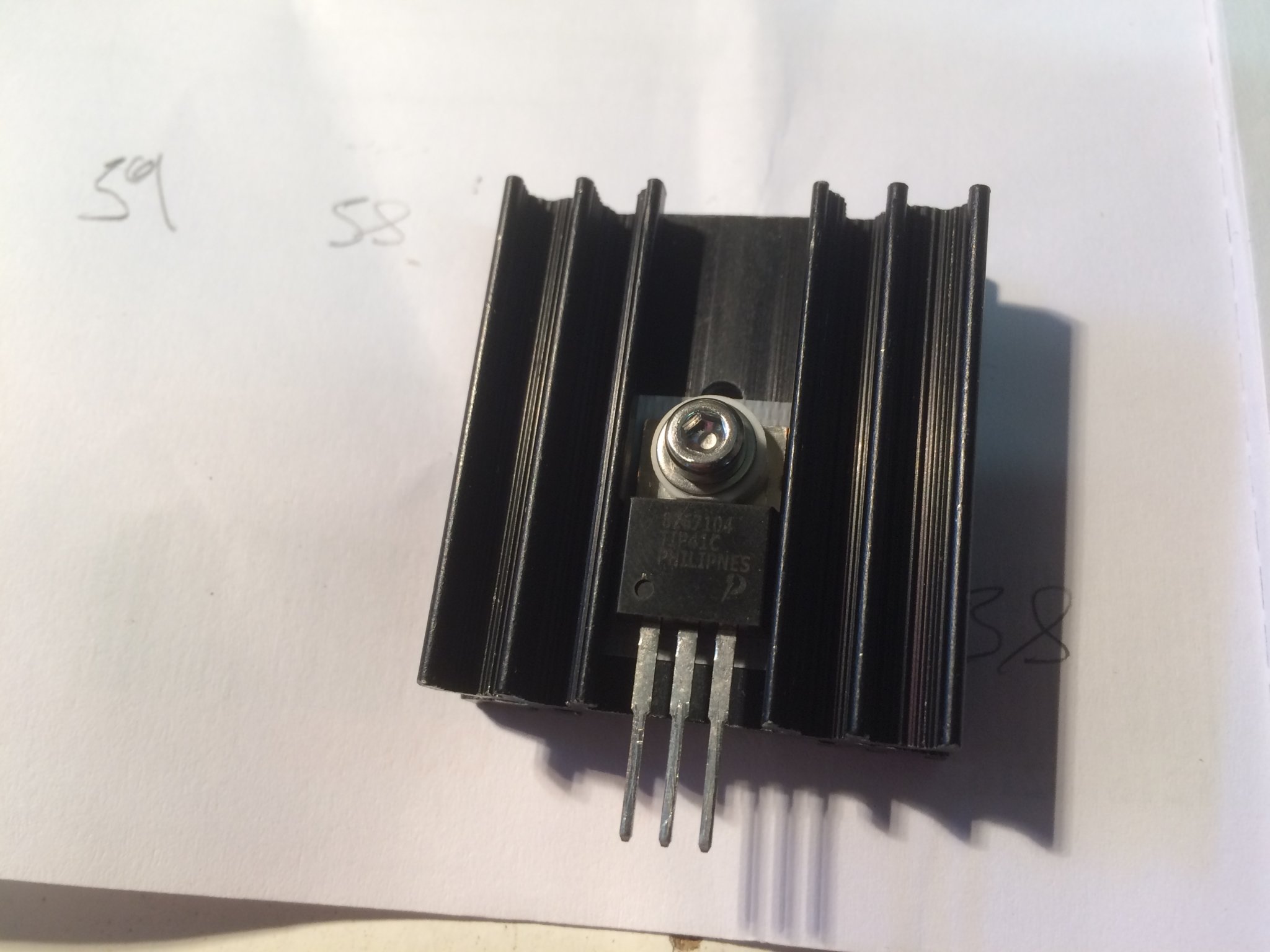

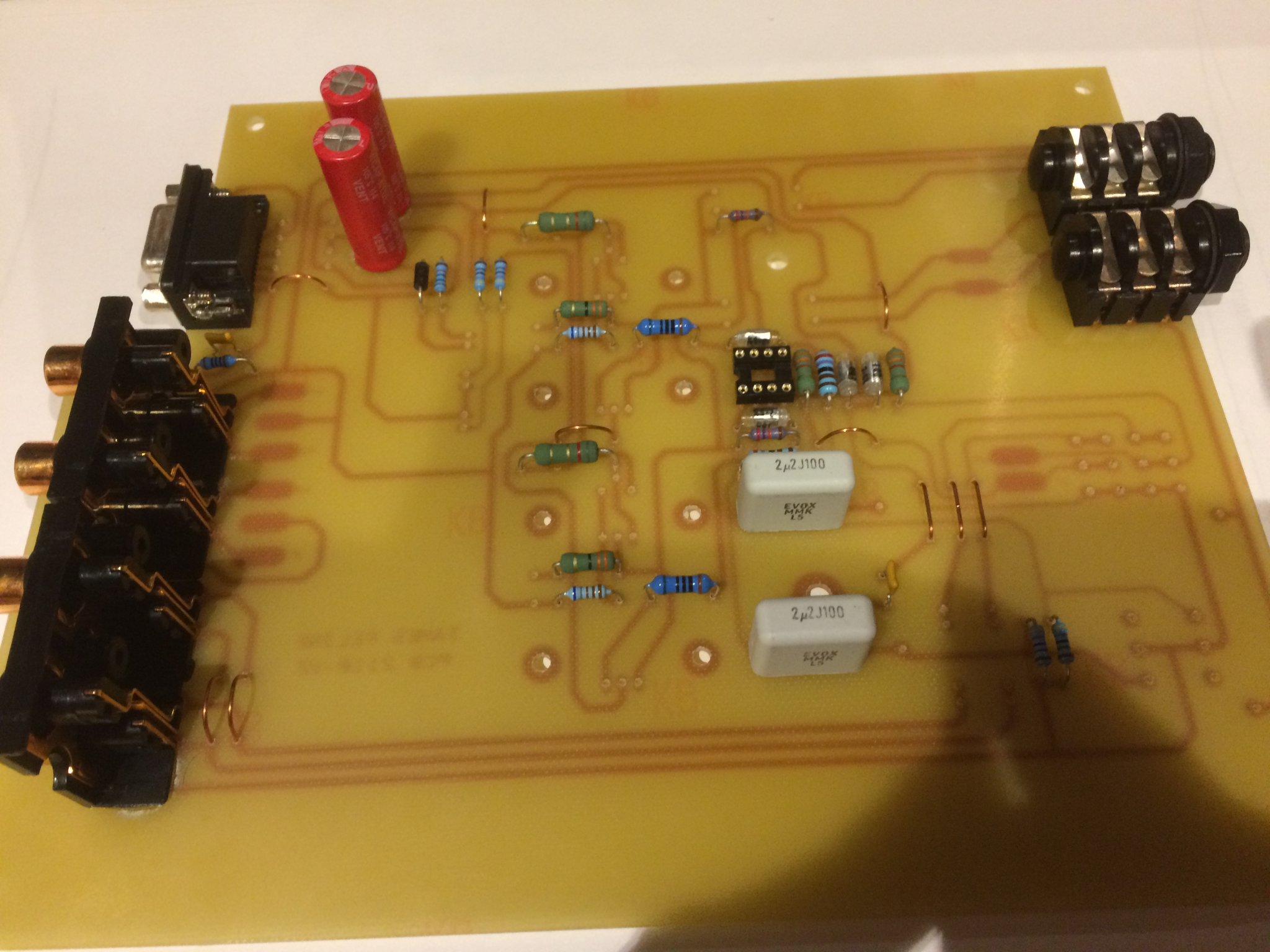

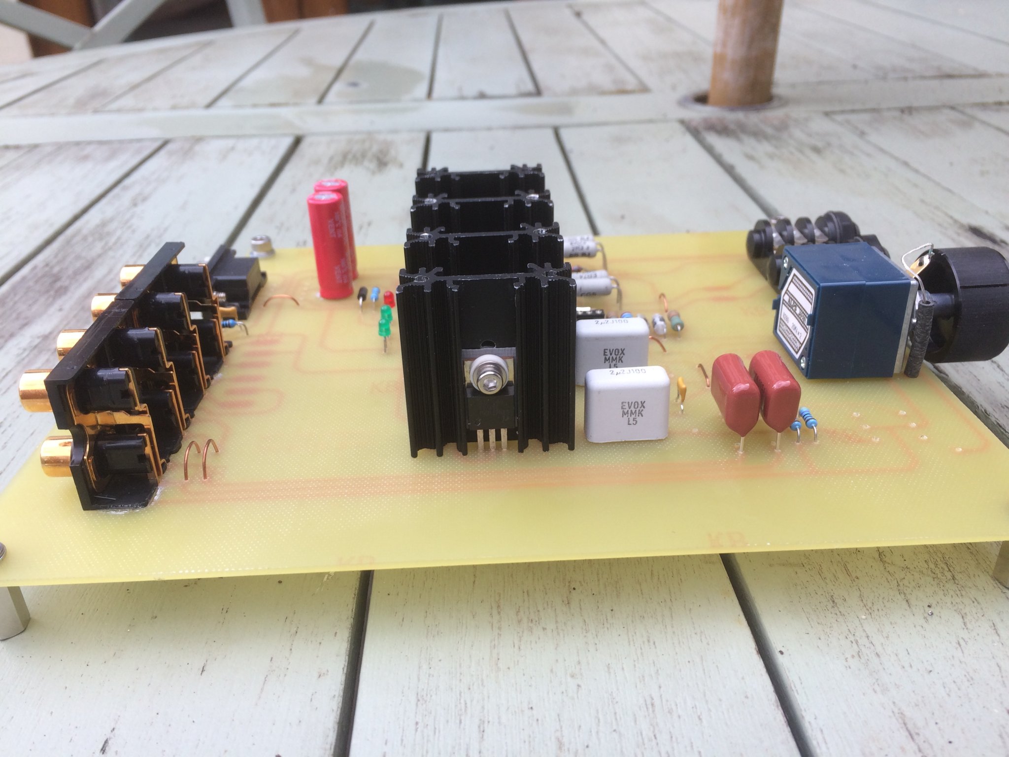

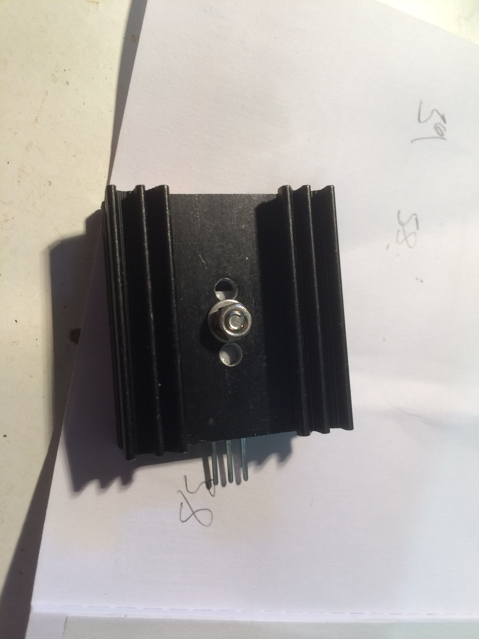

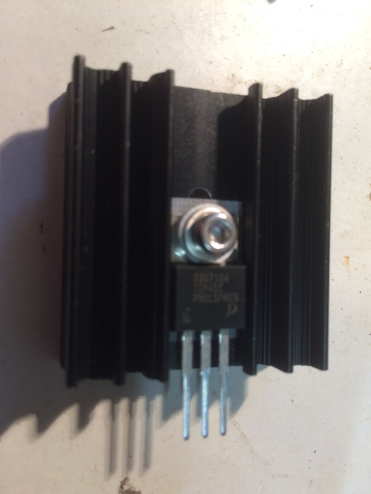

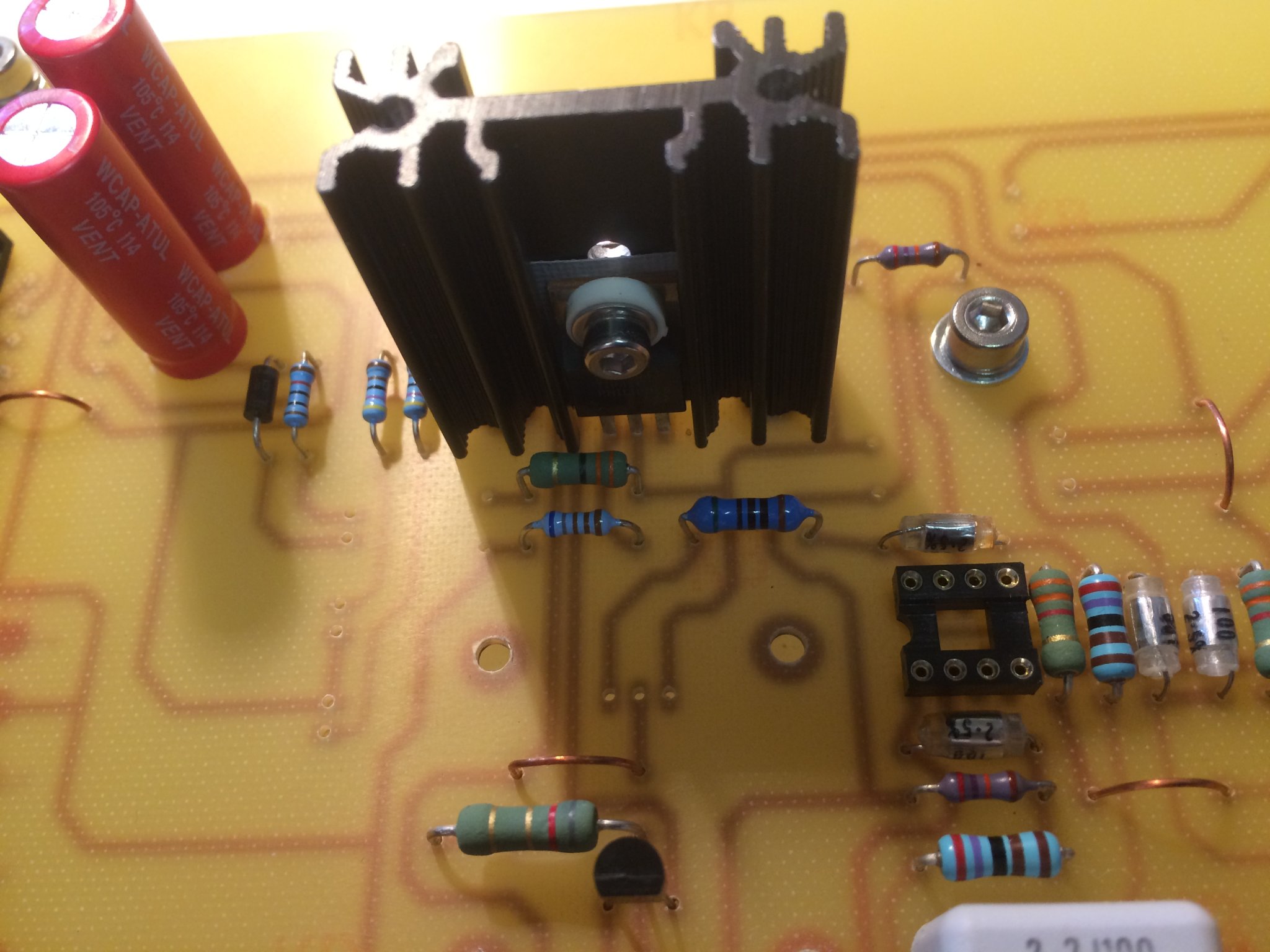

and the B184B and 2 power transistors with heatsinks fully mounted (all matched) just waiting for some more components to arrive from RS and Rapid .. plus mouser etc

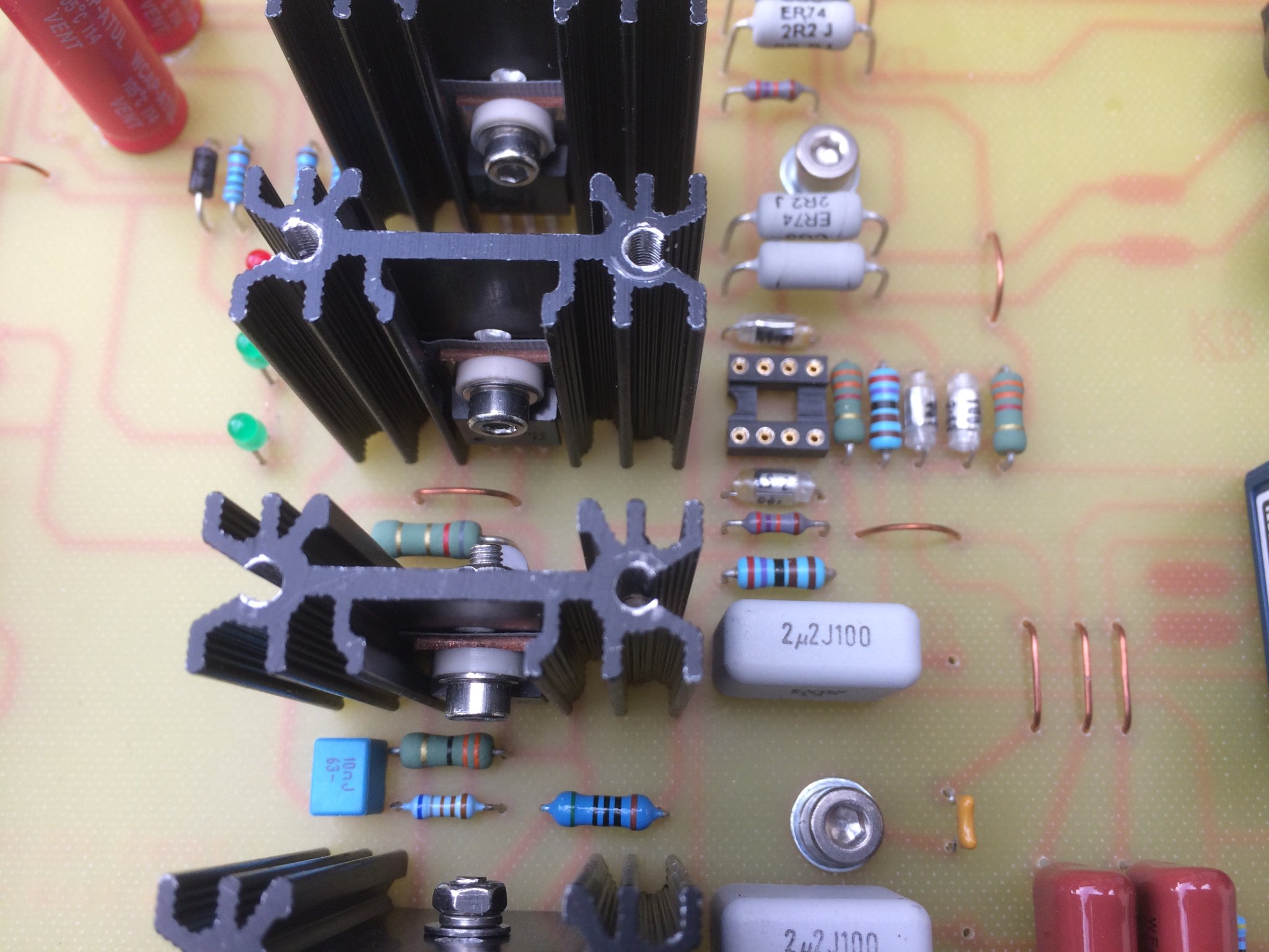

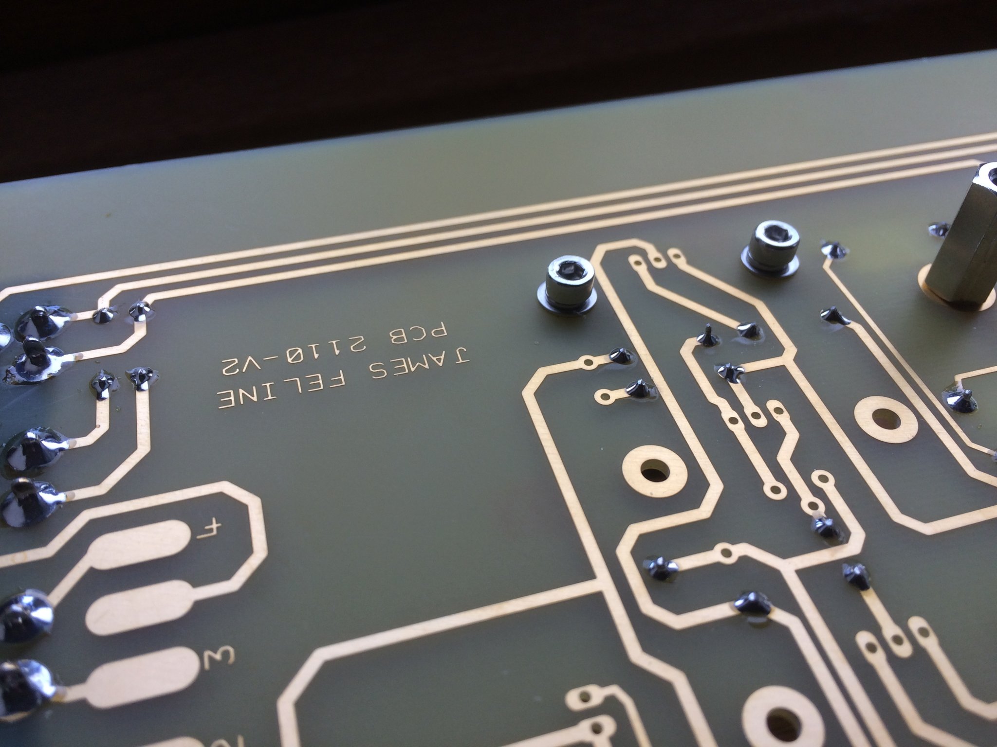

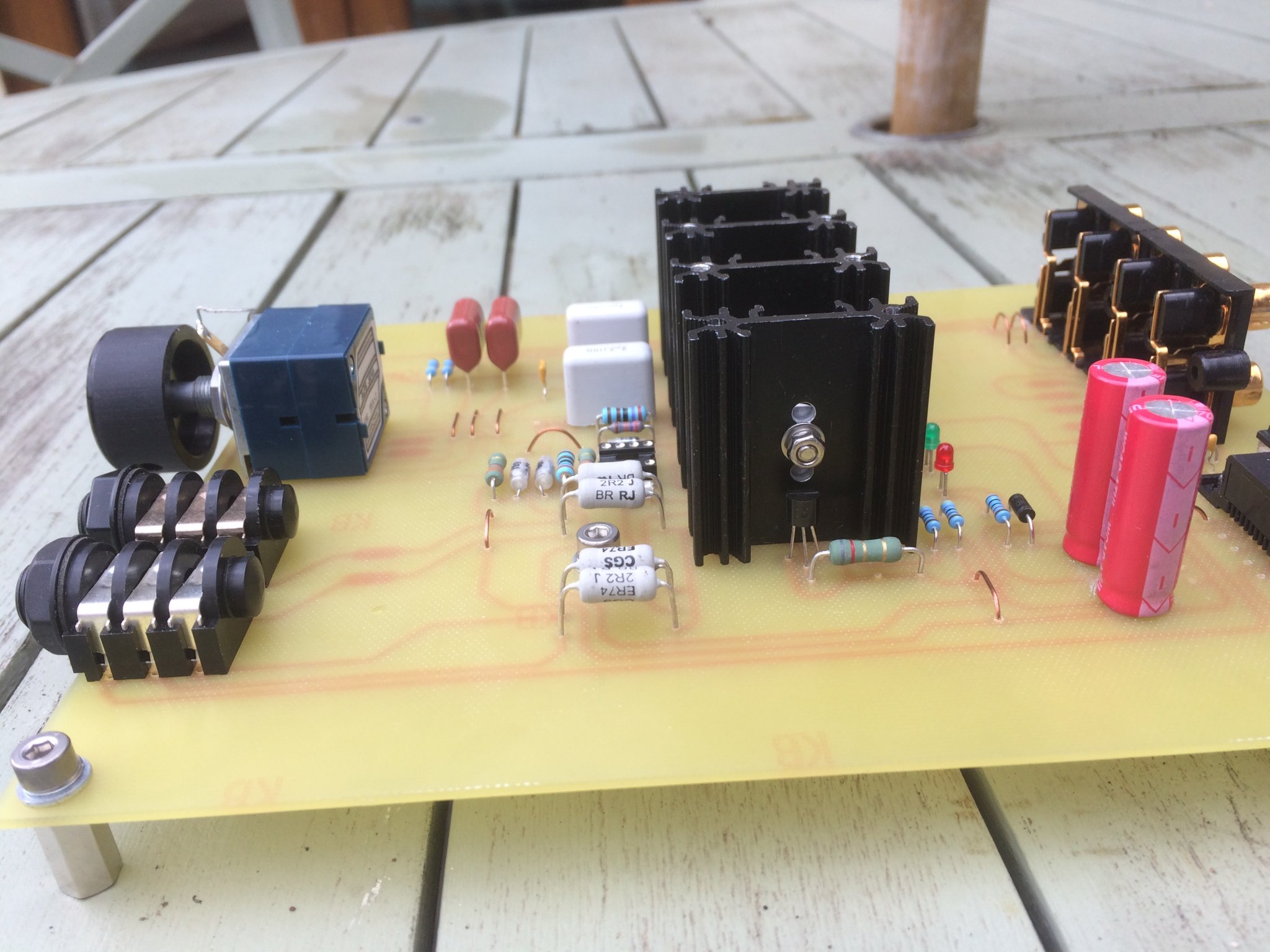

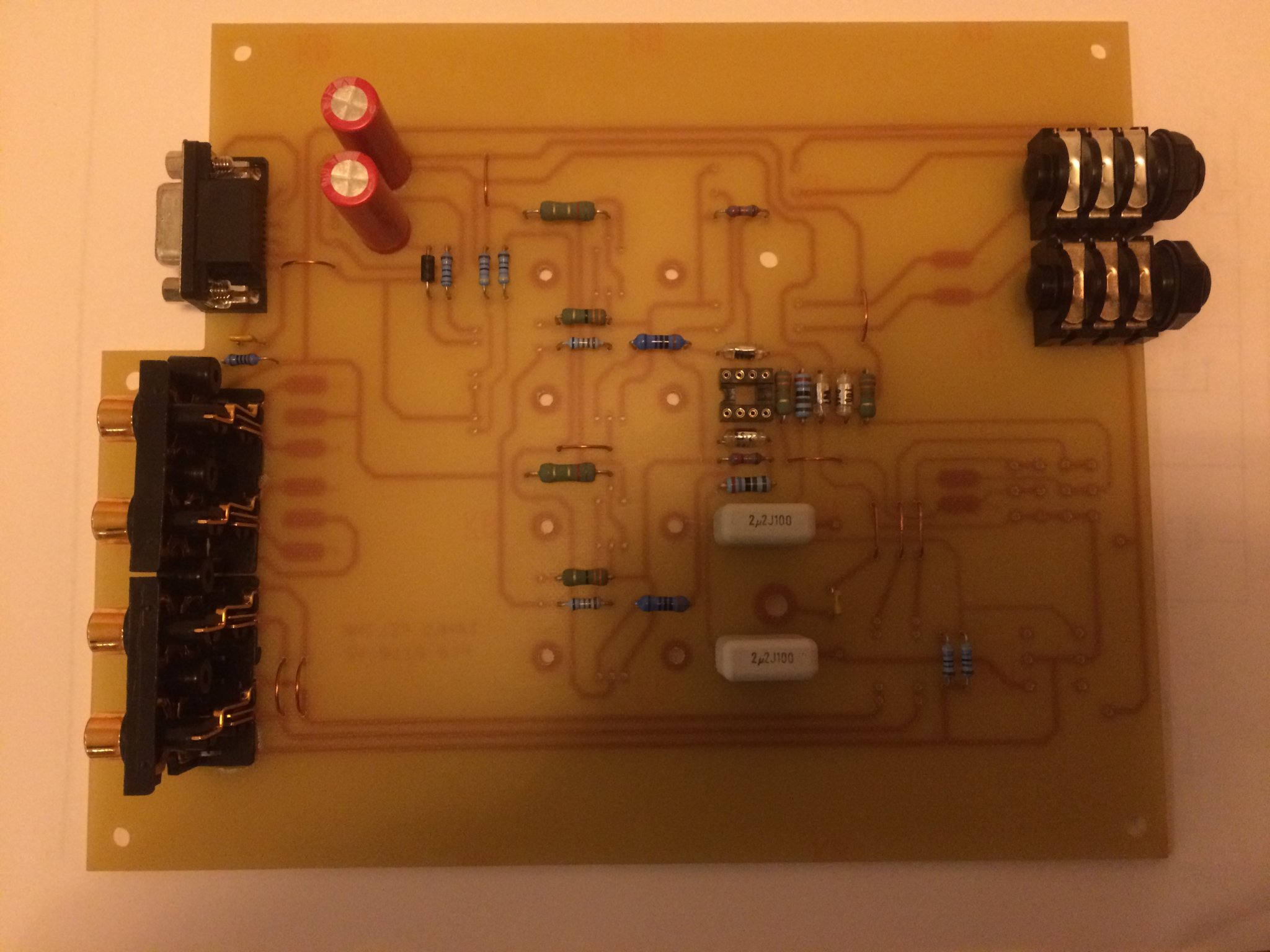

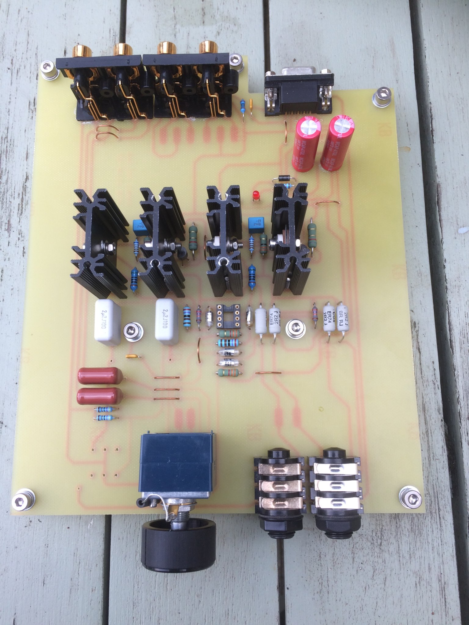

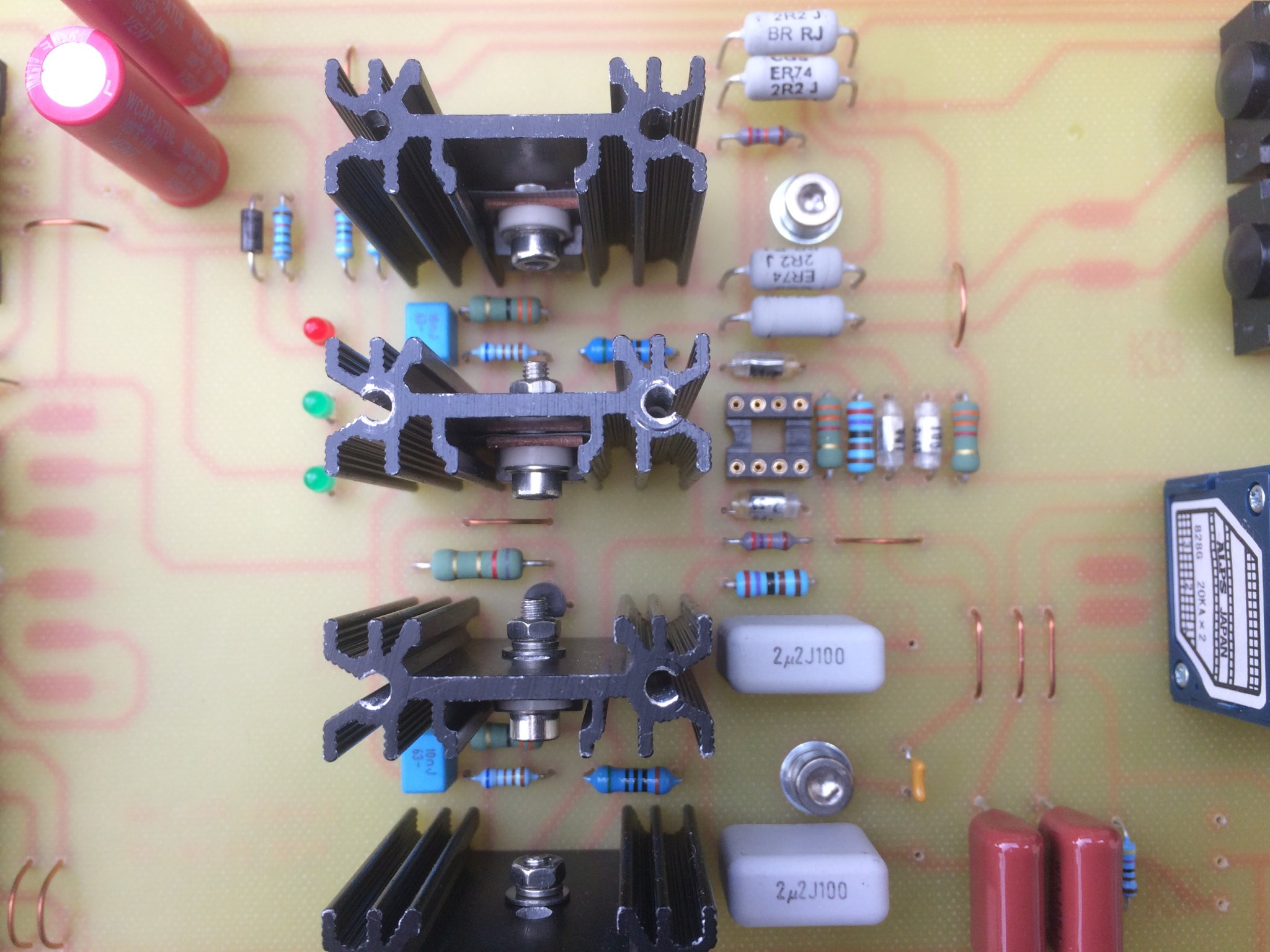

Hello gang
headphone amp nearly complete .. quick update on the main headphone amp
Reactions: davym

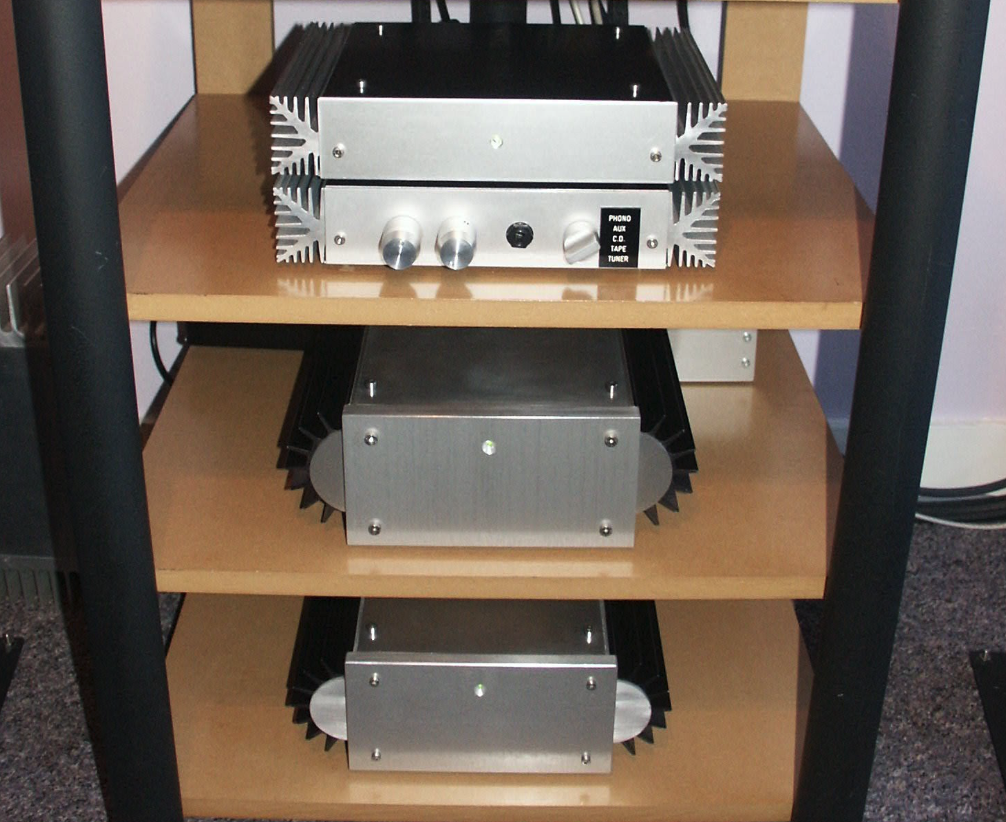

I still have my original Chiara headphone amp /preamp. I built mine when the kit was first published. I used original PCB from JLH kit. The 2 cases on the top shelf are JLH Chiara Headphone / preamp and power supply installed in my DIY cases.. The two items below it are a pair of ESP Audio P3A power amp mono blocks again in my DIY cases. I am a retired Electrical technician I used to work at a very large Pharmaceutical site in UK. All the enclosure heatsinks were made using materials from scrap Motor Drive VSD cabinets the rest of the aluminium came from scrap production machinary.
Hello penn07
Many thanks for posting .. great post this is exactly how I make my amps, always trying to reuse big heatsinks from old equipment
I love the Chiara its a great headphone amplifier that is why I invested lots of man hours to reproduce the pcbs's etc with new gerber files
would love some internal pics if possible
all the best 🙂
