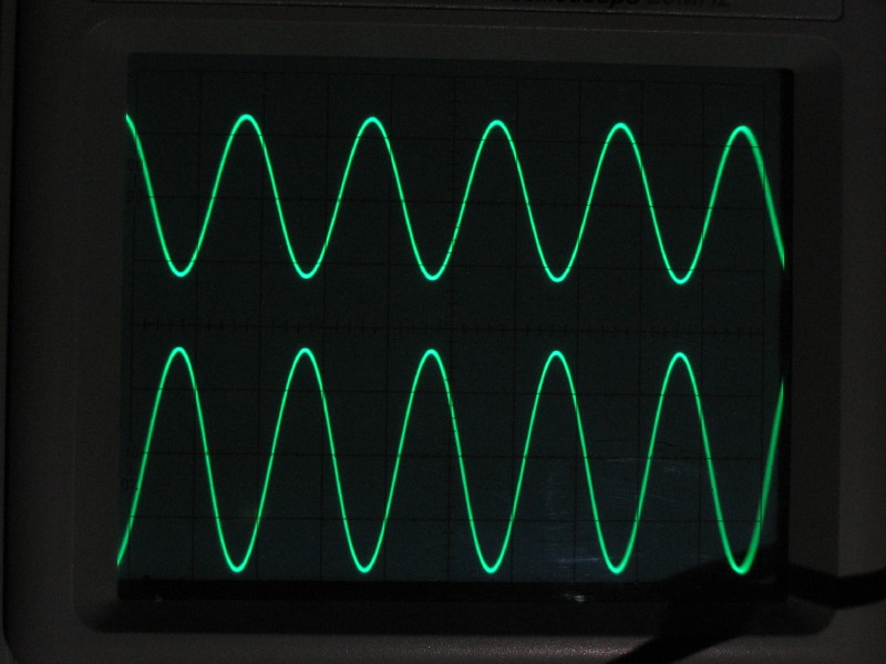

Geoff
I agree with your comment that the JLH would normally provide only about 1.35 times quiescent. This was the case using original transistors of the 2N3055 type.
If you use linear gain transistors like the MLJ3281A then I believe it is possible to do much better- perhaps almost 2.

john_ellis said:If you use linear gain transistors like the MLJ3281A then I believe it is possible to do much better- perhaps almost 2.
Hi John
If your comment is based on simulation, using OnSemi's model of the MJL3281A, then I would have to disagree as this model is seriously flawed. However, if your result is based on actual measurement then I would like to hear more. Unfortunately, using the MJL3281A requires additional components to ensure stability which will lower the open loop bandwidth to significantly below 20kHz. I believe that one of the reasons why the JLH sounds as good as it does is that the open loop bandwidth extends virtually across the full audio range.
Geoff
Hi Geoff
Measurements on a Class A amp.
I started by measuring the gain linearity of the MJL3281A's I'd wired into my bench JLH-10W circuit.
Within the very rough accuracy of the resistors, to 2 sig. figs, the gain varied from 90 to 96 to 94 over the range 80 mA to 4A. THis is similar to the published typical gain (100 flat from 5 mA to 5A).
In JLH's original Class A amplifier, the upper and lower output transistors share the driver transistor current. So when one transistor conducts more, it has to take base current from the other. If the gain linearity of the transistors is poor, the increase in one is not linear with the decrease in gain in the other.
Old transistors like the 2N3055(later called H) from RCA may have had a gain of about 50 at 1 A and 30 at 3A. The base current of the two devices might have been sitting at 20 mA, but when one transistor just reaches the point of switching off, a maximum current of 40 mA is available for the device turning on. If it's gain has dropped to 40, then it can only conduct 1.6A, so this explains the early ratios which were around 1.35 in practice as you mentioned.
BUt if the current gain in the output transistors is linear, then the current should in principle be able to double, since 2X Ib gives 2x Ic for the same gain.
I then measured the current in the output stage. The oscilloscope photo attached shows the output at the point of clipping (only ~ +/- 12V peak into 7.5 ohm load) while the lower trace shows the current which reaches a peak of 1.8 x idling, which coincides with the dotted reference line.
OK that's not quite 2 but it's better than 1.35.
cheers
John

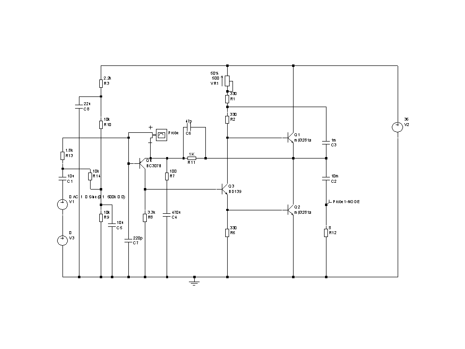

John
Thanks for the info. I am always pleased to read/hear feedback about the JLH Class-A. Your measurements confirm that which I had determined from simulation.
Did you need to add anything to the circuit to ensure stability? From comments received previously, it would appear that the original 1969 circuit is more stable with higher ft output transistors than the later 1996 revision, possibly due to the bootstrap Iq arrangement rolling off the gain at higher frequencies. For the former, at lot probably depends on the physical layout and associated parasitics.
From feedback I have received, the 1996 circuit is always unstable, without additional compensation components, when more modern, higher ft output transistors are used but the original version is more tolerant and sometimes works, sometimes doesn't.
Geoff

Geoff
I added a small capacitor to ensure stability. The bandwidth with this capacitor is still about 1 MHz.
The input filter could probably work with a much smaller capacitor (47 pF also?)
SImulations indicate that as the circuit stands, operation up to 200 kHz does not overload the input stage, but higher frequencies might.
A larger feedback capacitor is needed to ensure that the input stage does not overload, but I suspect that 200kHz margin is adequate for most signal sources?

current limited
Can anybody tell me what actually happens when the JLH amp runs out of current (Iq) when driven to loud in low impedances.
I do understand that the amp clips when the voltage needed to drive the speaker to a certain power is larger than the rail voltage.
But what happens with the waveform when the amp is running out of current?
thanks, MArco

Hi Marco
I've raised this point before, in other threads, but many threads seem to like going round in circles...
if your JLH69 overloads by clipping, nothing much happens except that the waveforms internally on the second stage transistor (phase splitter) saturate.
if your JLH69 overloads in current because of a low load impedance, then you might be in trouble. I've mentioned that the phase splitter could cause the upper output transistor base to reverse bias by as much as half the supply voltage. In this case the waveform is a square wave (for a sinewave input) with the upper output potentially becoming a liability.
This isn't too clever, and it may have caused one contributor's trannys to expire, since most bipolars will "blow a fuse" if their bases are more than about 7V backwards.
To stop this risk, either make sure that your speakers won't short or are 8 ohms or so, or put a fast diode in series with the upper output base!.
cheers
John
