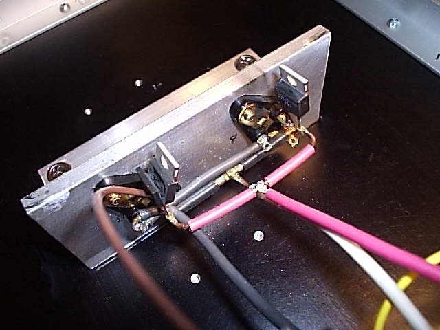

Nice fire works 20 miniutes ago! What happened here ? Both 0R1 ohmite resistors (either the R13 and R15 or R14 and R16 pair)blew wide open and split up in the middle...and the smell..
Do I assume both transistors are toasted as well?
Where do I begin fixing the amp? Any advise are welcome and appreciated..
I was listening to music over 3 hours today.. the amps are in daily use since 2005 but I have not done any Iq current checking or adjustment over 20 months or so since...
well perhaps it get bit too hot and then a transient come along and take it out.
perhaps ur bias drift.

Mike, John
The amps were completed and in daily use since around Nov, 2003 and the last time the Iq bias were re-adjusted in 2005.
The amps were on well over 3 hours before it fried. But the night before that was on continuesly over 5 hours before I went to bed.
The heatsinks were normally at 42C after 1 hour with bias set at 3A. I meant to re-set the bias two months ago that I noticed one Mj21194 felt hotter than the other. May be one was dying slowly over time.
At the time of the resistors were lighting up the temperature of the heat sink felt normal. It was in the middle of a song that suddently the left channel's mid-high muted then I realized something odd happened. As I walked over to the amp and investigate I was in time to see the fire work sparked up, pop , flash and smoke. My first reaction was reaching over to the power switch and turned it off. This pair of my JLHs is used to power the mid-high section of my 3 ways active OB Jordans. I have not check to see if the speakers were damaged yet.
Shall I replace the two Mj21194 on this rail first before replacing the 0R1 power resistors?
Mike, I do not mind to try those wire you mentioned but do I have to all 8 pieces of the resistors ? What do you do to implement the constanan wire? A specific length for 0R1? and is it a direct replacement?

difficult to tell what the problem was, but with Class A amps like this thermal runaway is a potential issue. Prolonged heating will cause the amp to warm up and the CCS to the input stage is not balanced against temperature change. Unfortunately. On the other hand, the CCS in the VAS (second ) stage will reduce the base current to the output and this could be a saving feature.
Your mid point will drift off with temperature. Most amps show some drift, but in a single ended non differential, it is likely to be more of a problem.
Don't know what speaker loading yours was, but a low impedance at DC could have caused a large offset current even for small offset voltage. Could the DC impoedance of your speakers contributed to the problem?
It might have been a dodgy joint in the power transitors- they were tightly screwed down I hope?
I think you will have to replace all output transistors and resistors.

I will try to keep it same as before like the right channel now that my multimeter will display 150MV when measure across R13 with 17MV DC offset at the speaker terminals after an hour power on with 38C heatsink in room temperature of 18C.
Do I really have to replace the power transistors and resistors on the other rail for R14 and R16, Q1 and Q1A? They seem to be fine.
My plan is to replace Q2, Q2A, R13, R15 only and unit test with variac once I can find the parts... is that a bad idea?
Of course you could try just changing the faulty ones ...
I think I would try that first but perhaps switch on with bias turned down and speaker disconnected.
but if you are interested to try the wire you will need to change them all.

You do have to consider power and heat, this is why I checked what current chris was planning to use
In this case if you do the maths - 0.15 Volts x 1.5 amps the power comes out at 0.225Watts.
From my experience, I know this will be ok. The resistors will get warm but nowhere near flamimg - perhaps about 50 deg C
This wire has been developed to have a low temperature coefficient - I guess that why it was called "constantan" wire.
for some reason it really improved the sound when I tried it - my guess would be because of it's low noise.

I think if you provide a way of limiting the volts and amps you can try just replacing transistors and resistors that look dead.
I would suggest you want to take a look at the VAS too - if your upper output device went skywards then maybe it took the VAS/driver with it....
maybe some protection is needed for the VAS?
