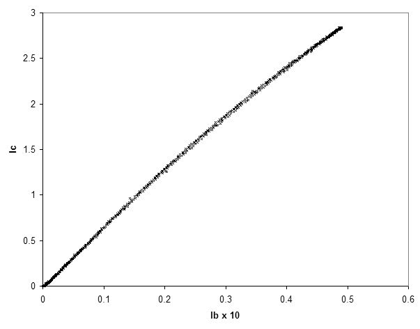

> How do I do that?
Buy 20 or so transistors and measure hfe, not with a multimeter but drive it with a base current, and measure collect and base current to calculate hfe. Vce should be about you rail voltage, so you need heatsinks for matching.
When you have 4 transistors with about the same hfe, pair them such that the sum of hfe's are closest to each other. But if one pair is still say 1% higher than the other, then use that pair for Tr1.
You may, if you wish, contact me by private email. I have some matched quad MJ15003's left.
> Do I understand correctly from this tha I can compensate mismatching in transistors with compensating mismatch in resistors.
No, I mean when you have perfectly matched transistors, you don't want to spoil the match because your emitter resistors differs to each other by 10~20% ? I measure them as well, and usually you can get metal films to much better than 1% if you buy 50% more and measure them all. This one I cannot help you. I have no 4W 0R1 lying around, only 0R47 metal oxide from Schuro.
Attached a typical measured hfe curve.
Patrick

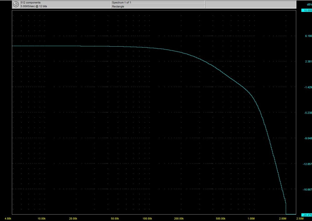

deduikertjes said:
I'm planning to upgrade to the high power version using 4 2sc3281's per channel.
Are we sure these transistors will work in this design without oscillating ?
When I used MJL3281 I needed some compensation.
So some precautions may be necessary
mike
What's wrong with that ?
Someone said on Geoff's website that they got humm with MJ21194.
Attached is the frequency response of my Xed JLH with MJ21194 and 10p compensation on the feedback. I can probably get away with 1/3 of that, but this is good enough for me.
And sounds wonderful.
Patrick
compensation cap
It is no problem if you do it - could be a big problem if you don't !!!
...and I agree that putting the cap across the feedback resistor is the best method if it works - I did not try that on this design yet
I previously did it from driver stage to i/p tr emitter but I concluded recently that this is not such a good method.
mike
