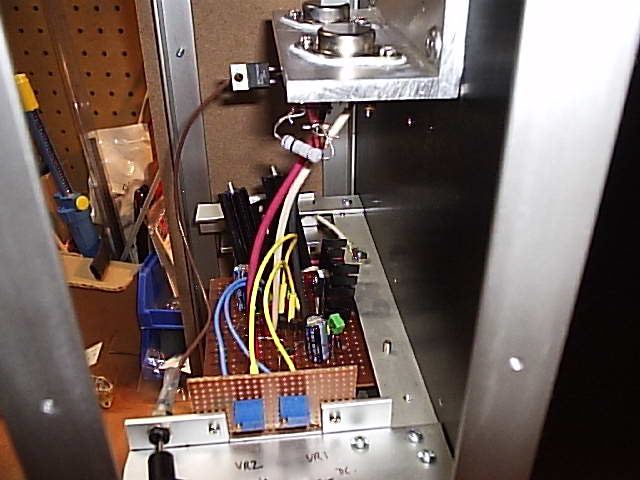

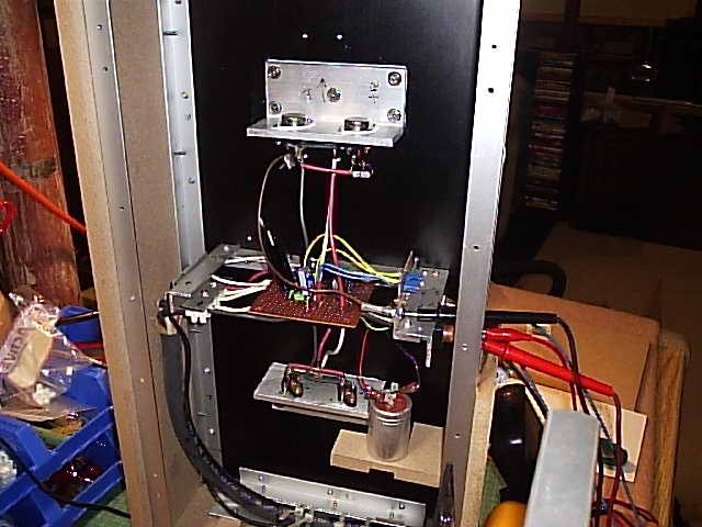

Second Breakdown

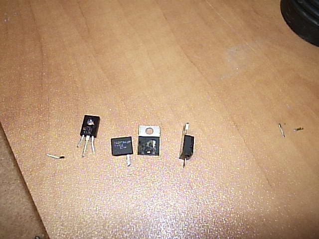

The BD139 checked out ok, but I have to put a new one in now. Very difficult to work on this one in a tight spot.
These 2 Ohmite 0R1 resistors R13, R15 in their damaged state see pic.
Three out of four Mj21194 output transistors were damaged. The Q2, Q2A, Q1 were damaged, Q1A is the only one survived.
I gathered it was because through the years of usage I didn't maintain it by go around and re-secure all mounting screws of the output transistors. The stress of the heat had lossen up the screws and slowly the contact for heat transfer was diminished that lead to this failure.

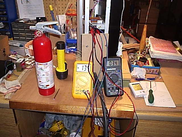

Fixing it
For the time being I have replaced the damaged parts with what I have in hand just to try things out.
2 MJ21194 and 1 2N3005
1 Ohmite 0R1 25W thick film power resistor as R13
1 NTE 0R1 2W carbon power resistor as R14
1 BD139 as Q3
using the variac and bring up the voltage checking the Iq current and DC offset. This pic is taken 2 minutes after switch on with full power. This time I am aiming to set the Iq at 138MV across R13.
1 BD139 as Q3
This 2 CCS version is so easy to adjust the DC offset and Iq current. The power on from cold to after an hour effect on Q3 has very steady effect on DC offset and the Iq current has changed from 136MV to 139MV from stone cold in an hour. I am very please with that.
mikelm said:I glad u keep the fire extinguisher handy ... 😀
Always with fear and respect when working and in our case playing with fire literally

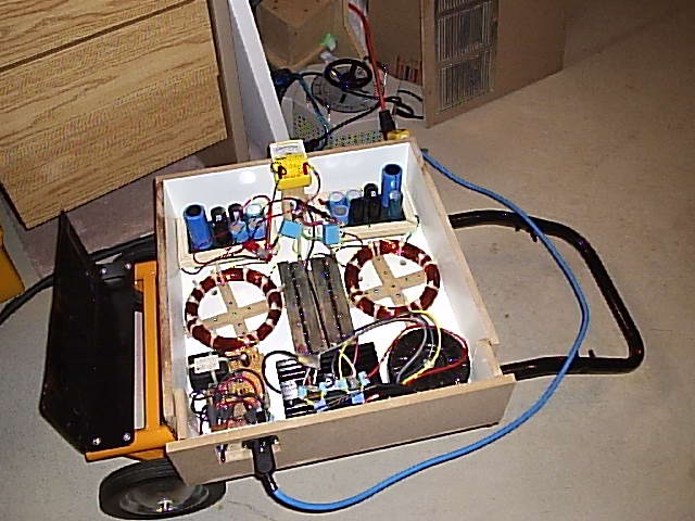

The one that fried last weekend is the newer 2 CCS and using big CLC remote power supply using Mj21194 output transistors.
In my system I am using active 3 way, for each channel I am using the following
1 JLH using Mj21194 to power the Jx53 and a ribbon tweeter
1 JLH using Mj15003 to power the Jx150
2 BrianGT GC to power 2 X 12 inche H frame subwoofers
This time the Mj21194 burned out due to second breakdown means overheat over a prolonged period shorten the life span of these transistors. Luckyly the ribbon has a transformer to survive this ordeal but the Jx53 is not that lucky.
