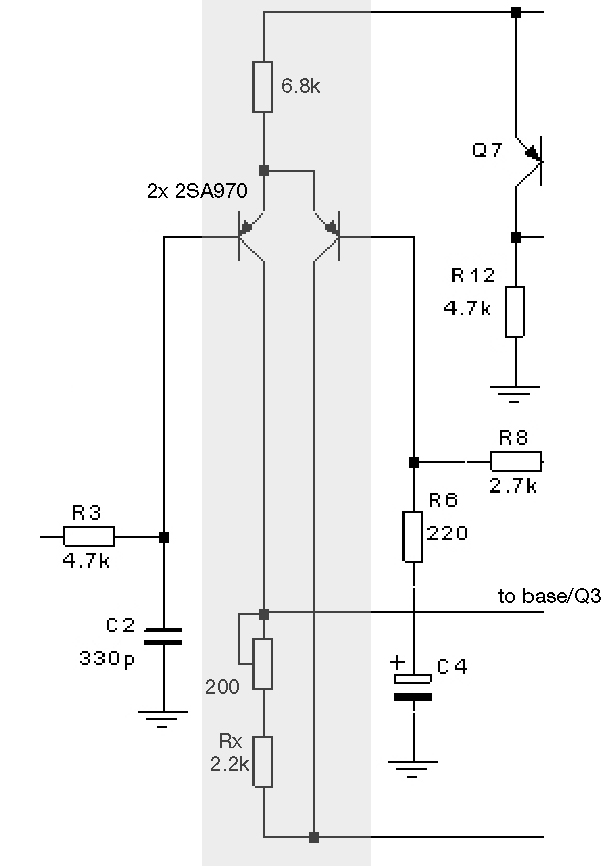

Discussion
Open for discussion, no hate-mail please:
- This nifty but not yet perfect DP-input should allready lower
overall THD to the lower 10th under every condition.
- With Rx, the Dc-offset point can be reached right into the
ballpark.
- MJ11016 should be a very, very good replacement for the
MJ15003.
Who dares to tell us the different in quality and sound?

> I seem to have missed something....
Yes. You missed the picture.
> what DP-input ?
Differential Pair. See also e.g. Post #1167 from yours truely.
> MJ11016 should be a very, very good replacement for the MJ15003.
Can you give your reasons ?
Purely from measurement, I would prefer MJ21194 -- much more constant hfe, and not too high bandwidth as Sanken 2SC2922. But not built anything yet, so no subjective comments.

MJ110016
> MJ11016 should be a very, very good replacement for the >MJ15003.
>Purely from measurement, I would prefer MJ21194 -- much more >constant hfe, and not too high bandwidth as Sanken 2SC2922. >But not built anything yet, so no subjective comments.
The behaviour in simulation for every circuit, I put my hands on was just outstanding.
My amp is not finished yet, so I have to depend on a second opinion or somebody who allready tried.
Michael

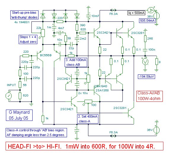

Hi Michael,
I'm running un-mirrored input differential myself at the moment.
Notes;-
If your psu is not regulated you can get hum through that tail resistor. Put another resistor in seies with the tail resistor (choose to drop about 0.6V), connect a smoothing capacitor, and fit diodes as in my circuit to prevent power-up thump. Result - silent power-up (with dual rails) and background.
Watch out for instability due to the extra stage of rf phase change - this does not show up adequately through simulation. I cured this by fitting 10nF across the feedback base-emitter differential transistor and adding the rf input filtering. The input bandwidth is still wide open but not troubled by clicks etc. No other stabilisation components needed here.
I have made many A-B comparisons between single input and differential pairs over the years, and I prefer the improved output zero control. If differential pair usage increases the open loop gain then the distortion is reduced and the loudspeaker damping increased; both aspects are worthwhile, but not always audible when compared to a single input. Where the differential input really scores though is when you turn the volume up, because the amplifier remains much more stable and does not make the loudspeaker cone 'breathe' the same as when input bias shifts with the non-linear driver current draw.
Good luck with your construction.
Cheers ......... Graham.

Graham, thanks for your input, which does help a lot.
The final goal will be a current-mirror, but first I have to learn how to calculate these thing and more important, how it will be affect the rest of the JLH and if the JLH has to be modified, what I really don´t want to do.
Cheers
Michael
