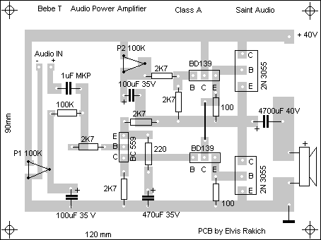

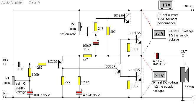

hum, i still do not understand how can you missed the schematics, but here they are:

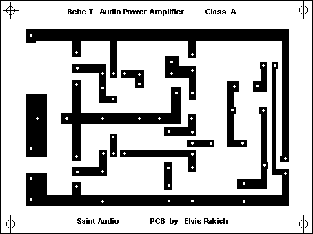

the schematic, the pcb with components, and the pcb MIRRORED(be carefull) hehe
and the pcb mirrored.
please before constructing it read the rod´s article about this amp, otherwise you can blew up almost instantaneously.
this is the rod´s page :
http://sound.westhost.com/project36.htm
i repeat, please read the whole article before building the amp specially if this is your first amp.
thanks to Elvis rakich por the pcb layout , and to master rod for the amp itself.
cheers.

high freq oscillation at negative peaks
I have soldered a JLH 69 cct on a protoboard. Runs at 1.7A, 40V single supply. Transistors are : 2SA970, BD139, MJ15003.
With single output transistor pairs (tr1 and tr2), the cct works nicely upto 35v peak to peak output.
As I found tr1 and tr2 are getting too hot, I parallel a second transistor to each of them. At low output swing, about 10v peak to peak, the waveform is very clean. As the output increases to over 15vp-p, there is a RF oscillation superimposed on the negative peak; the frequency is about 2MHz. The rf suppression capacitor between tr4e and tr3c is in placed already. The nozel network is also soldered. I dont want to increase the capacitance as the response already started to drop at 20KHz.
The test load is 8 ohm wired wound resistor.
Parallel transistors are wired in one heatsink, ie 2 tr1 on one heatsink and two tr2 on another heatsink.
I have wired a 0R1 in series with tr1 emitter.
Please advise.
thanks
kb
Hi kambule,
The output transistors should each have a 0.1 ohm resistor in series with their emitters.
Four output transistors - four resistors.
My choice is for non-inductive thick film types.
Hope you have a central earthing point, and that the Zobel is directly connected to it.
You could try an additional Zobel network in parallel with the one already fitted; say 22nF in series with 2.2 ohms.
Cheers ........... Graham Maynard.

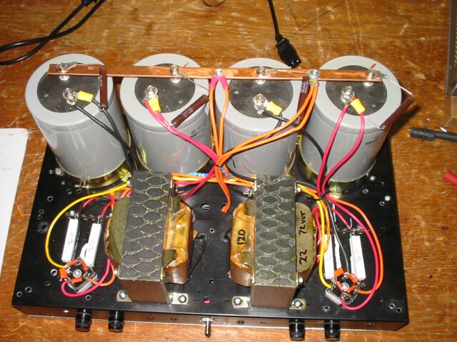

OK, I'm half done. I have a power supply ready for my upcoming JLH amp.
The two transformers have their primaries wired in series to give me half their normal secondary voltage. I'm getting about +/-24VDC. You can see the current sharing resistors, 0.47 ohms. Each transformer is centre-tapped and runs a separate bridge rectifier / capacitor pair (68000 uF per cap), although the rectified output is tied in parallel so neither side can hog too much current (which would unbalance the transformer primary voltages).
The transformers came from a pair of Advent powered loudspeakers I gutted.
I'll be using a capacitance multiplier as well; it will either fit on this chassis (two big heatsinks on the sides), or become part of the amp chassis.
Another couple or three years and I should have the actual amp built.
