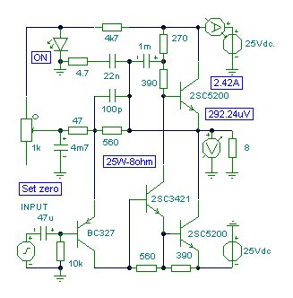

I have published a version I built about a year ago here, which was essentially an Aleph X (Mosfet) but with the Aleph current source replaced by a phase splitter. Now I am tempted to build a bipolar Xed JLH, having already build 2 1996-JLH's and ran them normally bridged but not X'ed.
Comments from experienced JLH builders still most welcome.
Patrick
Patrick

Hi Michael,
For many, one of the big advantages that this amp has is it's excellent gain/phase charactoristics which means that no compensation is needed.
When JHL published his second version of the amp he had considered using a long tailed pair but decided not to, because this would impact on the gain/phase margins ( and would almost certainly need a compensation cap or network etc )
My guess is that using CFP as an O/P devise would have the same consequences. Distortion may be decreased but would it sound better ?
Graham Maynard has offered here a circuit that has has a LTP i/p plus other novel elements and says it sounds very good.
I would suggest building a known good design first as a reference before getting into ideas that would need to be subjectively substantiated.
http://www.tcaas.btinternet.co.uk/jlhupdate.htm
This might be a good starting point
While I am aware that this is what he said, I could not quite figure out why that should be the case. Maybe you could help me out with a scientific explanation ??
Thanks,
Patrick
Thanks,
Patrick
Patrick,
I would guess this is because in JLH's design, he used a singleton input stage, with output from the collector and feedback to the emitter. If he had used a long tailed pair, then the output would be from T1, yet the feedback would be to T2, thus interposing an additional effective device in the chain. The phase shift introduced by the second device is absent in his singleton configuration; the one device handles both input/output and feedback.
Hugh
Hugh

Long Tail Pair
Hugh,
If your argument is true, then the circuit that I posted in Post #1167 should have similar phase behaviour as the updated version on Geoff's website ??
Patrick
Hugh,
Patrick
Hi Patrick,
I had a look at your design. I would say its gain/phase relationships would be excellent and it should not be necessary to introduce lag compensation or even phase lead. Then again, however, it must be said that amplifiers with compensation can be made to sound very good indeed, so that of itself this may be no real advantage.
Without building and hearing it, it's difficult to know how it will sound. You must remember that the JLH is an asymmetric design despite being pushpull, so it is likely to introduce some H2. This will confer warmth on the sound. Because of its balanced topology your circuit will cancel this H2, leaving only H3 and H5, and it may not be as euphonic. It will certainly sound very clean and free from intermodulation, but whether this is what you prefer is another matter. Lots of people like their women with stockings, after all...... It will sound demonstrably different to the original JLH, however.
Hugh
Hugh
