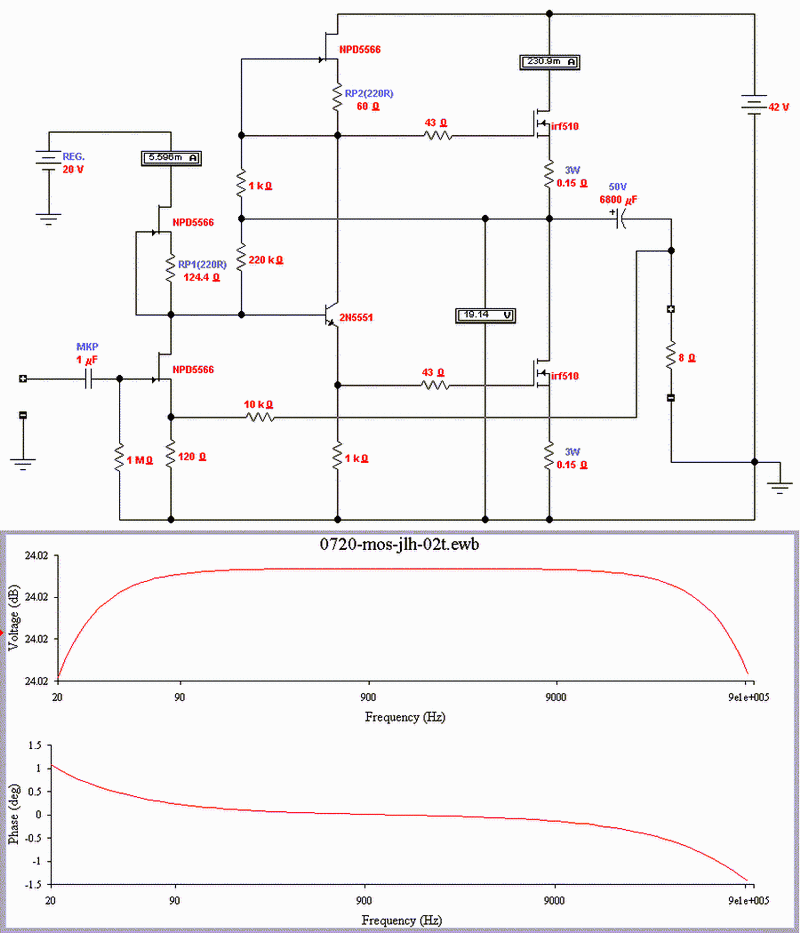

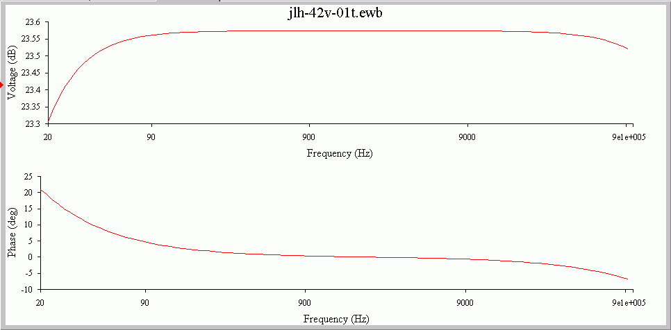

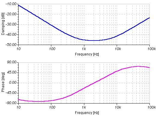

I have simulated your IRF510 circuit for damping amplitude/phase at 8 ohms; as attached. You can see that the NFB loop generated bass 'cone' control is going to be out of phase with loudspeaker generated back-EMF at low frequencies.
Also note that when you use Mosfets in the JLH class-A arrangement, that their gate capacitance creates a need for Miller stabilisation at the splitter transistor, and both sets of path capacitances shift the phase response of the hf damping. With your amplifier it is 50 degrees, with bipolars in class-A approx 15 degrees.

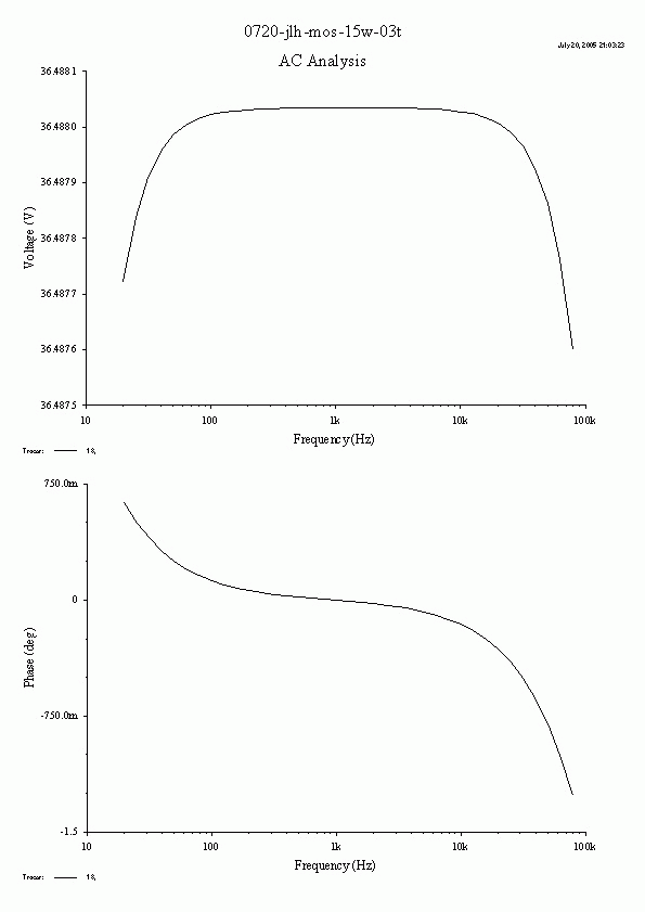

think you,Mr.Graham & Mr.Pass:
first,I agree with Graham's point,using large value of feedback cap & output cap,this is most easy way to improve it's bass character.
And I really like IRF540 transistor,It has low output resistor...but I hate it's about 1700pF's gate capacitance...it due to Hi-Frequency's waveform freaky...because it's driver current isn't strong(each IRF510 got about 4~5mA driver current ),so I have to choose low power&low gate cap.(about 200pF) IRF510...
and Mr.Pass said:using a resistor to instead of CCS,I think so!
because I have met the same things & get same recognition.
here is my IRF510 circuit's(according to my sample's value) AC ANALYSIS diagram(some difference with Mr.Graham,I think that is the software's problem?):

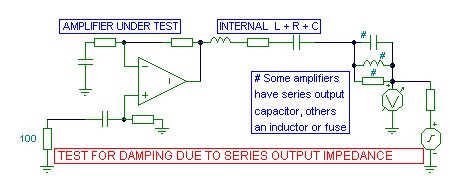

Hi DarkHorse,
Put a nominal input sourse resistance in place of your signal generator at amplifier input, say 100 ohms.
Move your signal generator to the earthy side of your 8 ohm amplifier load resistor, and analyse how the amplifier could behave in the presence of crossover/loudspeaker generated back-EMF.
Do this with several amplifier types and you will observe patterns arising that relate to topology, device types, stabilisation components, numbers of stages within global loop etc.
For cleanly controlled damping you need a flat phase response.
An increasing angle or quadrature at hf, especislly with a low damping factor and low bias class-AB, can lead to crossover section/loudspeaker generated back-EMF overcoming a portion of quiescent bias.
Output capacitor based back-EMF problems can arise with the 4 transistor JLH, but not the later directly coupled version. All other capacitors need to have sufficient value for good low frequency performance, and with today's lower frequencies original JLH values can be increased.
Don't forget that you can also place your virtual signal generator in series with the rail supplies to check out common mode rejection characteristics.
Cheers .......... Graham.

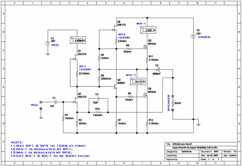

hi all:
I have say that I was unsatisfy with it's negative feed back networks...perhaps it was still suitable to BJT version(JLH1969),
but I don't comfortable with it in MOS version...So I have to do some modification with my IRF510 circuit,I think it should works well,maybe not.
here is my IRF510 circuit schematics,please do me a favor to check it's disadvantage,thank you!

good day everybody. its my first time to write here but ive been following this thread for long time now. i just want to ask if anyone of you tried changing the input transistor of the 1969 jhl into cascode. will its low cut off frequency improve. thank you all..
I would stick to the original JLH topology and tweak one at a time to see how it works. My experience of playing with JLHs is that they are excellent in producing bass.
IRF510 should be plenty enough for this kind of amplifier.
a few quick comments:
a) I am not sure how the driver stage is biased: on one hand, it is biased by the lower mosfet's Vgs (say 4v over 1kohm->4ma which seems to be very small). on the other hand it is also biased by Q4. it might be easier to replace Q4 with just a resistor (a JLH-styled bootstrap network isn't really needed to get this to function).
If you dial up the bias, you may have to use a beefier driver transistor. I used a 2119x series transistor for mine, or if you want, use a IRF510.
b) R8/R9 are probably OK but I tend to use 110 or 220 ohm resistors there.
c) the feedback networks are a little bit too complicated.
d) I am not sure if this really is a JLH, with so many changes.
e) is there inherent DC offset on the speaker?
f) if you are concerned about gate capacitance of larger output devices, you can use dedicated BJT drivers in front of them. I did so on FQA27N25 (Cgs of 1900pf typical). Let me know if you would like to see a schematic of it.
Good luck.

Hi DarkHorse.
A real-life loudspeaker generates back-EMF and thus its current is not phase linear, especially around driver/cabinet resonance.
When there is a capacitor in series with the loudspeaker then the amplifier's cone control also becomes phase shifted, and the bass drive sounds weak wrt mid/treble, even though the amplitude is little changed.
Assuming that all your other amplifier capacitors are good for a really low response, can I suggest you try powering up with parallel connected 2x10mF + 2m2F capacitors feeding the loudspeaker, and then listen to bass reproduction as you switch the 2x10mF out of and back into series connection.
The test I suggested in my last post is designed to look at the amplifier's output impedance by making an AC analysis looking back into the amplifier. This comprises NFB loop generated series resistance, capacitance and inductance plus any externally added series impedances. It also gives you the damping factor wrt. say 8 ohms. See attached
Hi Darkhorse
You need more powerfull transistors: IRF510 is good for input cap. but mosfets sing only when you put a lot of current. If you do that, the 510 will become hot and with 42v on the rail... You must use something like the IRF540-640 or IRFP140.
Like M.Maynard i suggest that you do split power supply to put off the output cap unless you want to install a bigger cap(25000uf)
You will have to get a bigger driver to satisfy the higher input cap of these bigger mosfets.
I have often tried jfet at the input and the better result i have obtained was with a cascode followed by a buffer.
Have a good day
Have a good day
