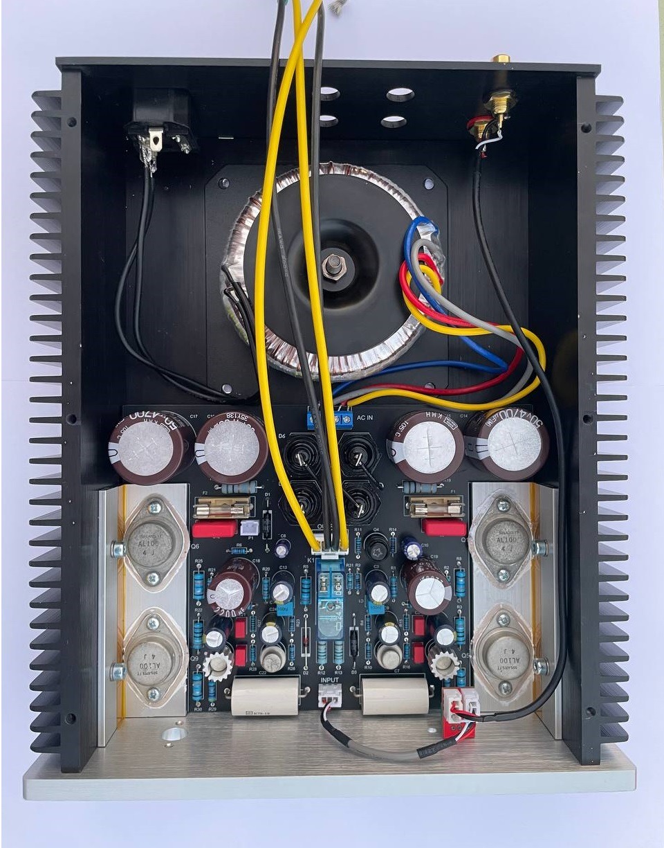

Got the case and assembled the amp for the first try:
I had to put captone on the aluminum angles because transistors were too close to the edge.
First channel worked almost as-is, only had to adjust DC offset on the first transistor. Iq is set to ~0.5A but goes almost up to 1A after 1 hr. Perhaps I need to lower it a bit.
Second channel was a bit more tricky, burned 2 AL100's in the process. There is still something wrong with it, and it looks like second transistor is out of it operating point after the amp heats up. Will continue in next weekends.
And I need to come up with some extender for the power switch 🙂
AL100 are germanium which has a max junction temp of 100C vs 200C for silicon, SOA says at 60C junction temp it can dissipate 25W at 80C 12W.

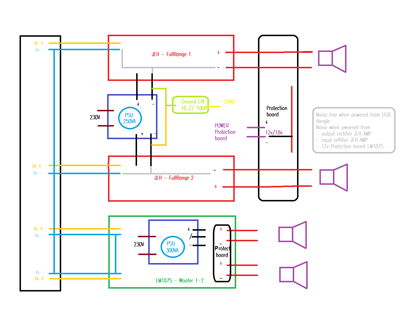

Routing speakers wires directly from the amplifier to the terminals, bypassing the protection boards, still hums.
Removing the input wires, then the humming stops. Ground from the source is shared. Its an 8-channel output board from a DSP module.
When I feed it with a USB 12v adapter from my laptop, the Humm is gone.

I think I find something.
Using the relay board, grounds are connected of both JLH amp boards. Then there is a connection to the ground lift circuit (10 ohm/ 100nF) for both boards.
Without the relay board there is no connection between both grounds apart from the route of the input signal.
I assume this route is not optimal and has some raised resistance.
When I directly link the second board ground to the ground lift circuit, which is connected to the first board, the humming stops. (orange line to the ground lift circuit)
This is without the relay board. (I assume this link is also created by the relay board and the shared ground)
Using the relay board will make a link between its power input and speaker ground which cause the humming.
Next, I connected only the speakers positive side through the relay board and bypassing it on the negative side.
The second amp board is still connected to the ground lift circuit.
powering the relay board from the + - input of the first amplifier board bring it immediately into DC protection.
powering it from the LM1875 protection circuit gives a buzzing sound.

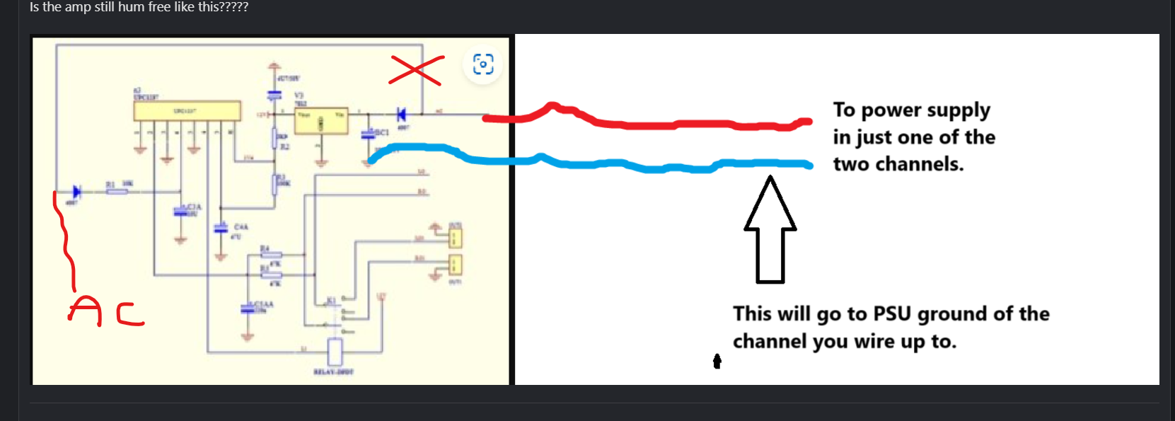

Yes, the connection of the boards via the grounds is most likely the issue but if you follow what I keep outlining that should not happen 🙂 because you are using the board as a delay circuit only and it does not even need to be ground referenced for that.
Think it through... from the position of it all working hum free and then adding the board.
If you hold the relay board in your hand and connect one single wire from the boards negative supply input, which will be ground if you feed it from one of the JLH supplies the amp can not then suddenly start to hum. Get it to that state.
Now connect the positive supply to the board with it still free and not in the amp. It still should all be hum free.
Fix the board in the amp. Still hum free... it should be.
Now just wire the positive speaker feeds only through the relays. That still should be hum free.
Board is hum free if speakers are bypassing the relay board and ground between both boards are connected to the ground lift.Yes, the connection of the boards via the grounds is most likely the issue but if you follow what I keep outlining that should not happen 🙂 because you are using the board as a delay circuit only and it does not even need to be ground referenced for that.

I discovered that one of my crocodile wires is broken...so it probably gave me some false conclusions.

Looking back on the thread did you go from using a 100 ohm resistor on each channel to charge the output cap to using a N/C relay that shorts the output to ground? I think you did.
If you did that then the relays need to have their common connection point separated both from each other and from any ground points in the relay board circuit they connect to. In other words the relay contact pins need to be all isolated from everything and then wired individually wired to each JLH. A sharp craft knife is good for cleanly removing print if needed.

I think I have a decent working amp now. The hum is a bit louder on the JLH board then on the LM1875, but in both cases I need to put my ear next to the speaker to hear it.
I saw that I put a 100 ohm resistor on the ground lift iso an 10 ohm. This cases some hum which took about 1 minute to disappear Most of the test where just power on and off, so I only notice the hum not the fact that it faded out.
Anyway I put a 10 ohm resistor on the ground lift.
3 crocodile wires had a bad connections. This caused many wrong test interpretations. Time to replace them.
I started to replace all connections one by one and see if i got any improvement. I ended with all wires going through the relay board. powered from the input of 1 jlh board (its 25Vdc, the board has an 25v rated input cap after a diode, so its just just.)
The board with 10 ohm ground lift, 10ohm resistor on the NC contact of the relay and both speakers + and - through the protection board seems to work with a slight hum only audible when you put your ear next to the speaker.
The only issue now is that the protection board takes a while to switch off after the power has been cut. The discharge of the power supply capacitors take around 3-5 seconds. Not sure if its going to be any problem.
Thanks for your time and suggestions it helped me to debug and learned a few things on the way.

I'm thinking you could cut this line as shown and connect it to the transformer secondary AC. Untried of course but the theory is sound enough at this point.
