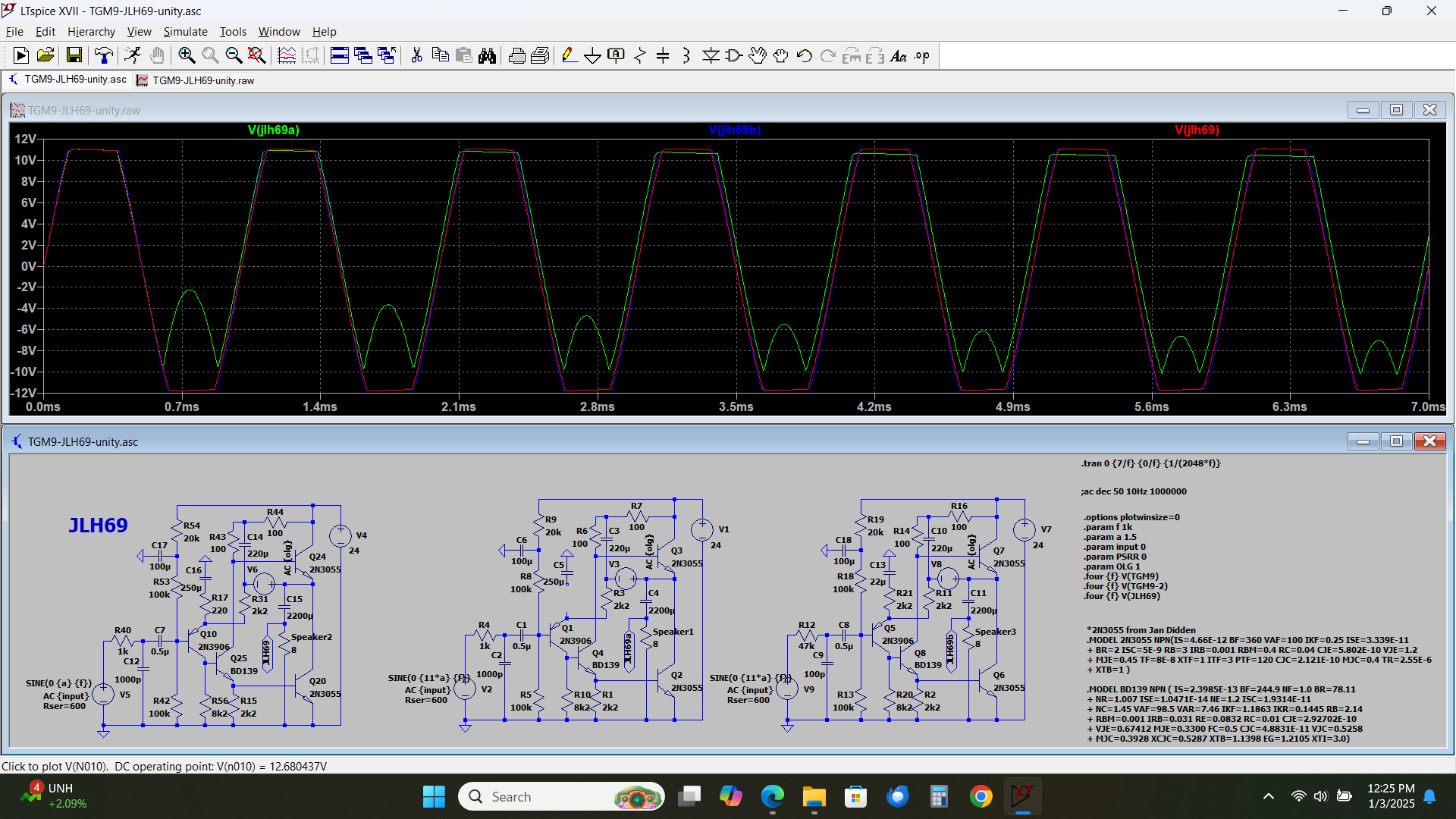

Well, almost. As I suspected, the input does not like high amplitude signals and there is phase inversion when you overdrive the unity gain version. There can be stability issues when you increase feedback but I don't see that in simulation.
Rather than removing the 220 ohms, I wouldsuggest disconnecting the 220 uF and reconnecting it to the output rail so that the 220uF-220 ohm pair are in parallel with the 2.7k feedback resistor. This maintains (nearly) the original open loop gain and will give a correspondingly lower distortion.
Omitting the 220 ohm resistor makes the 2700 ohm resistor the effective input loading, and will reduce the OLG because the input transconductance will now be only 1/2700 A/V instead of 1/220, approximately, as the internal emitter impedance is not included in this estimate.
The polarity of the capacitor will have to be swapped, though, so that it is correctly polarised (positive to the output).
The massive reduction in input stage gm with the 2700 ohm probably accounts for the stability steveu reports.
In my simulations there is some awful switching distortion when overdriving the unity gain option with either approach and the shunted RC version gives a high frequency component in the first few cycles while the unbypassed option gives a large second harmonic switch, but these were without an RC input filter which may help, along with a preamplifier clipping limit.

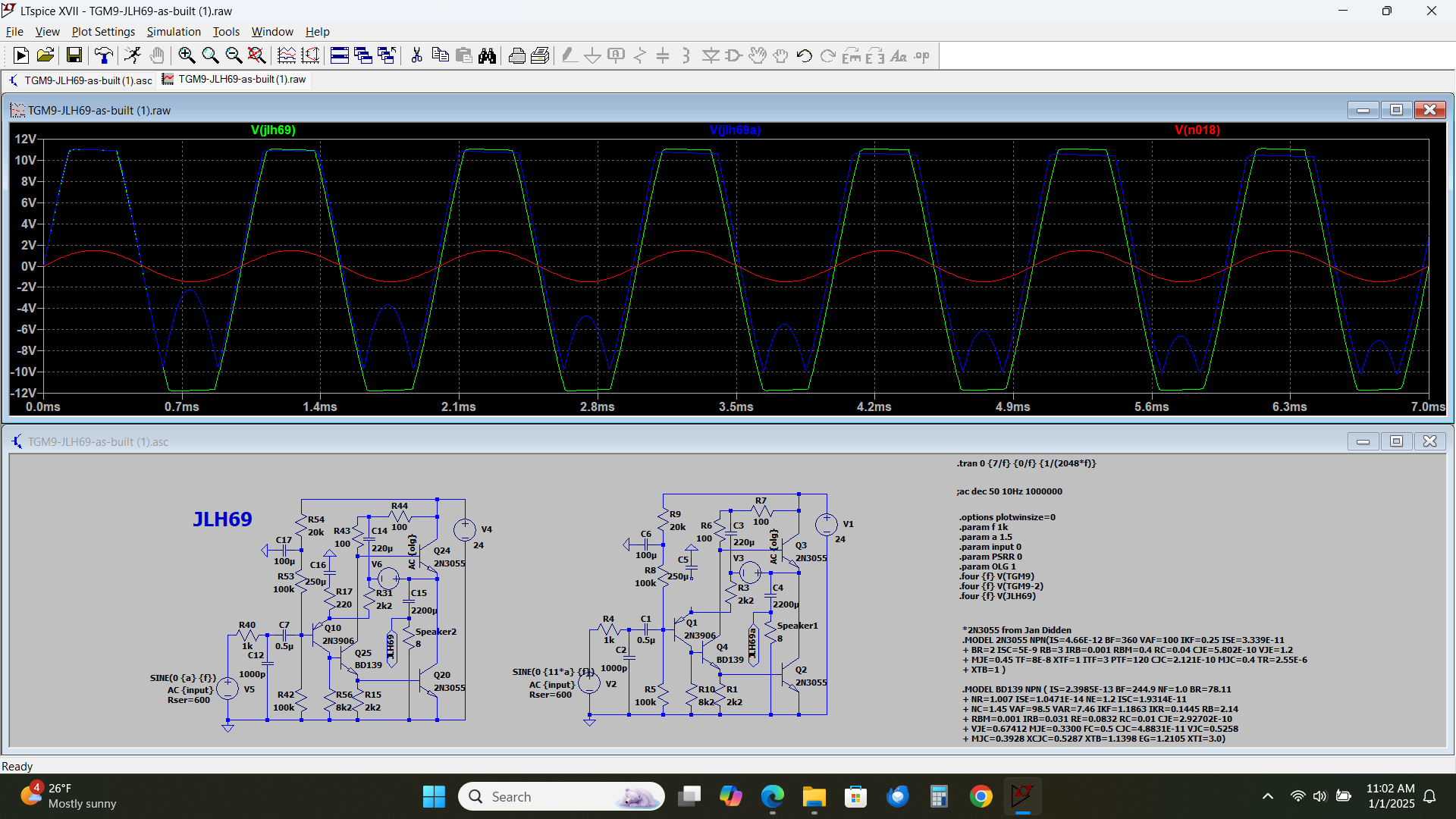

As a postscript to the previous post, the JLH shows some tendency to latchup which is the second harmonic switching I referred to.
This is not unlike the old Class AB with quasi-complementary outputs with a PNP/NPN output pair where the emitter of the pnp was connected to the output rail instead of the "emitter resistor" of the combination.
These effects can be mitigated by suitable current limiting, but I 've not explored this in any great detail for the JLH10.

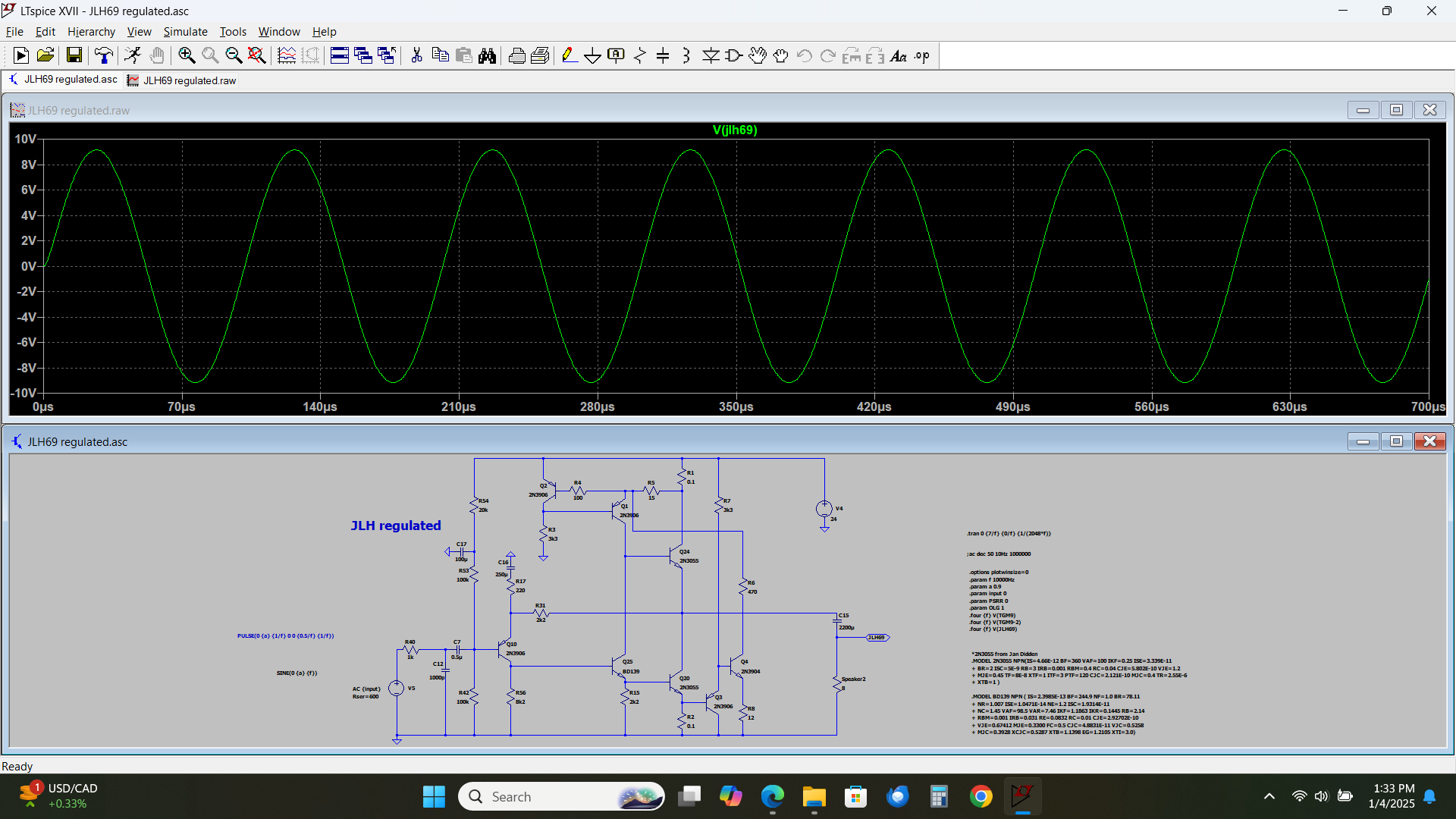

Steve, could you please post your LTspice ASC files to help us lazy wannabe LTspice gurus. I think you have to rename the to *.txt for this forum.Well, almost. As I suspected, the input does not like high amplitude signals and there is phase inversion when you overdrive the unity gain version. There can be stability issues when you increase feedback but I don't see that in simulation.
.asc's are fine to post and can be attached directly.I think you have to rename the to *.txt for this forum
OK. This is based on a post from S. G. Ingram some time ago. I have added a third version which is a net ~unity gain with no phase inversion (initially) by attenuating the input by 1/2 and then 2x gain.Steve, could you please post your LTspice ASC files to help us lazy wannabe LTspice gurus. I think you have to rename the to *.txt for this forum.
THe problem I was seeing with overdrive is due to the PNP current being switched on hard, following the half-period when it has been off.
The emitter voltage takes some time to recover, and in the meantime, in the switching period, a high curent pulse is actually sucked out of the base (this is the negative-going phase) which prevents the output stage being fully driven.A base resistor of 1k reduces this problem, but it seems that the basic circuit is not ideal as a unity gain stage.
With the resistor, as shown in steveu's circuit the overload is mitigated and with normal listening levels should still perform adequately. Whether an input capacitor is also needed is dependent on whether you need it for RF filtering or for slew rate limiting.
Using the series RC feedback ararngement (220 ohm-220u in series, in parallel with 2700) also minimises the effect by allowing the maximum current to increase.
This is perhaps a case for a differential input stage with current mirror and possibly Miller stabilisation - but that would not be a JLH -10W (AKA JLH69).
