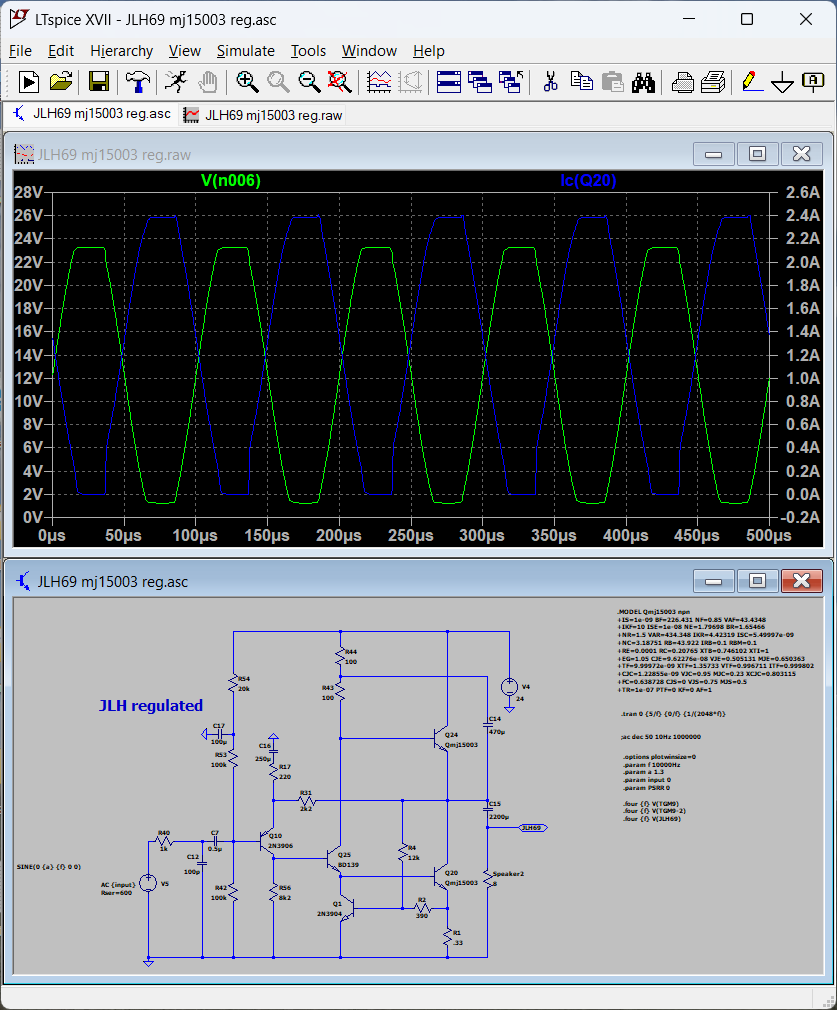

JLH 69 has a couple problems. Firstly, it uses the limited gain of the output transistors to set the idle current and limit the output current. So, using "better" transistors gets you into trouble. But the exact gain of any BJT is unpredictable, so you probably have to fiddle with the pull-up, bootstrap resistors (~100x2) to get an appropriate operating current. And as the OPs heat up, that current increases. 1.4 Amps on a 24V supply is appropriate for a 4 Ohm load (1.4x2x4 ~= 24/2) but it is a bit excessive for 8 Ohms, and the OPs are dissipating 1.4x12 =16.8 Watts each all the time, ie hot. Secondly, the THD will be about 0.1%, although it is largely 2nd harmonic which is a sound many people love.
JLH made some better amps later in life, and the 69 reflects the limited parts options available at that time, 55 years ago. Today, the 10W range is mostly cheap chip-amps, but you can roll your own with a handful of penny transistors. Even if you insist on a class-A amp, there are better options today if you are willing to DIY. Others have tried to tame the JLH69 bias problem. Attached is my cut on that idea:
PS: Note the bias transistors need to be larger due to excessive heat, but you get the idea.

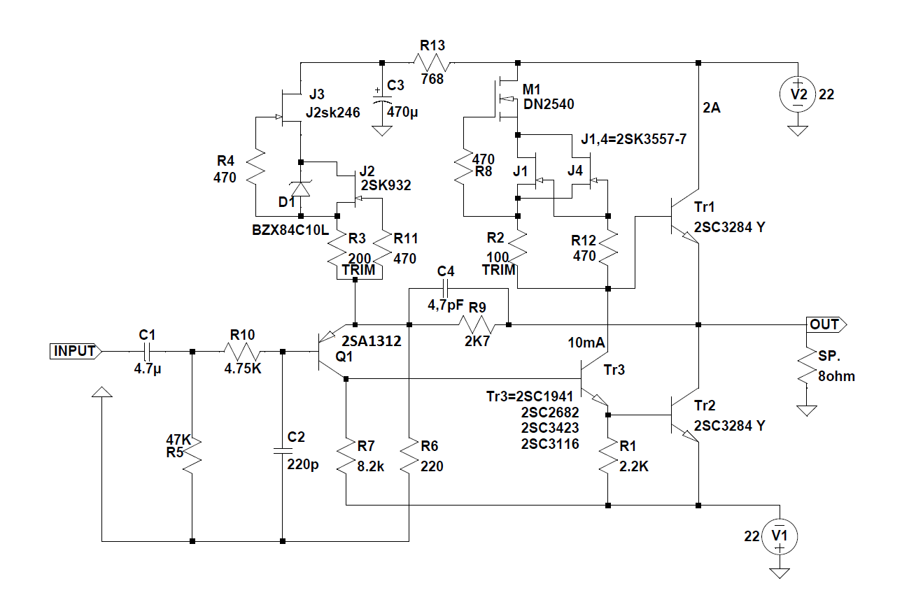

Hi Steveu,
An advices for a better class A diy amp?

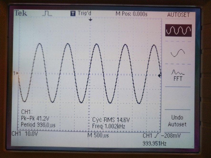

I would not really agree with this, JLH69 can work with high hFE and fT transistors. My version worked very well with 2SC3284 Y, with 2A quiescent current and +/-22V power supply. I have not had any problems with the stability of the amplifier. This version can be further improved with better CCSs.

I actually recommend the use of newer high gain high ft transistors for the JLH. Some great debate a few hundred posts ago about thermal stability though - certainly this option would (in my experience) need a thermal compensation, perhaps along the lines I mentioned which has a temperature dependent current shunt on the driver to progressively reduce the bias current as the heatsink warms. Typically (using 2SC5200's) the Iq started around 1.2A and could reach 1.5A without compensation, even with a generous heatsink. With, it was controlled to within a few tens of mA.
I also found that it required a small compensation capacitor to maintain stability, as grunf shows, but I also kept the bootstrap for maximum positive output.
This certainly gave the best sound (and lowest distortion) from the JLH's I have built.
If people prefer a CCS drive, then I recommend using a higher voltage rail to prevent the voltage compliance limit from limiting the output, but remember that distortion will be increasing due to quasi-saturation near clipping, which you might use as a counter argument to needing a separate higher rail. In my case, I used a higher voltage to offset Q-S with the need for that generous heatsink.

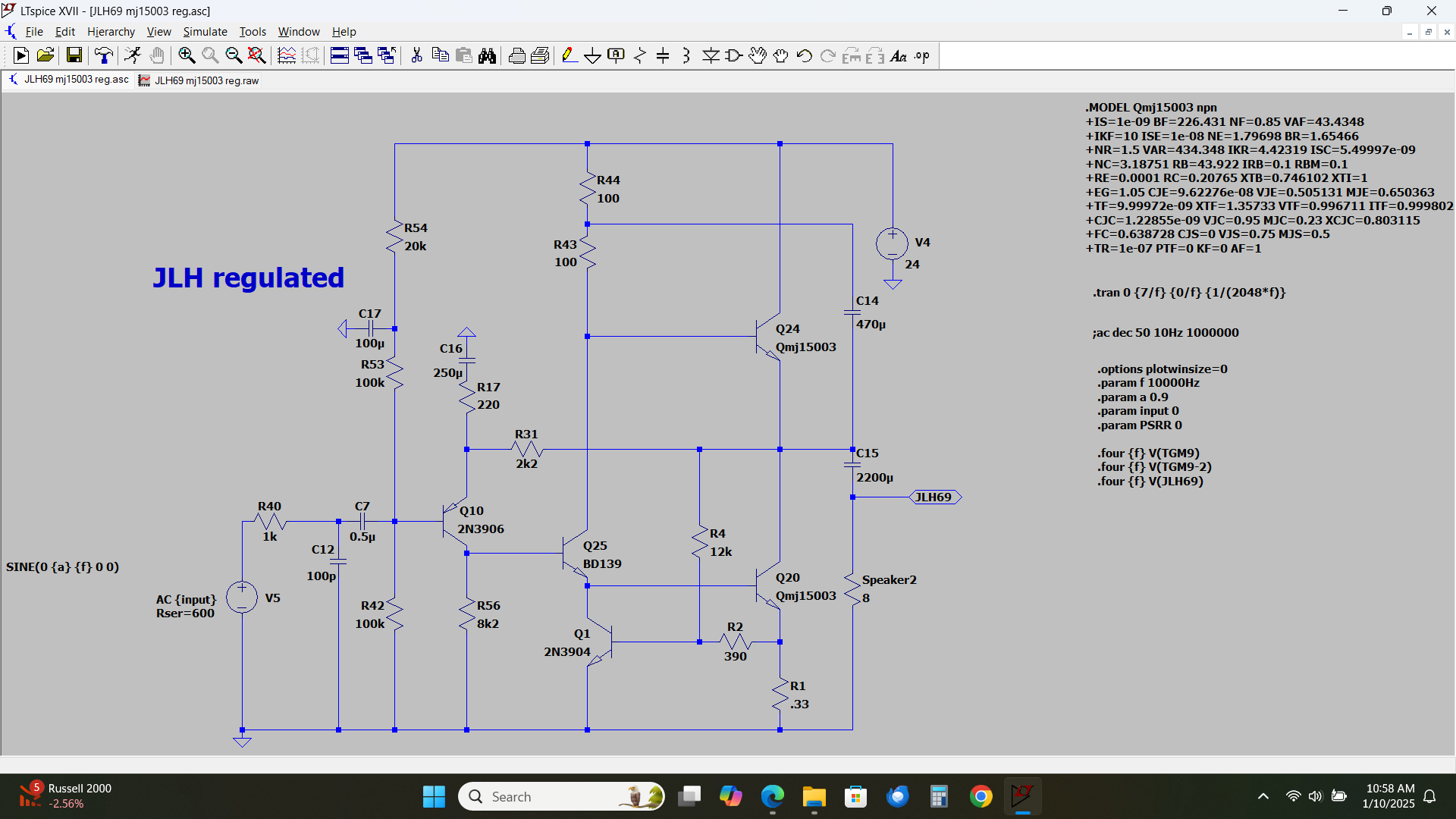

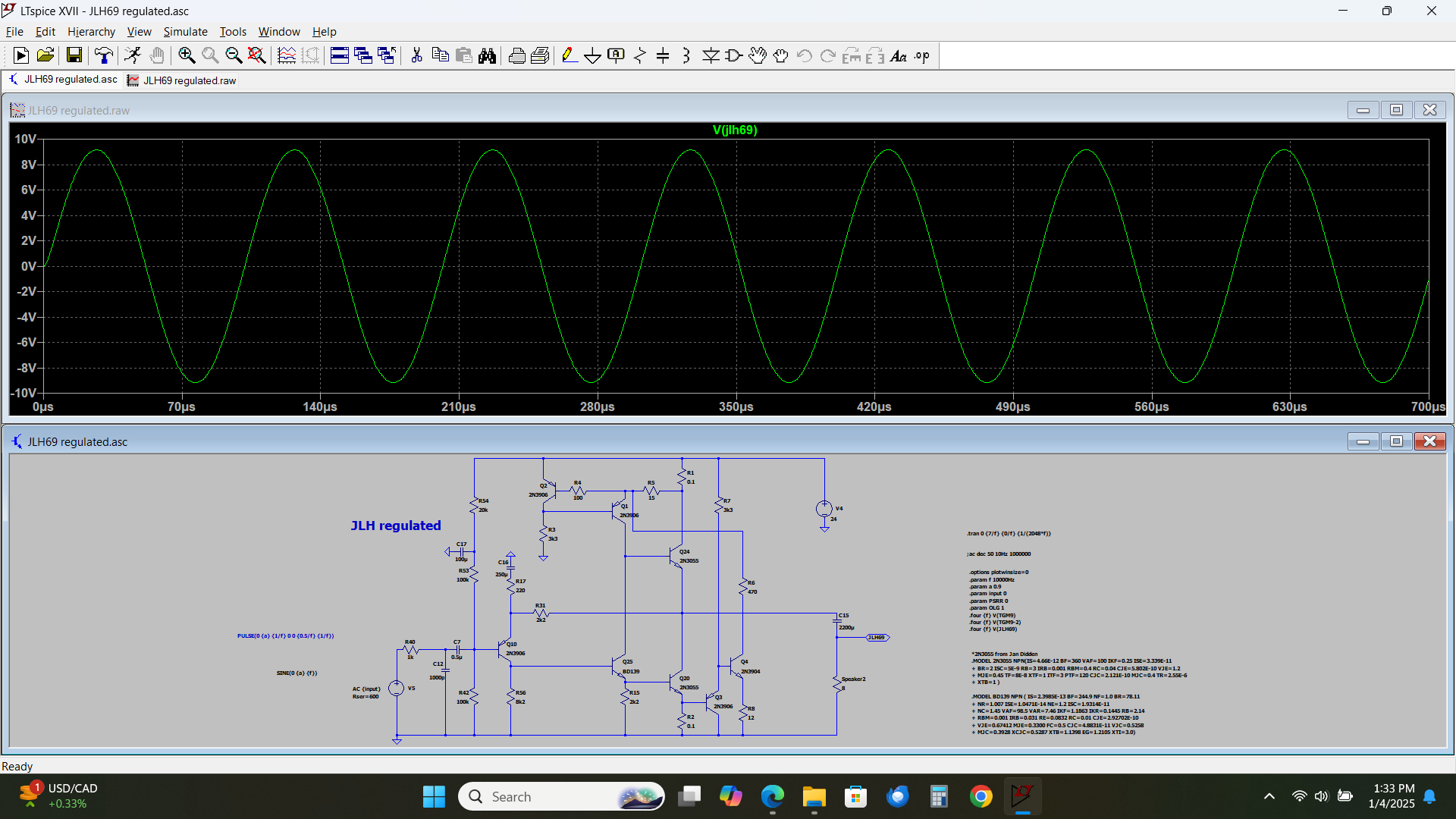

Sure, but you have reduced the VAS current from 27mA to 10mA to compensate for the higher gain OPs. Still, the idle current is defined by the OP gain times that bias current. And the idle current is still temperature dependent. Like others, I initially modified the pull-up to reduce or bias current, but then I realized that is not a great idea. The idle current is actually defined by the lower OP and a 2k2 base resistor is not enough pull-off current for a decent slew rate. So attached is a simulation of an alternate approach that works with a range of OP gain and the idle current is relatively independent of OP temperature.
Have you actually tried this? You've turned the bottom output Q20 into a sorta crappy CCS so the max output will have dropped a LOT compared to the true Class A push pull original.
That's the point of R4. On the negative peak, the "current limit" is about 0.65/0.33 ~=2A while on the positive peak, it's about (0.65-23/12K4 *390)/0.33 ~= nothing. Values were tweaked in simulation, and interestingly the THD is better with no capacitor. OP gain will make a bit of difference but not much. Try the simulation and you will see how it works.
That is an interesting solution - using what would otherwise be a short circuit protection to optimise the current.
It's a similar idea to the one I had where I also used a transistor in your Q1 position, but fed from a temperature sensor on the heatsink.
I also ran the driver current higher, and that helped with slew rate too. Though the highest slew rate I have achieved is with using modern high frequency transistors like 2SC5200/MJL3281A. They may require a small capacitor for stability. Of all the JLH options I have built the HF devices sounded best to me.

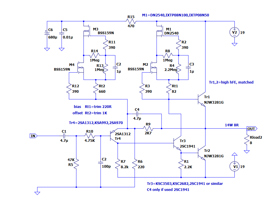

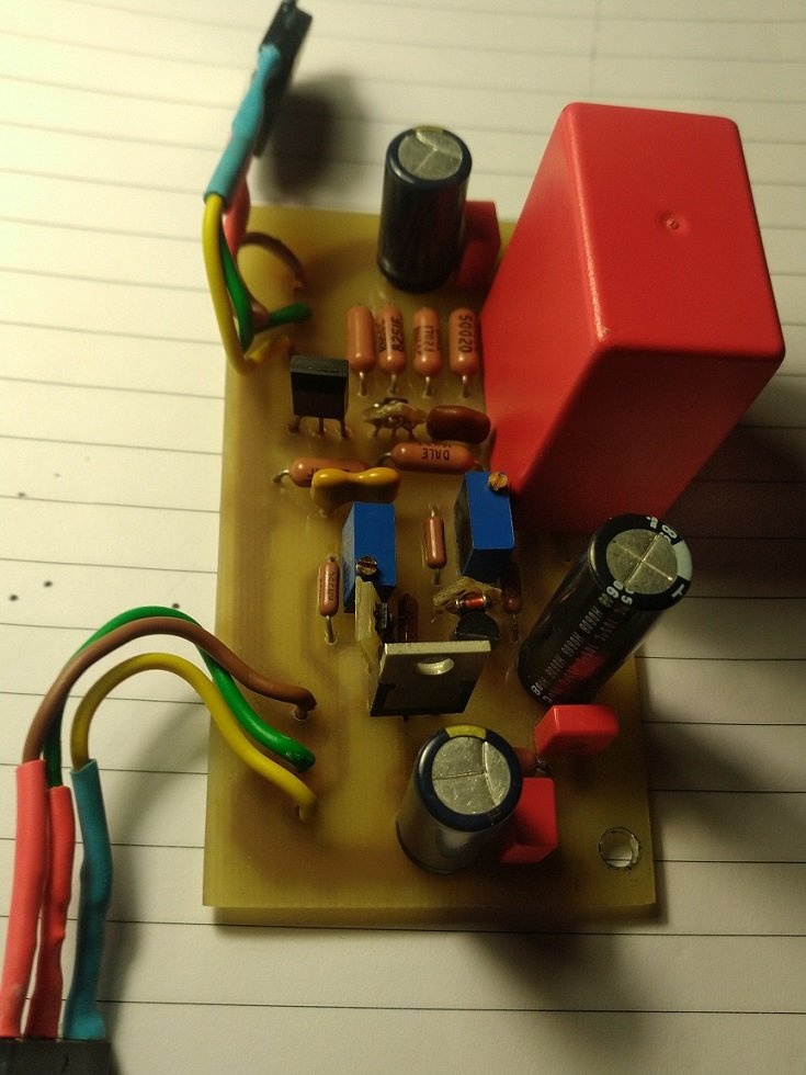

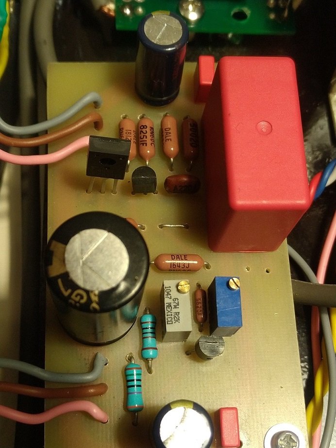

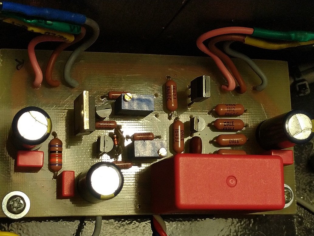

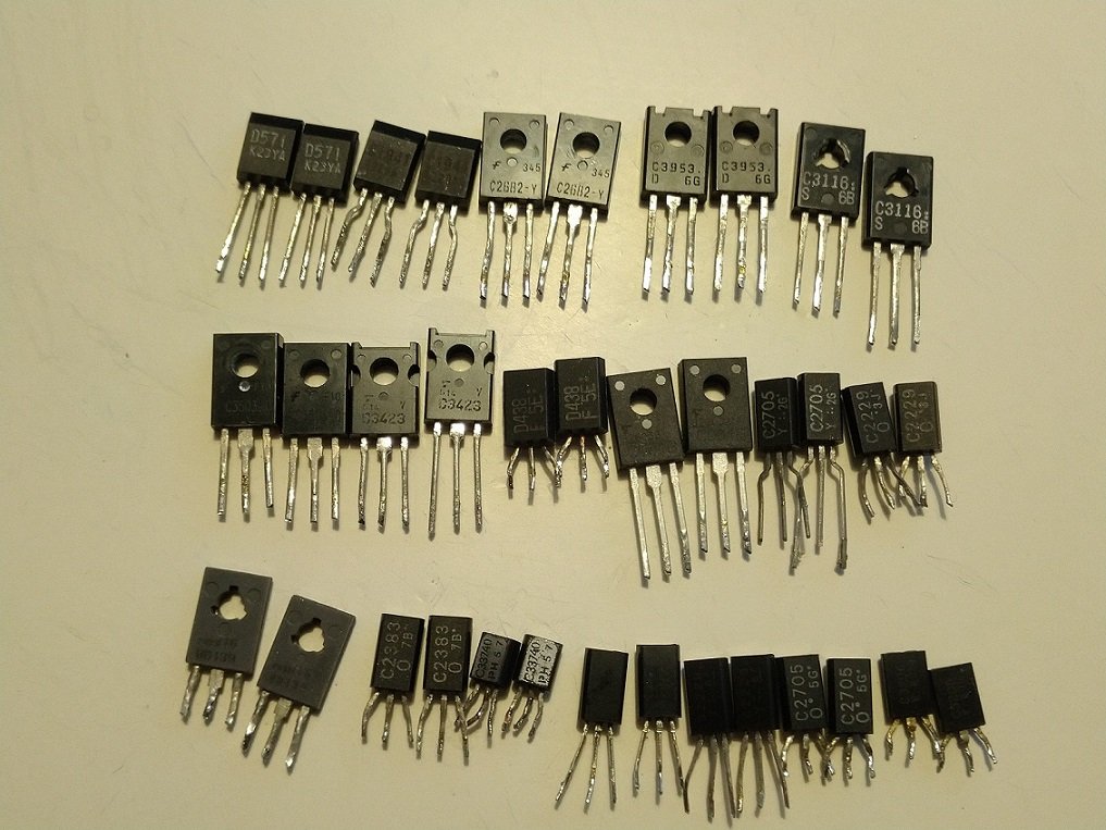

The idea of CCS in JLH69 was presented by JLH himself in one of his articles, as well as the idea for dual power supply. Geoff Moss and I were guided by these ideas, with the difference that my CCSs are made with depletion mosfets and his with bipolar ones. Thermal drift is somewhat smaller in my version, but it is still there, which is a feature of the amplifier itself. That thermal drift never worried me because it is a class A amplifier.
I started from the basic version to get to the CCS with depletion. All with tests, and along the way I tested a bunch of transistors in all positions, of which VAS is the most important because it affects the sound the most. By reducing the current through VAS I got a much wider choice of transistors which in the end turned out to be useful because I could use better transistors. The maximum power I pulled out was almost 26W at 8R with +/-22V.
But the most important thing is the power supply and regulators, it makes a huge difference in the sound, just like the 'VAS' transistor.
