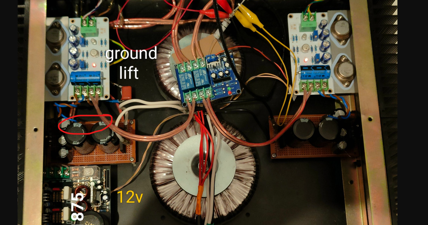

You cut the ground leads to the protection board, that is the supply ground and the input ground and add a resistor in series with each lead. A 0.5 watt more than sufficient as it passes only the relay current.
Thanks @Mooly .

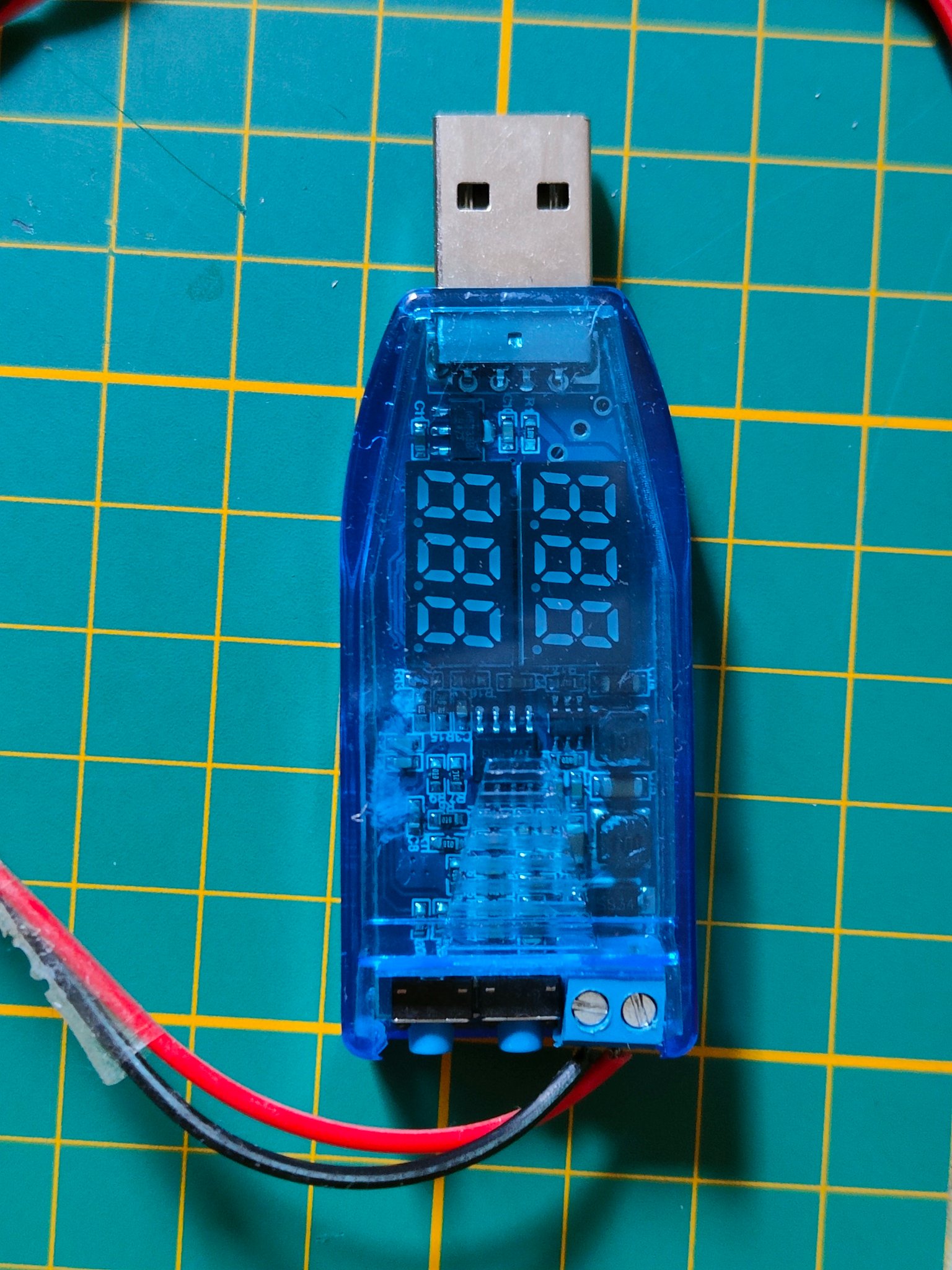

There is some improvement but still not the same level as using the USB 12v dongle.
I also tried 20 ohm but that doesn't change anything compared with 10ohm.

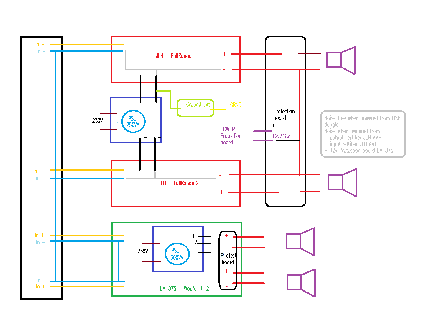

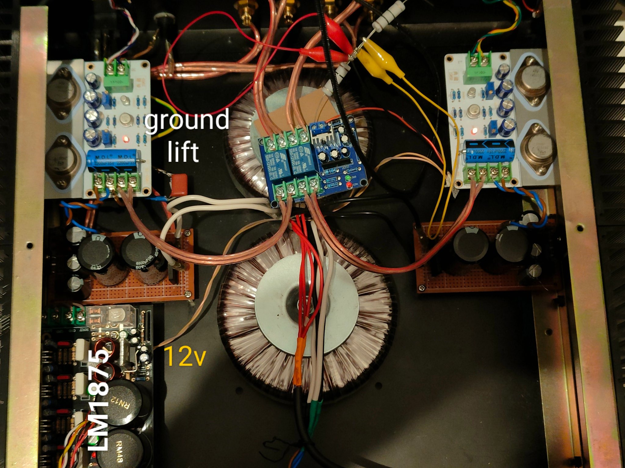

Attached the amplifier.
12v is taken from the LM protection board to feed the jlh separated protection board.
There is a ground lift attached to the negative speaker rail of 1 jlh board.
Input signal ground of the jlh and lm is the same coming from a 3.5 input split into 2 RCAs.
There is continuity between all signal ground from both channels. Input and output.
Also the 12v ground.

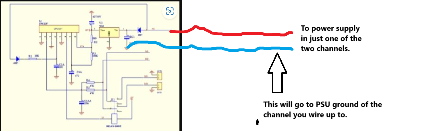

Different idea.... feed the protection board from one supply only in one channel. All I think you are trying to do is get the relay to mute the switch on thump so one supply is all you need. Share the board between the two separate channels with it powered from just one.
Make sure the relay speaker ground terminals for each channel are separate. If you have built the amp as two mono amps then you must end up with NO connection between left and right grounds apart from when you connect it to a preamp or whatever.
Looking back on this. You can not connect voltage rails in parallel if that is what you are doing.But still have some Humm when I connect 12V input of the protection board in parallel with the 12V from an other protection circuit.

@Mooly I thought I did my best to make a good picture 🙂
I disconnected the input cables. The ground between the LM1875 and JLH is not connected.
The ground between both JLH boards is still connected.
Each JLH board has it's own secundary winding and powersupply.
The ground is connected on the protection board though.
edit. The relay speaker grounds are connected as well with the ground that feeds the board.

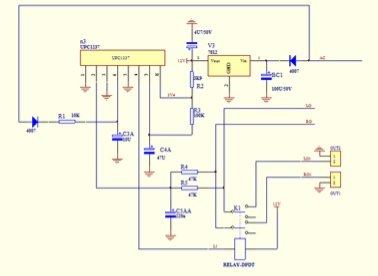

What I can't see is how the power ground is connected to the speaker ground.
There is no trace on the bottom of the board. I have to desolder components to see how the traces run on the top.
With my multimeter I checked a few.
The attached scheme resemble quiet well the board.

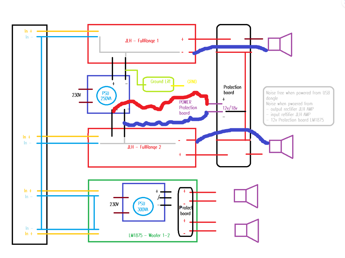

Did you work methodically through the 6 points I listed above ? All you are doing is connecting the wires one at a time if you work through those 🙂
The picture you show implies a common speaker ground and your two separate amps should not have that. I agree no separate PSU ground is shown. Maybe as drawn it uses the speaker ground connection/s (well it would have to as drawn).
Begin by wiring just this and nothing else.
Is the amp still hum free like this?????
So the drawing just above should not have any mechanism to introduce hum. Are you 100 % sure that the delay board is 100% isolated from the chassis (and so any ground routes) and that there are just those two wires connected?
All that is doing is adding the small load of the board to the power supply but with no possible route into the signal path.
We might have a couple of different ways of doing this... so this is trail and error...
Is the ground return wire going back to the power supply? Do not connect this ground to any point on the amplifier boards. So the ground wire should go here (circled in red) which is the negative end of the big reservoir caps.
Try connecting just that one wire to begin with and make sure it is hum free.
Where are you connecting the power supply input to your board to. Are you connecting it to the plus rail supplying the JLH or are you feeding it AC direct from from the transformer?
Lets now connect the supply input to the board to the plus rail which would be the plus end of the big caps. That feeds the board around 27 volts DC from memory for a JLH.
Is it still hum free?
Does the relay operate correctly (click in and out) with the correct delay?
The other option we have is to wire the board direct to the AC from the transformer. Lets try the above option first. As long as the relay operates OK it should work. All you want is the delay, there is no point adding the offset sensing because the JLH69 is cap coupled and can not generate an offset across the speaker.

You need to configure it like this as a start. Note all the connections that have been erased.
1. You apply power to the board.
2. You route only the speaker + connection through the board (and so through the relay).
3. The speaker negative feeds bypass the board completely.
You haven't shown the supply to the board but based on what you posted before with the board having a 7812 reg you can connect it to the 27v supply of the JLH. Make sure any caps before the reg are rated at higher than the supply voltage applied.
Try it like that and see where that gets you.

I connected it like you mentioned in the the drawing above.
It is worse then when negative speaker wires goes through the board.
Really strange as I felt it would minimal improve the situation but it didn't.
I tried powering the board directly from the 12v from the lm-board.
Also from the DC input from the jlh.
