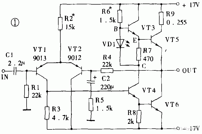

Diode...Resistor 100 ohm (DoZ)massive reverse bias on its base.

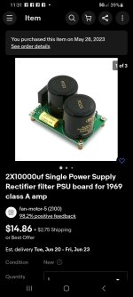

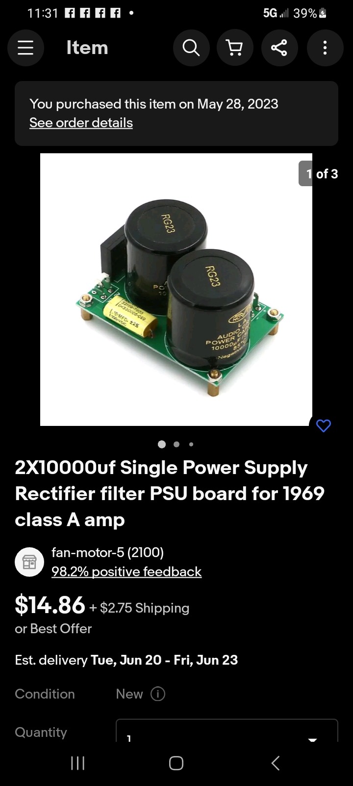

Hello fellow DIYers. Recently my wife said I needed a hobby, and know I used to be into car audio thought I'd like to get back into it, but for the home. So she got me the JLH1969 with the 3055s from Ebay. Pretty cool. I bought a toroidal from Antek (20v x2 @5A per coil) and the recommended psu module for the amp from Ebay also. My question is after that 20vac gets changed to dc (20vac x 1.414= 28.3 or higher with no load) is this too high a voltage? Should I get an 18vac x 2? I don't want to ruin anything. Sorry for an absolute noob question but we all have to start somewhere.
Yes, obvious but no-one has said this before in a JLH as far as I know.Diode...Resistor 100 ohm (DoZ)
Question: where to put?
In series with the base? No- because it will have a high impedance and disconnect the transistor when turning off (not fast).
Add capacitor? - critical value so as not to exceed reverse bias but possible.
In parallel? No- because then the driver transistor shunts the current. Possibly blows the driver.
Actually with my series resistor in the base that would work. It allows the negative slew rate to be quick (I already tried this in sim) and the resistor limits the current. Perhaps that was the resistor you were thinking of?
Then you have the problem that the negative slew is faster than the positive (pulse of current in the driver, switches lower output device on rapidly.). So now the positive slew needs to be raised ...
when to stop modding?
I take it you have a meter? Using one coil you will get 28V plus an overhead due to the winding resistance set by the transformer designer. That is countered by the voltage drop across the bridge rectifier you need. If you have a single channel as you appear to, the ripple voltage will be 2 or 3V so to power the amp you need to run the amp at least at the ripple voltage below, so that means your amp would probably have to run at 23 or 24V, if the power supply capacitor is 5mF as JLH specified. With your higher current transformer (5A) a larger capacitor is possible and will reduce the ripple.cms1112..
Make sure you have the circuit diagram for the PSU and check the value of the main capacitor.
You might find that you don't have enough volts. JLH recommended a 30V transformer (45V rectified) but unfortunately putting your 2x20V in series will be too high. (Unless you run 15 ohm speakers).
A 20V transformer was recommended for 4 ohm loads, so if that is what you plan to use you should be OK.
Diode parallel to junction (reverse).In parallel?
Zener.
Thank you John. I don't have schematics or diagrams for the psu. But the pics are what were ordered. And my speakers are Dayton B652-AIRs. 6ohms for the drivers. I'm guessing that's ok.I take it you have a meter? Using one coil you will get 28V plus an overhead due to the winding resistance set by the transformer designer. That is countered by the voltage drop across the bridge rectifier you need. If you have a single channel as you appear to, the ripple voltage will be 2 or 3V so to power the amp you need to run the amp at least at the ripple voltage below, so that means your amp would probably have to run at 23 or 24V, if the power supply capacitor is 5mF as JLH specified. With your higher current transformer (5A) a larger capacitor is possible and will reduce the ripple.
