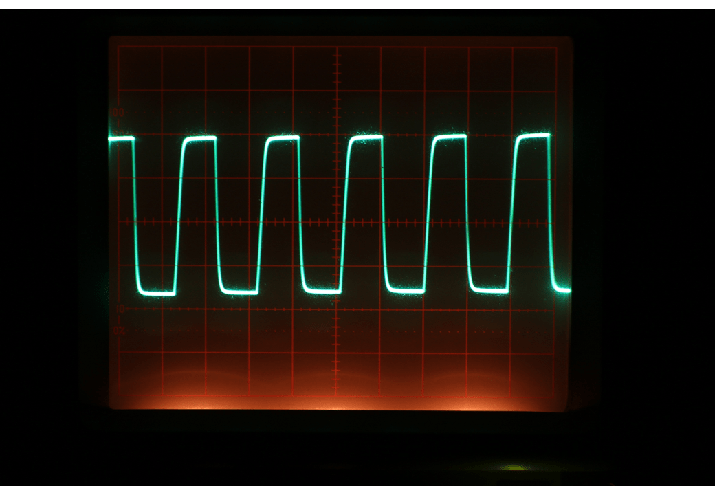

So I took an old JLH build and set it up with 2SC5200's in the circuit I posted (#9070 back in 454).
First results (with some minor changes to the components) - bandwidth <6Hz-300kHz.
Stable into inductive and resistive loads.
example square wave at 50kHz into resistive load attached.
Really seems that Bode and Tian can show stability. But if anyone does try this and finds some problems I'd be interested to hear.
Changes: base resistors 47 ohms (was 22)
PNP input shunt: 220pF, 47 ohm resistor omitted as showed little effect in simulation.
Output capacitor only 6.8mF as was used when first built.
Measured without the output inductor. May need this for capacitive loads.

...and some distortion figures:
1kHz 1W 2nd .029% 3rd .004%
8W 2nd .08% 3rd .02%
20kHz 1W 2nd .025% 3rd .006%
8W 2nd .075% 3rd .06%
Note that with the base resistors the output is limited and the circuit needs a 32V supply to achieve 10W output (higher dissipation!)
The PSU I used for testing had a 30V limit, and at 9V rms the distortion increased - evidence of clipping. Load was 7.5 ohms (which also needs a higher current).
Not sure why 1kHz is slightly worse than 20kHz but I haven't calibrated my LDO for ages. But as expected I think for a JLH.
If you want lower distortion it will need some additional modifications.

veysel - hope your kit works. In my testing the PSU I had was limited at 30V and 2A, so any short term current over 2A caused a limit (which may have also been a problem for measuring at full power (10W) - I need to look into that.)
It does concern me that the JLH PSU is only a capacitor multiplier. If that is the PSU circuit you are using it may not provide as good a regulation as expected. JLH specified 5mF in his original circuit and ran it from a 30V transformer. The ripple voltage on a 2.4A load is about 5V, and if your amplifier is to run down to 20Hz or lower then it needs a PSU which can provide double the standing current for at least the peak of the low frequencies. (The PSU current is not constant as some may think as the upper transistor current varies with the signal and therefore demands a varying current from the PSU with a signal).
I would have recommended JLH to have used a more standard PSU. With just 2 more transistors he could have got better stabilisation and lower ripple!
Also, I very much doubt that your kit will be using the frequency compensation I have suggested. Would you have the circuit for your kit?
