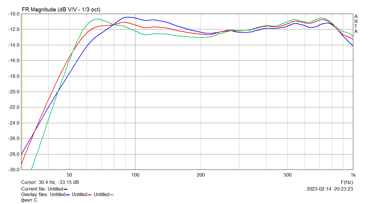

I already use it for fullrange but it is bass assisted fullrange and 140uF caps make 284Hz cutoff frequency. Below 284Hz bass speakers will play. No i will not parallel film caps with elko. I will only use film caps for fullranges(wideranges).I am already using with passive line level crossover (pllxo) It needs 4 channel amp.
Yes i agree Jlh may not be enough for bass speakers for deep bass like 30Hz.
