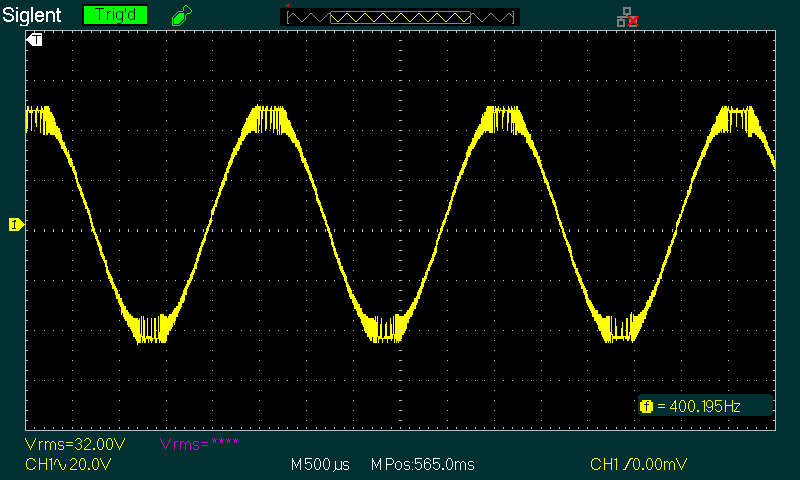

I particularly like this picture - I once built a "perfect" AB op-amp which did something similar
One of the great joys of the JLH 69 is its behaviour when clipped (and with most real music(tm) and speakers, your amplifier will clip at "realistic" levels)
Much of the value of oscilloscope trace views and any serious testing that involves graphic displays, is related to the use of similar gear and test conditions. Would it be possible to post a 'scope trace view of your JLH'69 (or similar) amplifier when it's similarly clipping, for comparison?I particularly like this picture - I once built a "perfect" AB op-amp which did something similar...........

I don't know if I have one. I'll dig. Maybe I'll need to go make oneMuch of the value of oscilloscope trace views and any serious testing that involves graphic displays, is related to the use of similar gear and test conditions. Would it be possible to post a 'scope trace view of your JLH'69 (or similar) amplifier when it's similarly clipping, for comparison?
But I know that it won't have the oscillation artifacts. Nor will it have the harder-to-see internal bias upset common to high-gain/high-feedback designs. (Last one I scoped out showed lower gain and sulked back into class B until the bias recovered). Nor Class AB rail-recharge induced intermodulation

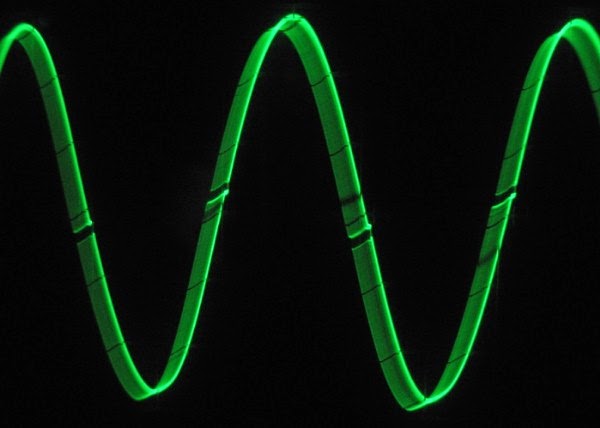

For those new to these concepts, some pictures from around the web. All of these are pretty extreme but they (hopefully) do explain some of the concepts.
Basic soft vs hard clipping (listeningpost.co.nz) concept drawing
Assymetric, soft clipping (one of mine)
Class B cross over notch (PS Audio)

Really bad oscillation in an marginally stable amplifier driving an unsuitable load (stack exchange)

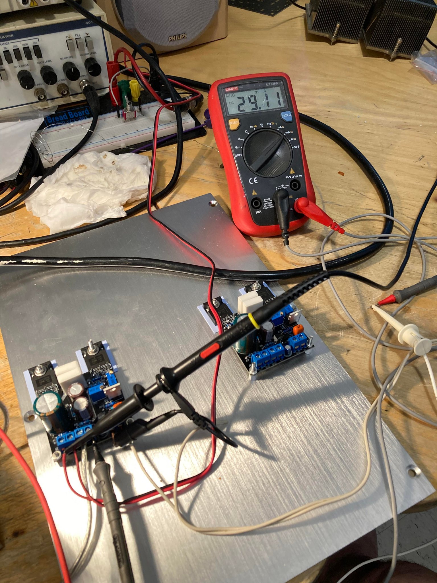

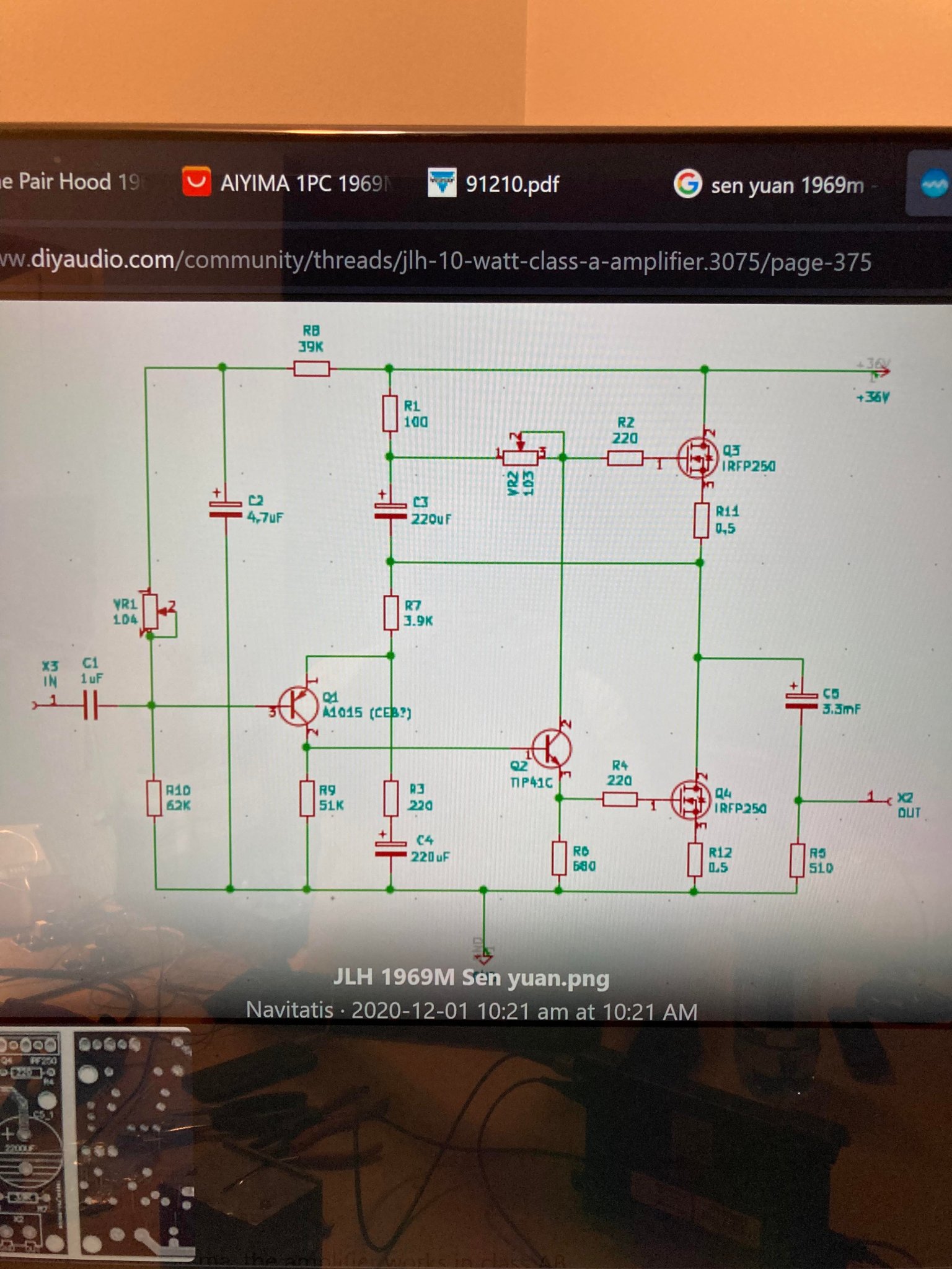

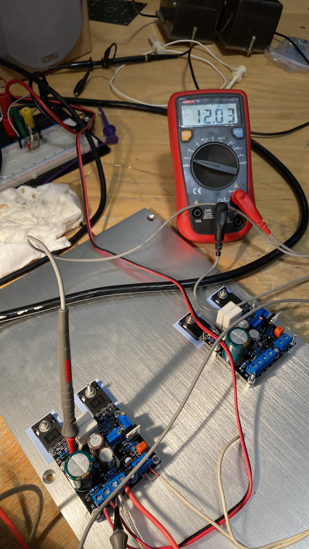

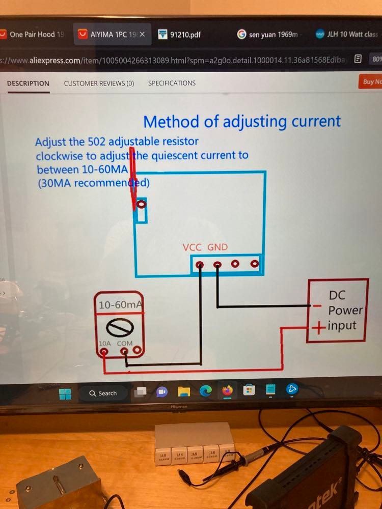

I got my Sen Yuan Chi-Fi JLH 1969M "MOSFET" IRFP250N Boards today and set them up, I dont know if i'm doing it right but I set the idle bias current to 30mA using VR2 per the directions in the photo and then I disconnected meter and adjusted VR1 for 1/2VCC at the postive pole of output cap (12V). I am using 24vDC SMPS. I My heatsink plate barely getting warm with one channel after an hour so I am wondering if something is wrong. Any suggestions? Sound is not bad but a little bass heavy.
The quiescent current of your amplifier is class AB. Moreover, for MOSFETs, a current of 150-300 mA (AB) is recommended. To work in class A, you need to set the current above 1A (depending on the impedance of the speaker) #8635. This will require a large area heatsink. Lift the aluminum sheet off the table surface.

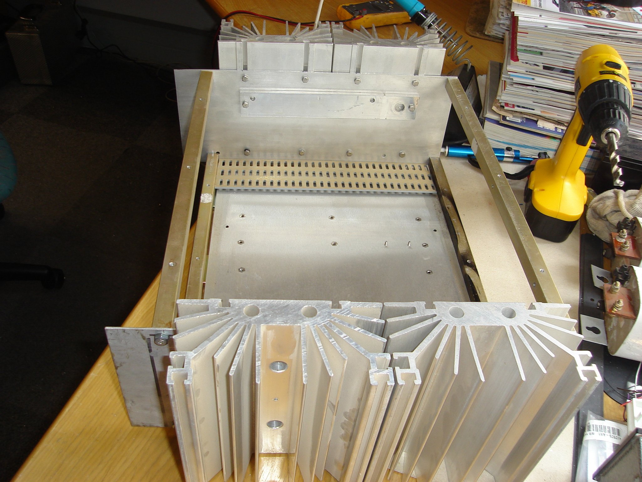

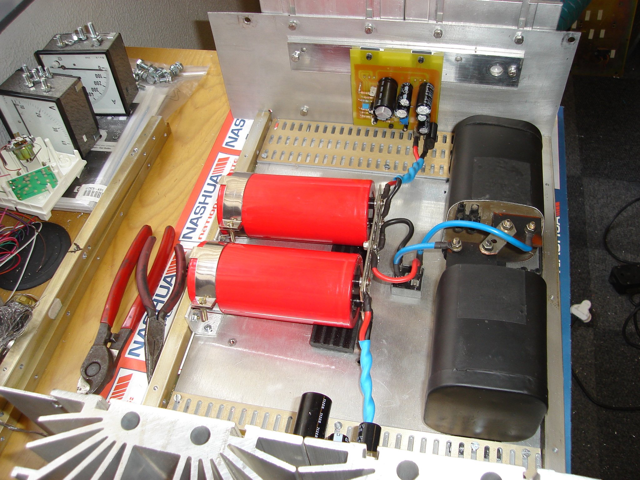

My JLH 1969 (10W) CLASS A monoblock, I set the BIAS in 2A!
See my tests (BIAS show in 12min):
