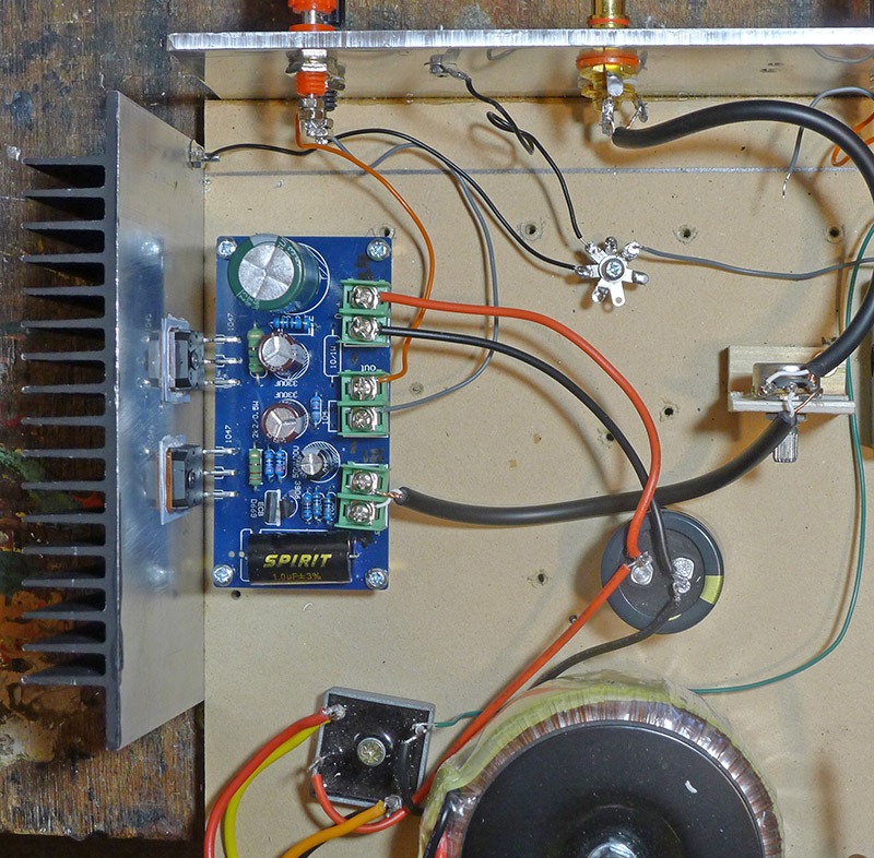

Hello all,
I would be most grateful for some help with my JLH 1969 hum.

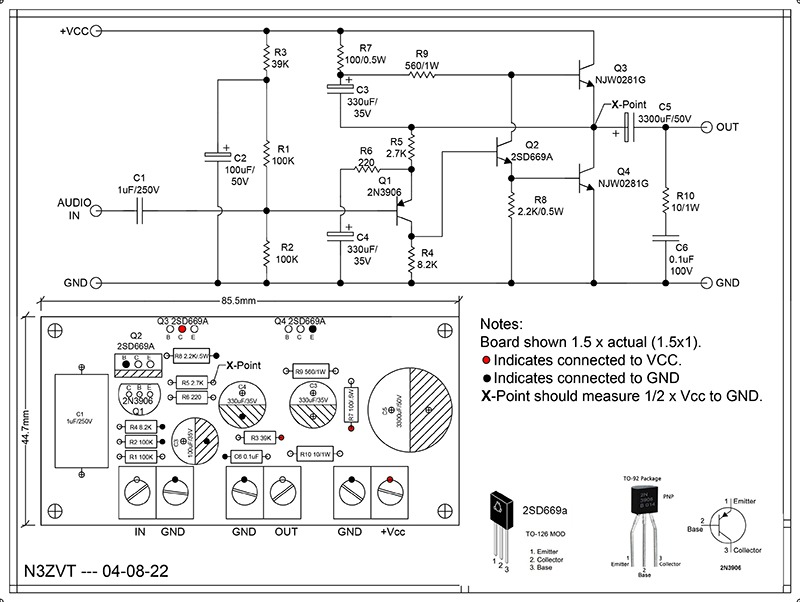

Having watched Steve Wagner's instrument test of this board I decided to make one myself.
This is it on what has become my test bed
And here is Steve's drawing of the board and the circuit.
I switched on to check the 1/2 at 14.5 volts that was OK the quiescent current is set at 1.2 Amps and I am using an FH3 with the 4ohm CHP-70 original.
With and without an input the hum becomes louder as I turn the pot up and sounds like mains hum. I've taken the ground from the input and from the pot, the input, and the front panel to the star and from there to the earth on the IEC connector. All the ground connections on the board are connected to each other.
I do hope someone can see what I have done wrong from looking at the pics.
Cheers - J

That sounds a little worrying. If the input impedance changes the hum it suggests that your amplifier might be oscillating. The frequency response of the input stage will be affected by an impedance, and normally a low impedance (volme at zero) should give no or minimal hum. But that also would give the highest frequency response and it could be that the oscillations are causing excess ripple on the power line. I note that you have NJW0281's which may require small frequency compensation capacitors to stop oscillation.
Are there any power line decoupling capacitors on the PCB? I don't see any, and your leads from the PSU PCB could be jsut long enough to generate unwanted inductance. Especially with HF transistors I would have put something like 100uF-1mF on the PCB next to the collector of the upper output transitor to ground.
Also twist the output lead pair, and the power supply feed pair to keep the inductance formed from rather haphazard loops low.

Hello John,
Nice of you to make a comment and with such comprehensive advice. The output transistors in my kit are 2SD1047. I think C2 on the diagram is a decoupling one. I do have a Oscilloscope a little plastic one that I assembled from a kit to check the output from some oscillators I made it's a DSO138 from Aliexpress. I will have a go at twisting some wires if the new pot does nothing. and report back soon.
Mr Wagner is in the USA his kit with the NJW0281's came in a box, his YT instrument test of the kit can be seen here, apologies I should have put that in my original post

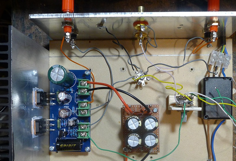

Hello all,
I must thank you all again for your excellent advice, very well done indeed.
From the top down, the star is now only for the metal panel/heatsink ground and straight to the mains Earth wire
I found some old shielded wire studio flash firing cable and used that to the pot and from the pot to the board, I've ordered some more but in 3.0mm diameter.
The ground connection is from the power return and to the mains Earth from the Negative pin of the bridge rectifier.
I halved the input voltage to from 24 Volts to 12 Volts just to see if it would work, with the odd result that the volume rises much faster than it did with 24 Volts.
My speakers are FH3's with CHP-70 4 Ohm originals and are rated at 85 db.
Ohh and the hum, back to sticking ones ear'ole right up against the speaker cone to hear a minute hum.
I will be doing my switched test with the JLH and my 3886, I'll let you know the result.

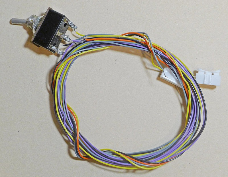

This is the cable I used to switch the inputs from one amp to the other

That's plain, insulated wire. Unless some ever-present hum and/or noise level in your audio is OK, all audio signal connections over any distance between the board and controls, in/out connectors etc. are best made with grounded, shielded cable - the shorter the run and the further from AC power wiring and transformer, the better. Sometimes, you can also cause hum loops this way when you couple ground between circuits multiple times but unless you have specific advice about connections to your gear, its simpler to begin with using the cable. Its not hard to disconnect the braided shield wire at one end if it causes a definite problem.
If you are looking for suitable cable, most homes will already have an unused stereo connector lead or even an AV lead that likely contains suitable shielded wire. Why buy new and over-priced bits and pieces when you already have suitable materials lying unused, in a drawer or storage box somewhere around?
