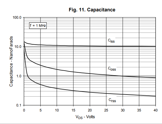

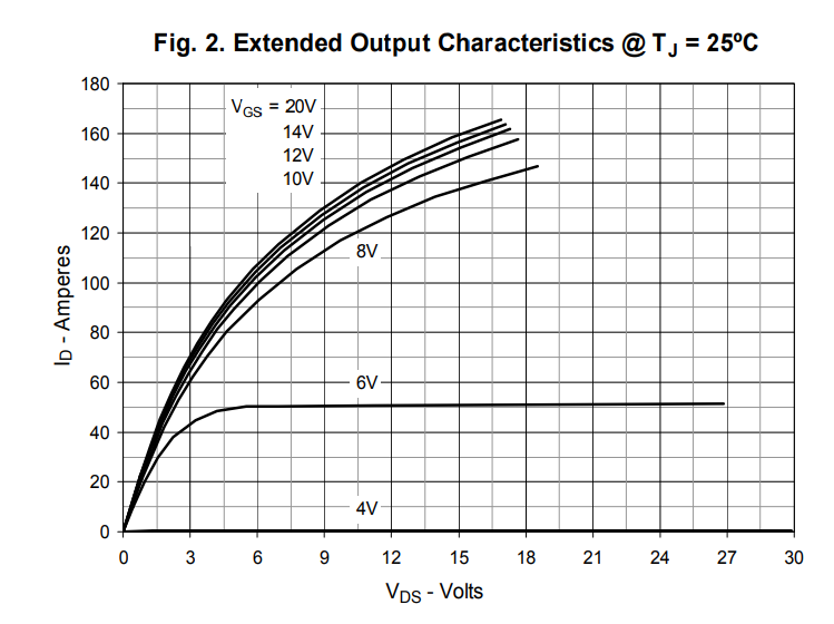

Power Mosfet.Here are some modern (introduced 2011) power transistors which are specifically designed to implement constant current electronic loads: (link)

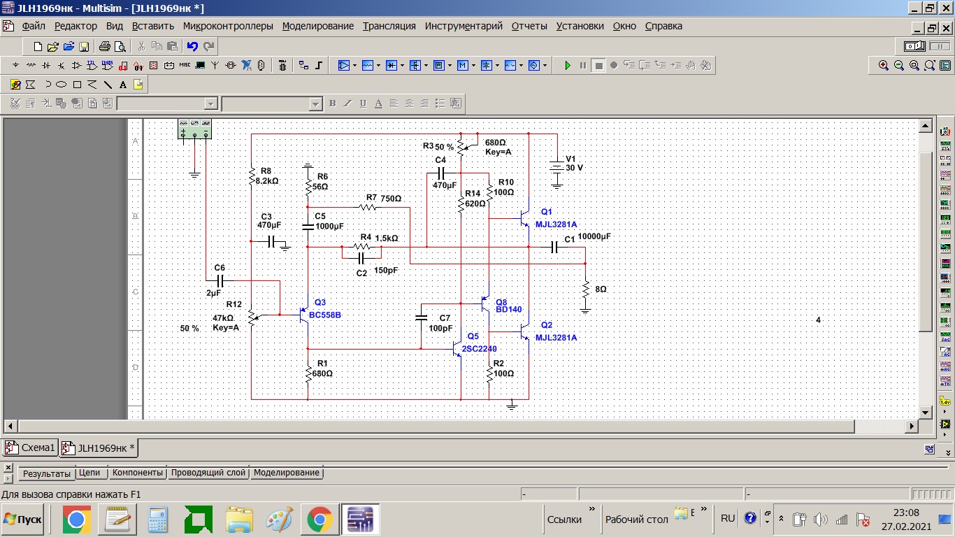

Has anyone used a complimentary feedback pair as a JLH VAS/ Phase splitter? It could have similar DC points whilst being more linear. Current drive should be good. I tried this with another amplifier with few problems! I think using a local feedback capacitor helped ( 33 pF )

Harmonic distortions are reduced if you use an additional OE amplification stage Vas and an inverted phase splitter pnp (like in Brosky / Nikitin).

In a 1969 amplifier, you can reduce the collector voltage of the input transistor by dividing the pull-up resistor by two.
The top one can be shunted with a boost capacitor.
The noise can be reduced.
