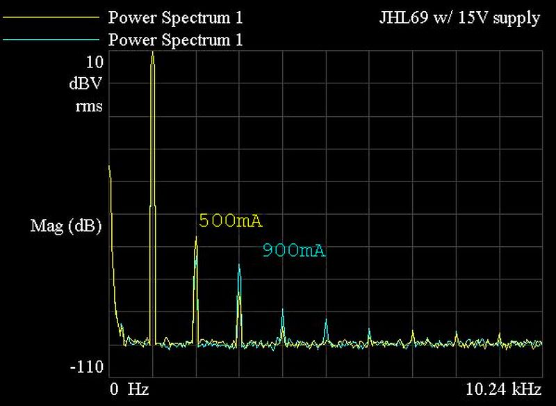

I ran distortion curves last night, +10dBV into 20 Ohms. At 500mA static current, H2 was -74dB, H3 was -90. Increasing current to 900mA lowered H2 to -79 but raised H3 to -81 and brought higher harmonics out.
Not great resuts. There's a ground loop I need to fix, that should improves things some. Also the bench power supply I'm using has high-ish output impedance, 3mVRMS of ripple at the test freq appears on the rail. I'll try another one.

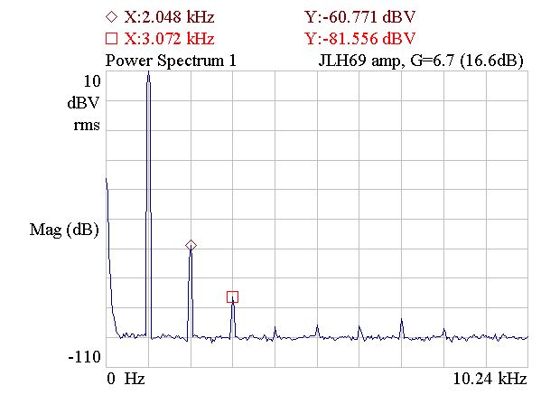

Lowering the gain is worthwhile. With feedback shunt R of 470 Ohms, Gain=6.7, about half the stock setup. Attached is distortion at 1K and +10dBV. With 500mA static current, compared to stock, distortion is lower by 2.5dB at H2, and 2.9dB at H3. Transient response shows no significant difference. Noise is lower as well, but I didn't measure the difference. I see no signs of instability.
Good news for folks who want to go directly from say a DAC output to amp input.

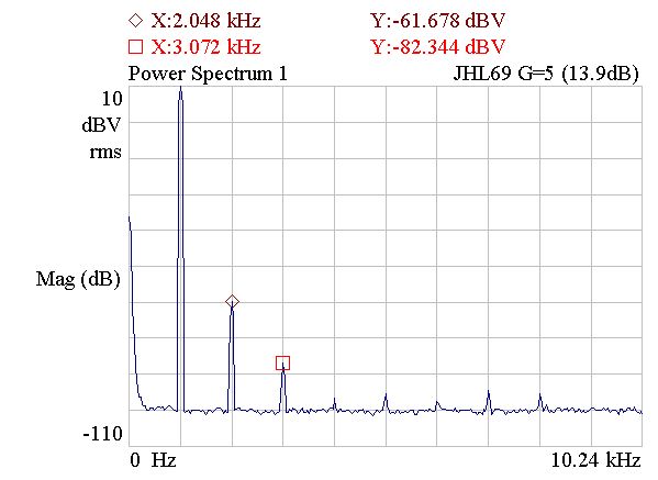

Some more interesting results. Same setup as previous except where noted.
First is with gain of 5. H2 and H3 drop about a dB from G=6.7.

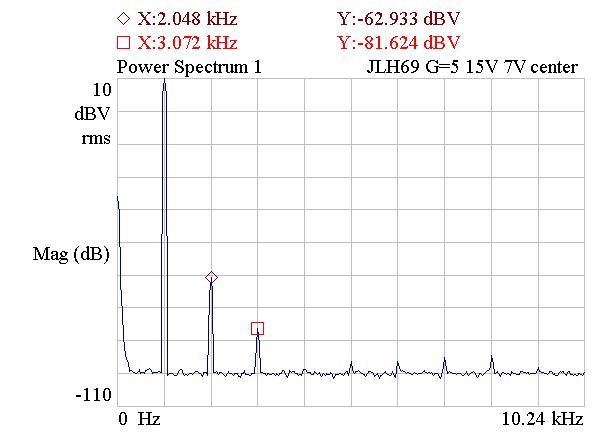

Second is with the output center point set to 7V. H2 drops 1.5dB, H3 is up a dB.

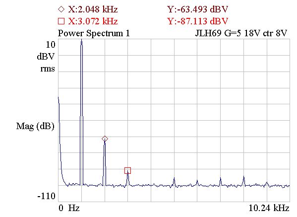

Third is with 18V supply, 620mA static current, 8V center point. H2 drops another db, H3 drops 6dB.
Question: when the distortion drops by changing the output center point does this suggest that the output pair beta are not well matched?

The center point does not necessarily represent the minimum distortion at a level close to clipping. Rather a guideline for simple setup without measurements 🙂

Understood, and I appreciate your reply. But the reason I'm building headroom into the system is precisely to *not* operate close to clipping. So I still find this phenomena interesting, and wonder what it might be indicative of.

True, but I'm not trying to use this as a transistor tester, only trying to suss out what the improvement that comes from the asymmetrical "center" point is correcting, or indicative of.
This is the first measurable indication that there is some benefit to a higher operating voltage and current. I'm going to build the 2nd amp for G=5 and do some listening tests.
