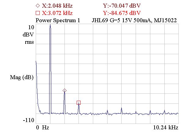

I tested 6 different sets of output transistors in the amp, all with Hfe of 60 to 125 and matched with an M328 tester. The three different sets of RCA 2N3055's from 1981 thru 1989 were all slow, risetime of ~1V/uS in the circuit. Seeing this, I would avoid RCA 3055's in the JLH. A Signetics NPN from a power supply was really slow, 0.2V/uS. A set of Motorola late-80's NPN's from an ACDC electronic load (house part numbers) were much better, distortion was low (H2 -79dBr), risetime 2.5V/uS. Probably would be fine for this low-power application.
But the winner was mid-90's Motorola MJ15022's. Fast (5-6V/uS) and the best distortion yet (H2 @ -80dBr), even with with 15V 500mA bias. See attached. With 18V 900mA bias, distortion came down another 2-3 dB.
I'll run with these, and do listening tests to see if the higher bias sounds significantly better to warrant using it.

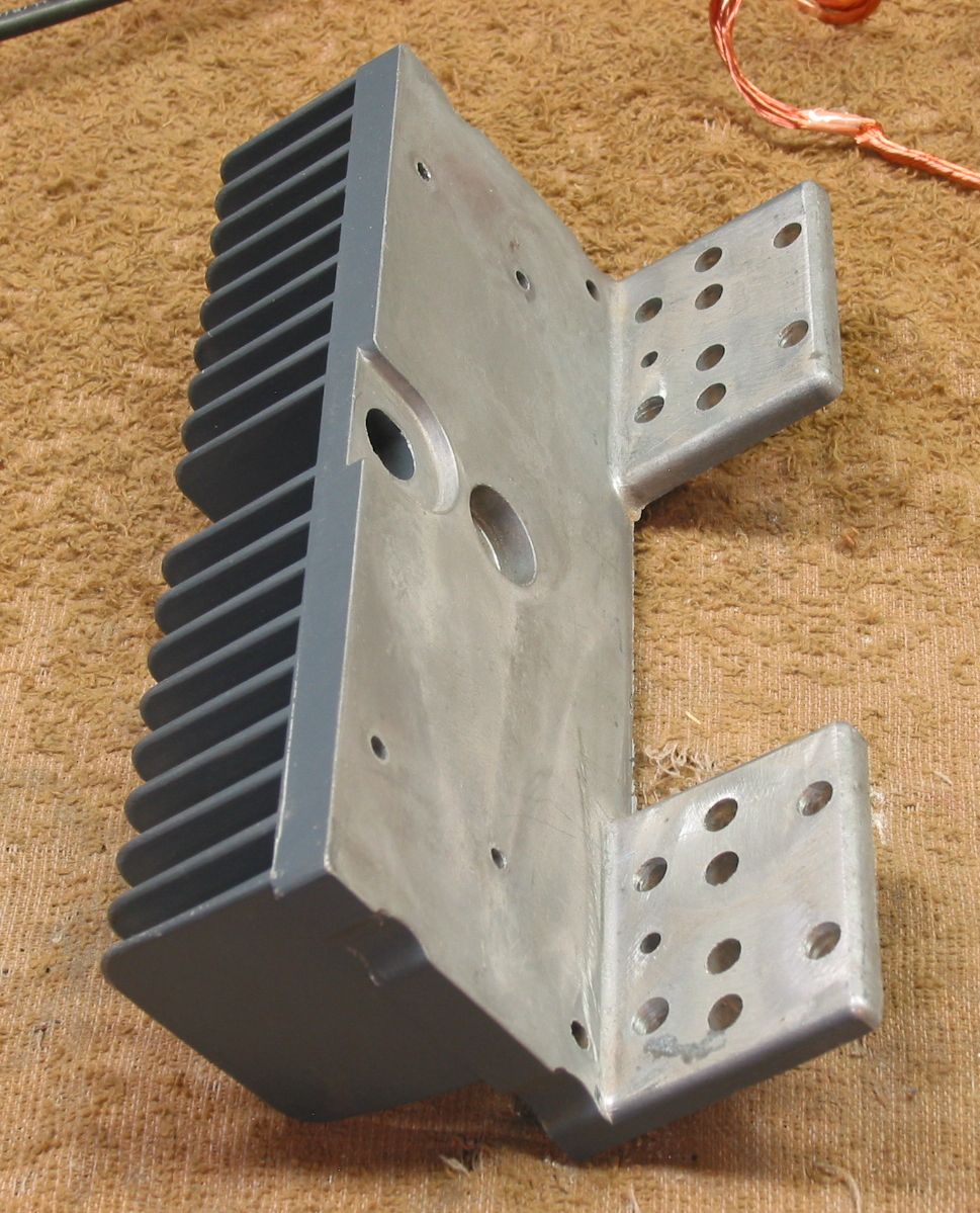

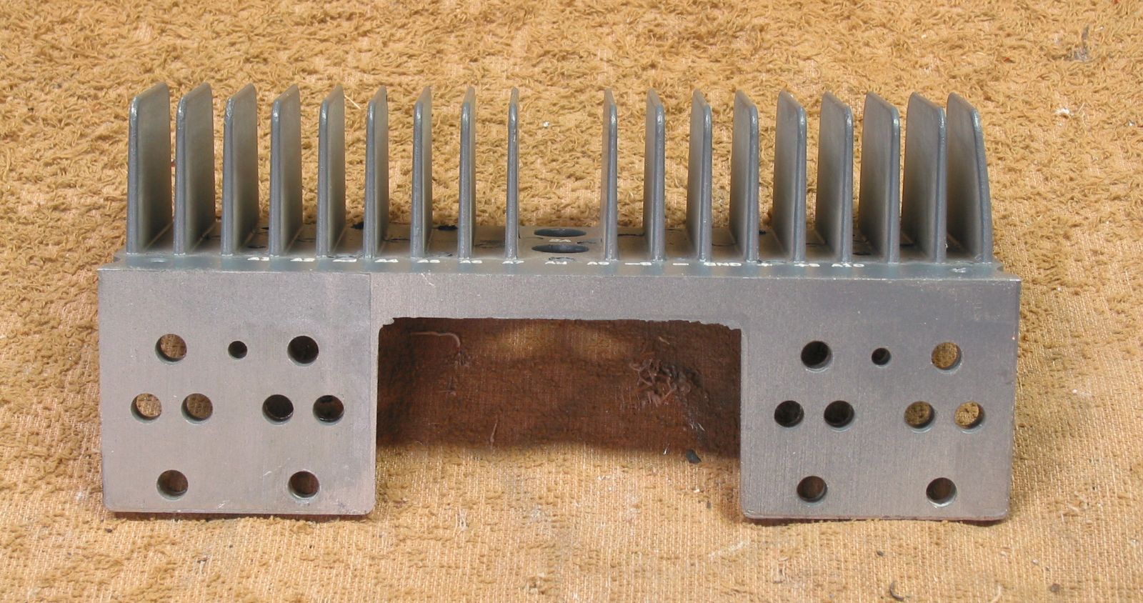

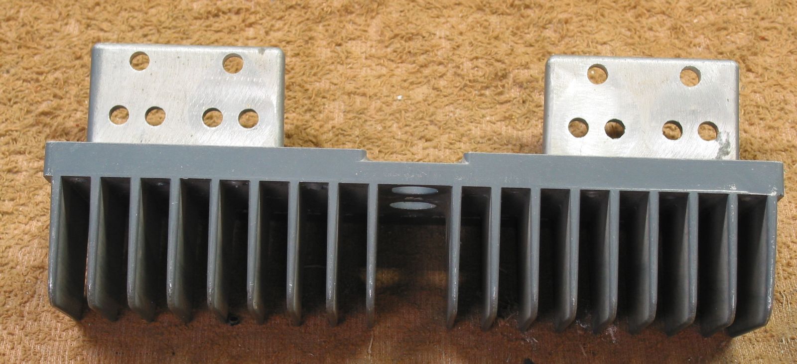

I thought this might be of general interest. I'm considering using this heatsink, scavenged from an old HP/Harrison 6205B power supply. 2 lbs of cast aluminum with holes for two sets of TO-3's. Holes in the center for power cord and fuse holder. Size 8"W x 3"H x 2" fins.
Except for the 6209B, these old 6200-series supplies are not in demand and can usually be had for next to nothing. Some models are twice as high. Looks like a great heatsink for JLH69 amps.
Nice find! You need around 0.5K/W heatsink rating per channel to be comfortable around the original JLH's 10-15W version and two of these look to be just about right. From an earlier post, each channel dissipates around 36W constant which is quite significant.
