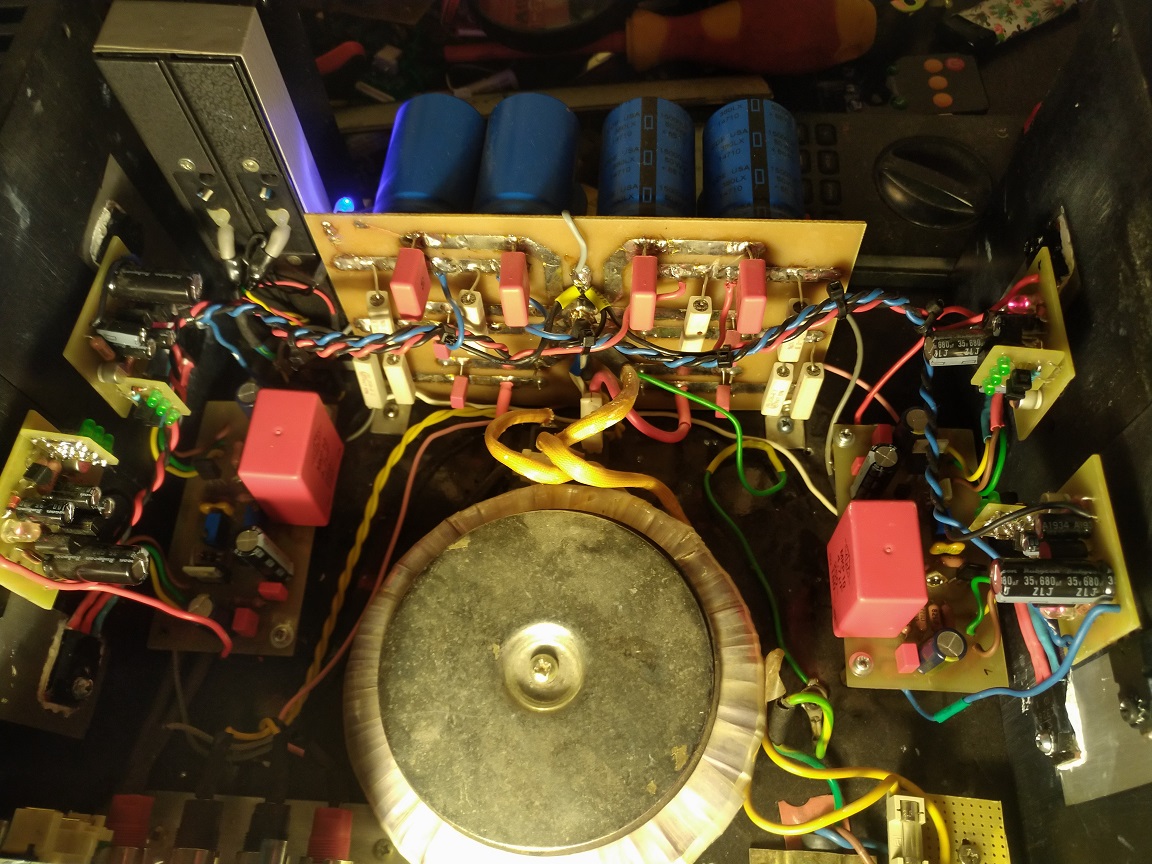

jlh69 with improved regulators, sounds great, now better than Le Monstre
I'm waiting for 2SC1940 and 2SA915 to arrive for Le Monstre, so we'll see then,I have 2SC1941 in jlh69, otherwise these NEC transistors are great, but not available today

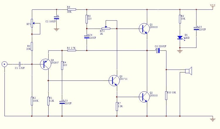

Low-power JHL69
This is my first excursion into Class A land. Am building a pair of JLH69's tailored to drive a set of xfmr-coupled electrostatic headphones. Would like to scale back the power as much as possible, without sacrificing performance, to minimize heat generation. I ordered a couple of the TIP41C-based kits but they won't arrive for another week or two. These just arrived:
GHXAMP Hifi JLH 1969 Amplifier Audio Class A Power Amplifier Board Stereo High Quality For 3 8 inch Full Range Speakers 2pcs|Amplifier| - AliExpress
Load is pretty easy to drive, around 20 Ohms up to 5kHz. 5VRMS is enough to drive them to comfortably-loud levels, so maybe 8-10V for some headroom. Power-wise we're looking at 5 watts max. I was thinking a 24V supply since I have some of them here.
What changes would you make to the basic circuit to scale it down for 24V, 5W, 20 Ohms? JLH's suggestions for 15 Ohms are for maximum power (37V supply).
I've attached the schematic for the unit.
BTW, gain curves on the supplied small-signal devices (2N2907A and 2N1711) look good on the curve tracer, very linear parallel lines. Hfe on the supplied 3055's are all over the map. Supplied capacitors are cr@p.
You need to use an additional heatsink.
To reduce the mains hum / noise, it is advisable to power the amplifier from a linear stabilizer or capacitance multiplier. Use C-R-C filters.
Avoid earth loops during installation.
There is a special board JLH for headphones ($20). Just add a transformer and box🙂
I have some Lambda modular 24V supplies laying around, I plan on using one or more of them.
I have one of those kits coming, it will be good for dynamic headphones, but it's not suitable for driving these electrostats (5 Watts).
You might find hum and hiss noticeable.
Is this a noisy amplifier? I don't recall that being mentioned.
