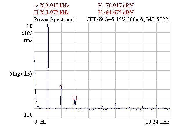

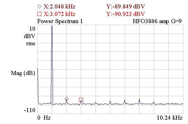

No offense, but I am agnostic to Class A vs AB dogma. I trust my measurements and listening. There is nothing "drastically wrong" with these JLH69 amps. Parts quality is high. Small-signal transistors selected via curve tracer. Distortion measurements are as good or better than anything else I've seen posted here. They don't sound "bad". Problem is, they are simply outperformed by the 3886 at gain of 9 on hifiocean's pcb (now discontinued, btw...).
The 1kHz distortion curves tell some of the tale. Measurement conditions are identical (3.1VRMS into 18 ohms). The 3886 board:
And the JLH board:
Freq scale is linear to highlight the harmonics. The 3886 has 19dB less H2 and 6dB less H3. And has less noise below say 500Hz. It also has lower output impedance (around 20mOhms vs 250mOhms for the JLH). There is every reason for it to sound better. And it does.

let's be honest - gain 9x is not serious for home use - will need another stage of amplification.with so much negative feedback, anything can reach such a thd level ..but will it sound better?
It would be interesting to see JLH vs 3886 starting at 10Khz and up.
JLH with matched outputs @ 1.3 A you can get 2H -80db...
Going from DAC to amp, 9dB can be plenty. The days of -10dBV consumer output levels are long gone...
My current THD measurement rig has issues (mostly its DAC) at 10kHz. But I would put my money on the 3886. Personally, I find THD to be less meaningful at 10k and up.
This is the Class A dogma...

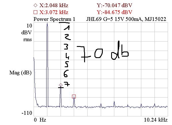

This setup is already H2 at -80dB... you have to add the +10 signal level to the marker readout value. That's why I say, this JLH amp measures as good as any I've seen posted here.
