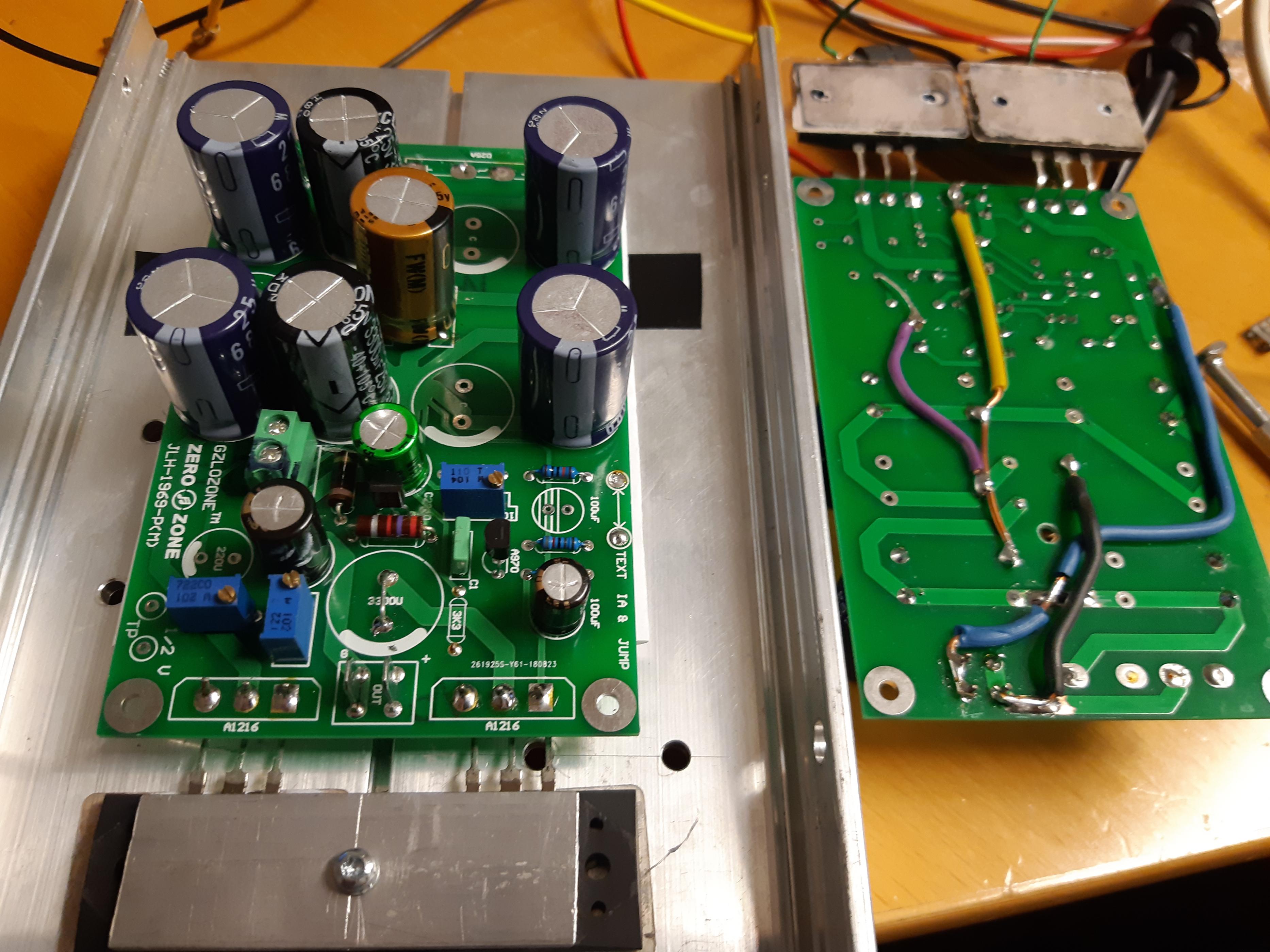

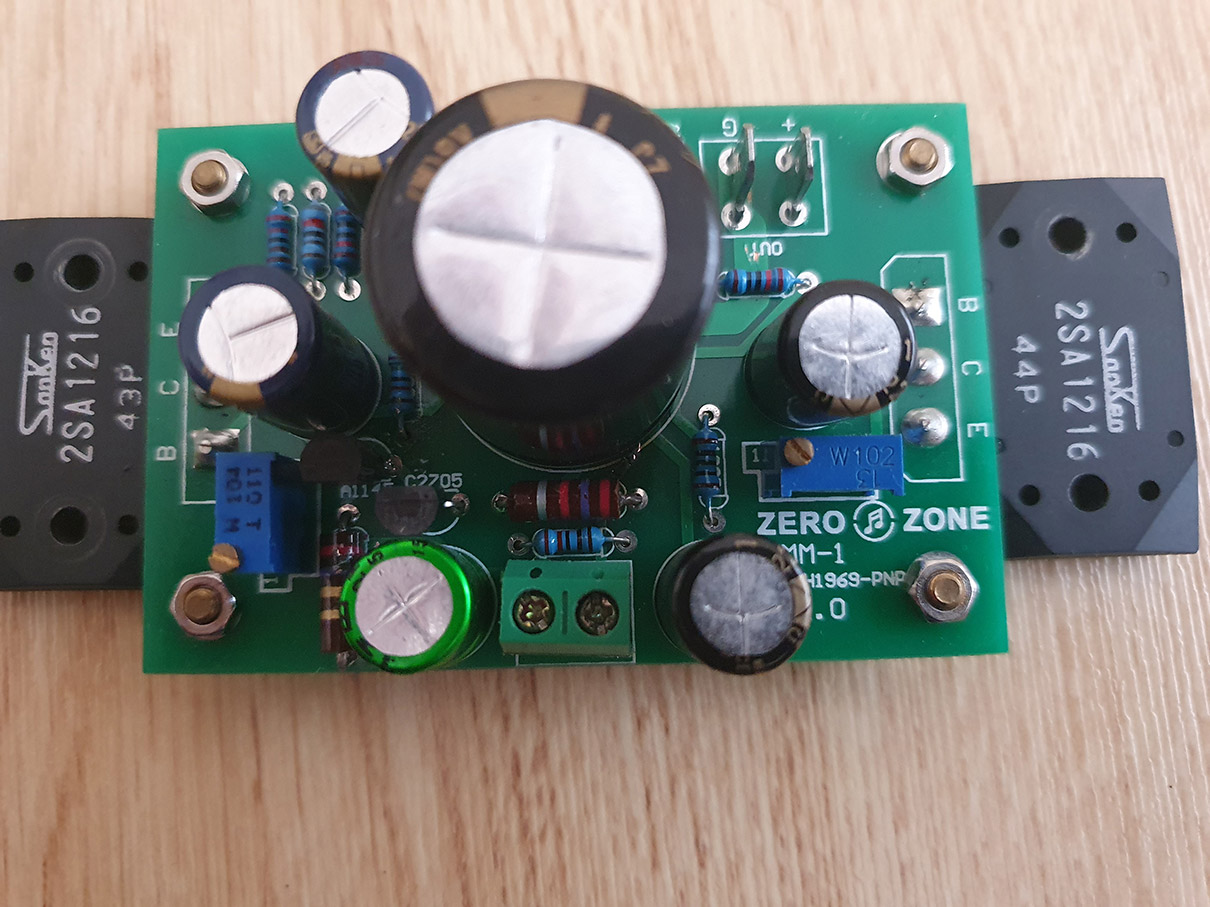

I have these boards, default off load voltage source is 26.7v. I connect same board much clean 22v and it get burned in a second. What could be wrong?
Almost all componenets on it is obsolete. 2SA1216, 2sa1145, 2sc2705.
Which PNP version you use?

Attached a picture of my modified PNP bords. I think it's the same amp, only that mine came with rectifier and caps.
Not easy to say what went wrong. Can't see any burned components on the board either. Did you check the current setting when you changed the supply?
Current changes when voltage is changed.
You could try to measure the components, since there are not so many.
what i saw transistors are different your board uses a970 and c2240 i guess
