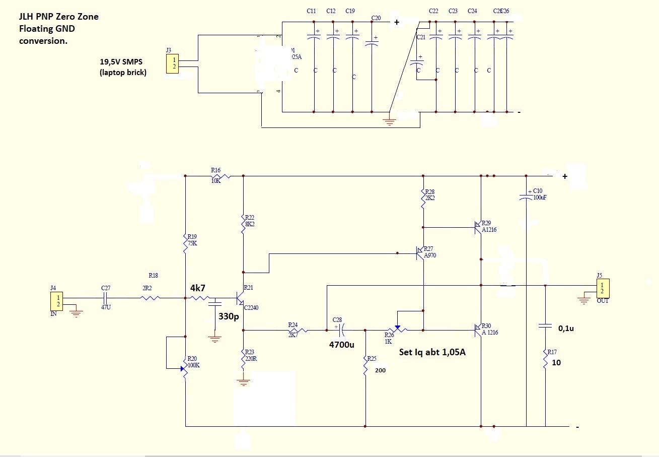

Here is your problem:
In the original circuit, the two output transistors had an Iq set by the driver/VAS stage current. This had to be approximately half the required peak base current at peak output. Just over, in fact, due to the gain roll-off at high currents.
In your circuit the CFP have a high current gain. Say the MJ15004 has a gain of 60 at 2A and that will require a base current of 33mA. At 33mA the gain of the BD139 is about 100. So it needs only 330uA. As mentioned before, the pair will have a high current gain roll-off due to the MJ15004, in the main. That would suggest setting the pre-driver stage current to only 660uA. To low, really, for a high power amp although it is not having to drive a Miller capacitor, so it seems possible.
To equalise the currents, then local feedback needs to be significantly higher to increase the effective base currents. If the current gain of the MJ15004 is 120 at 1A* the driver has to swing about +25mA, -5mA. So to balance, the local currents probably need to be at least 100mA. That would mean using a VAS stage current of maybe 1.5mA, and a base resistor causing a current shift of about 1mA for a 1A output swing. That means, say, using a 1k base resistor and 1 ohm current sharing resistors.
But the overall distortion will increase because you will have lost some gain.
As a starting point, I used 0.68 ohm current sharing resistors, a 1k base to ground/centre rail load resistor and 4mA in the VAS stage driver, with adjustments to the input bias current to re-zero the output rail.
Distortion was higher - 0.1% instead of 0.01%, but no sign of asymmetrical currents in the output transistors. The quiescent current stability would be higher IMO and easier to set.
I leave it to you to optimise the performance!
* edit- I use this as an illustration. The current gain probably won't alter this much.
Looks like you have really been working hard John!
Just to put things in perspective, if you compare it to the RC circuit I added to Mike's original circuit, what do you think? Is there something fundamentally wrong with it? If so, don't be too polite, just say it. I'm a novice, but I can handle the truth!
I found it as a simple and effective solution, it shares the currents nicely, and seems to have high efficiency on voltage swing and current use. It also had pretty good simulated distortion performance just as the original from Mike. However I suspect the uneven currents in Mike's original design might add some extra distortion when built.
I can also see that with the RC it only needs abt 8,5A Iq to acheive full output swing, and without it it needs abt 12A.

I missed that post. Yes it looks an interesting idea, but goes back to bootstrap days. Not that that is a big issue when everything else is AC coupled.
Not sure how you control the quiescent current though. I suspect you will still need to use a local feedback resistor. Nor how you control the current sharing. Simulators using the same model for parallel transistors don't understand manufacturing differences - that needs additional models.
Another possible mod might be to wire all the bases of the MJ15004's together (only in each half, obvs.) so as to utilise your existing emitter resistors. But then you will still need smaller resistors in the emitters of the drivers to ensure the current is balanced in those as the mod. only shares the output transistor currents.
The emitter resistors of 0.68 ohms I tried are larger than needed for current sharing, so there is scope to reduce those (and distortion).
Need to simulate at different temperatures - especially with the output devices heating up.
That will probably need a different model to swap in for the MJ15004's with a different temperature setting compared with the rest of the amp.

As I understand it, Iq is still from the ccs (capacitor decouples the DC), the capacitor and 2k2 resistor takes care of impedance matching the AC signal for the upper bases to do the current sharing when signal is applied. It looks to be working all right in the sim.. + I like it since it has similarities to the original JLH
I quickly tried it on a 96 JLH sim too, but it did not work well. Maybe needs some tuning.

I had this PNP JLH apart the other day to replace the bootstrap cap with a larger one, so I updated the schematic with that, and also found an error: I have no feedback cap in the amp, so I removed it from the schematic too.

Have you simulated the transient response (low frequency) of the floating ground arrangement?
I also had a design once (class AB) using the floating ground ... until I simulated it.
I found that decoupling the supply lines with a large capacitor helped. That means adding a 10k equivalent to R16 in the - line and something like 1mF each to ground.

I've simulated it before and it requires a large amount of capacitance and it suffers from the same risk of low frequency instability as a single output capacitor - as you would expect.
fyi - slightly OT - What I did on a Class AB amplifier which employed this floating ground was to connect the floating ground to the centre tap of the power transformer secondary through a power resistor. This is somewhat akin to split rail supply and hence it 'anchors' the ground at DC but it protects the speaker from excessive DC current in the case of a fault. This protection only works for mono construction in which additional channels have separate exclusive floating grounds.

Yes.. and seen it on a scope too, I mentioned it some time ago in this thread. There is a visible (on woofers) LF oscillation around 1Hz at startup, but it dies after abt 2 cycles. It can also be made to 'swing' a bit from steady state with correctly spaced tone bursts, I think I posted a scope picture of this. I have chosen to ignore it, since the amp just sounds so nice, but it is in the back of my head..
I have also made a spice model of the PNP amp that is almost spot on in distortion simulations compared to the real thing, even if the low power transistors are not the same as the real thing. It seems getting the models for the 2SA1216 outputs made the difference.
After listening some more to it after I changed the bootstrap cap, I have a feeling the sound has changed a bit. Not only LF, but mid/treble too, and that should be imagination. Anyway, I'm thinking about getting some 'audio' caps to try in this position..
