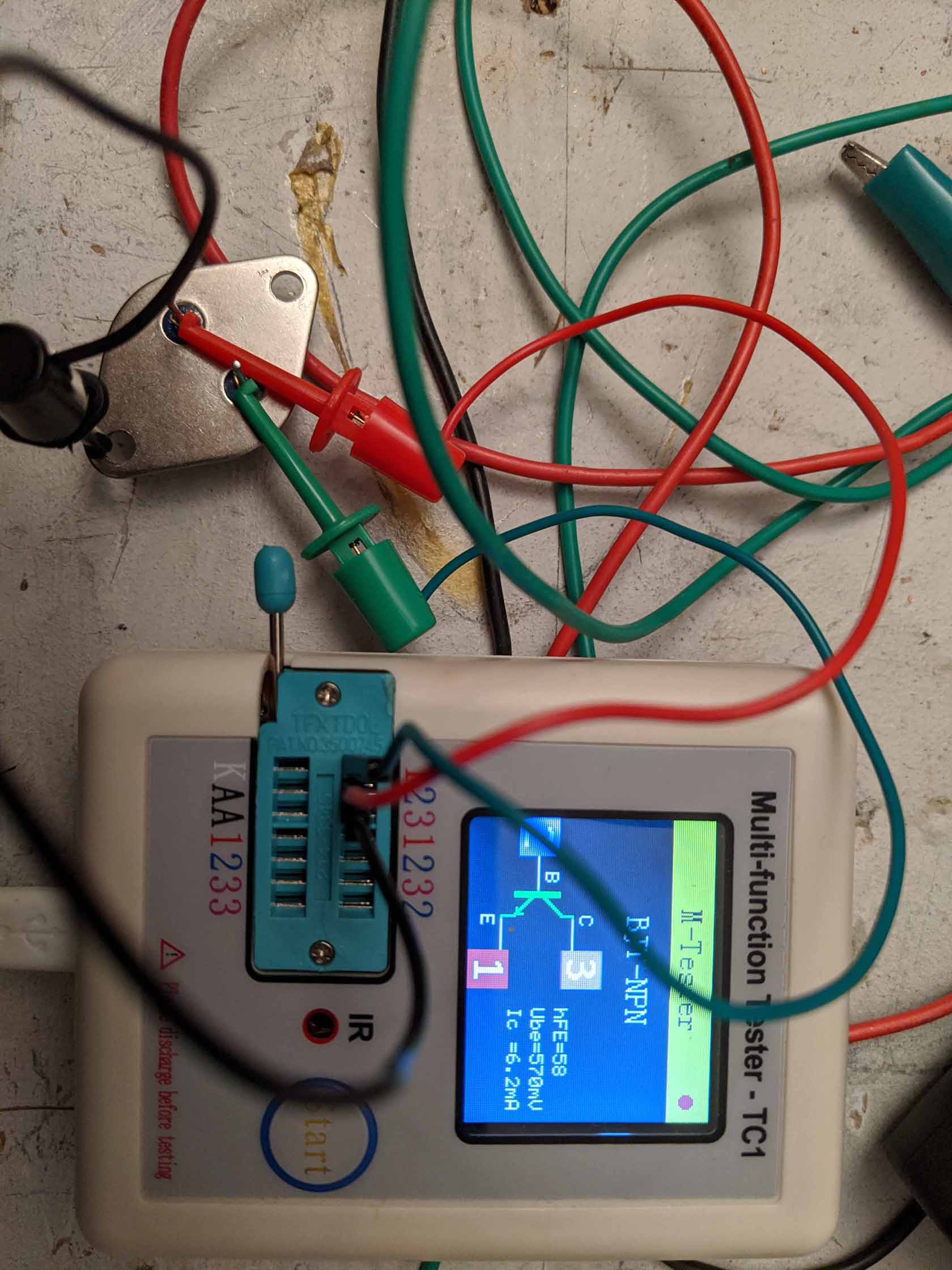

Hello Fred, thanks for your Reply! I bought a transistor tester and tested, and got out hfe=58. which I considered to low after studiing the Datasheet of the MJ15003. So I thought about a more real testing with 10V and aound 1A and 85°C and got very different results.
results:
MJ15003 (Digikey) measured with 10V PSU: 25°C -> hfe=70, 85°C -> hfe=113;
MJ15003 (Digikey) measured with Tester: 25°C -> hfe=58, 85°C -> hfe=90
2N3055 (used, from chinese Kit) measured with 10V PSU: 25°C -> hfe 131, 85°C -> hfe=125
2N3055 (used, from chinese Kit) measured with Tester: 25°C -> hfe 175, 85°C -> hfe=304
Probably this tester (Type: Transistor Tester TFT -> picture) isn't strong enough for power transistors. ..
Hi again,
Sorry, I was thinking of testing the small signal devices and did not answer your question.
You are quite correct in that the hfe will vary with the Collector current and the method you have tried is valid for power transistors. However, you will have to be very careful in how long you test a free standing device (i.e. not on a heatsink) with a current of 1 Amp going through it and 10Volts across it with no protection.
This may help further.

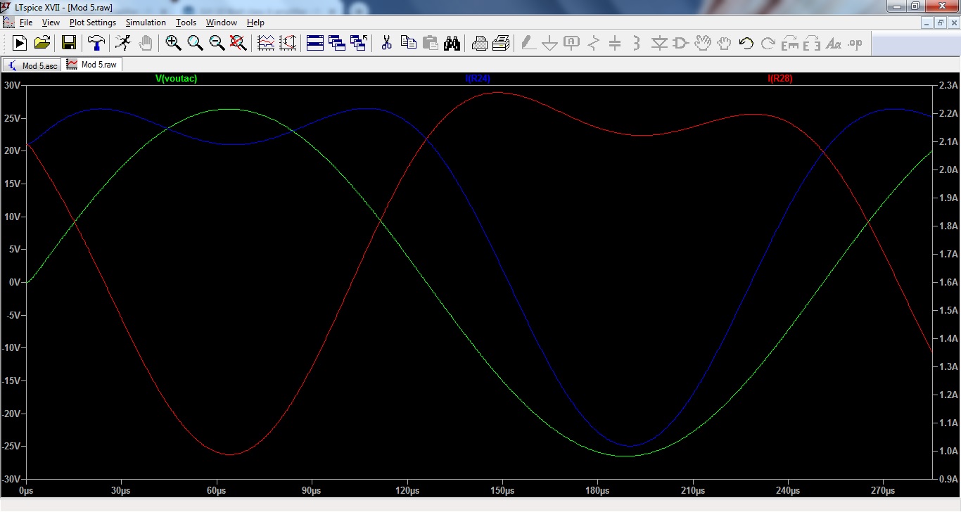

I tried that one first, but the currents still looked strange. Here is a plot of mod5 upper and lower currents together with output voltage. They look ok on low levels, but get odd with higher output.
Again, I'm not sure how the current sharing matters, but I guess it could have some effect on the PS etc.
This is the same problem I had when I designed my variant a while back. The only way I could get the currents to equalise was to increase the local feedback, which the 2.2k base and local emitter resistors provide.
It can be forced to balance by increasing this local feedback. This means by reducing the 2.2k or increasing the emitter resistors or both,.
First, though, I would suggest that using local emitter resistors is always to be recommended when parallelling devices to improve current sharing.
Increasing the local feedback by introducing the 2.2k in the upper stage or reducing its value in both halves will have a detrimental effect on distortion, because the nonlinear emitter-base voltages then have to be applied to the resistor. So what was a minimal offset current is then larger.
One further option you might look at which should preserve the low distortion is to keep the "local" emitter resistors to ensure current sharing. Then instead of connecting the 2.2k resistors from the base to ground on the lower half, or base to centre in the upper, try replacing these by four 8.2k resistors each one tied locally between the base and emitter of the drivers. This should provide a balanced drive impedance while not incurring the excess non-linear component.
It won't however provide local feedback, only balance the impedances.
Another point I found was that the reduction in current in one half at higher currents was due to gain roll-off in the output transistors. That means perhaps the Iq is set too high. If your expected output is 36V into 6 ohms, say, the peak (nominal) current would be 6A, suggesting an Iq of perhaps 4A, or 1A in each device. Or maybe trying a sim with MJ21193 which have a more linear gain than the 15004, though they cost more and seem to be getting even more so.

Here is your problem:
In the original circuit, the two output transistors had an Iq set by the driver/VAS stage current. This had to be approximately half the required peak base current at peak output. Just over, in fact, due to the gain roll-off at high currents.
In your circuit the CFP have a high current gain. Say the MJ15004 has a gain of 60 at 2A and that will require a base current of 33mA. At 33mA the gain of the BD139 is about 100. So it needs only 330uA. As mentioned before, the pair will have a high current gain roll-off due to the MJ15004, in the main. That would suggest setting the pre-driver stage current to only 660uA. To low, really, for a high power amp although it is not having to drive a Miller capacitor, so it seems possible.
To equalise the currents, then local feedback needs to be significantly higher to increase the effective base currents. If the current gain of the MJ15004 is 120 at 1A* the driver has to swing about +25mA, -5mA. So to balance, the local currents probably need to be at least 100mA. That would mean using a VAS stage current of maybe 1.5mA, and a base resistor causing a current shift of about 1mA for a 1A output swing. That means, say, using a 1k base resistor and 1 ohm current sharing resistors.
But the overall distortion will increase because you will have lost some gain.
As a starting point, I used 0.68 ohm current sharing resistors, a 1k base to ground/centre rail load resistor and 4mA in the VAS stage driver, with adjustments to the input bias current to re-zero the output rail.
Distortion was higher - 0.1% instead of 0.01%, but no sign of asymmetrical currents in the output transistors. The quiescent current stability would be higher IMO and easier to set.
I leave it to you to optimise the performance!

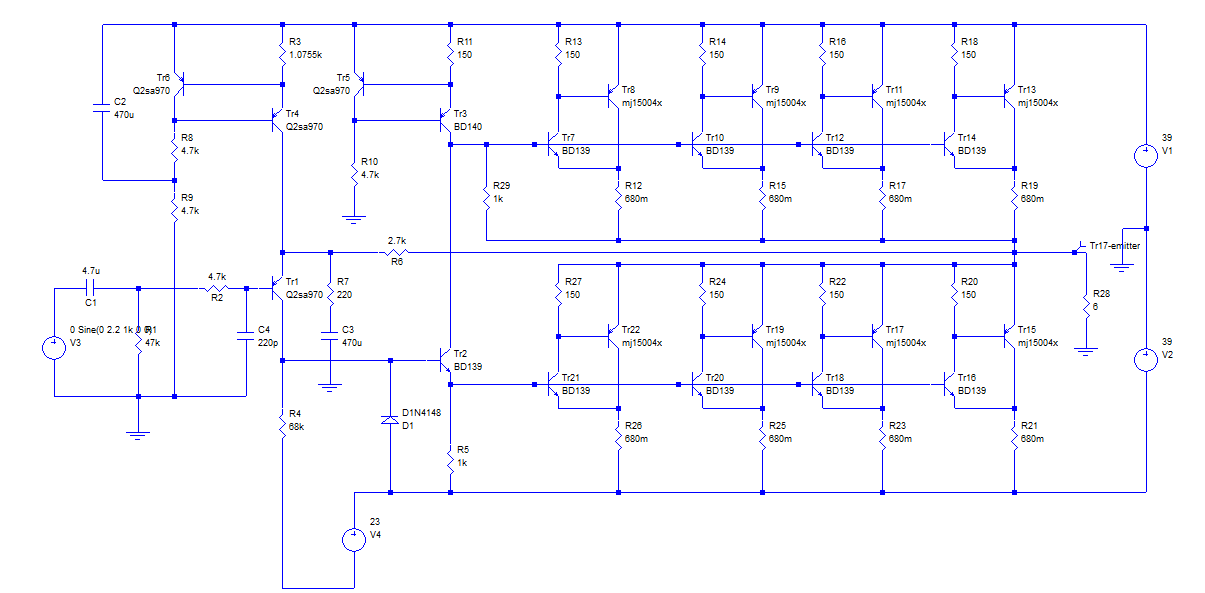

John (Ellis),
Here is the LT model for the BD139, perhaps you could help us all by including it and making changes to one of the .asc files, such as components, adjusting the Iq and DC offset etc, so we can all see what you are trying to explain.
Kind regards
Mike
Kind regards
Mike
Mike/Rally
I haven't got round to learning LT spice in any depth. Here is my sim pic- hope you can make the adjustments in LT Spice yourselves.
It is basically Mike's Mod 5. I've used BD139/BD140 in the VAS stage as I did not have the models for the devices you used - maybe I should copy them from the previous posts.
I've taken the lower base resistor of (your) Q4 to a -23 V extra rail which in practice means -62V but that can be obtained with a voltage doubler on the - rail.
John Linsley Hood made an astute choice of feedback and grounding resistors. The stability of the circuit may well depend on the low gain due to the 220 grounding resistor, limiting the input stage gain to 5mA/V. While the different bias on the 6.8k (now 68k) resistor goes a long way to reducing the increased distortion due to the local feedback, making the feedbadk resistor 1.2k and 100 reduces it further.
But the stability is lost and a 22pF compensation capacitor is needed across the feedback resistor. Not checked stability margin etc - over to you!
One wonders whether it's cheaper to implement (R4 and V4) in the Thevenin Equivalent form shown here, or alternatively in Norton Equivalent form. Norton offers the possibility to eliminate an entire power supply, indeed a critically low-noise supply.
