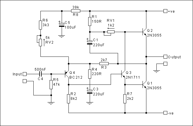

I played with JLH69 for over two years, the starting position was a dual-power version. I then added power sources for Q3 and Q4. I spent most of my time trying out various transistors, primarily for the Q3, which I realized had the most impact on amplifier sound. I dropped the C3 and adjusted the current through the Q4. For Q3, low Cob fast transistors are good.Q3 with low Hfe will not sound good. Q1 and Q2 must have higher Hfe.
Of the equipment, I only have an oscilloscope and a voltmeter, but on scop I have an FFT analysis and you can see the difference in Q3 selection.
The other important thing is the power supply, it has to be as good as possible with less ripple and noise, initially I only used capacitors, so I added the resistors so I had a CRCRC combination with a 2V voltage drop, now I added the regulators with an additional 3V voltage drop. I have a total of 180,000uF in power supply.

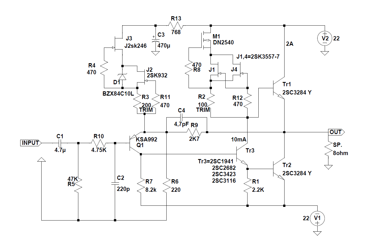

The JLH69 amplifier really sounds great and I have no intention of changing anything for now.
In my opinion it is not necessary to change a lot according to the basic scheme, it is enough to add CCSs, but special attention should be paid to the choice of parts (especially Q3) and power supply quality.

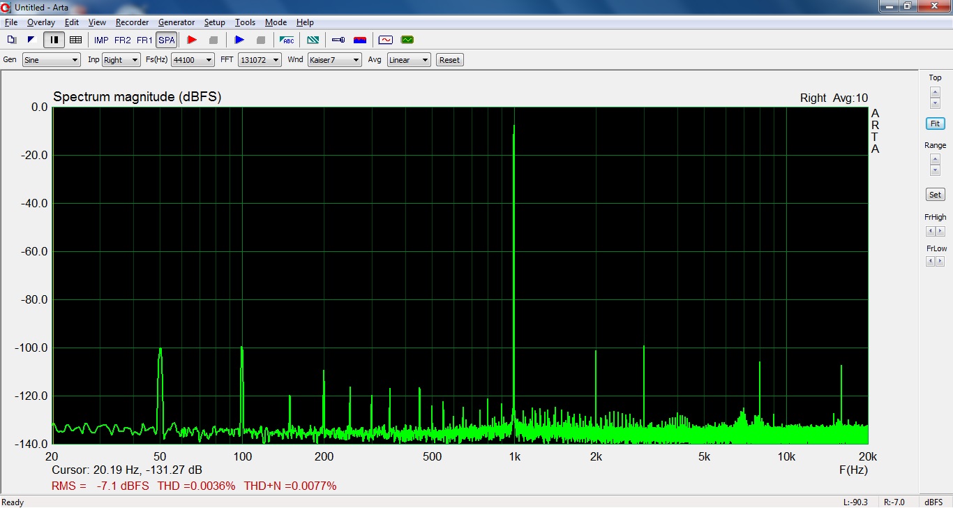

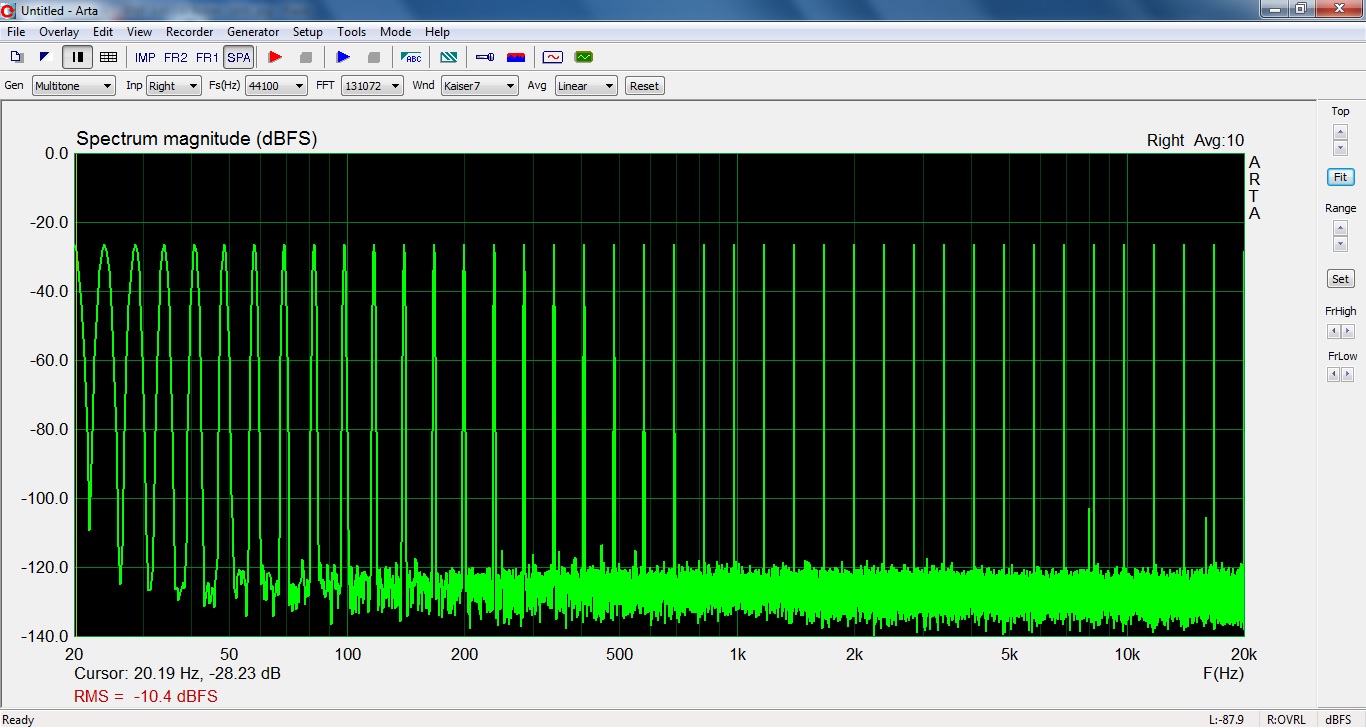

Just did a quick test of my PNP JLH to refresh my memory. Load is actually 7.2ohm, not 8.
There are some spikes from noise pickup that should be disregarded at 8kHz and 16kHz, and some 50Hz and multiples of that.

I've been doing some thinking. The JLH design is frustrating because as far as I can tell it was arrived at by experiment and finds a sweet spot that removes the need for an extra stage of amplification. Designs using op amps and current buffers don't give dramatically better paper distortion as proof of concept. The main hang up most seem to have is wanting to use the rules of a class AB designs to update the JLH.This does no harm but when it works is for different reasons.
After some thinking I remembered two designs from the past. Teleton GA202 and PE Texan. The hybrid I suspect could work is the Texan output stage and a single transistor VAS. The output can have any gain you like. This gives options that should favour a gain of one. It might not and most likely will be three. We might have an open loop gain of 700 or greater from two stages.
As the output buffer has massive current gain the VAS current might be lower than usual. 2mA? The distortion of the buffer will be an order of magnitude lower than the JLH. Bias would be two diodes and a resistor. Current between 0.4 to 0.8 amps would be fine as loud stuff would be class AB like old cinema amplifiers. If 0.5 amps 30 watts might be possible. 2 watts class A then AB might sound better than the JLH due to PSU effects.
The big advantage of an amplifier like this is the highly desirable input shunt feedback is used. The beauty of this is if your preamp has the current and the output certainly does the feedback is warp factor 9 fast. I would use the speaker capacitor as bootstrap as 2 mA won't hurt the speaker. It possibly is better.
I always remember tests I did with the OPA604 and this output stage. It was almost impossible to measure any distortion from the buffer if running 0.7 amps bias. If the heatsink large enough the bias was stable with two diodes and a resistor. It's often said this bias method is hopelessly bad. Not really, if so the heatsink is too small. An smps makes that more certain as it is a regulator into the bargain. I suspect even stability will be fine. The output pair can have 100% local negative feedback. Very little loop feedback required to correct it. The distortion is a single transistor with active current source with a gain of twenty perhaps. The current source makes the transistor think it's working from hundreds of volts. Therefore the amplification curve looks like a straight line. An mpsa 44 at 300 VDC no better if as good.
The JLH still assumes a valve preamp would be used. This Idea assumes a preamp that might drive 32 ohms used. One might even make the amplifier gain of minus three and make the preamp work harder.

Great to hear that the JL-H is still arousing interest.Split rail amp. is much better,eliminates the op. cap. Tried building the amp. with Toshiba 2SC5200s (watch out for fakes!). The sound was extremely "bright",not surprising as the op. was still flat at 250KHz.!It is well worth reading the JL-H section on the Class A Amp. Site. now hosted by Elliott Sound Products.
There are a few points to make about replacing 2N3055 with 2SC5200 firstly there is no need for a compensation capacitor using the former as the low fT sets the dominant pole of the whole amplifier. JLH stated this in his book.
If you use 2SC5200 then you have to rely on the voltage gain stages having enough diffusion capacitance for Miller effect to reduce the gain to unity before the phase reaches - 180 degrees.
Having culled the main stability of the original design it makes sense to do some calculations in that regard or stick to the script. If people expect improvements in sound without doing this they will perceive the change as an improvement.
As loudspeakers generate delayed signal there is a need for a margin of 45 degrees to trouble can start moving above -135 degrees. If the sound is extremely bright there has to be a stability issue.
There is a set of articles on Rod Elliott's site on the follow up Class AB amplifier by JLH in 1970 based partly on the 1969 Class A.
I suggest you study his preferred method of stability compensation. He did not support the use of lead capacitors that some have included in the feedback path - he said these made the 1969 Class A design "readily oscillatory". Bob Cordell has also cautioned against the use of lead capacitors in the feedback path.
My Indian 3055 required some Millar capacitance to the driver. 33pf collector to bass. I suspect less would have been OK. The driver bc337-40. On reflection the bc337 was a bit marginal at 0.6 watts. The higher gain fake 3055 made it possible. When I say fake a very superior fake. Having read JLH on compensation I tried everything. Nothing except the Vas worked. JLH talks about output to input. I didn't find that workable. The brightness heard is doubtless instability. It's said marginal instability sounds great. Reason is music is less punishing. Some think the signature of the amplifier can be inferred by rise time or decay time.

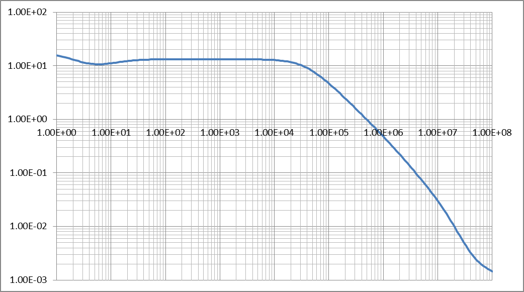

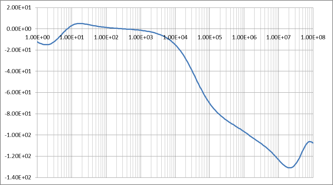

mjona offers good advice and it is instructive to compare the performance of the JLH 10-watter with different transistors. I ran a Tien anaylsis on four configurations: (1) with a 2N3055H (the slow hometaxial base device) model; (2) with a 2N3716 (epi base) model; (3) with a C5200 model and (4) a C5200 with a small compensation capacitor. Rather than showing all of the plots, here are the first two showing the loop gain and phase of the first. (a) shows the loop gain and (b) the phase.
The results are summarised as:
Configuration Gain margin Phase margin*
1 40dB 90°
2 26dB 68°
3 26dB 74°
4 30dB 95°
* Where the phase has not reached 180 degrees, I have taken the margin at a point of inflexion.
These are what the plots show, at least. I have not checked the C5200 model, but I have generated the 2N3055H model as none of the available ones I have seen describes it properly, and adjusted the 2N3716 model to what I think seems a better representation than the commercially available model I had.
The first result confirms that the original design with slow devices has the best overall stability margin. All show that they are stable, however. What is interesting is that the high speed devices do not appear to require a capacitor, but the epitaxial devices (4Mhz types) have a lower phase margin than the very high speed C5200.

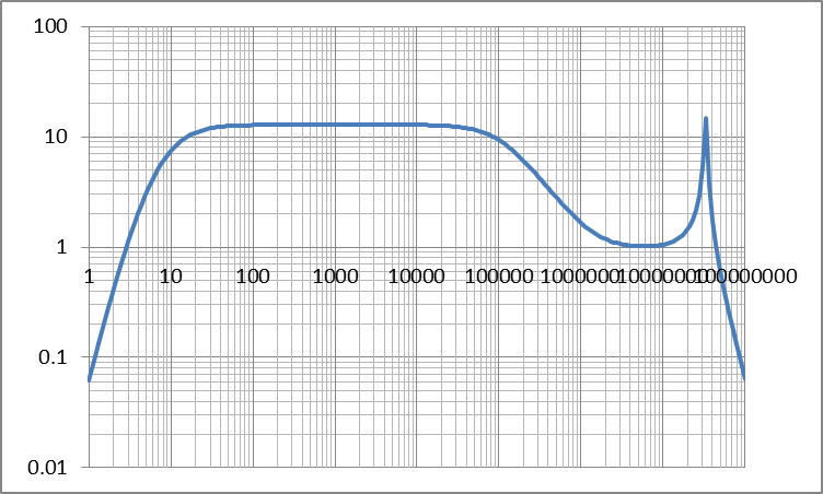

The compensation capacitor for (4) was a small value of 33pF. And I think this is where some of the generalisations about using it need to be considered more fully. If using capacitors to roll the gain off at some particular (lowish) frequency, there are several consequences. First, it will indeed reduce the gain at the target frequency (as set by the RC time constant) but the gain in a non-inverting feedback loop does not get to fall below unity until the open loop gain has. The gain therefore could well flatten out, hovering just above unity into the megahertz region, which means it does not necessarily compensate as one might have expected in terms of stability improvement through reducing the gain. This point is well worth illustrating. The third picture show the frequency response of the high speed version where a 560pF capacitor has been added as a compensation capacitor in an attempt to limit the response to 100kHz. The horrid spike is clear evidence of trouble. The Tian plot confirms that the gain margin is -3dB (that is, none - it has positive feedback) and the phase margin is, well, none either as it is a degree or two over 180.
A small capacitor which has less effect on the output stability can sometimes be used for a small phase correction. Even Doug Self indeed included one in his "Blameless" design. Configuration 4 confirms that there is indeed a greater phase margin with the capacitor. From these results, which I think I would need to check, it does indeed seem that a small capacitor can provide an improved margin.
What might be even more significant, however, is the unity gain frequency. This is 21MHz (simulated) for the high speed device with and without the compensation capacitor. That has significant consequences for layout. Any stray inductance in the leads (power supply, loutspeaker wires, grounding) could potentially cause instability. This may well leave the circuit open to potential parasitic induced oscillations.
Possibly, this excessive frequency response may well be the cause of varying results when using a compensation capacitor. If I include a small compensation capacitor, then invariably I will also use an output RC-LC network on the output which acts to counter stray speaker wiring inductance and also reduces potential RF pick up getting into the amplifier through this capacitor.
My conclusion is that a phase lead feedback capacitor is certainly not something which can be used lightly. That raises the question as to what can be done to ameliorate an excessive gain at megahertz frequencies when using these modern transistors. One traditional idea is to add "sprog stopper" capacitors. Adding 100pF between the collector and bases of the output transistors brought the unity gain frequency down to 10MHz, but at a closing rate of 40dB/decade which is considered marginally stable. Another option is to add 100 ohm resistors in series with the bases, and combining both gave a well controlled gain reduction, but still at too fast a rate. To compensate for the 12dB/octave roll-off a phase lead capacitor was also added. The phase margin became 100 degrees while the gain margin was 30dB, and the unity gain frequency was as mentioned 10MHz.
