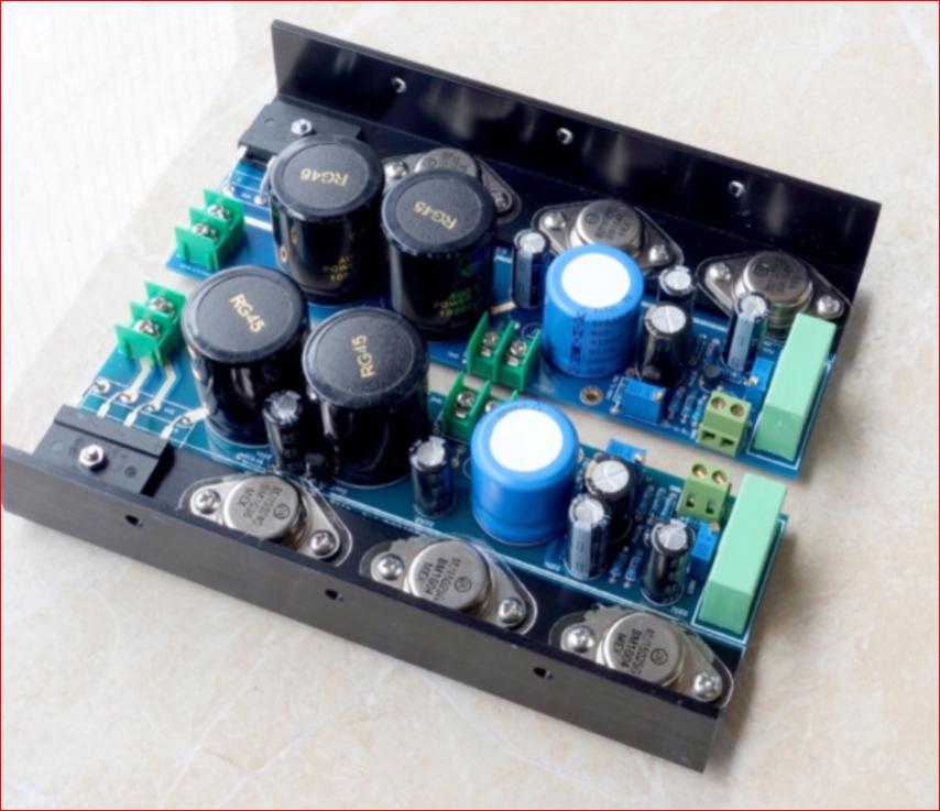

There have been a string of Ebay JLH'69 kits, PCBs and fully built amplifiers that might fit this description.building on the nostalgia approach, a 2N3055 based regulator with the '69 using 2N3055 outputs would be nice.
'not saying they are particulary good products and the rectifier location worries me. Also, some versions may only be simple cap. multipliers that would need modification but they look attractive, simple and compact assemblies - a good way to get started with a better power supply if you have a suitable transformer, capacitors and heatsinks to meet the higher voltage and dissipation needs.
I bought just the PCBs for around US $10 including post. In the meantime, a friend had bought a fully assembled amplifier which used similar PCBs. I was somewhat impressed and no longer curious so for now, that project is relegated to the ever-growing list.
