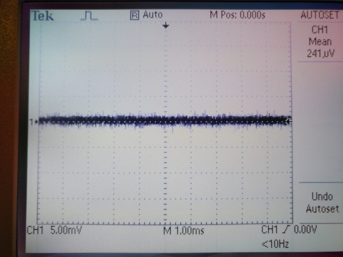

What I will attempt is better output filtering.

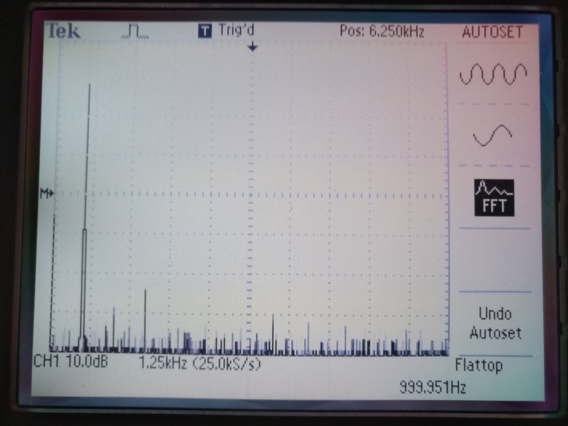

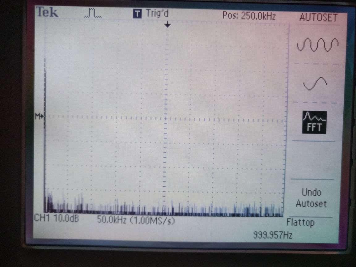

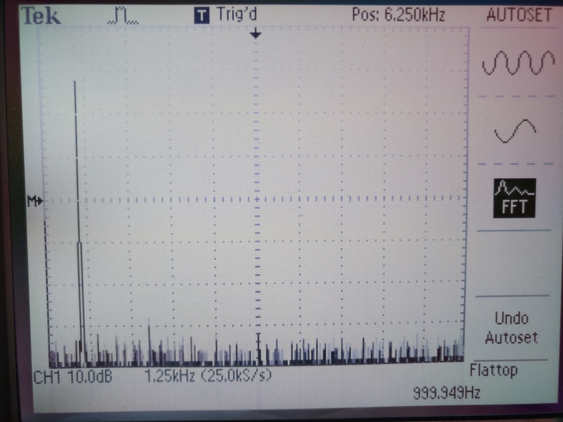

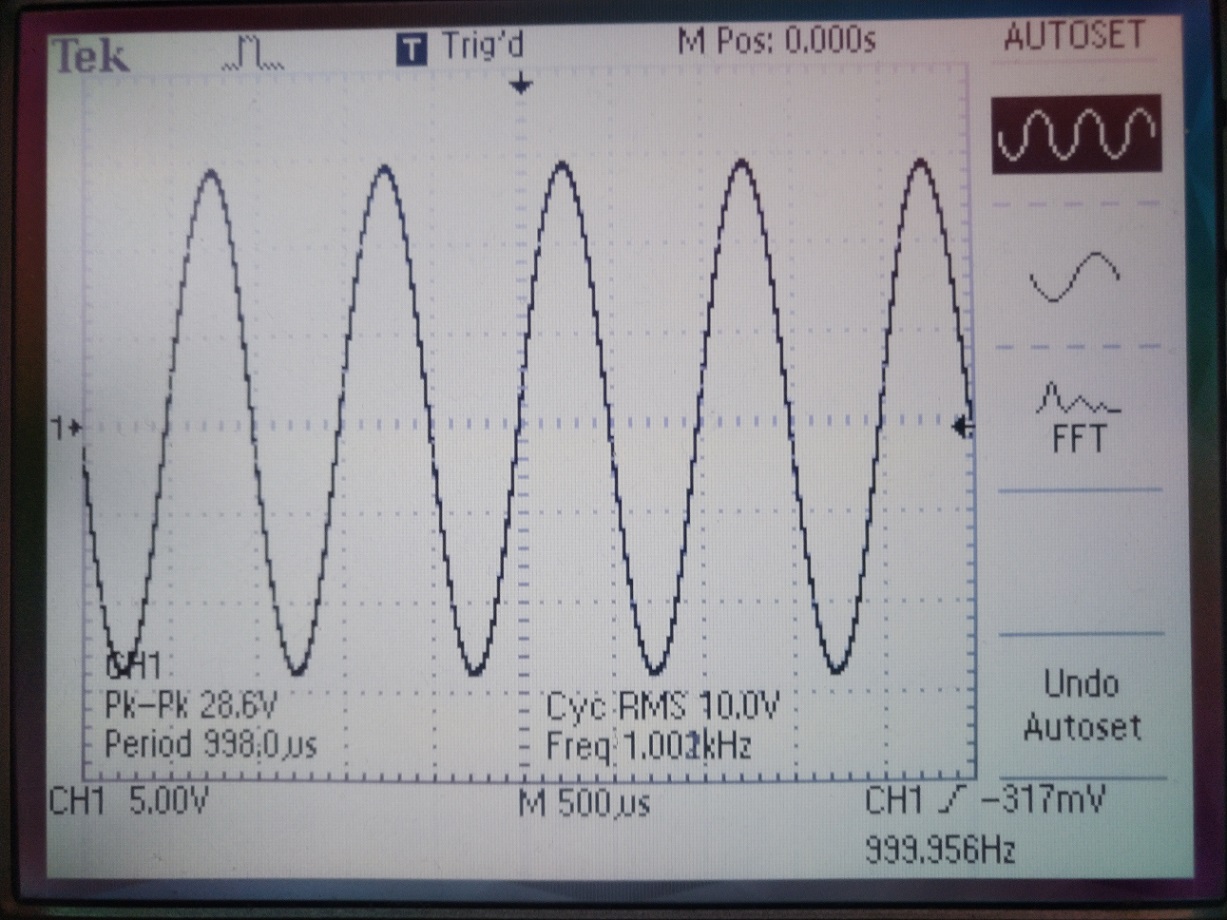

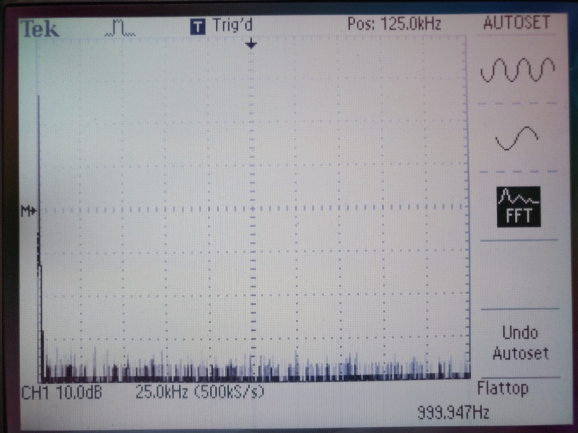

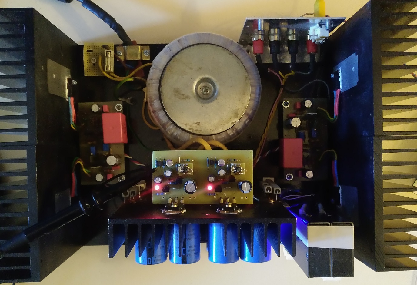

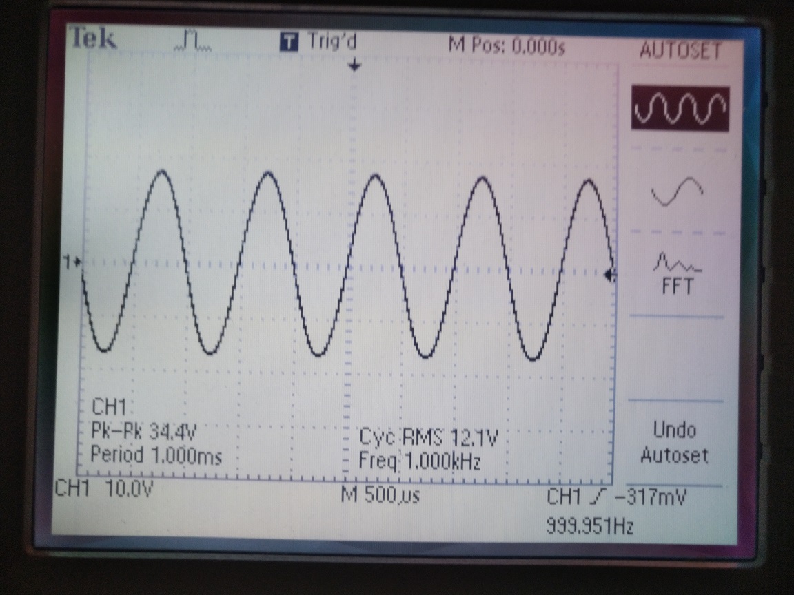

Today I was doing some measurements on my JLH69 amplifier. Power is classic, toroid + CRCRC filter + voltage regulator, +/- 19V 8A.
All transistors are fast, minimum ft 60MHz on 2A for output transistor. The current through the output transistors is 2A.
All transistors are fast, minimum ft 60MHz on 2A for output transistor. The current through the output transistors is 2A.....
That's a very nice looking assembly 🙂 What is your actual power supply since a 19V supply would only require 2A bias if the speakers were say, 3 Ohm or less. A +/-19V supply implies a total rail-rail 38V which would stretch the recommended limits of the '69, original design. It likely would suit the JLH'96 and later versions with dual rails and 8 Ohm loads.
JLH had doubts about very fast output transistors and was at a loss to say why. As far as I know he never found out. Next generation faster transistors were liked. BDY56 being an example. My feeling is speed is irrelevant. What might be ultra important is a quality called super beta by Douglas Self. Self also says better to add high grade capacitors to a device than see the transistor capacitance as a virtue. Self also plays down IM distortion saying excellent THD and poor IM seems unlikely. It should show up somewhere. Much as Self and myself wouldn't agree about the Blameless concept I do like the bench marks he set. Rod Elliot of esp audio had an interesting point to make. He said he didn't feel simple amplifiers of the JLH type were more stable due to simplicity, instead it is high capacitance transistors especially for the VAS. I have doubts that applies to the best. However he probably has a point. My JLH required 33 of VAS compensation. Here is a thought. The average value of a sine wave is zero. How come we can hear a sine wave? That is because it is a power wave. As current is proportional to current we can use sin^2 to express that as V^2. Now magically there is no negative value of 180 to 360 ddgrees. It also explains RMS. Sin 45 is 0.7071 which is the accepted DC equivalent level. That's bonkers as simple calculus of how the curve looks. Sin^2 45 is 0.5 , that makes sense. A Pythagorean solution of a 1 x 1 x 1.414 triangle. What does sine squared look like? A distorted sinewave. If we add phase shift into the story we realize how distortion testing probably doesn't tell us the whole story. Sine 0,30,45,60, 90 , 0, 0.5 0.701, 0..866, 1 Sin^2 0, 0.25, 0.5 , 0.75, 1. Notice how the number is the actual clock face number and better describes the process. The other thing to remember is our use of sine waves is related to the invention of television.

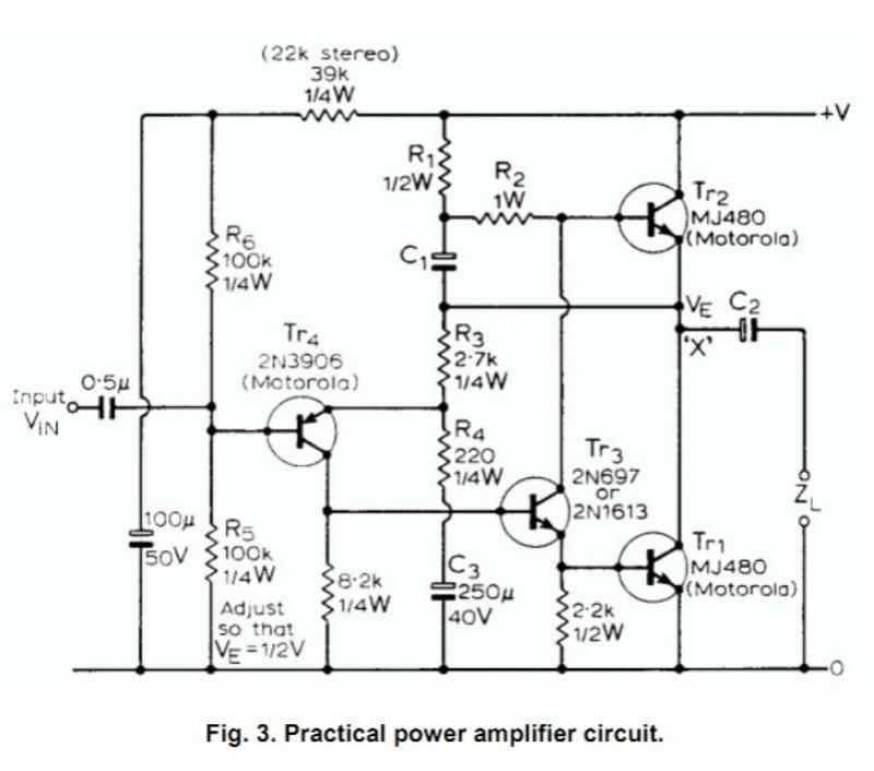

I don't know what Self means by "super beta", that was a term used a while back for transistors with a very high gain (over 1000). In the JLH amplifier, modern output transistors with "flat beta" I would suggest is a better if more mundane description, having a gain more or less constant with current over a wide current range, and in particular, maintaining the gain at high currents, is particularly relevant for lower distortion. Unlike the 2N3055 which had a peak gain of perhaps 200 at 200mA but only 30 at 4A.
Regarding IMD, that is primarily why low THD is required. Since low THD implies linearity, IMD should be low. Amplifiers with THD around 0.1% could have quite high levels of IMD, which as people are pointing out depended on the degree of complexity of the music signals.
Transistors like the BDY56 were intermediate: higher ft, yes, but not "flat beta". For output devices, they should have been an improvement over the 2N3055. But for stability, a lower frequency VAS device would have been required, or compensation capacitors needed.

Today I installed voltage regulators in my JLH69 . It is a Walt Jung superreg that I boosted a little. The output voltage is +/-20V and can withstand currents greater than 4A.The voltage drop for good regulation is 4V.
The difference in sound was immediately felt. It was as if I was removing the curtain from the speakers, so many new details came in, the quality of the recording and the studio was exactly felt, the sound stage was literally in my living room, it really sounds wonderful.It played great before, but now it has gone to a higher level.
A few days ago I inserted another RC element into the power supply, so I had 30000+30000+30000uF old + 24000uF new, the resistors between were 3x0,24R, there was a difference on the oscilloscope and also in the sound but not like today with the regulators. At the moment I put jumpers on the resistors so I do not have a voltage drop of 2.5V on them. So I provided a larger voltage drop for the regulators. For the test I will reset it, but then I will have to adjust the regulators to a lower output voltage.
My plan is to make another pair of regulators so that I can separate the power for both channels. I think that will be the final step for this amplifier and I think then I might experience sound enlightenment.🙂

Hi John. I possibly mix up the terms. Douglas says the gain is high ( not Darlington ) and is excellent into low resistance loads, sustained beta is the term used as his own idea. When driving very low loads 2N3055 has a gain of about 5. On the other hand it will permit very high base currents. Gogny a French design had a 3055 driving a 3055. This reliably gave 50 watts one ohm for the Gogny ribbon speaker ( With feedback into the amp from the ribbon, my French thought this said it was to damp resonance, I could be wrong, 1967 ). That's the problem, The 3055 and most driven by a puny driver stage is going to suffer. If class AB it wouldn't work at all. Very often high Ft transistors have the ideal gain. I will try the MJ3001 I bought. JLH wasn't sure if he liked it. The standard measurements at the time were excellent with is. THD 0.01%. I will have to build the Elektor 28V 40 mA lamp state variable filter oscilator to measure that. TL074 - 108 dB at 1kHz. The problem is outside of 1kHz it's less good. All the same for a JLH its fine. Hope this link works. Buy the book if you don't have it.
