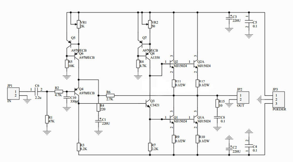

Anyway, I'm slowly putting together the dual output/dual supply boards, and the first measurement I did was not so impressive. Especially with 4ohm load.
I would like to be able to tweak the balance between the output transistors on this one too, but not sure how/if it can be done?
Schematic attached, hope somebody can point me in the right direction.

in terms of getting the balance 'right', what I did was to measure the hfe of the output transistors and put those with the highest values in the lower position - obviously you have to do this for both channels so it means getting quite a few of the o/p devices to cherry pick from. This was the advice that JLH gave in his original article as a way to get the minimum distortion.
It would also probably be a good plan to implement the o/p pairs one at a time and get a feel for how the amp works and sounds before adding the second pair. I used MJ15003s on my version.
If you have them, a +/- 30 Volt @3Amp bench power supplyand an 8 Ohm dummy load would be very useful when testing.

The balancing I was referring to was to adjust R1/R2 (ref to original 69 schematic) to cancel 2nd harmonics from the outputs. Not sure if the same can be done with the CCS version?
No bench supply with such high rating, but I have dummy loads and setup with Arta and sound card to measure distortion spectrum, and planning to compare one channel with 4 outputs, and the other with 2. Not a thick enough wallet to buy a load of (15003) outputs to chose from either..
Another question(for the other JLH boards I have): When it comes to filtering HF on the input, I was planning to use 4,7k in series and 330p to gnd.
However, while I'm slowly getting through this thread, I have seen other variants of this (plain capacitor to gnd for example), and also read that input impedance has influence on the stability of the amp. Should I just go with the 'standard' filter, or are there better options?
On the output I'm planning 0,1u + 10ohm to gnd (+ possibly small RL), and have seen no alternatives to this.
Often to reduce second harmonic is to reject the whole concept of this design. The idea is to have second above third. Douglas Self loves to get rid of second as statistically it is distortion. I couldn't agree less. Douglas rightly rejects certain distortions and how they got there. I think he believes if distortion is very low how it is made up is unimportant. Many do not agree with that. I dare say he doesn't mean that, it reads that way. 1% second and 0.3% third and 0.1 % fourth with 0.03% fifth could be a zero distortion sound to our ears.
The usual way to get that is to use a long tail pair input stage. If some second harmonic is wanted the LTP can be forced out of balance like in Naim NAP 140. One way that might have merit is using a complementary feedback pair input.. If that can be done without modification needs some thought. Rendarson Audio show how. The second harmonic should mostly be due to curve distortion of a single input transistor not corrected by loop gain. What some valve designers do is mix the distortions of triodes and pentodes. If the pentode has sufficient current reserves it is a practical solution. Predistortion as it's sometimes called has none of the problems of negative feedback. As each stage of a valve designs inverts at each stage even triode to triode distortion cancellation takes place. Basically the errors are mirror imaged. Some of this occurres in JLH. One way to reduce second harmonic is to use Quad ESL loudspeakers. KEF LS50 whilst not as good is a good attempt.0.8% from memory against 0.1% Quad. 3% is typical at levels where it's noticeable. To my thinking the coil leaving the mangetic gap is the cause.
This is getting too complicated for me.. adjusting the resistors on the 69 version was an easy task, but rebuilding the amp to something else is not what I'm after, just tuning the ccs-version a little to balance the outputs.. Or maybe rebuilding that part of the circuit to the 69 version and tune it as I did with the others could be an option, but I want to test it as is first.
Could adjusting the 2,2k for the lower outputs do this 'balancing'?

The great complication of the JLH is the current sink is on a knife edge of working. Massive performance advantages come from these sensible compromiss. It's like the balance factor of a single cylinder motorcycle that is then fine tuned to it's frame and mountings. The motorcycle has a dreadful problem we don't have which is every fourth part of the cycle is compression.
JLH I seem to remember says to measure all transistors and put the highest gain as the top transistor or current sink. I would love someone to explain the current sink. In theory the transistor gain is too low.
Hi Nigel,
IIRC it was the other way around in that the minimum distortion occurs when the higher hfe device is in the TR1 (lower) position.
On mine, adjustment of the distortion levels was accomplished by injecting a 1KHz signal in, looking at the attenuated output spectrum using ARTA and adjusting the Iq pot to the appropriate level.
I found that with multiple output pairs, the distortion percentage reading varies according the power output so the adjustment point is a compromise across the power output range.

I did some quick measurements on the dual output boards with ccs today. One board with a single pair of outputs installed, and one with double. I must say I'm not impressed with the results. IMD and 1kHz distortion spectrum looks worse than both the modified 69 boards I have. Nicely falling, but higher overall levels. Loading them with 4ohm makes distortion jump up abt 20dB. Funny thing is that minimum distortion is achieved with lower Iq on a 4ohm load compared to 8ohm, as long as it's kept away from clipping. Could it be overloading of the 'splitter transistor' causing this?
As it is now, I'm not impressed by those boards/amps, I'm thinking they are better for burning more heat (with double outputs), but not for producing better sound. I'm using BD139 as 'splitter' and MJ15003 as outputs.
