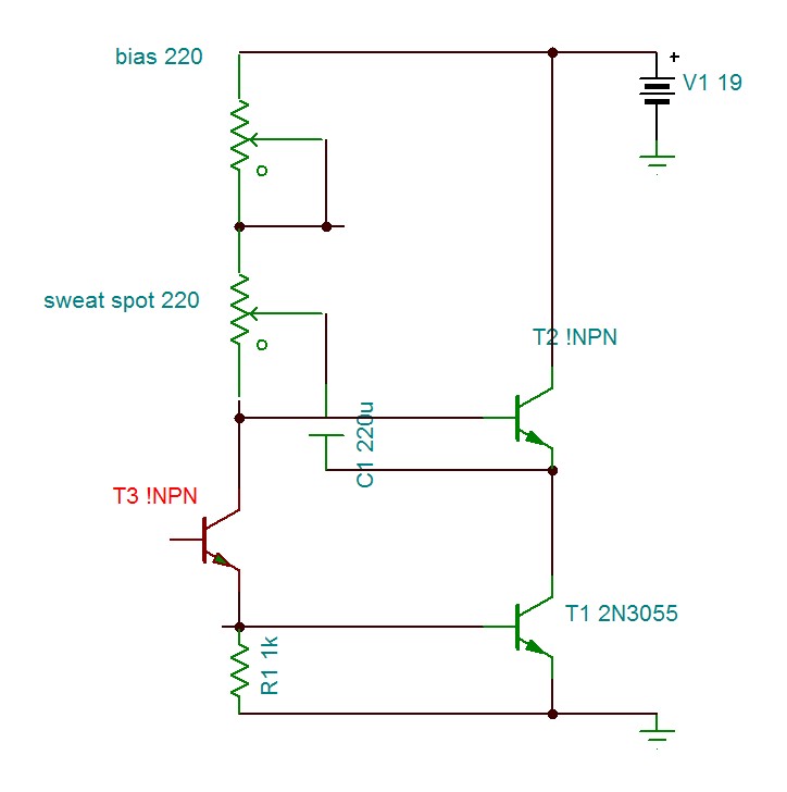

Yes , you understood exactly. You can apply an adjust in series with a potentiometer . The adjust for the bias and with the pot. you adjust the shunting resistor the one which parallels the base emitter. This resistor will balance the gain with the lower one . If it requires too high value than you have very little left for the bootstrap capacitor and the supply. If such occurs, it means the upper has too low Hfe vs the lowers . The IMD and even order harmonics have the same cause , but what concerns sound, the story if different. To give an example, the revered SHURE V15 type 5 most expensive in 80's used mainly by radio station, recording studios has 2.5% 2nd order harmonic 0.5% 3rd and IMD of 3%. The lower output as it is driven by emitter follower works with its Ic/Vbe function . The 3055A having decreasing Hfe above 200ma results very linear Ic/Vbe transfer function . Once the RCA datasheet showed how linear it is in linear scale . Motorola shows in nonlinear one not easy to see . This why I advise you you keep the lower the 3055A . JLH himself preconizes to use of different Hfe s as the two outputs function differently. As 3055 is of low Hfe and speed ,20Khz, you will not have any difficulty to match the upper one.
To sublime it first apply the current mirrors to bias the input transistor 2ma instead of 200ua , and listen the difference.

Along the 2n3055A apply externally the potentiometers, to adjust for your upper chosen output transistor. Once decided, put fix resistors on the PCB.

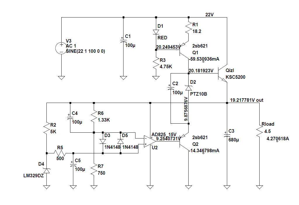

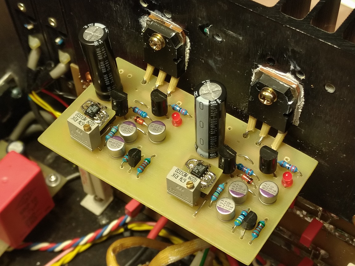

This is the latest version of the voltage regulator for my JLH69, for some wonderful wonder OS-CONs work well in the controller, I usually only use them in digital but they are OK here too. I also changed the drivers, I put in transistors with bigger fT and smaller cob.
The sound has changed again, and it's better again.
I'm going to draw a complete power scheme with regulators, positive and negative when I do all the testing and find the best components and it would be great to try this regulator with Hiraga in A class because it's the next amp I think to do.

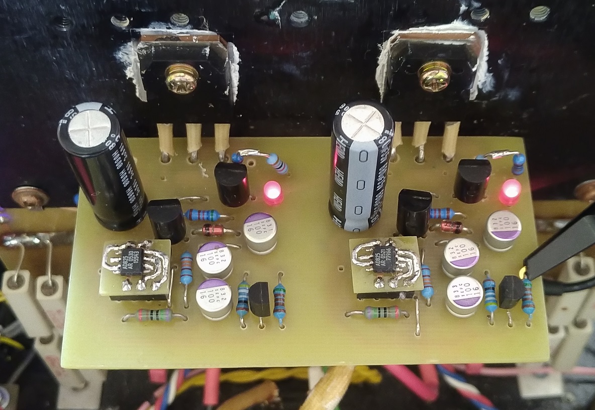

I have been soldering on the board with dual outputs (https://www.diyaudio.com/forums/solid-state/3075-jlh-10-watt-class-amplifier-560.html#post5957967)
I powered one with some odd output transistors I had lying around just to see how it works. Now, there is some oscillation around 2GHz..With single outputs when I touch the driver transistor (BD139), the oscillation stops. If I connect dual outputs, the oscillation is damped and sometimes stops completely when I touch the same transistor.
If I decrease Iq, the oscillation also stops.
Maybe it's a bad PCB design, maybe I have the wrong choice of transistors? I also have the outputs on short twisted leads(C & E twisted, base only parallell to the other two), since they are the wrong package to solder directly to the PCB..
The RC on the output is missing, because I'm waiting for the components.
Is there something I could try as an easy fix to get it stable?
I will try some other output transistors just to see what happens, but since I don't understand the details of the design, I'm asking for some pointers..

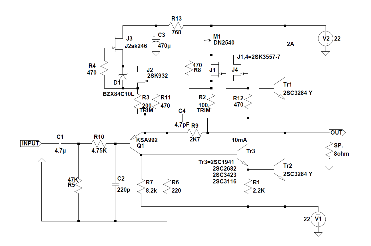

I use fast transistors in my version and there are no oscillations, only with 2SC1941 I got instability and by adding a C4 of 4.7pF I removed it. Nigel Pearson recommended the addition of C4 to me because he too had the same problem with BC337-16. In my JLH69 BC337-16 worked without oscillations and without any compensation.
I currently have a 2SC1941 in the amplifier, which has a fT of 100MHz at 10mA and the outputs are at 2A 60MHz. Instead of 2SC1941 I used faster transistors such as sanyo 2SC3953 where fT is 280MHz or toshiba 2SC3423 with fT of 240MHz without C4 and without oscillations.
The 2SC1941 only has a Cob at 20V below 2pF of the transistors I tried and only it oscillates. hFE for all transistors was between 200 and 400. Outputs have an hFE of about 160.
For the input transistor I now use toshiba 2SA1312 which is 2SA970 but in SMD and certainly not a fake.
