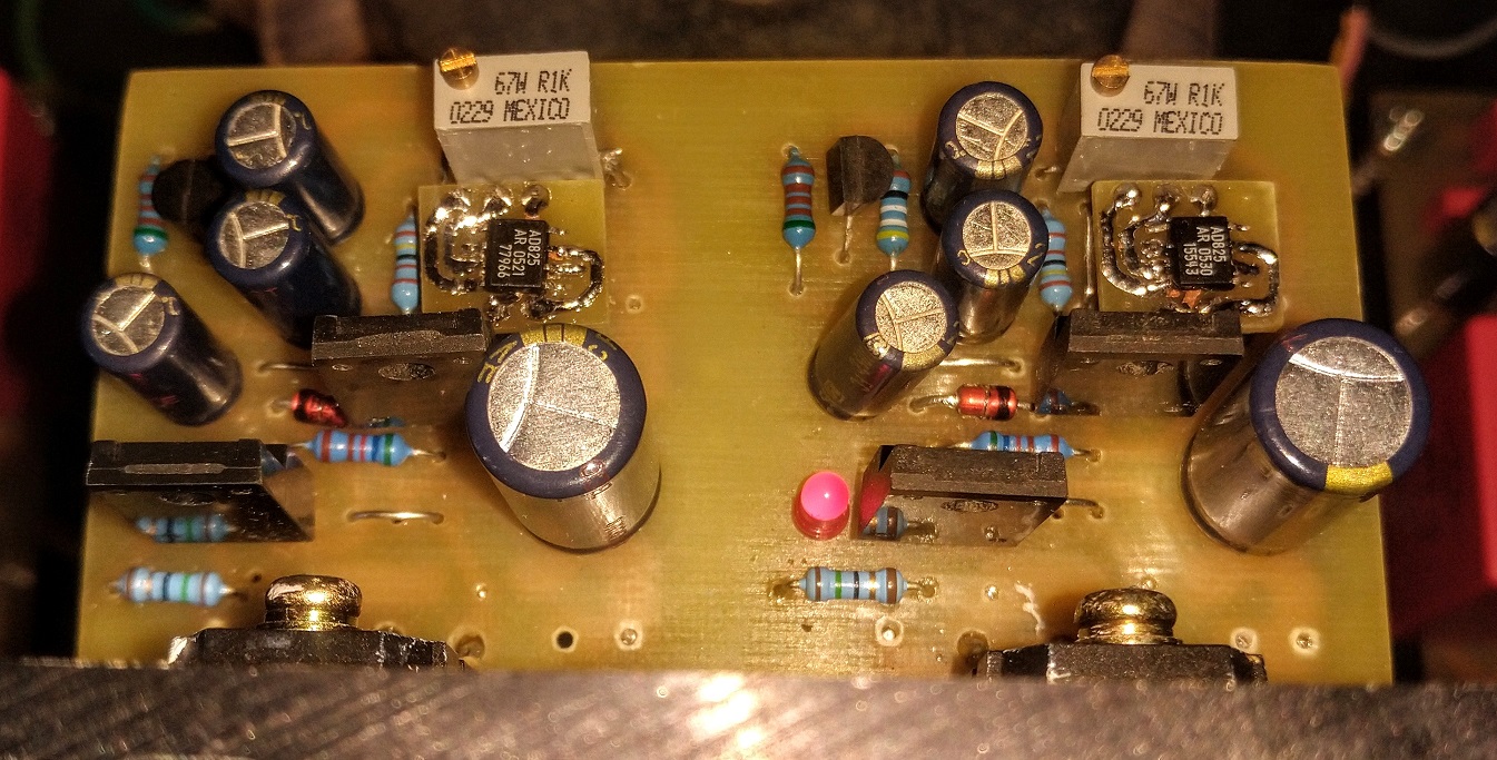

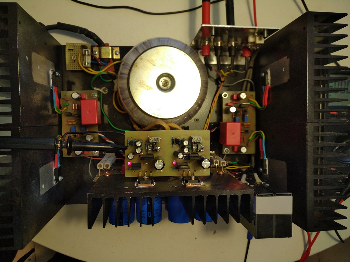

My plan is to make another pair of regulators so that I can separate the power for both channels. I think that will be the final step for this amplifier and I think then I might experience sound enlightenment.🙂
Channel-separate-psus? Do not;-) It is a mistake of the inexperienced;-)-;
And why is that a mistake??

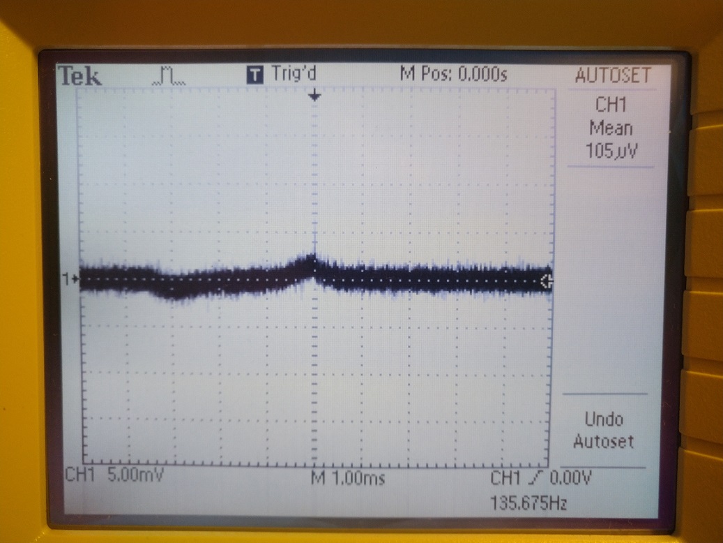

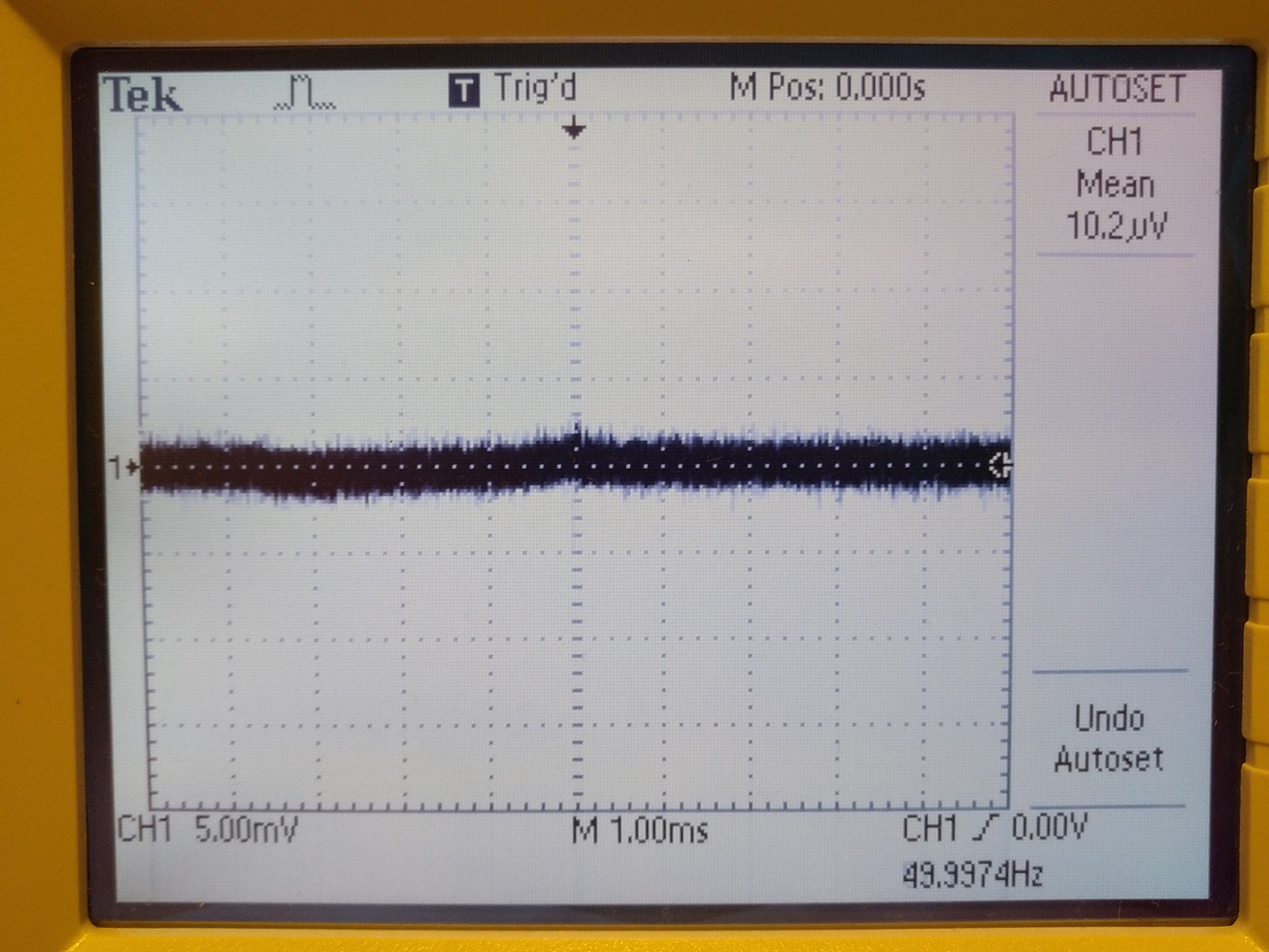

I replaced NE5534 with AD825, there is a difference on the oscilloscope. The AD825 cleared the audio image a bit more. I think whether to replace them with the AD817 because I had the best results with it in Jung's regulators. There is an audible difference between the AD825 and AD817 in W. Jung's shunt regulator.
AD825 or AD817 - I would just try ... to get the best audio-performance;-)

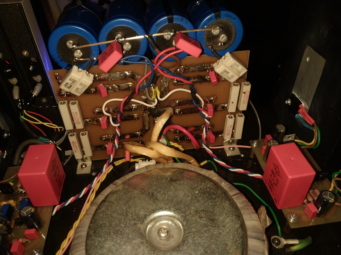

I would replace all WIMAs. Would use the big caps only.
Coupling caps too. Any older electrolytics: do sound very very well. The WIMA MKP screeched and ripped and warped only. The MKS do sound gray and grainy.
The WIMA MKP10 is quite OK for the price / quality ratio, as far as audio signals are concerned, I have never used MKS for an audio signal, they are for decoupling.

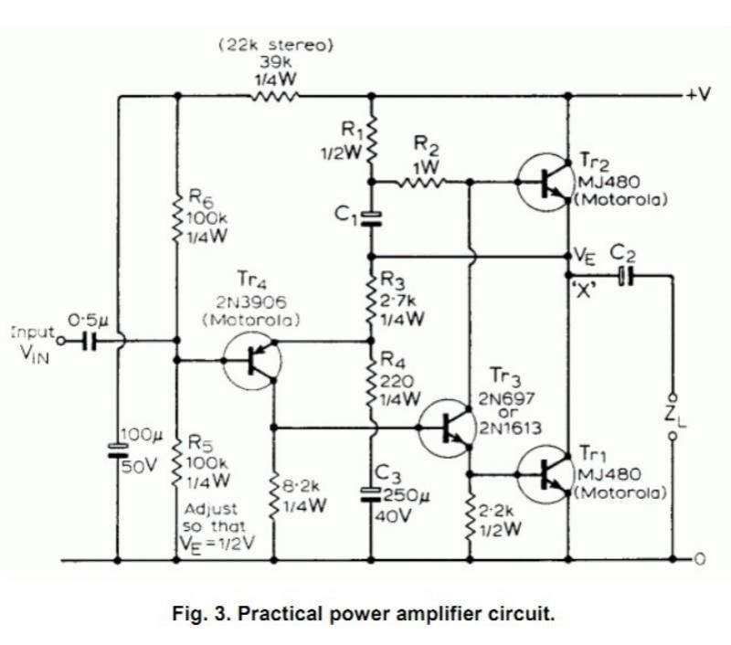

Hi Guys,
I'm planning to build a 3-watt amplifier. Which is better ? A 3w Zen or 3w JLH ?
Thanks.
Thanks.
... for an audio signal, they are for decoupling.
Everything within and outside the box "amp" is "audio signal"-)
A 3w Zen or 3w JLH
I would prefer the Zen.
Or would slim the JLH: No bootstrap, no Tr4 (see below: schemata)
Both with output-cap, no "complementary-psu" (+ and -)-!
... and no WIMAs;-)

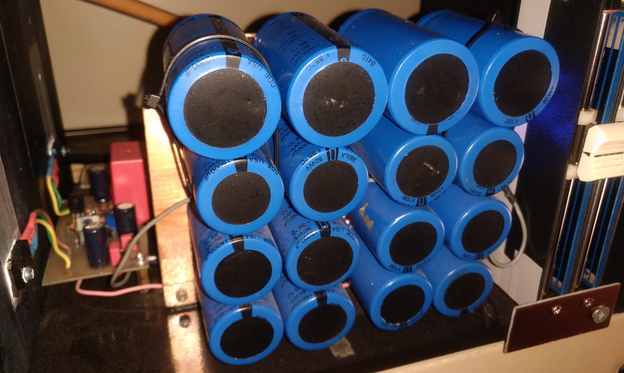

A few days ago I put the CRCRC filter back in power supply before the regulators, I lost another 2V on it and 3V on the regulator so now I have +/- 19V to power the JLH69.
The JLH69 sounds better again, so this combination definitely stays in the amp.
I see you have output transistors on separate heatsinks. Are they connected in some way that is not visible in the photo, or is it not a problem if they are on separate unconnected heatsinks?
It doesn't matter because both transistors have the same dissipation, so they heat equally.

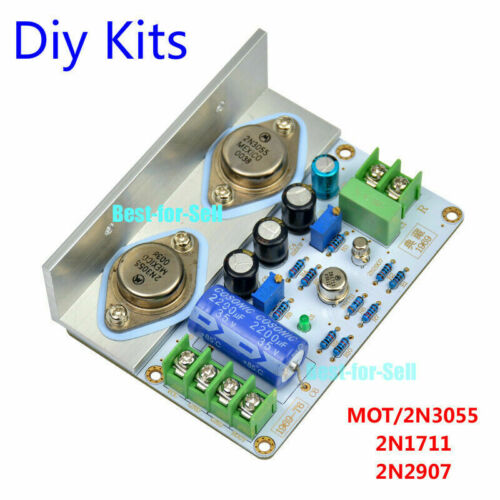

Hello!

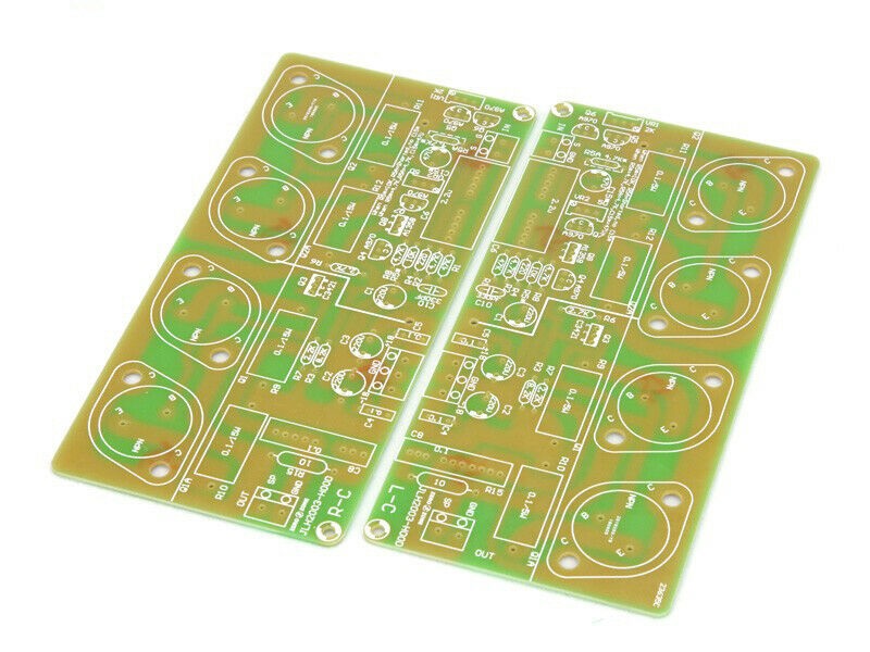

Looking for advice/suggestions on JLH projects here.. I bought a pair of the chinese JLH kits (white PCB 1pc JLH 1969 Class A Verstarker Board Hifi hochwertiger PCB mot/2n3055 Do it yourself Kits | eBay)
and a pair of 'JLH2003' boards with dual supply and double outputs 2 PCs Hood jlh2003 Class A Single-Ended Power Amplifier PCB 2 Kanal 22w+22w | eBay
The white boards I have been thinking of modifying to 'sublimed' ( sublimed JLH1969 )
Or, should I just keep it as is, or maybe replace just outputs?
The dual supply/dual output boards need populating.. any recommendations on what good and easy to find transistors I should use? Possible improvements?

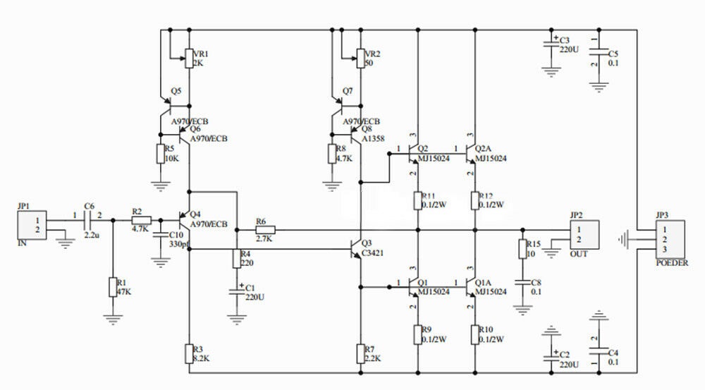

I see now that the dual supply version is the same as the 'Higher power circuit' here: The Class-A Amplifier Site - JLH Class-A Update
I found the following transistors locally:
Q1, Q2 MJ15003
Q3 BD139-16
Q4 BC560c
Q5 BC560c
Q6 BC560c
Q7 BC560c
Q8 BD140-16
Is this a good substitution, or are there better alternatives? The 2sa/sc (toshiba?) are not available.
