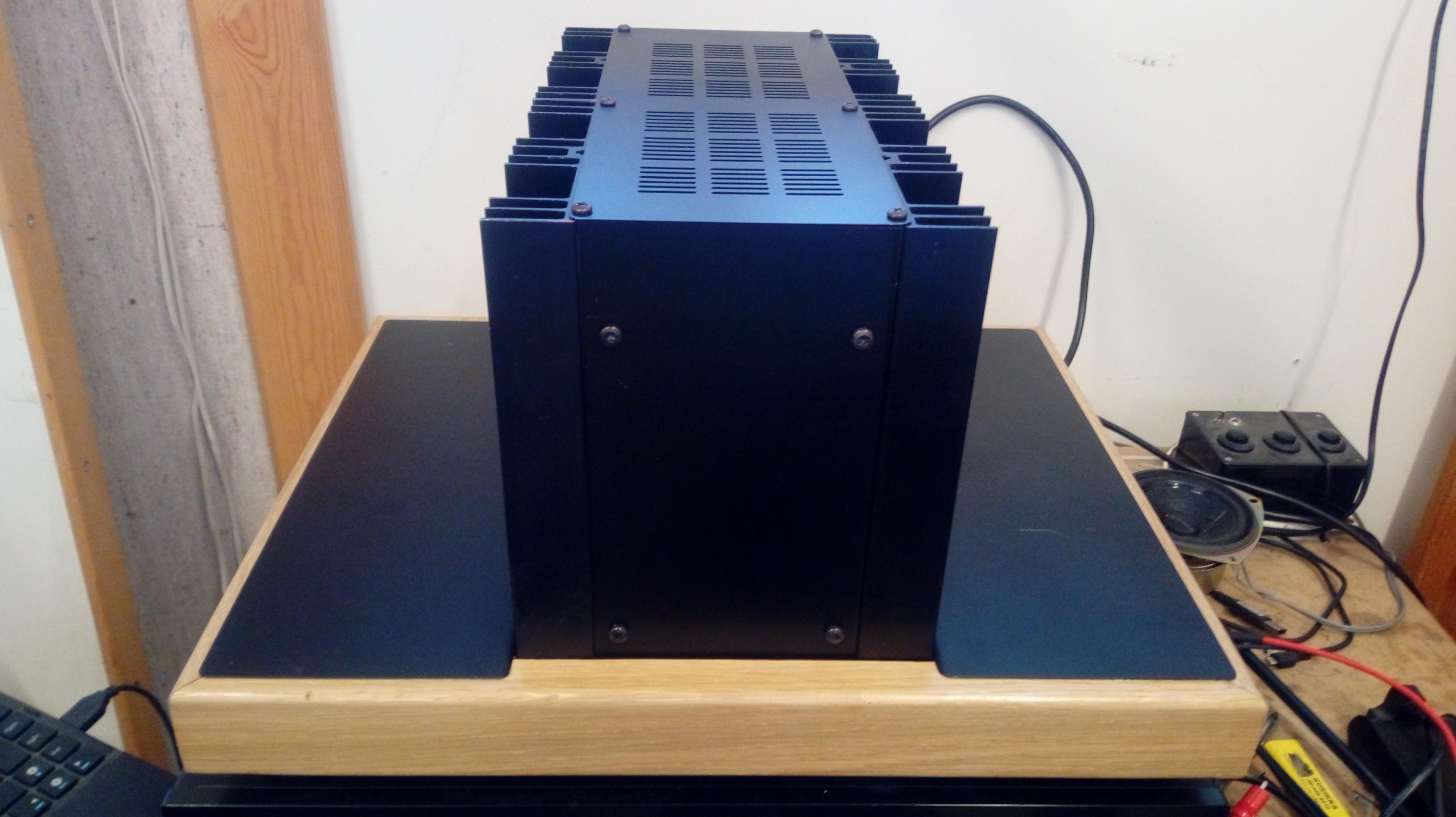

The Zerozone boards have arrived and are up and running. First impression is good, I like the sound, they have not 'failed' any of my test tracks so far.
Had some issues with two resistors not being the same value as the markings on the silkscreen. One was a series resistor on input, and the other in the bias adjustment circuit (connected to bias pot, I think as some kind of voltage divider between rails).
I figured the series resistor on the input was ok. The other one was not, only got the idle current up to maybe 0,1A at max setting.. It was marked 75K, and the supplied resistor was around 500k. I tried the intended value, but only got up to abt 0,7A, so I ended up with 35k, and idling at 1,3A now.
Supply voltage is 19,5V from one laptop brick per channel. I have some C(RL)C filtering too since the boards came with a rectifier and CRC setup.
First one 6800uF, then a small inductor on negative(ground) and a 0R47 on positive rail, after that 4x6800uF+0,5uF polyester.
Tried with only one plain 6800uF first, but sound was suffering, but improved a lot with what I have now. PSU bricks start up fine with this, which I was worried about first.
ZeroZone 'JLH 1969 10W' info
The amp, and especially PSU's, were running a little bit warm for my taste at 1,3A, so today I lowered the current to 1A. It was ok out of the chassis (attached pic of that too), but not a lot of airflow on the PSU's as I installed them.

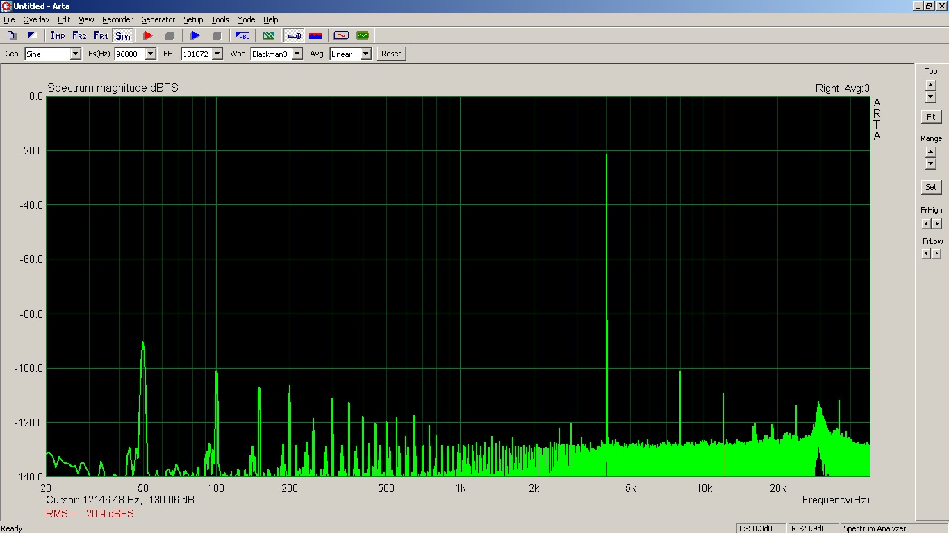

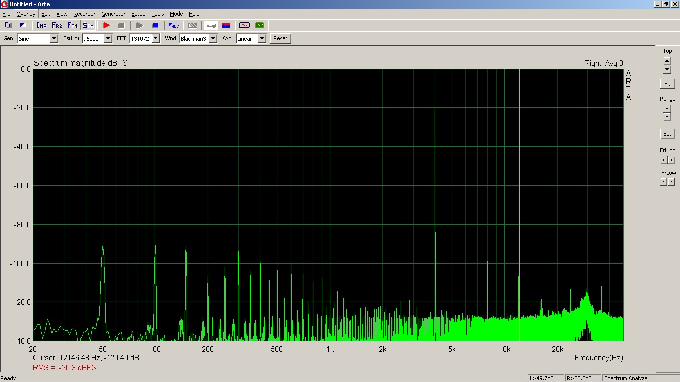

I decided to fo a little bit scientific, so I also tried to do some measurements on it. A lot of factors on the measurements though.. My setup is not very good for amp measurements, I used my 'ARTA box' for speaker measurements, so I only have a fixed attentuator, and since I wanted to measure it at low power levels (2Vpp into 4ohms) where I will use it, the input signal was very low, and that probably affects the ADC in the sound card (Asus Xonar 8ch usb sound card). Please note the -20dB 'reference level'. Measurements are for L & R channels, each averaged three times.
Cables are most likely the cause of the low frequency peaks that are multiples of the grid frequency 50Hz.
Output DAC was running full amplitude, and a Denon receiver was used as preamp.. (another factor). Anyway, results seem ok under the circumstances.
Harmonics went up with higher output, and the third came up to the same level as the second, but higher harmonics were not visible until approaching clipping. The peaks higher up were constant with amplitude, maybe some artefacts from PSU's switching.
I also did a 'reality check' where I compared distortion with 8ohm resistor and some 8ohm workshop speakers (dual tone). They were practically identical, high frequency harmonics were actually slightly lower with the speaker as load.
I could hear a weak beep from the amps around 2,2kHz under load, I suspect there is some resonance in the output caps around that frequency.
I also attach a schematic for it, probably not much 'JLH' in it?

First of all, I love the design of your amp, it is very successful.
thank you also for taking the time to share the conclusions of your experiences with us.
but it misses a lot of details.
how do you choose your transistors (signal and power) (gain, brand), what have you chosen as output capacitors (brand, voltage, capacity)
what is the supply voltage under load because I made several tests with labtop power supply and I have never had good results compared to a conventional linear power supply (transformer / diode bridge / capacitor / resistance / capacitors ).
I also specify that I have always selected and assembled my jlh "by the ear" and based on the work of Mr. Hood and others who took the following
This is only a kit from China, and the name of the kit is JLH 1969 10W PNP.
V18 PNP Sanken 2SA1216 JLH1969 Class A Power Amp Kit 10W+10W Amplifier Kit | eBay
It should probably have it's own thread, since it is not a 'true' JLH design, which was with NPN output transistors.
I posted here because I started writing about it in this thread.
I have not changed anyting in the kit, except for resistor R19 to 36k to get the idle current up. I did not assemble all the capacitors in the power supply, and substituted one resistor in the CRC to a small inductor.

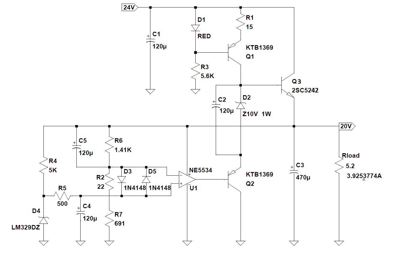

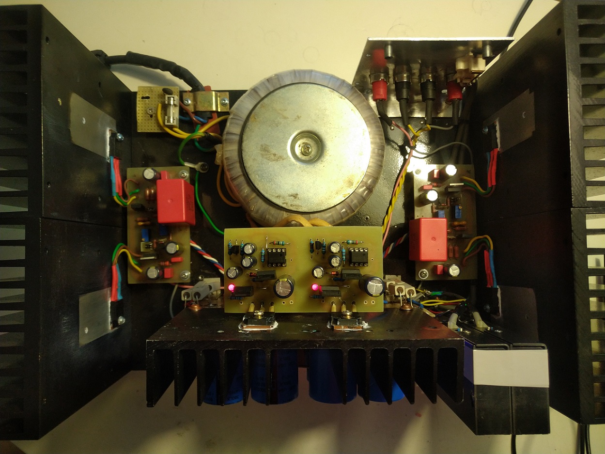

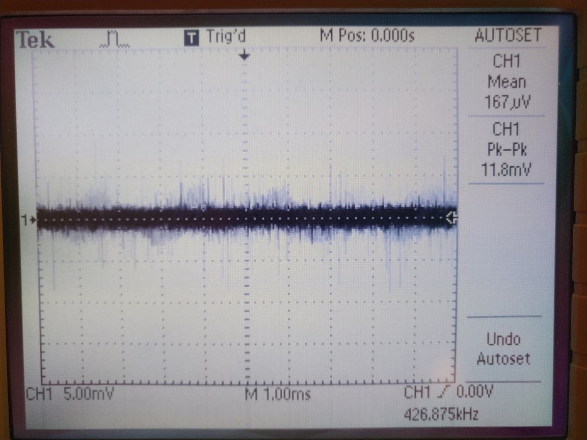

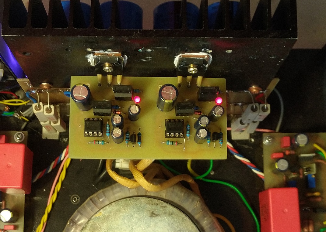

Today I installed voltage regulators in my JLH69 . It is a Walt Jung superreg that I boosted a little. The output voltage is +/-20V and can withstand currents greater than 4A.The voltage drop for good regulation is 4V.
The difference in sound was immediately felt. It was as if I was removing the curtain from the speakers, so many new details came in, the quality of the recording and the studio was exactly felt, the sound stage was literally in my living room, it really sounds wonderful.It played great before, but now it has gone to a higher level.
A few days ago I inserted another RC element into the power supply, so I had 30000+30000+30000uF old + 24000uF new, the resistors between were 3x0,24R, there was a difference on the oscilloscope and also in the sound but not like today with the regulators. At the moment I put jumpers on the resistors so I do not have a voltage drop of 2.5V on them. So I provided a larger voltage drop for the regulators. For the test I will reset it, but then I will have to adjust the regulators to a lower output voltage.
My plan is to make another pair of regulators so that I can separate the power for both channels. I think that will be the final step for this amplifier and I think then I might experience sound enlightenment.🙂
https://refsnregs.waltjung.org/Improved_PN_Regs.pdf
