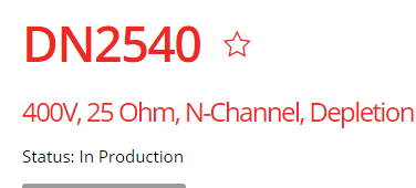

I think DN2540 is obsolete now. A depletion type if I am right? More like a jfet or vacuum tube. Again a bipolar CCS would be interesting and what best sets standing current. BC327-40 could work. An emitter resistor almost ensures linearity and is the current setting. Most MOS FET and all bipolar are enhancement (?) devices. The CCS for them look different. Bipolar types need about 0.55 to 0.7 volts to to switch on. This means a calculated design will be very close to actual result. Other devices may spread 2 to 4 volts.
The DN2540 is still in production, in three different cases.
dn2540 Microchip MOSFET | Mouser Croatia
DN2540 is depletion type and in my case it needs Vgs of -0.8V for 30mA. This CCS I think to improving with a better mosfet with lower Vds and maybe with a cascade with FET at a lower position although DN is doing its job well.

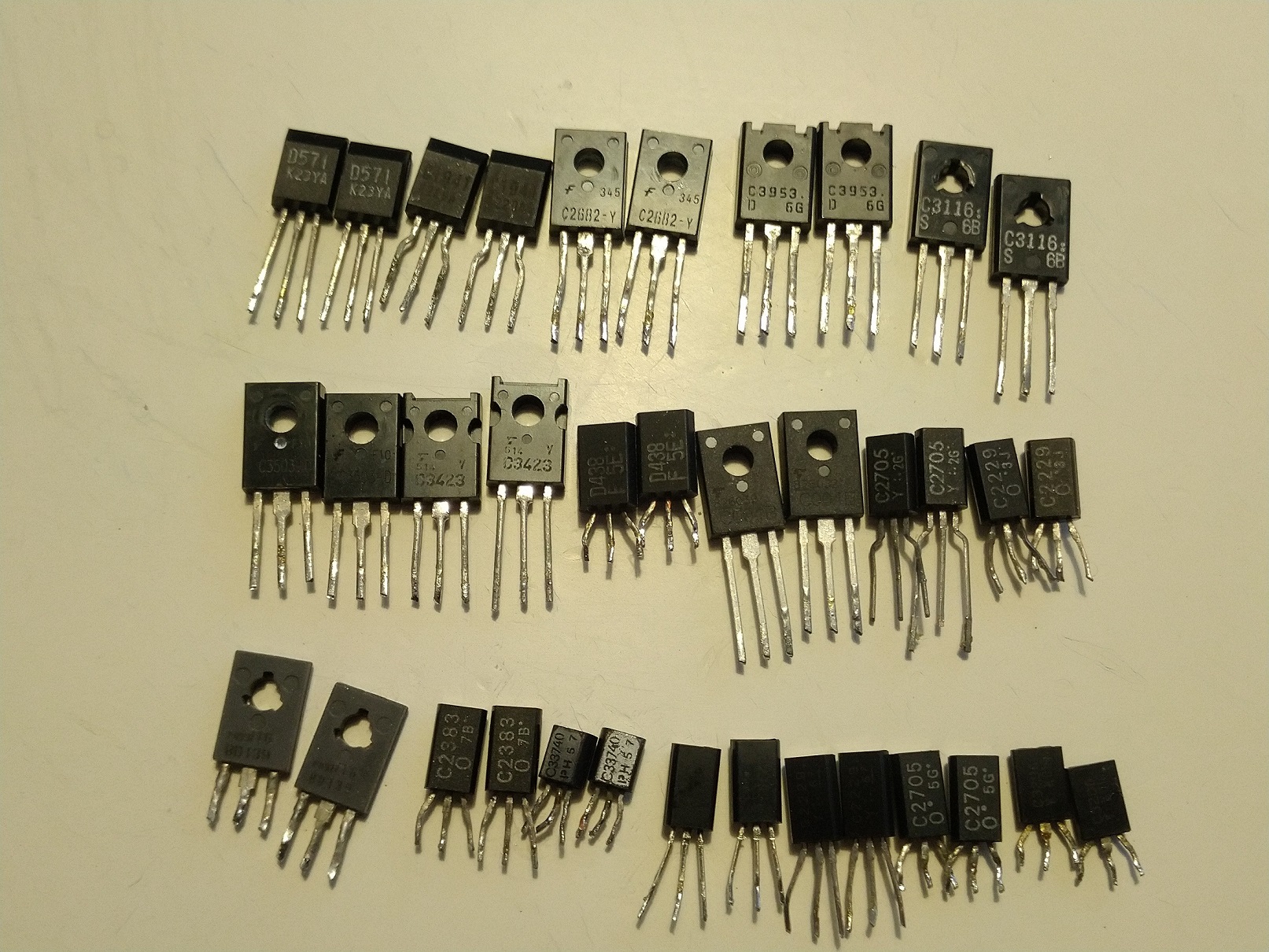

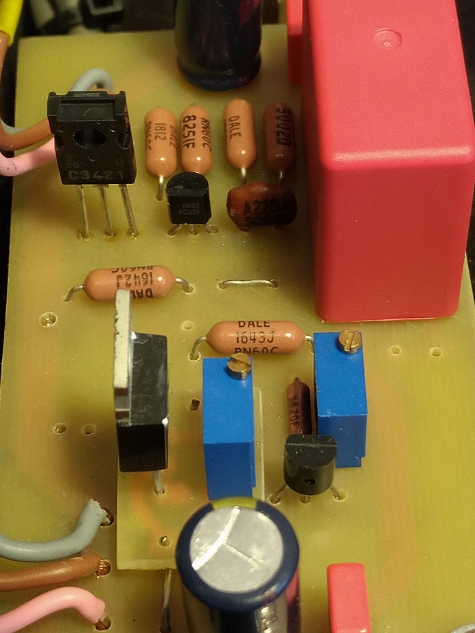

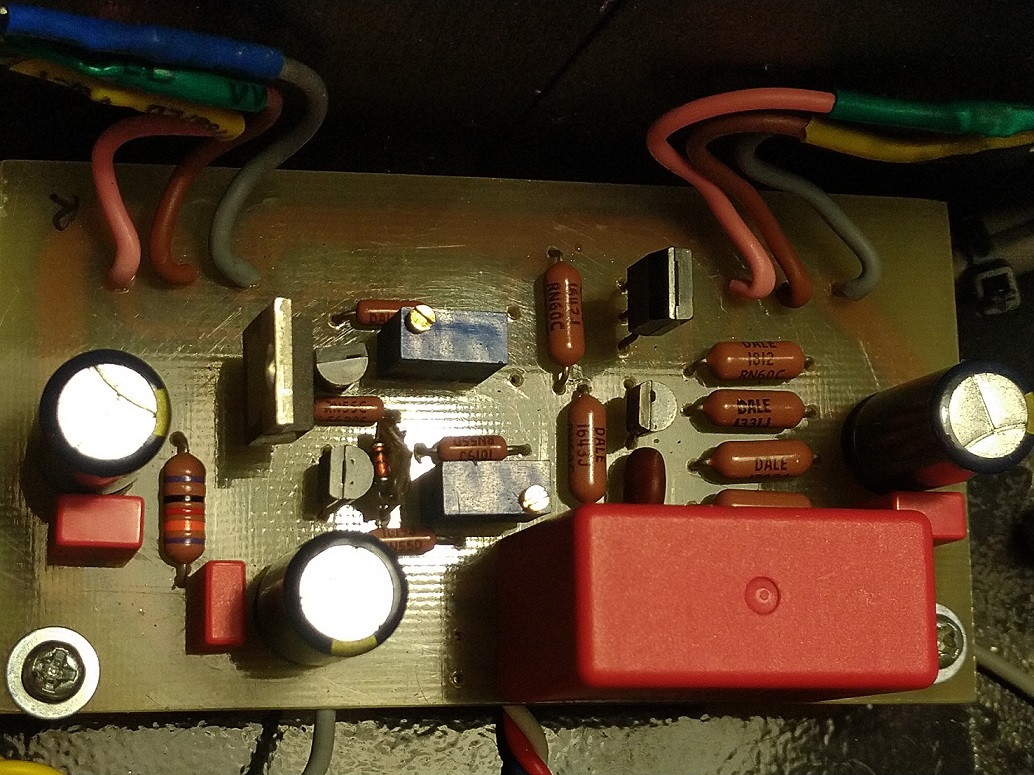

This is a collection of transistors I've tried for Tr3. There is a difference in the sound whether the scheme is with botstrap or with the CSS for Tr3. 2SC3421 I deliberately left the end because it was listed as the best replacement for 2N1711. And now I can say it's not worthy of that title.
My favorites are 2SC1941, 2SC3116, 2SD571, 2SD438, KSC2682, KSC3505 and 2SC3423. The 2SC3421 is missing the stage width, somehow it is muddy.

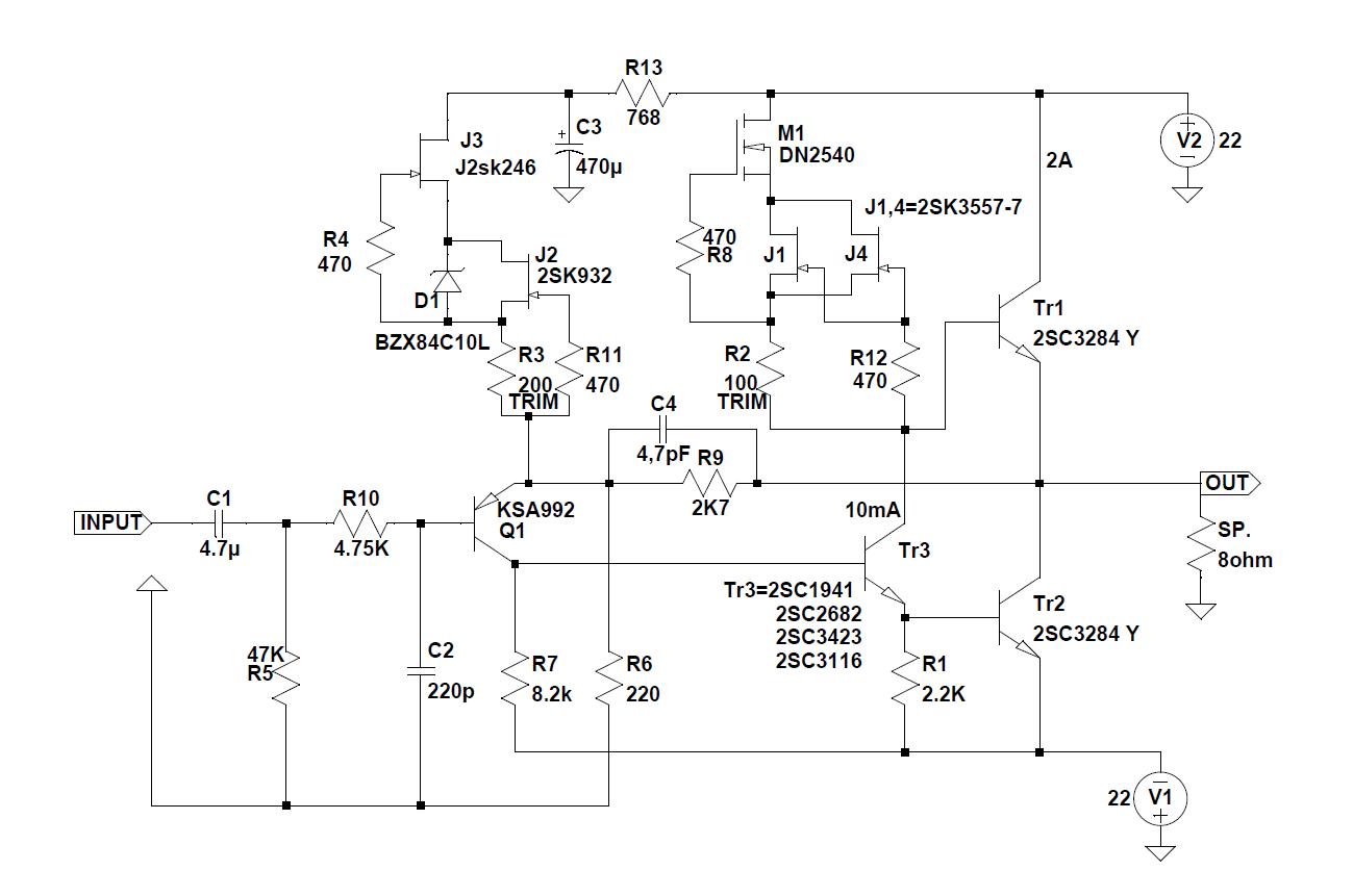

Here is a new version of JLH with CCS, the first CCS formed by a pair of cascoded FETs, and the second with cascoded depletion MOSFETs. The sound is really great, so far the best improvement.

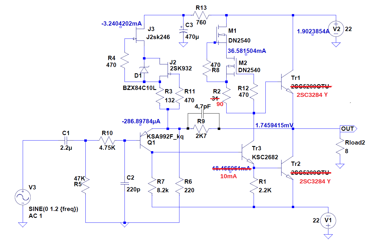

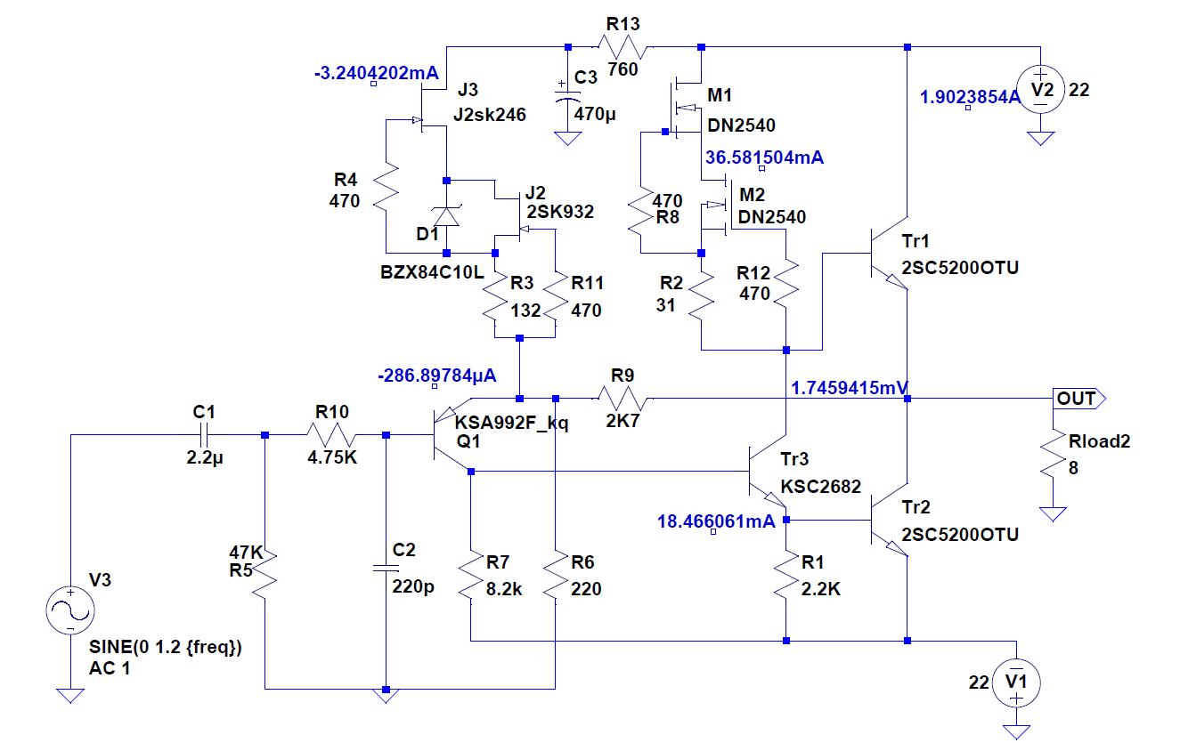

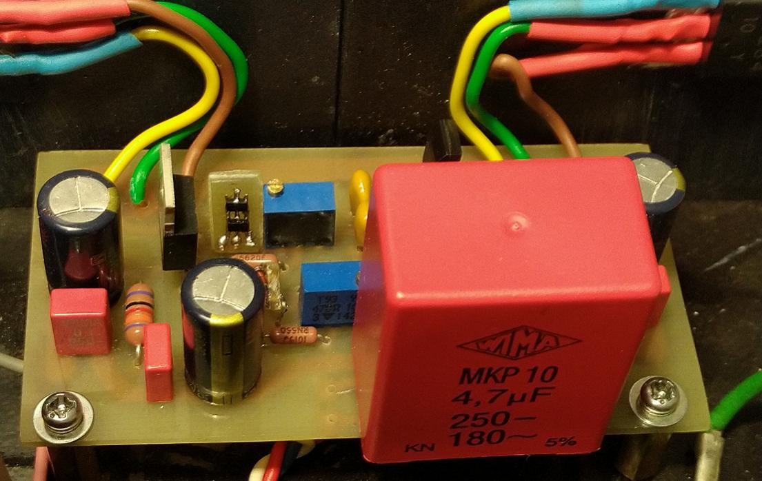

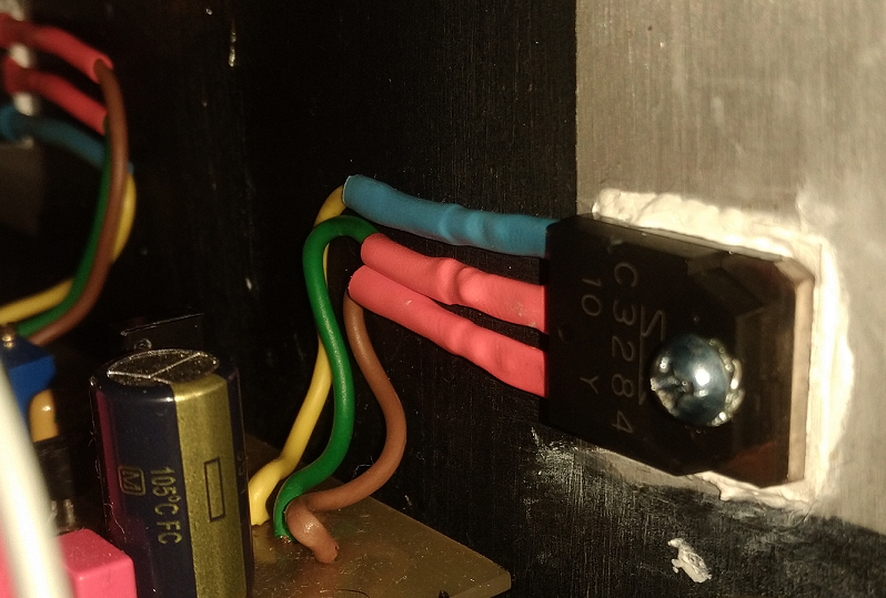

A few days ago I changed the outputs in my JLH amplifier. I put 2SC3284 Y (hFE 170-180) instead of 2SC5242 O. The current through Tr3 has dropped significantly to ~ 10mA. In my measurements Sanken has almost double hFE according to 2SC5242 O. There is also a big difference in fT, 60MHz vs. 30MHz, Cob is the same.
After installing new CCSs https://www.diyaudio.com/forums/solid-state/3075-jlh-10-watt-class-amplifier-553.html#post5686739, oscillations occurred when using 2SC1941 K with Cob below 3pF for Tr3. The problem was solved by adding mica 4.7pF in parallel with R9. The same capacitor stayed with 2SC3284 and now works without problems with 2SC1941. For Tr3 I have more favorites to try.https://www.diyaudio.com/forums/solid-state/3075-jlh-10-watt-class-amplifier-553.html#post5678173 For now I have tried KSC2682 and 2SC1941 and can not decide which one is better. I'm waiting for an independent hi-fi listener.
The amplifier sounds again better, the more details come to light and the lower part of the bandwidth is also gained on the dynamics.

There are two things you can do without getting an independent hi-fi listener.
First one can get used to the change over a period since it takes some time to adjust to differences or in my case I can ask my wife to listen. That can be a quick reality check.
There was an engineer named Eckersley who famously said about bandwidth "the wider you open the door the more the muck flies in". In this case it is the back door with a 4.7pF capacitor as the foot keeping this open.

The decision fell to 2SC1941 which has a more natural sound, 2SC2682 is a little tough, but both are great, beautiful space and details.
I made another change today, instead of the bottom DN2540 in TO92 I inserted two FETs 2SK3557-7 in parallel. I also changed the input polypropylene from 2.2 to 4.7uF.
The sound was again improved. The same combination of CCS with MOSFET and double FET I have already used for tubes with excellent results so I'm not surprised by the result at JLH69.
At the moment this is one of the better (and perhaps the best) amplifier I've listened to.
