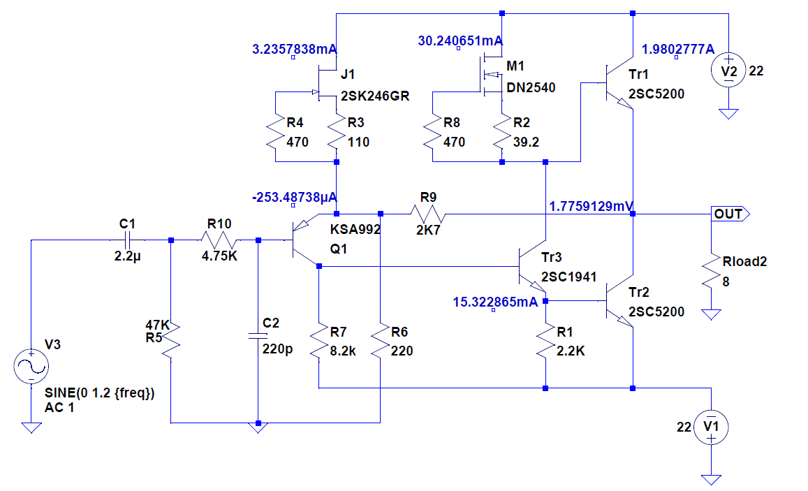

For cooler running I would limit the supply rails to +/- 22Volts which is the point I started out with the simulation I am posting. The idea to use MJL3281 super beta output transistors was to reduce the current demand on the split phase transistor - a 2N5551 in this instance.
This is rated variously at 625 m.W. (or 1W in an old Motorola Small Signal Databook) I have a couple of Motorola 2N5551's in my old stocks. In the simulations here the median dissipation is about half of the lower figure.
There is a version of this device where the collector and emitter leads are crooked out to fit wider track spacing. This allows the pads on the copper side of a pcb to be a little larger. In theory some of the heat in the body of the transistor will travel down through the leads into the copper of the pcb.
If dissipation in this transistor becomes an issue with a requirement for high output current levels then 2SC 3503 or KSC 3503 would give a close enough result.
The latter and 2N5551 are not available over the counter in electronics stores and there are no major warehouse suppliers where I live. Some of these will sell only in minimum quantities like 200 which I regard as a turn off.
There is another option use a 2N3904 and cut down on the output current and power level to a little bit more than the 1969 Class A which should be adequate with reasonably sensitive speakers and more than enough with some of the larger and more sensitive ones.

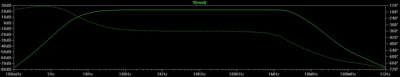

The simulation attached is to determine the stability margins. In this R5 and R14 need to be variable for adjusting dc offset and output current. R10 connects to the negative rail rather than earth. The intention here is to allow a thermal cut out to be mounted on a heat sink to turn the amplifier off if it gets too hot - or otherwise if the negative rail fails the constant current sources will be disabled and avoid a dc fault on the output line.
To run the simulation copy the expression in blue on the .asc file i.e. -1/(1-1/(2*(I(Vi)@1*V(x)@2-V(x)@1*I(Vi)@2)+V(x)@1+I(Vi)@2)) right click to run and click on vout. In the .raw file the expression V (vout) will show in the title header. Right click on this and delete that and paste in the expression copied as above.
In the attached cursor box select the option for cursor 1 and 2. Drag cursor one horizontal as close as you can to 0 dB and use the left and right arrow keys on your keyboard to make fine adjustments. Repeat this exercise with cursor 2 and drag this as close as possible to - 180 degrees and use the arrow keys to make fine adjustments.
The gain and phase margins are shown in the box at the bottom. A phase margin of 45 degrees is about the minimum however simulations are predictions which don't take account of stray capacitance and variations in transistors. Alterations in phase start a decade in frequency in advance of the point where gain has declined by 3dB you should be able to check this using the cursors.

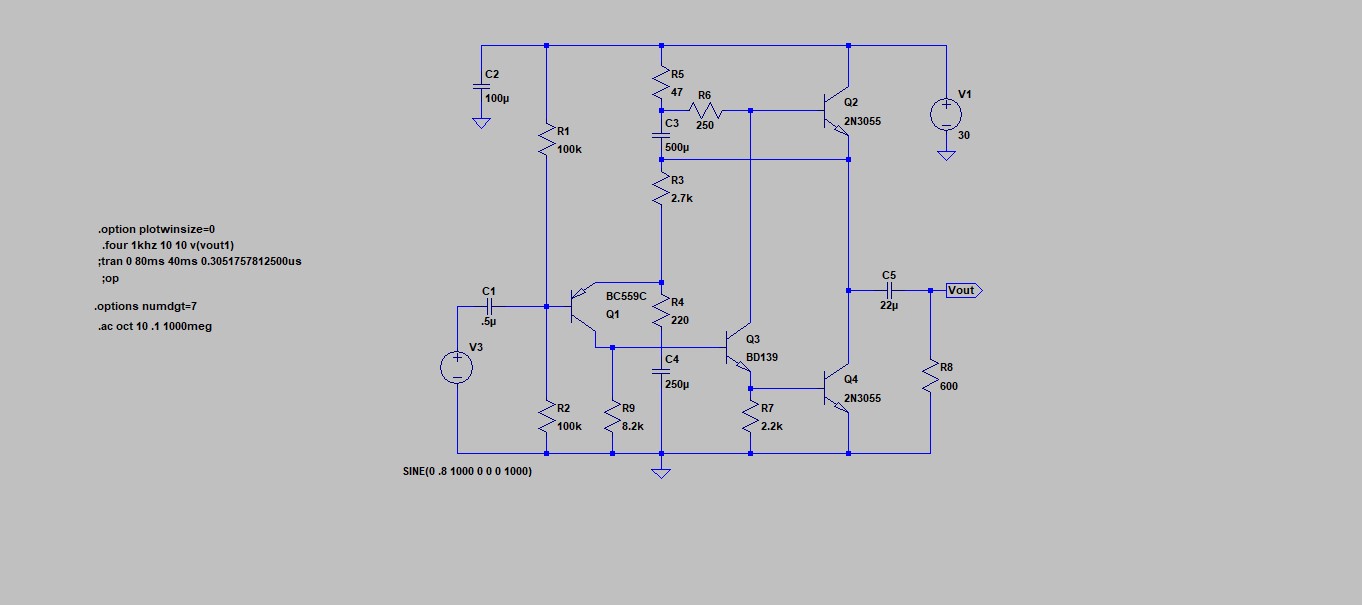

Great idea. If like the old Senheisser HD414 mk1 one needs the most voltage swing you can get. Perhaps use BD139/135 outputs. What a great idea. Do have capacitor coupling to protect the phones from DC. I lost a few when I didn't. You might need a regulated PSU to reduce hum. 22uF in pairs ( 44 uF ) 250 V polyester perhaps.
Here is a bit of fun I did. Would make a great preamp that can drive headphones. The green resistor is a bit of Folk Law. The BC337 40 is very high current gain. Even a LM358 will be in class A when so ( don't ). Good example of how high gain modern transistors help a JLH. I tried NE5532, TL072, MC33078. The latter I liked best. I had some OPA2604 also.
These are notes to myself. The BC337 is runing too high really. Look how I won't spend the extra penny on the CCS's. That was for fun really. Doubtlesss some error somewhere. Somethings are from before in another test. The results are real. I always remove one part at a time if simplifying.
I remember in to 600R it would be very good.
I said 44uF as it is low cost and as you say gives 10Hz. Some think even for headphones that is good. In theroy 200Hz is the lowest note the ear " really " hears. The other 20 Hz to 200 Hz is ear type devices in the body, often lymphatic area. One should always keep an open mind when so cheap do. The brain seems to synthisise when no ear body ear in use.
If you took my headphoneamp and used a NE5534 I would guess a 6 watt + version could be made that should be close to the JLH. You need very high gain transistors and about 0.7 to 1 amp standing current. I t can be argued the transistors can be different and 1N4004 is where you start for the CCS side 1R is about 0.7A. Big heatsink and PSU. Say a NE5534 can give 20 mA and the transistors gain of 100, it looks possible. If class A driver added even better. Not sure if a Darlington to the op amp and single type to CCS could work. If it did it is a very pure design, simplicity would be a better word. At 1 mA the 5534 will be in class A. If you had a MJ3001 and 2N3055 in the junk box it could work. Impressive if that nasty pair sounded nice. Tweak the 5534 comp to your taste. There are better/cheaper choices for transistors. +/- 17 Vrails at a guess.

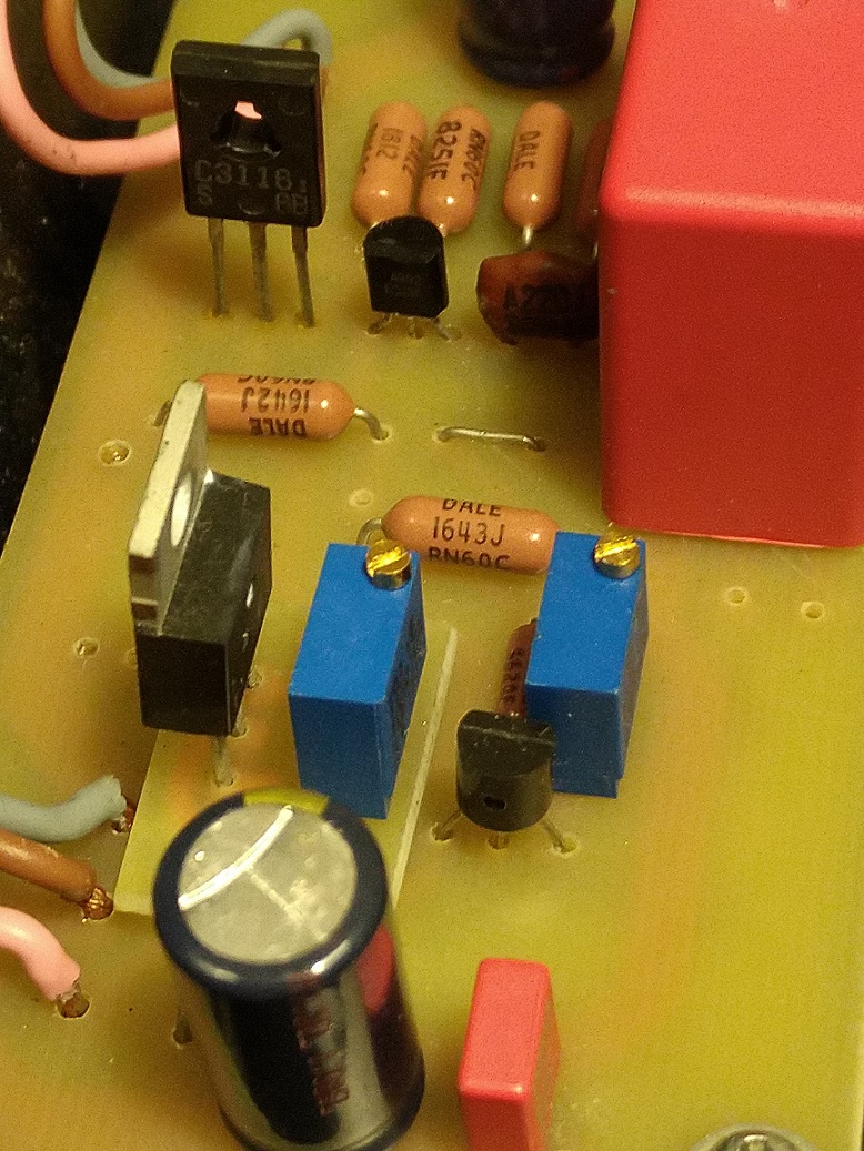

Last days I made a modification on my JLH, I added another CCS for Tr3 made from one DN2540.
The bootstrap amplifier sounded great, I used Black Gate 470uF / 35V, but the other CCS added a bit more dynamics and detail.
I tried a little different transistors for Tr3, but now with the other CCS I have to do it all again.
Before CCS I tried, KSC3503,2SC2229,2SC2383,2SC2705, BC337, BD139 and my favorite 2SD438. The best sound for me have
1.2SD438
2.KSC3503 / 2SC2229
3.BC337-40
2SC2383 and 2SC2705 was a disappointment.
With CCS I have been testing 2SC1941,2SC3593, KSC3503 and today 2SC3116. 2SC1941 was a real invention, I did not have such a sound with bootstrap before. The KSC3503 is no longer brilliant as the 400MHz Sanyo 2SC3593. The 2SC3116 I listen to this afternoon is also a good choice, but I need to give it a few more hours.
The amplifier was stable without any compensation to all the above transistors.
For the next test I still have 2SC2690,2SC3421,2SC3423
It also seems to me that now has a great deal of hfe from Tr3, the higher hfe has a better sound.
