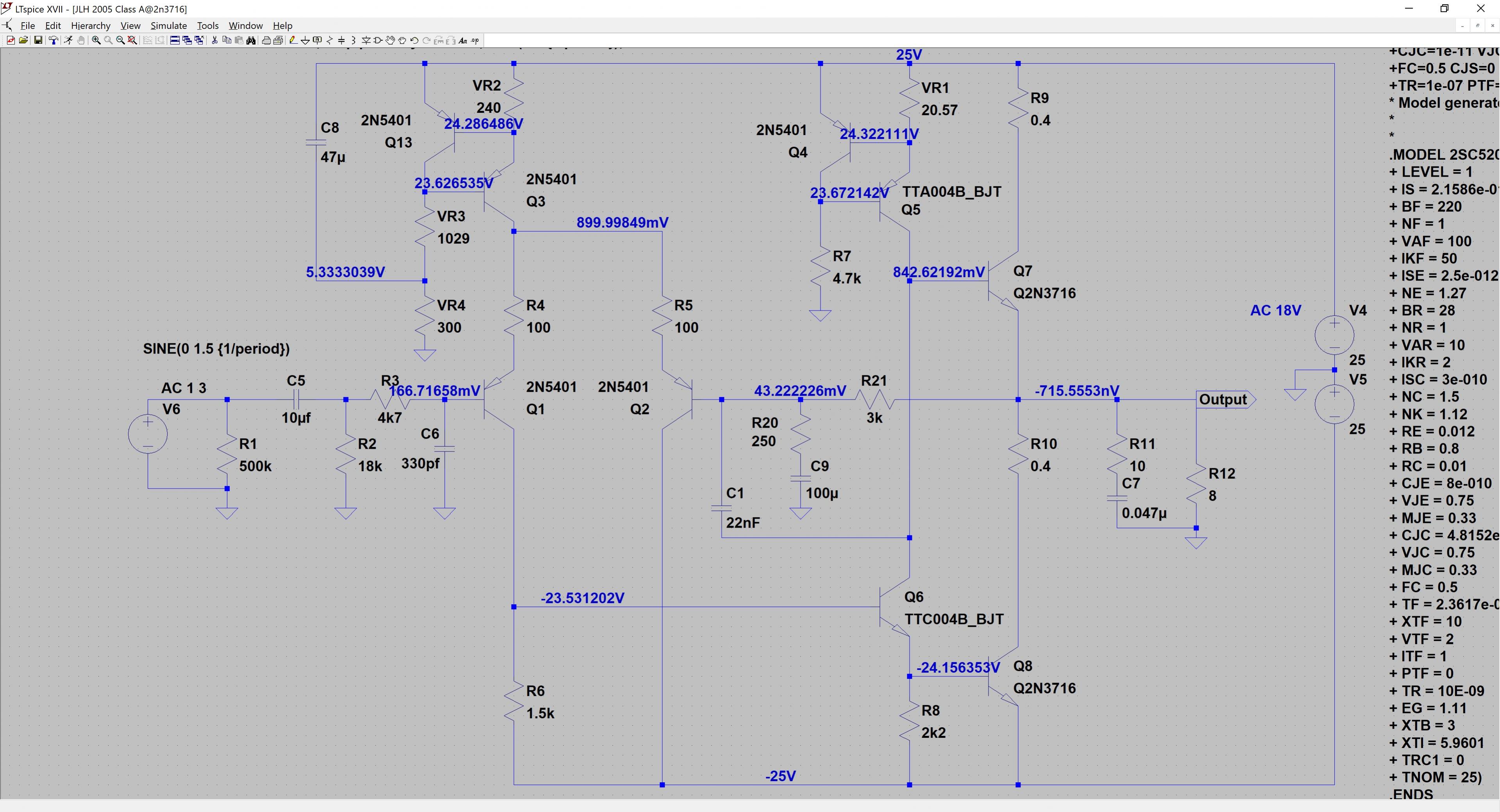

Hi All, attached is a dual rail supply, CCS variant with differential input. Quick question, what is the recommended current for the differential input Q1 and Q2? Is the CCS Q3/Q13 adequate for this purpose?
To make the dc offset to zero, the differential input ccs is running as low as 0.79mA. Not sure if it is a good idea or not.
Please feel free to download and play with the circuit, any recommendation or modification are more than welcome!
If you look at conventional LTP circuits you will see lower values for R6 than 8.2k. If you reduce this to 1.5k then VR2 can be reduced to 240R.
In addition to getting ccs currents right, the transistor bias voltages have to be right
Also with LTP stages you will need a compensation capacitor to make your amplifier stable. Using Hood's method this would connect between Q6 collector and Q2 base and and the matching capacitor value will be relatively high in relation to Q6 collector current.
Ideally this capacitor should be made as low as possible, to keep the additonal loading on Q6 collector current down, and this is not helped by a value of 2.7k for R21.
Increasing the feedback network resistors allows proportionate reduction of the capacitor value needed. In your simulation I looked at 18k with R2 equal to 1k. Sometimes it helps to improve stability by increasing closed loop gain so give this a try.

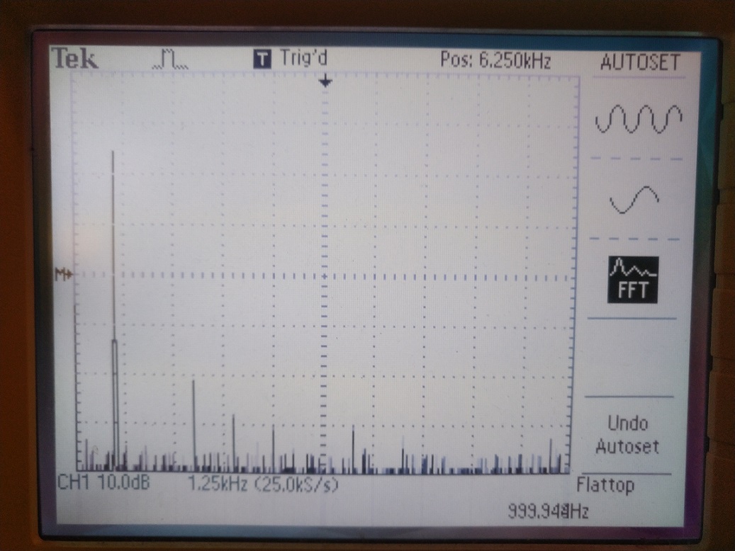

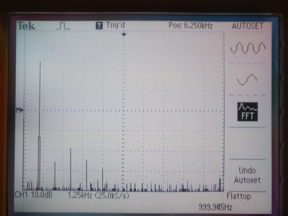

Today I have repeated the oscilloscope testing for KTC3206 and 2SC2705.
The results are not exactly what I expected, especially for 2SC2705 which is 2SC3423 in the TO92 case. It seems that 2SD438 (sanyo) is the best, not just by oscilloscope but also by sound tests.
I still have to try 2SC2229 and again the TTC004B, and I hope I get some Y versions of C2705 and C2229 for testing.

In a common emitter stage the gain Av = gm times the load in k Ohms where gm is about 40 per m.a. of collector current.
If the to be driven stages that follow the LTP have low impedance the outlook is not rosy.
In one of my simulations I could apply 21 dB of feedback at unity gain. At this point the phase shift is -100 degrees, giving 80 degrees margin and a gain margin of - 31.7dB.
I have not looked at a THD simulation since this is not a stand alone circuit.

Hi Mjona, thanks for your comment, much appreciated!😀 I hope I get it right with the modified circuit. Seems that if I increase the feedback resistor R21 anything >4k, I can't get the dc offset >100mV. 😕 Any comment are welcome 😉If you look at conventional LTP circuits you will see lower values for R6 than 8.2k. If you reduce this to 1.5k then VR2 can be reduced to 240R.
Your circuit does not look too much different from simulations I have done for a lower power version LTP which I have not found the time to build.
The resistor values I gave in my last post were drawn from this so it is not hard to see where changes can be made. For the moment you should look at increasing the values in your nfb divider network - for a start try 22k and 1.8k and tune the emitter resistor value in the first CCS transistor.
I will look at doing some fuller simulations of your circuit in the next day or so. It is interesting that the Beta factor (BF) of 2N3716 is highest of the two power transistor .models

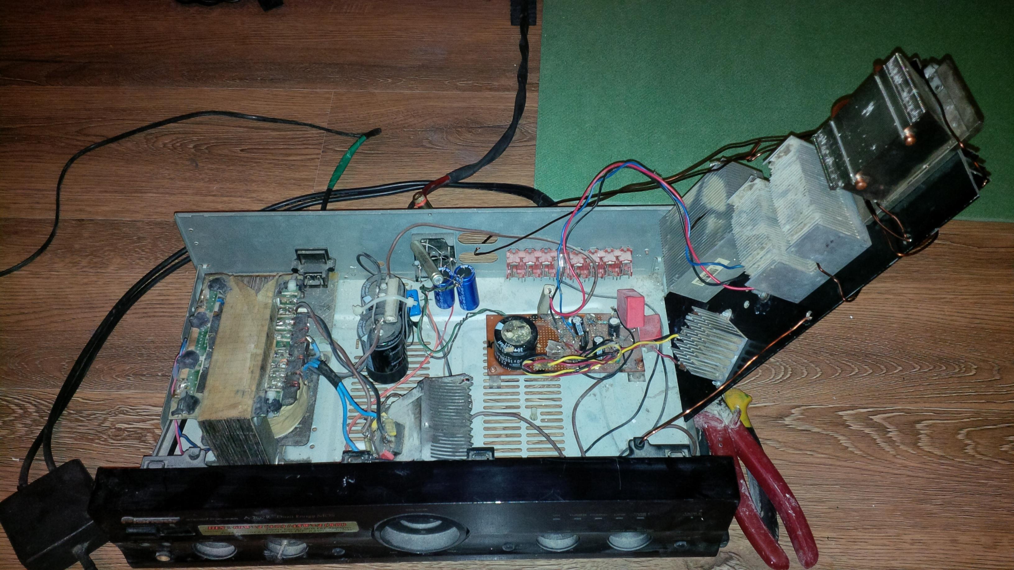

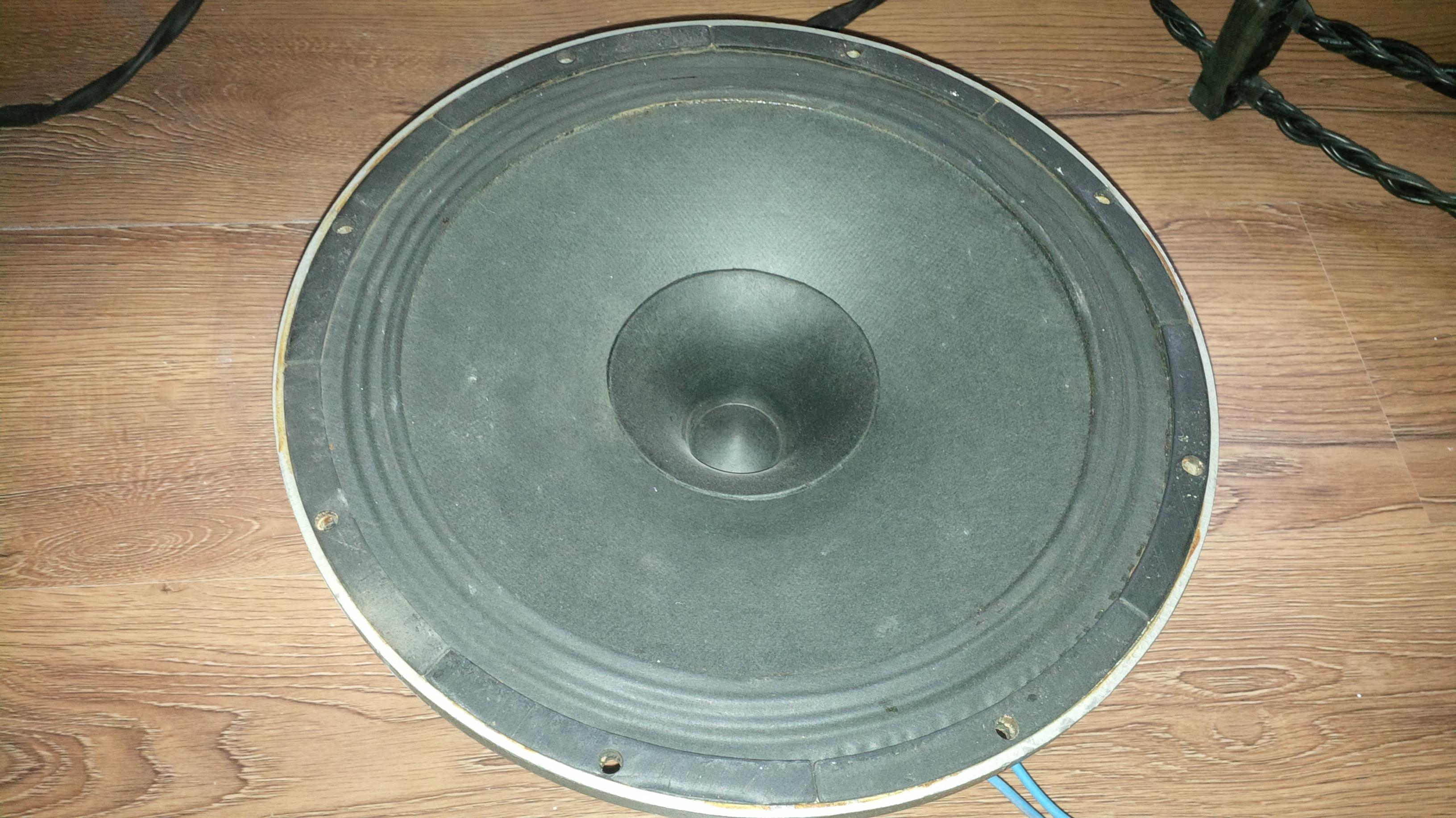

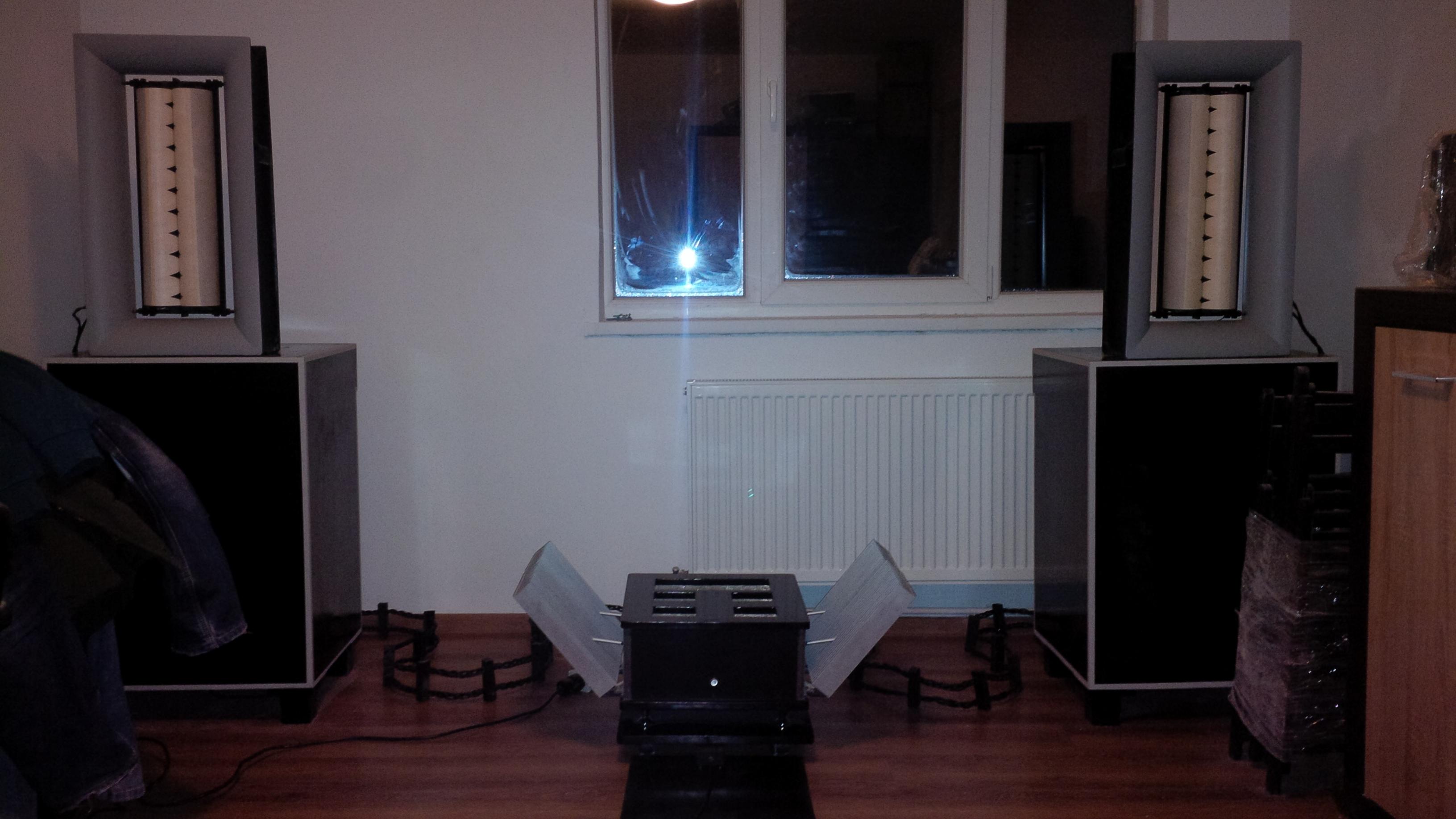

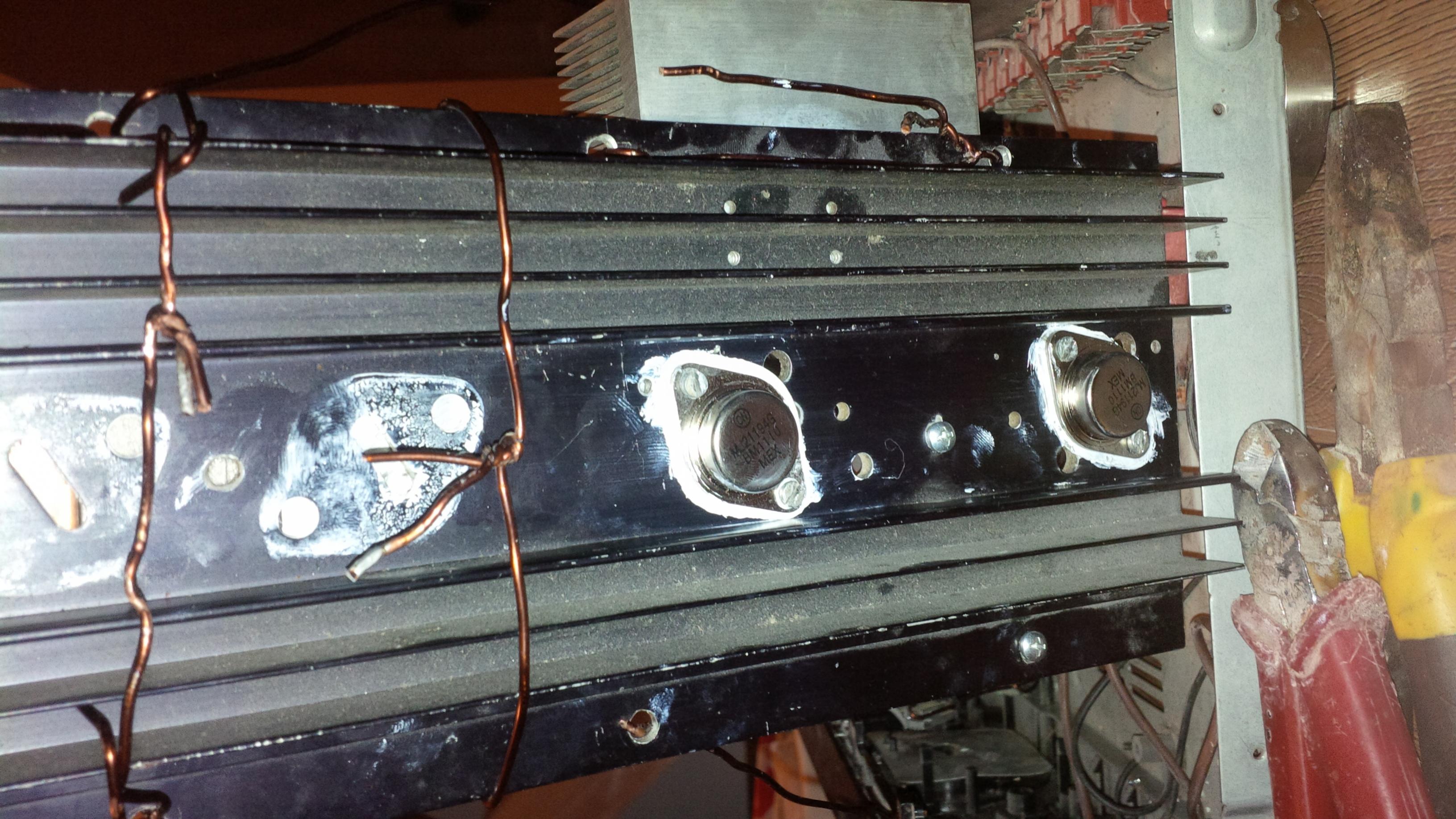

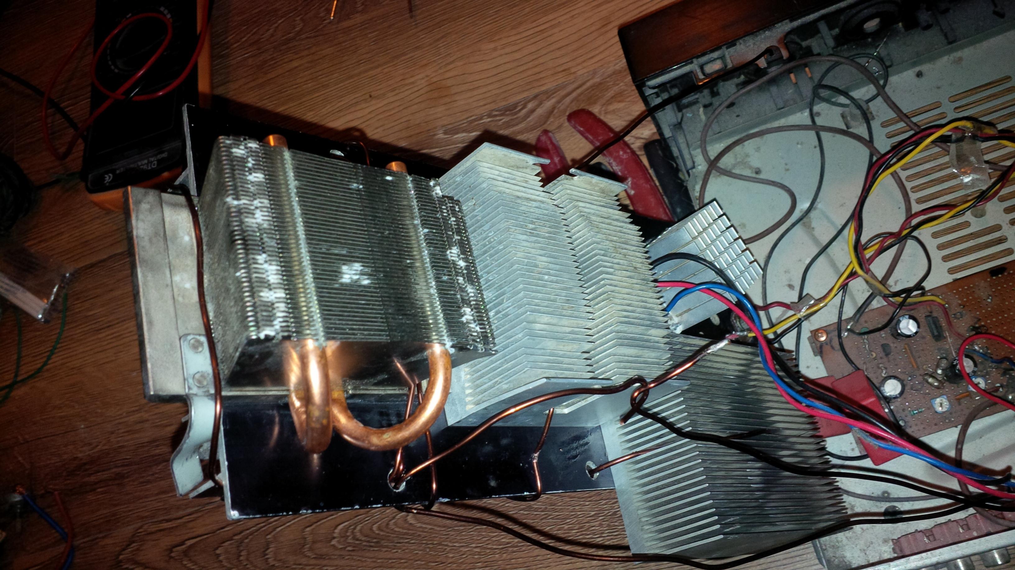

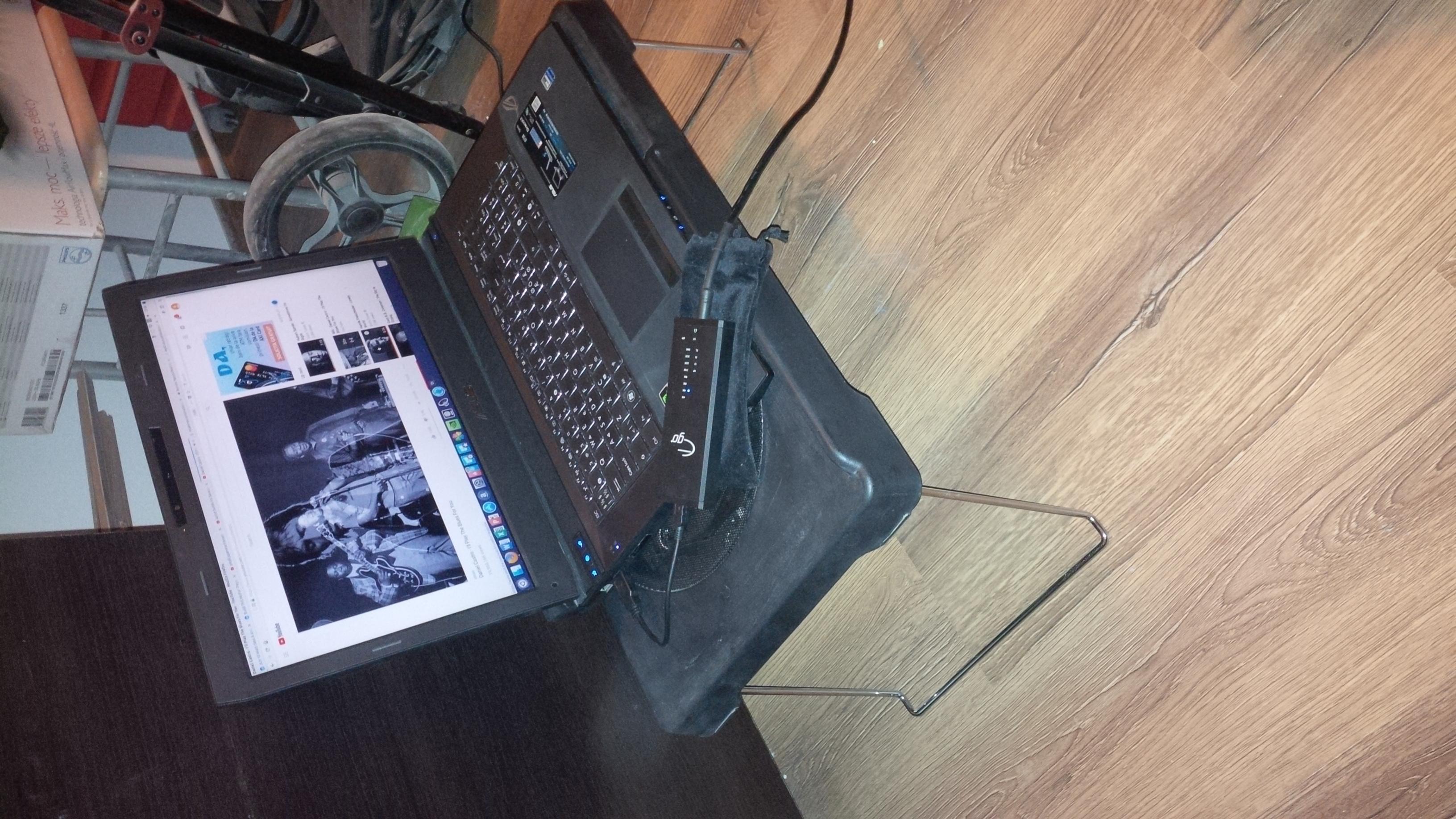

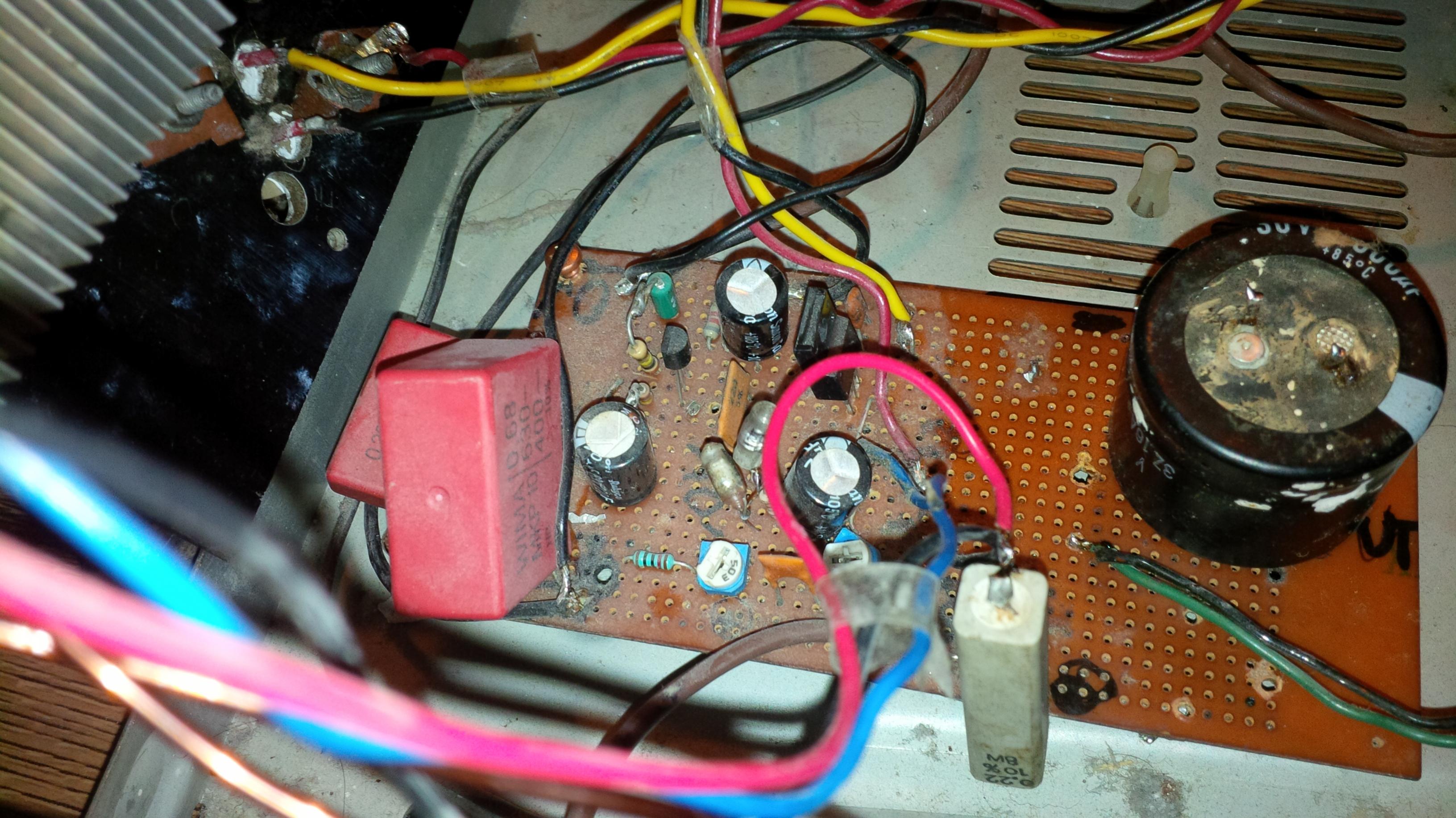

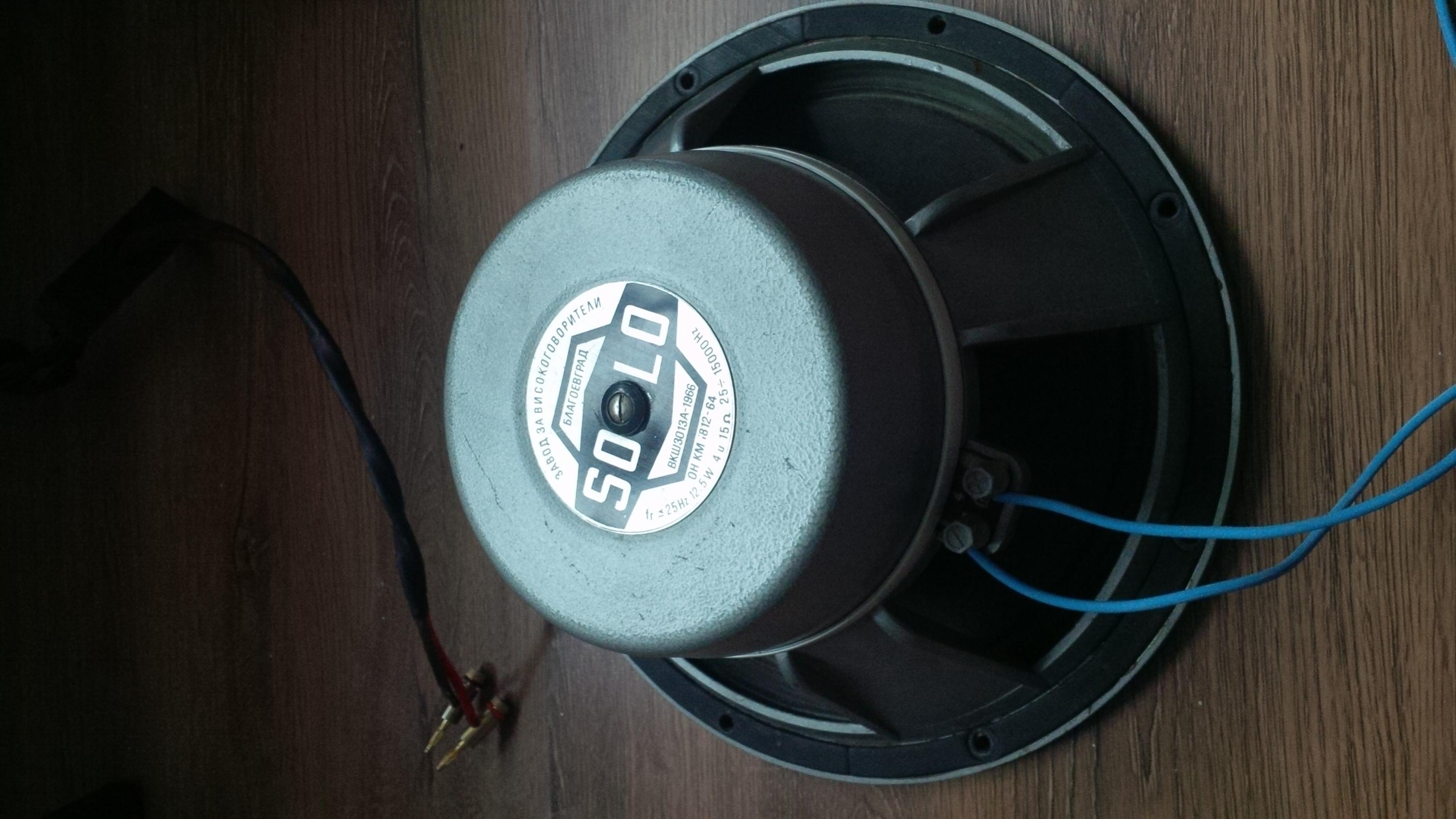

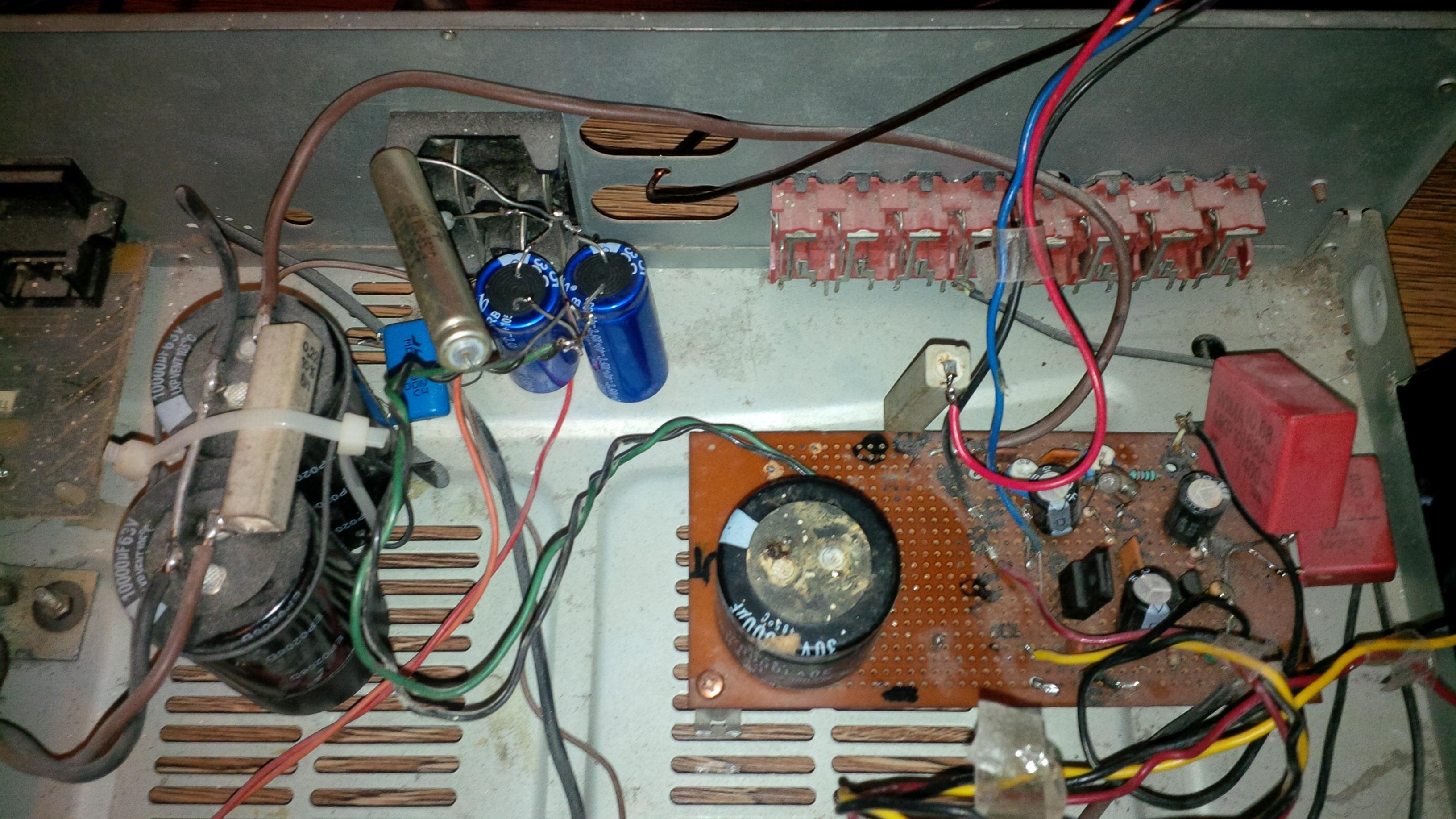

Here are some pics with my test equippment:
-speakers: SOLO full range (also called GAMMA) @8ohm and my diy rubanoide speakers+15 inch black cabinets;
-the jlh from the monkey box as seen with the diy radiator+ the modified Hiraga 30w (the satellite);
-the asus laptop+ emotiva big ego dac and diy input cables for the amps
No fancy smanchy no snake oil. 🙂

Hello Nigel, Mjona, Huggy and other participants to this thread.
I made a jlh1969 and still listen to it for about 4 years by now in parallel with my modified Hiraga 30w amp. Someone here asked about some listening impressions. Well here they are...
I used my Jlh with a Philips bc560c on input 2sc5171 as driver and a 2n3055+BD182 as outputs.
I listened to ST bd139-16 and bd140-16 on the Hiraga amp (1% matched) and wasnt so pleased because the 2sa1930/2sc5171 was clearer, more musical, and sounded more relaxed. I have tested 2 more types of drivers other than the famous bd139/140 or the 2sa/sc pair mentionned above but the 2sa/2sc was a clear winner. XRK and Hugh (AKSA) had confirmed that this pair is one of the most musical driver pair made novadays by Toshiba. I have some 2n1711 in the monkey box to test tomorrow and will report back, but i doubt that the 2N will beat the 2sc...😎![]()
With most variants of the JLH Class A circuit it is necessary to use a medium power transistor in the phase-split position. This is a consequence of the need to drive low current gain power transistors like 2N3055.
If these can be replaced by super beta types this opens the possibility of using some common small signal types like 2N5551 or for 2N3904 depending on the supply rail voltages ( to be safe with 2N3904 36volts or +/- 18).
If you look at the .models for these the VAF numbers are 667 and 400 high numbers like this indicate high Early voltage meaning these are less susceptible to base width modulation than devices like BD139 with a value of 99 and 2N1711 with 100.
As I have explained in an earlier post the capacitance between the collector and base transistor in a common emitter is inversely proportionate to the square root of the voltage applied to the collector. When a larger current is drawn through a load in the collector connection, the collector voltage will drop and the collector-to-base capacitance will increase.
The width of the collector region is proportional to the capacitance and when this increases the width of the base decreases. The outcome of this modulation process is a loss of current gain (and a recovery on the reverse cycle).
While I have put some emphasis on Early Effect (named after George Early) or VAF this has been investigated by Samuel Groner who came up with a rough calculation to consider the merit of a Vas transistor which is BF times VAF.
You also need to take the fT into consideration- some super beta power transistors might look attractive on Groner's calculation an fT of 30MHz is not good enough.
Also some transistors might have very good noise characteristics which might be the icing on the cake if you can get the mixture of that right.
One thing seems sure if you use the common garden transistors you are less likely to be buying the fake of an exotic transistor type.
