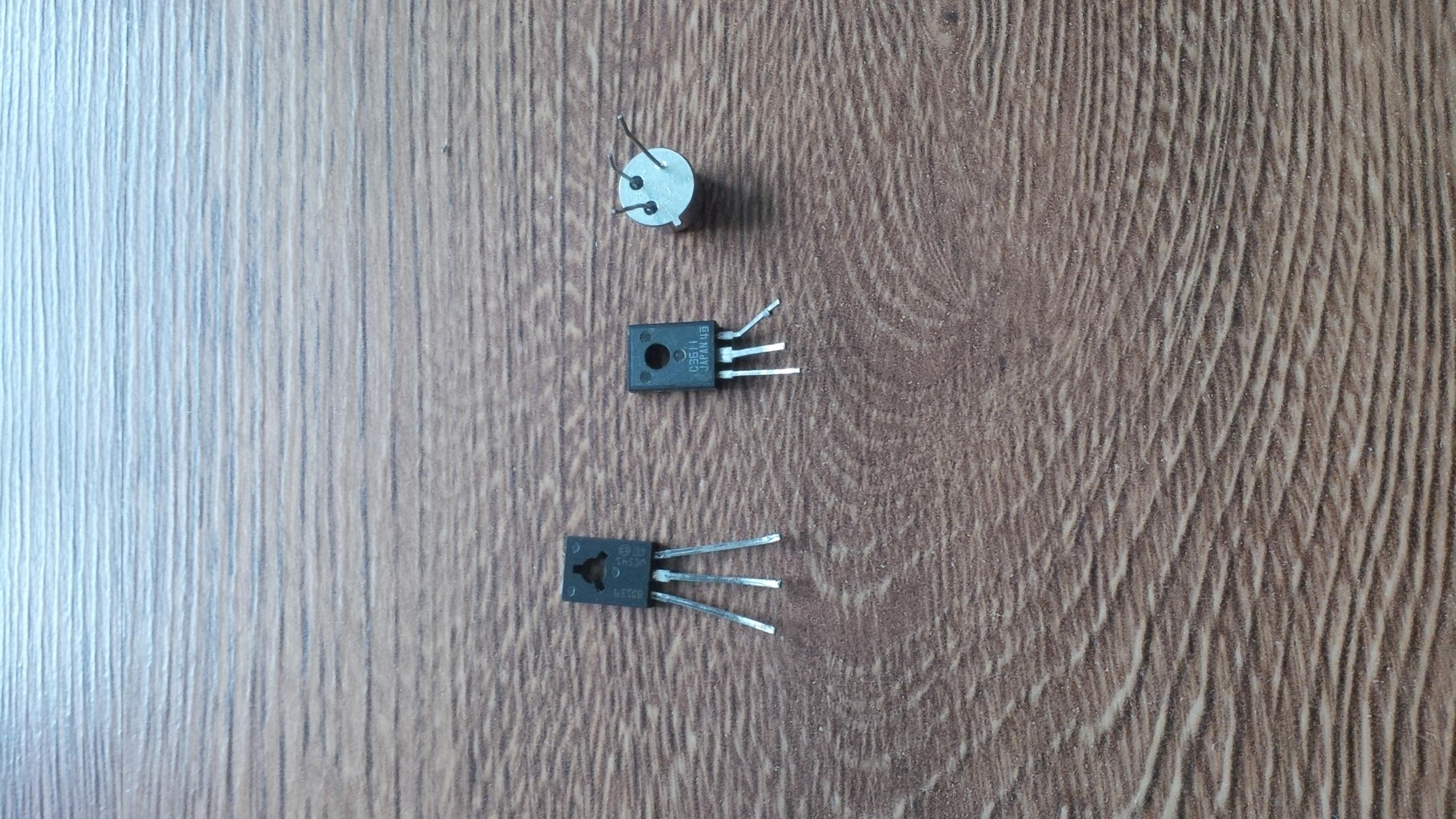

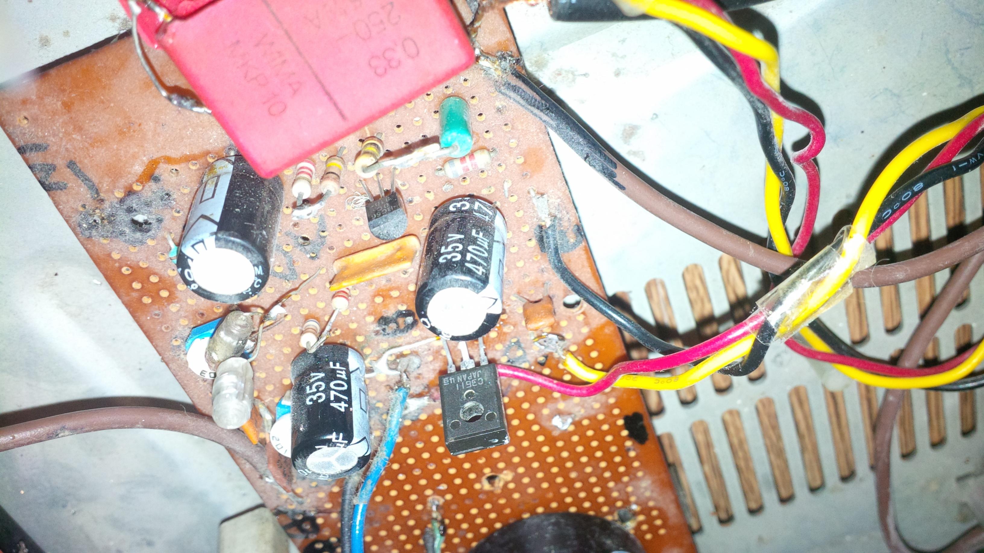

These three vs the 2sc 5171. The 2n and bd has a beta measured of 640 and 2sc 3611 of 680..
The 2sc seems more equilibrated... Now with the 2N i have a ton of gain, more mids and punchier bass. Now i can hear each and every tone of bass individually. As for the hights, well, now i have hights sufficiently to hear everything. Very good transistor. I wasnt expecting this. The 2n shines. The mids are very clear, dynamic and with allot of presence.
You are right Mjona, each stage, and amp has its own suitable transistor with its characteristics and parameters accordint to what the designer has in its mind.
Even tough the 2sc5171 has better Cob, and parameters, its just TOO MUCH for this little fellow jlh. It seems the 2SC5171 its just a better choice for the Hiraga 30 watter emitor follower topology than this one.
THanks
Next: the bd139-16 from ST (SGS Thomson).
The bd139-16 from ST: the bass is a bit less punchier but deeper at lower lewels and less detailled ( they are still there but you need to concentrate more to distinguish them on "Almost home, melosense remix" and "sounds from the ground--tending the wine") with less nuances, a less cleaner overall sound at max level, with a bit of heard distorsions on "the shadow of your smile by Jacintah" (a sign of saturation?). The bass flattens a bit at max level and so the mids. Less presence on "what a difference a day makes--chantal chamberland" and the sound is less present in "Mantovani-moon river|.
The hights are still there but less crisp wich makes the amp a bit less revealling. The mids are a tiny bit more softer on the trompets on the "smoke gets in you eyes by chantal chamberland", and "Take five by Dave Brubeck".
Next, a nos 2sc3611 by Panasonic, from the monkey box. :)
Now THIS is something, this driver gives the deepest, thoughest, punciest bass from them all, a verry verry close match to the Hiraga overall sound and IS an amp with an input and output cap!!!!! (and i use cheap industriall ones!!!---i have to dig in more into this aspect to fine tune this aspect)
I think that the bass deffinetly has something to do with the Cob of only just 3pf @1mhz, because in the Hiraga i have a ton of caps, blodly matching transistors etc etc etc to listen to something like this........ This is very interesting that the 300mhz Ft doesnt care that much.
The mids are very close to the Hiragas, very present, full, clean with no distorsion or signs of saturation at max power. The hights are clean, clear and revealing but less sharper in the upper end compared to the 2N.
This overall combo makes a very natural, present and pleasant overall sound.
Now i have a ton of gain as with the 2N but even cleaner and clearer, richer and full of details as it should be.
I think that the receipt for this amps Vas is a transistor of 50mhz or more, very little Cob and noise, no more than 1.2-1.3w max max and at least 60V to coup with the psu and voltage swings.
Hard decision to make... I have to do more listening to decide and buy more 2N and 2SC is i can find..

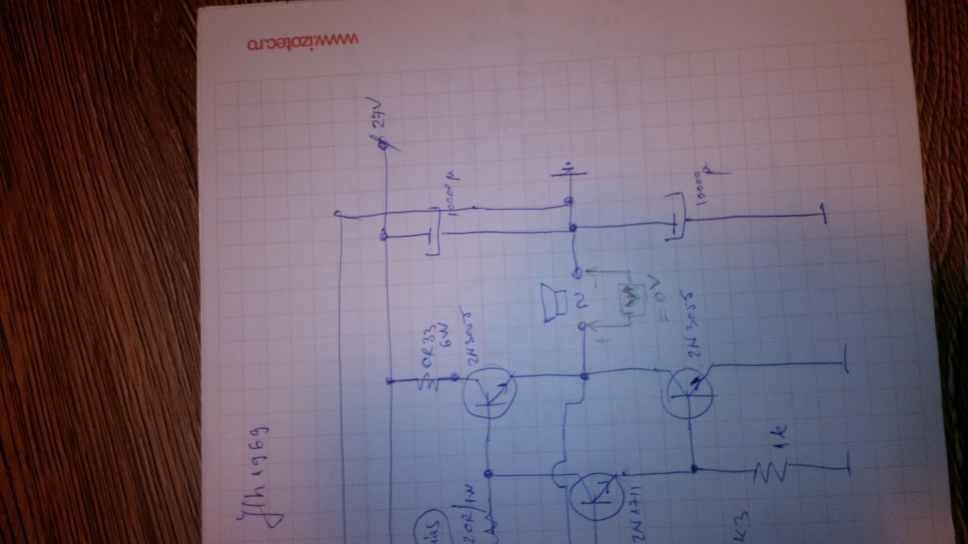

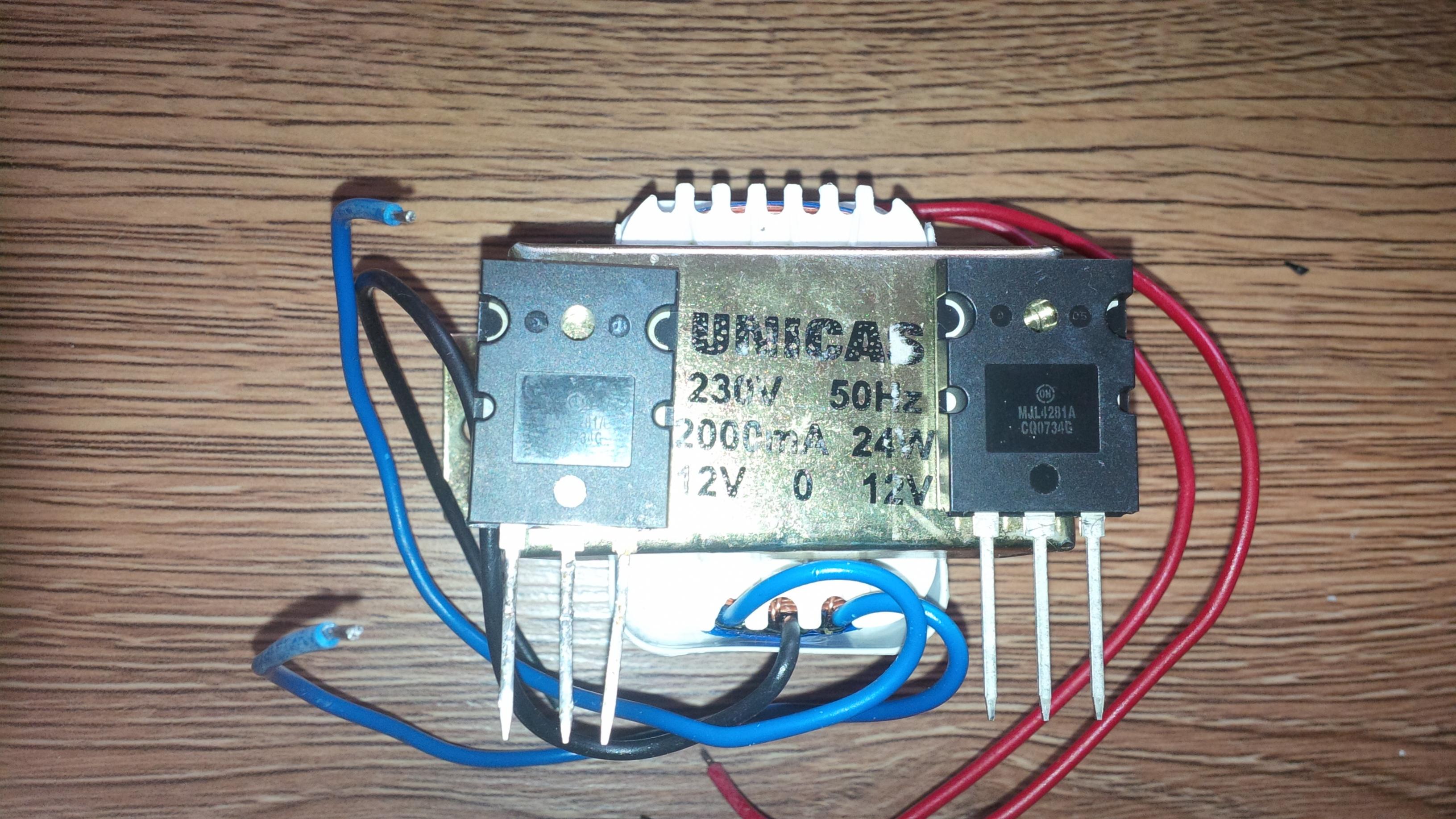

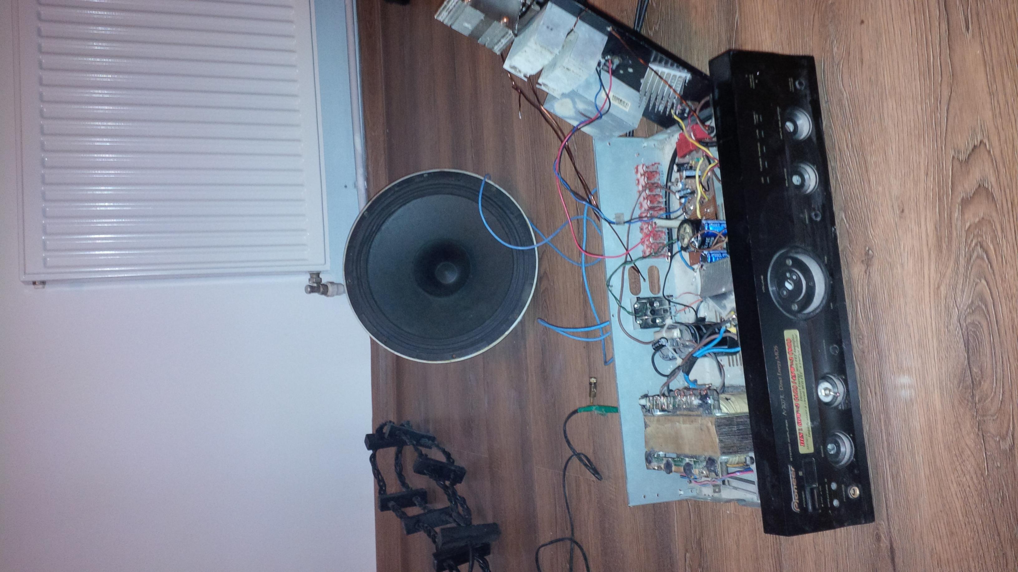

A couple of years back, I think about 10 by now, I had readed tens of times the Hiraga philosophy about the 20w classe a. Somewhere in that article he sayed something about floating ground for amps with output caps..
Made the jlh69 and didnt try till now. After seeing mr Kokoriantz Sublimed jlh I had to gave it a try, and what do you know. I dont need snake oil caps on the output to make this amp shine..I made a floating ground - and equilibrated the output to 0v with a dummy load hooked up, and what do you know, the amp is stagerring right now. Just incredible!!!!!!! I can confirm each and every word Kokoriantz sayed. I have hear such hights only in my Hiraga. They are plenty,crisp, clear and doesnt iritate. They just got silk smooth. Incredible!!!!
The mids are just like those heard at a friend of mine on his SET 300b. Stagerring I tell you!!! Fine, detailled,full, round, precise and present.. What to say more??
The bass, well here I need more caps. Now I have only two pieces of 3300uf in series, but will buy bigger ones because it doesnt go that low like when I had 6600uf as I got used to.. I dont even need to bypass these suckers with smaller ones. They are enough. On a fullrange speaker this combo rips your jaw off your face. Incredible!! Thanks KoKoriantz for the ideea to test this. I will test your variant too.
Ps: I think this ideea of floating ground is good too because, in either way,double psu (+-) or float, if an output burns it takes the speaker with it. So a protection is mandatory in either case.

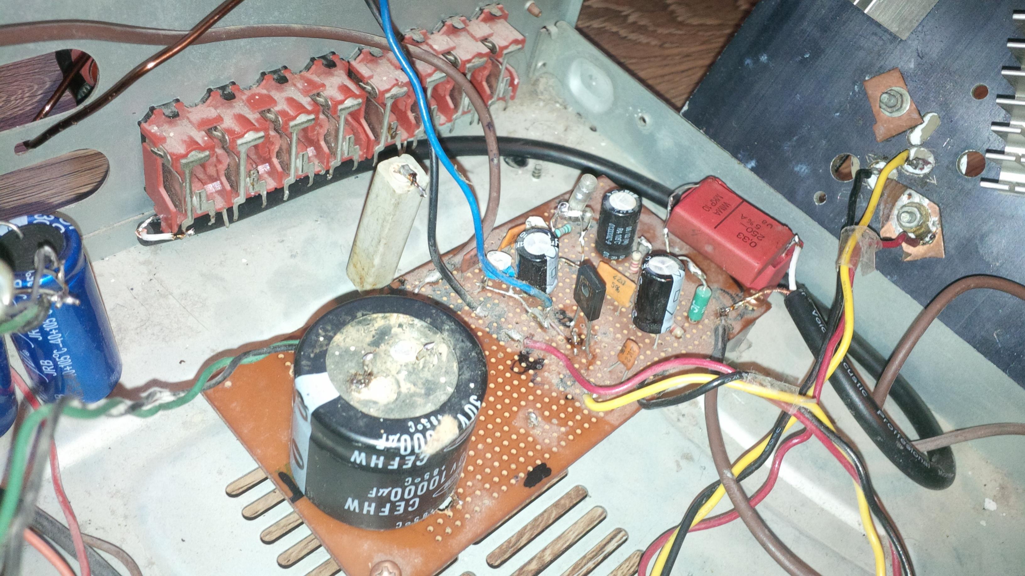

One more thing intrigues me, with the 2sc video trasistor, it oscilates if I have under 1.5A bias if I go up no problem, only with the heat... :)
Neither of the other transistors did this, I could go as low as 500mA with the 2n1711. Why is this? How can I counter this? Spliting the 1k2 bias resistor in two to protect the upper transistor base and decresing the upper resistor of 150R to half to acomodate to the bigger demands of this transistor? Also I gained a bit more hum with the video 2sc and even more with the floating ground.. does this fellow need some compensation C-B of lets say 40-60pF?
Thanks in advance

The maximum current you can expect from your amplifier is about twice the standing amount you decide on, so if the load demands more than this the amplifier will head more into distortion and at the extreme limit it will clip.
From your description of what is happening I think this is the cause.

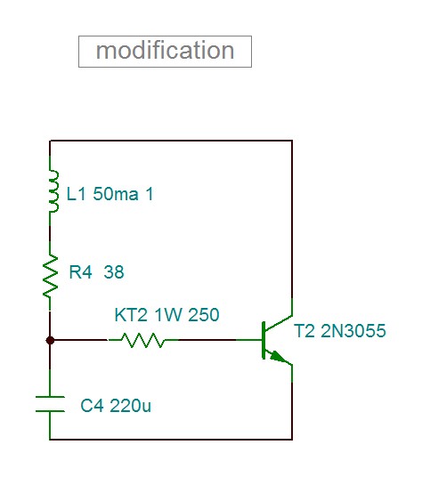

The bootstrap circuit as seen has two problems to resolve .
The shunt resistor needs to be 250 ohm for best frequency responce of the upper output transistor.
The pull up resistor is loading the output too heavily pumping 12% from its power and polluting the PS .
The remedy I will try out in compliance with 1969 technology , is to supply the bias current by a choke . 1H/50ma can be sufficient , but its resistance should be less than 30 ohm . The choke must be small enough to be installed upon the heatsink adapter mounted by the same screws joining the heatsink .
I will go DIY mode and wind it myself . I'll report about it in few months .

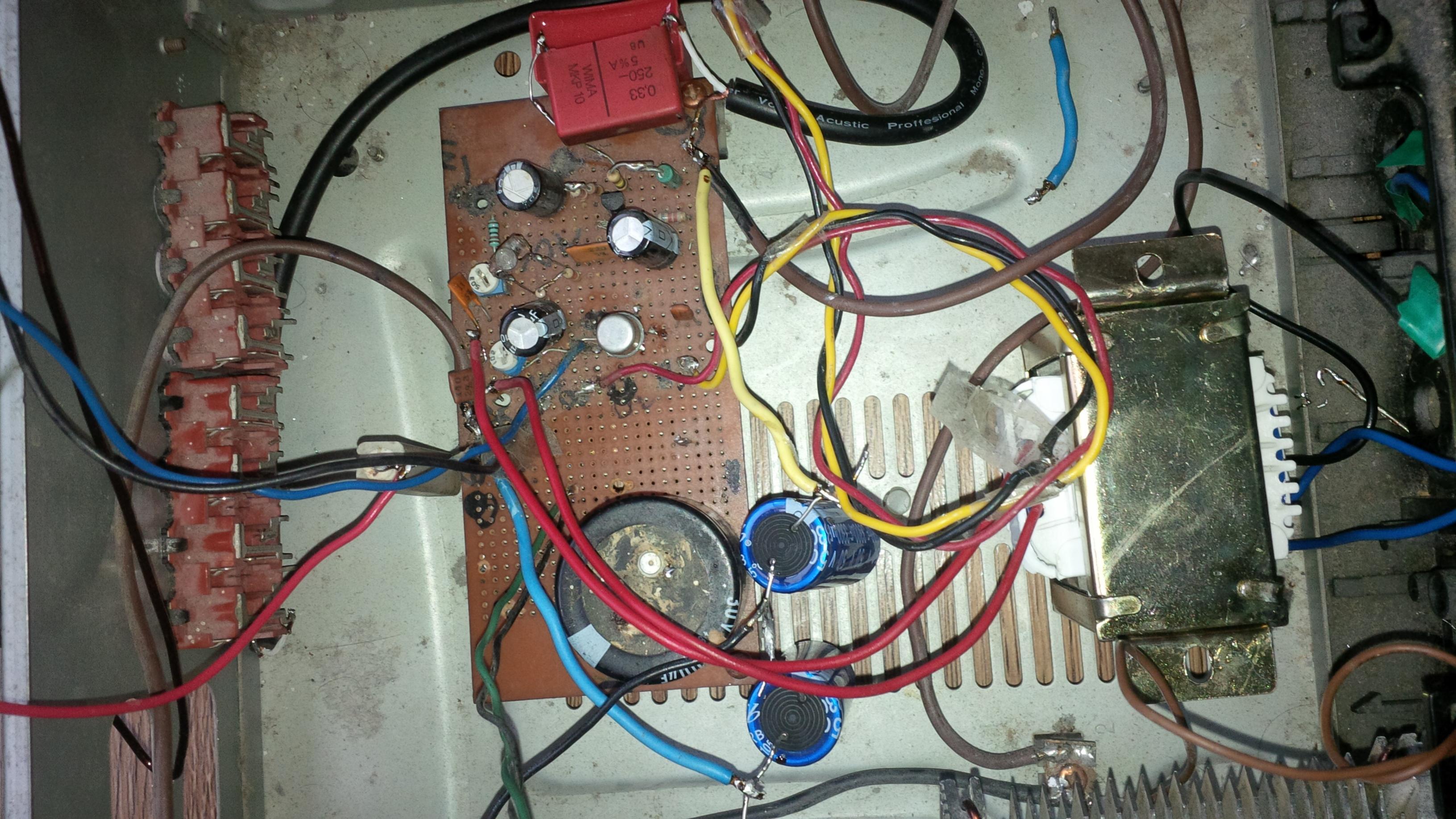

I tested it Kokorianz. The voice is rounder, and a tiny bit cleaner, the bass is more profound, deeper and punchier...
713399d1541333170-sublimed-jlh1969-modif-jpg
The hights are now even more silk smooth like but not sharp like before. It still needs some tweaking. Nice adition though.

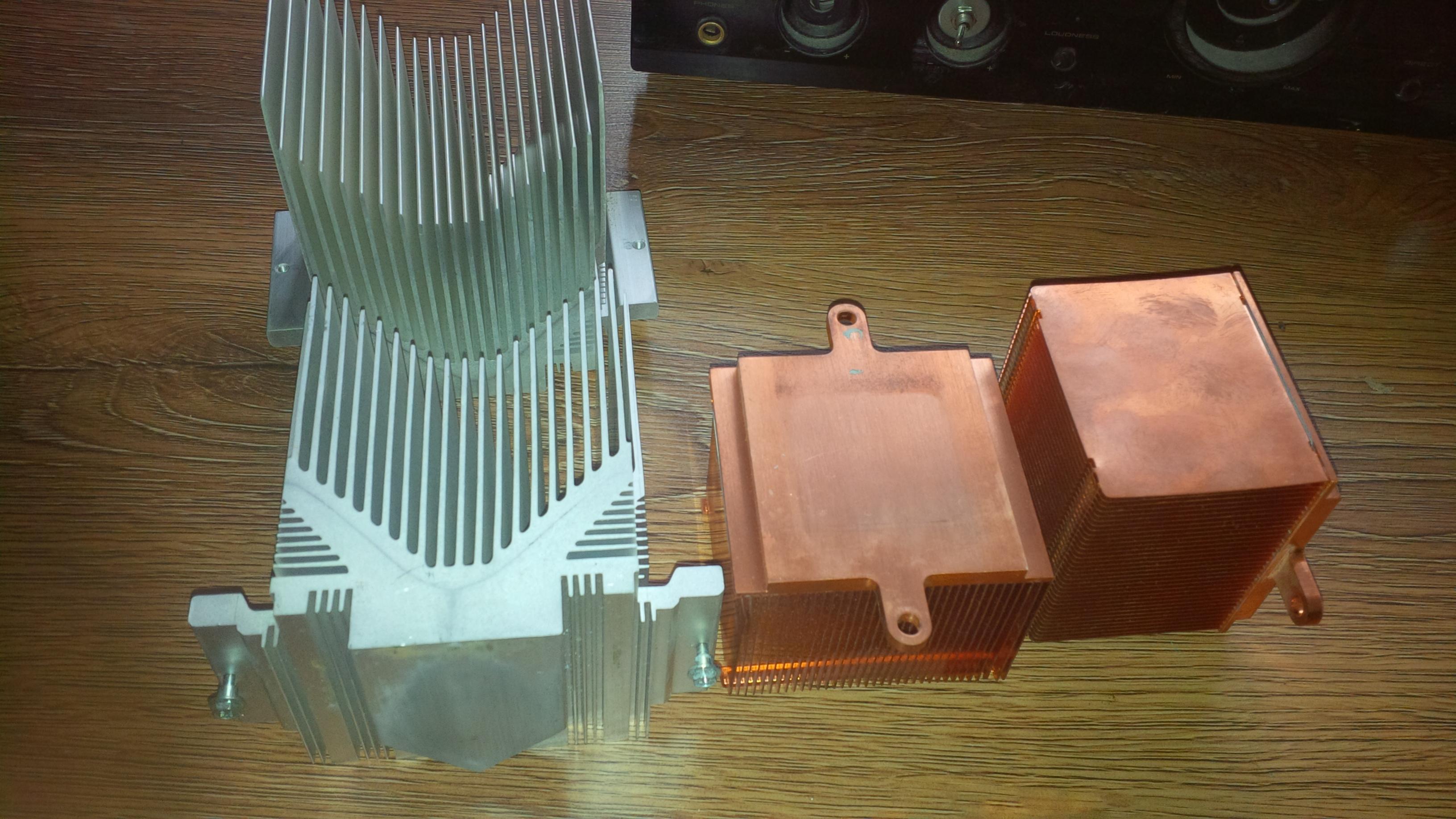

I fitted new rads from xeon servers for the higher gain outputs. Will test them this week.
