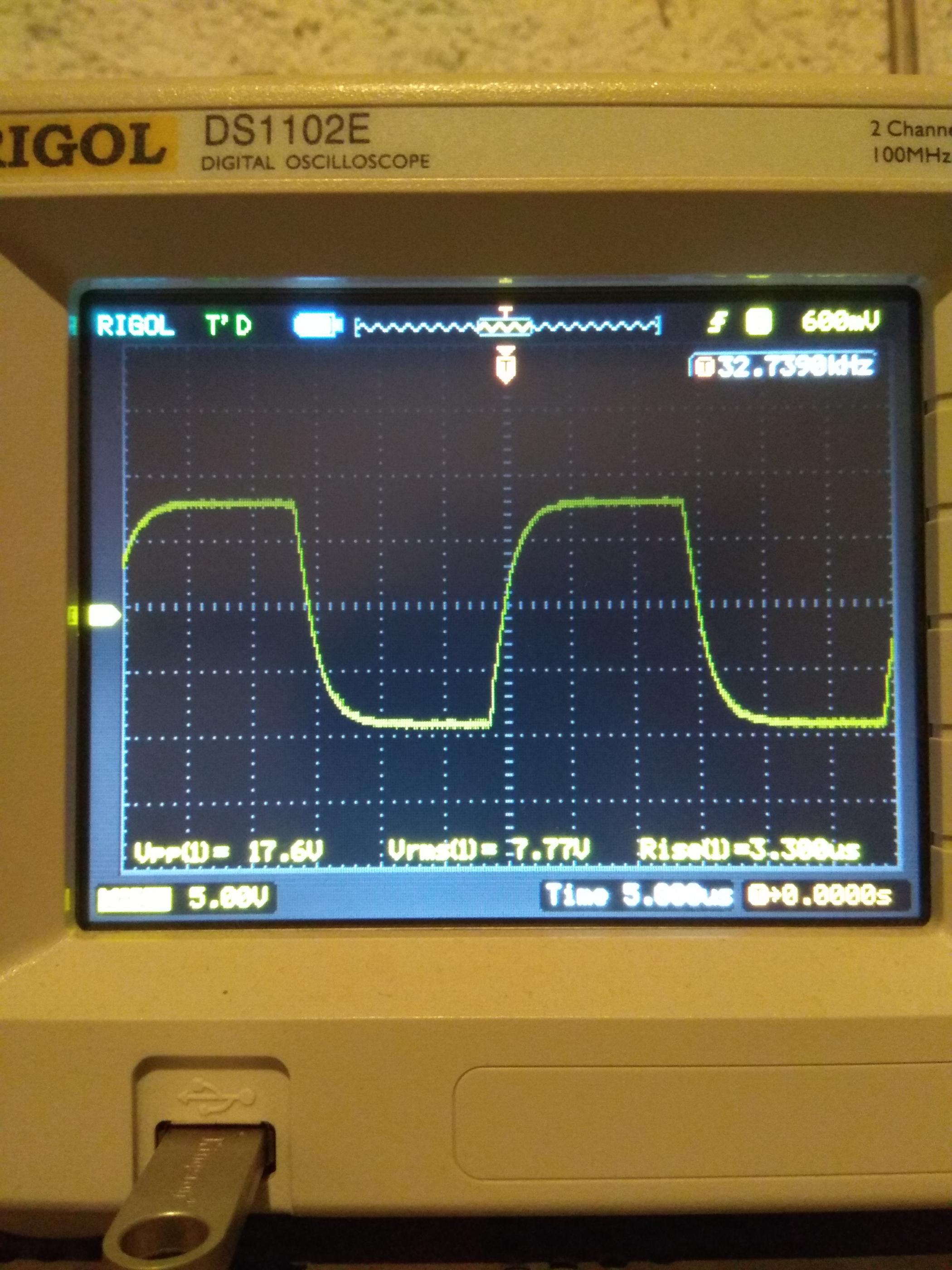

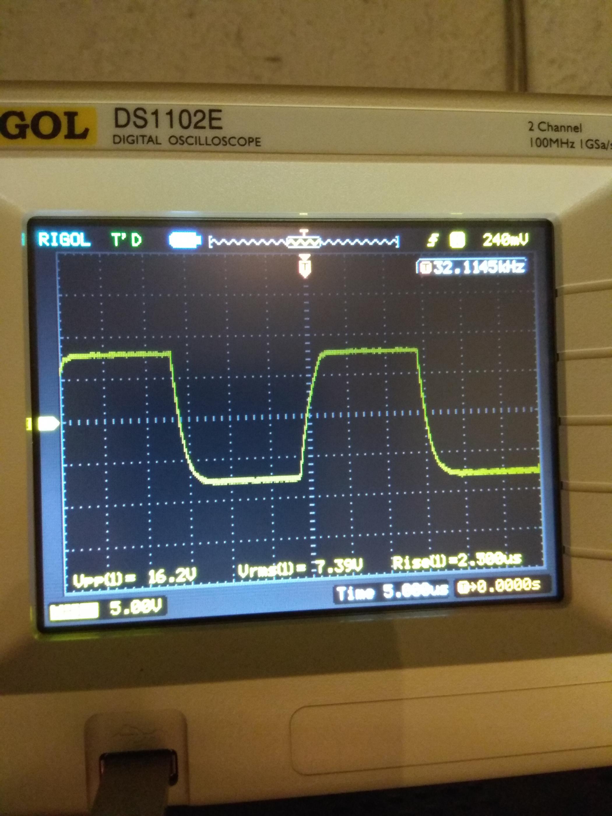

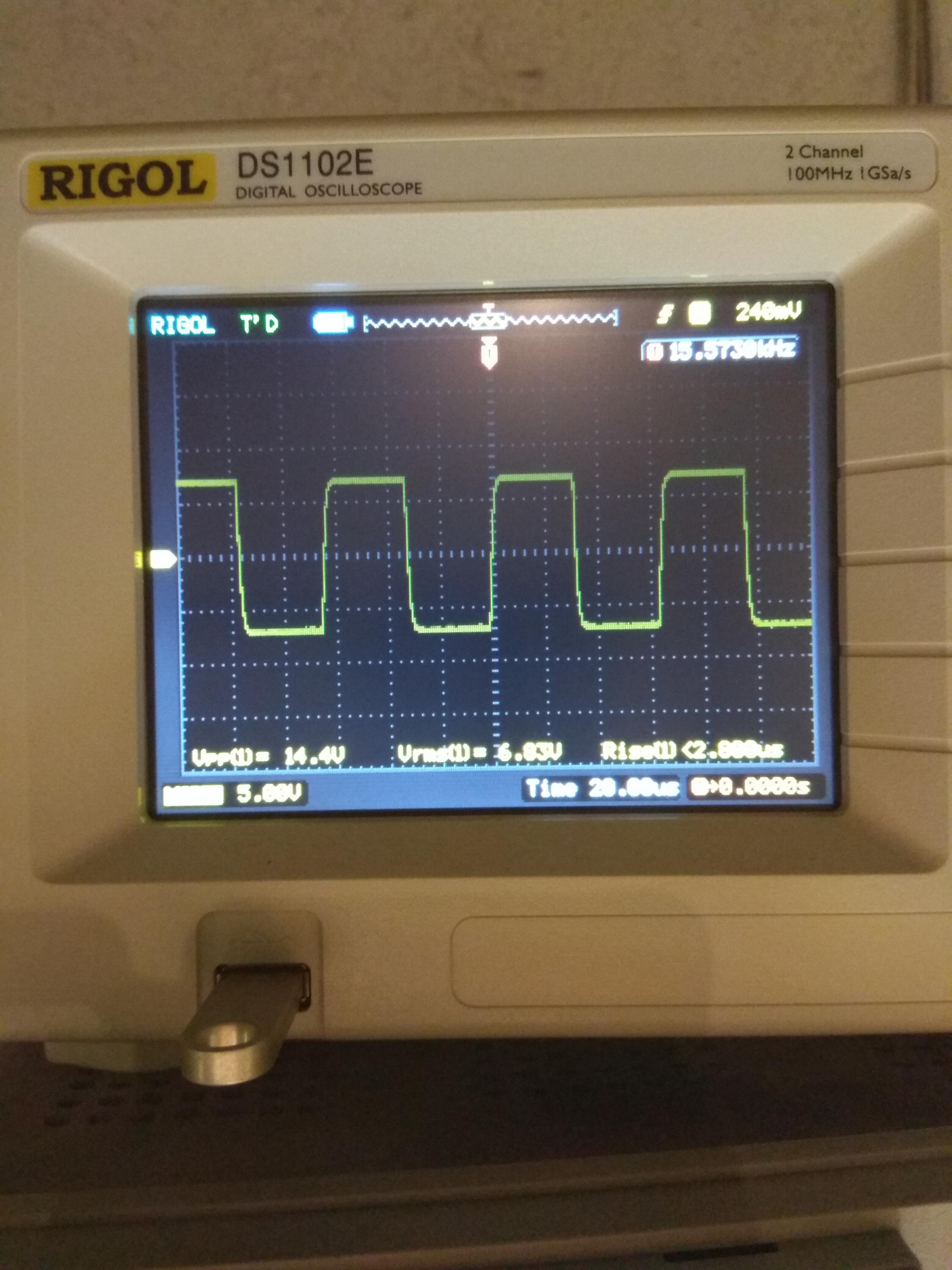

JLH 10 Watt class A amplifier

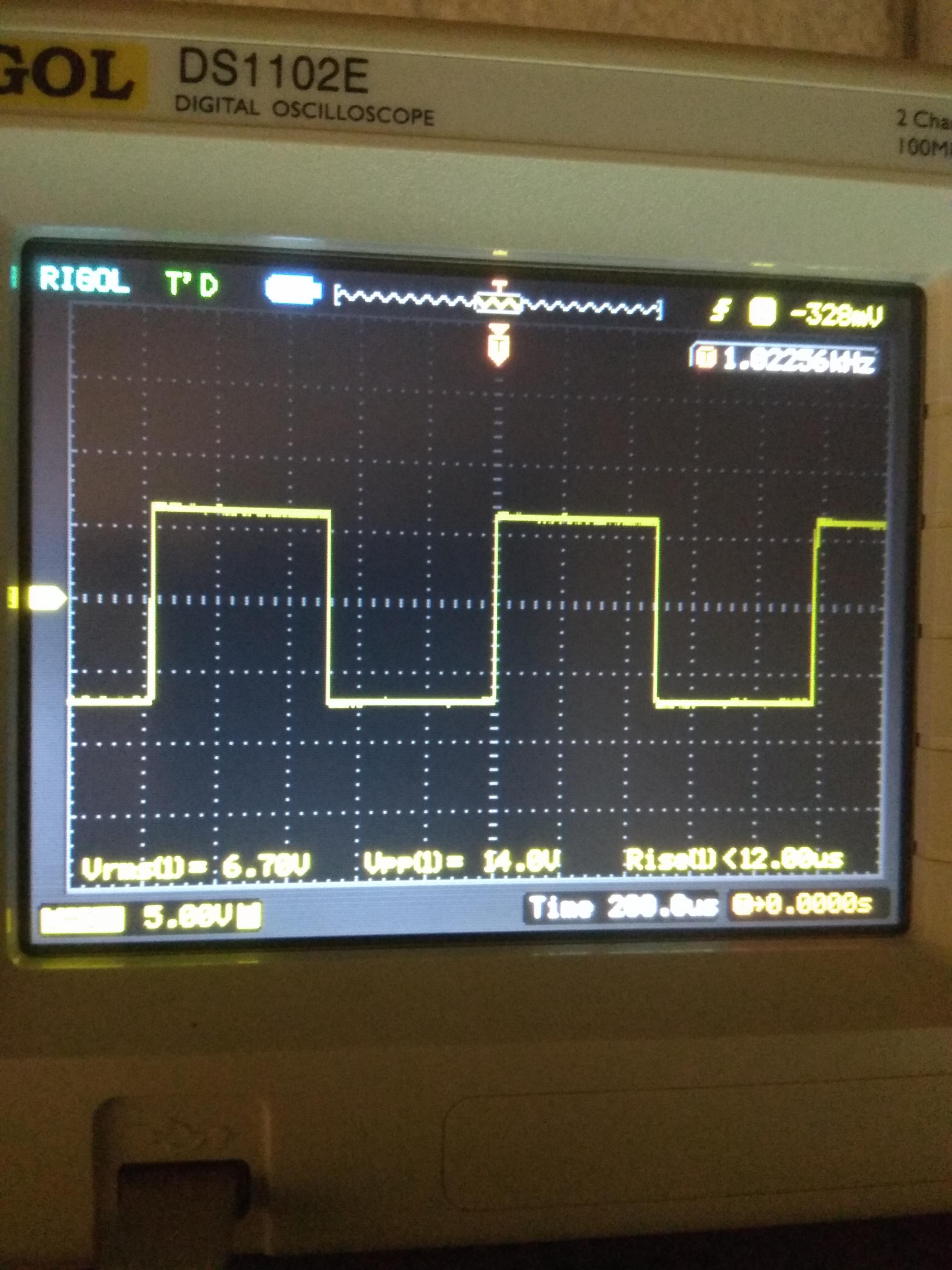

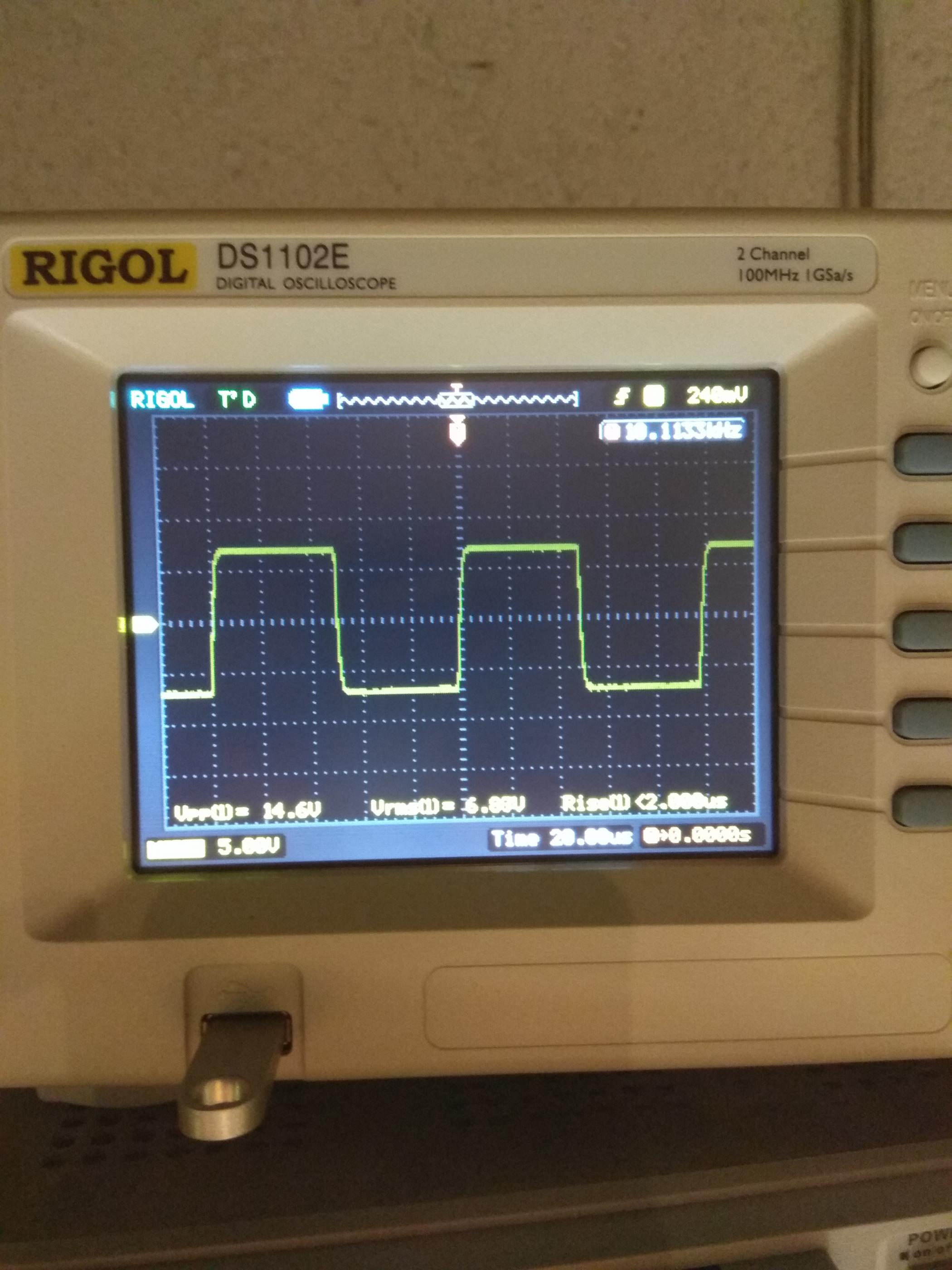

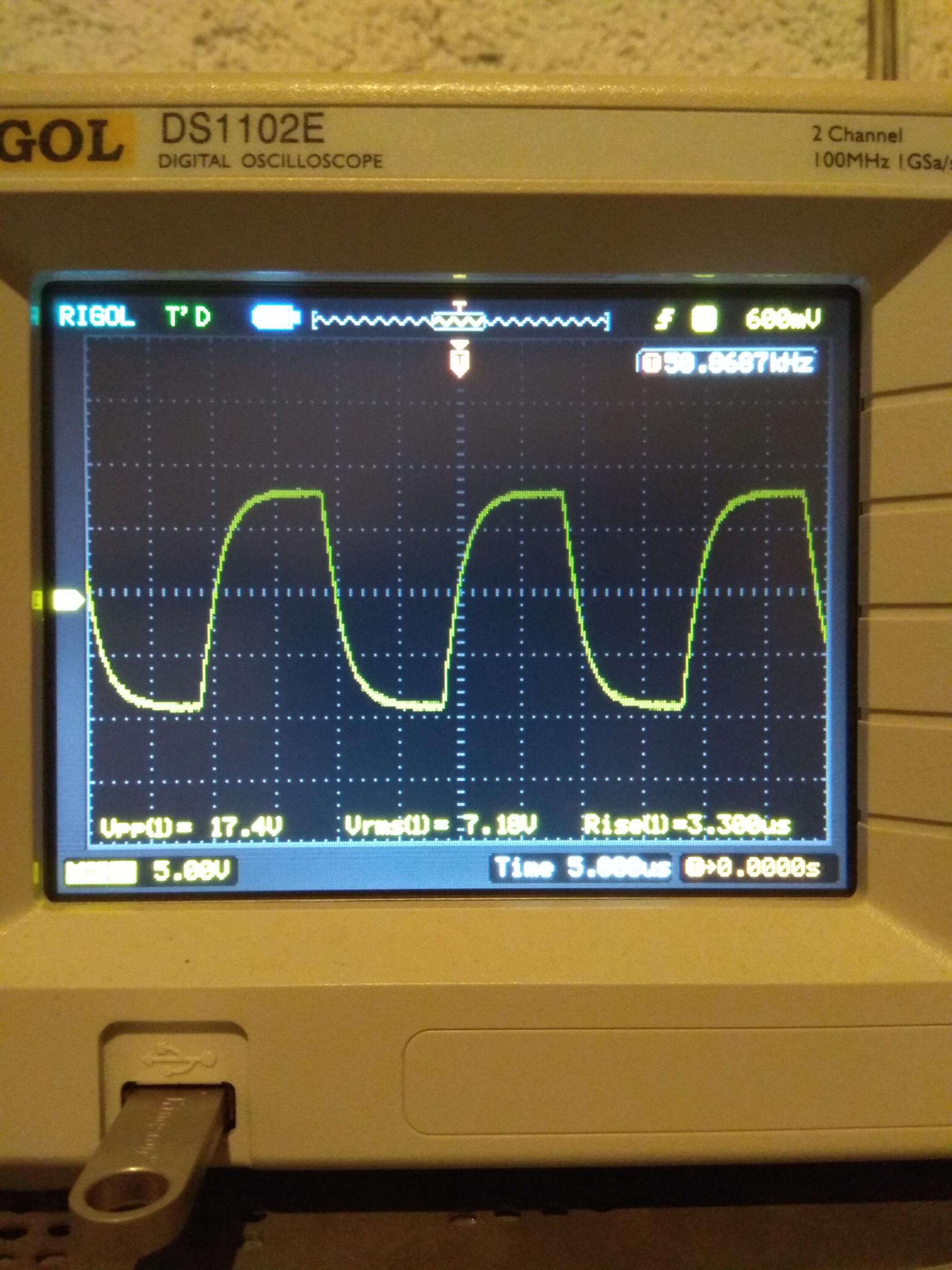

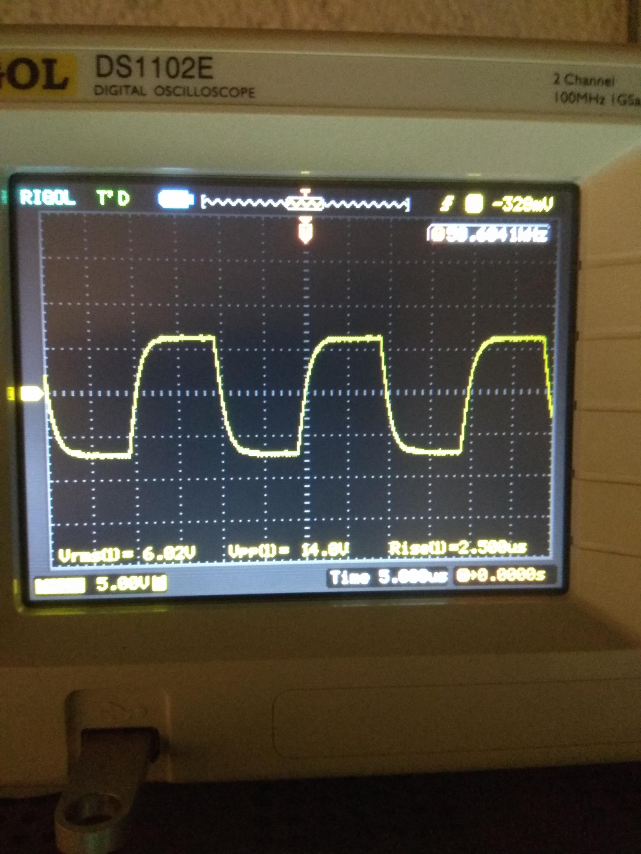

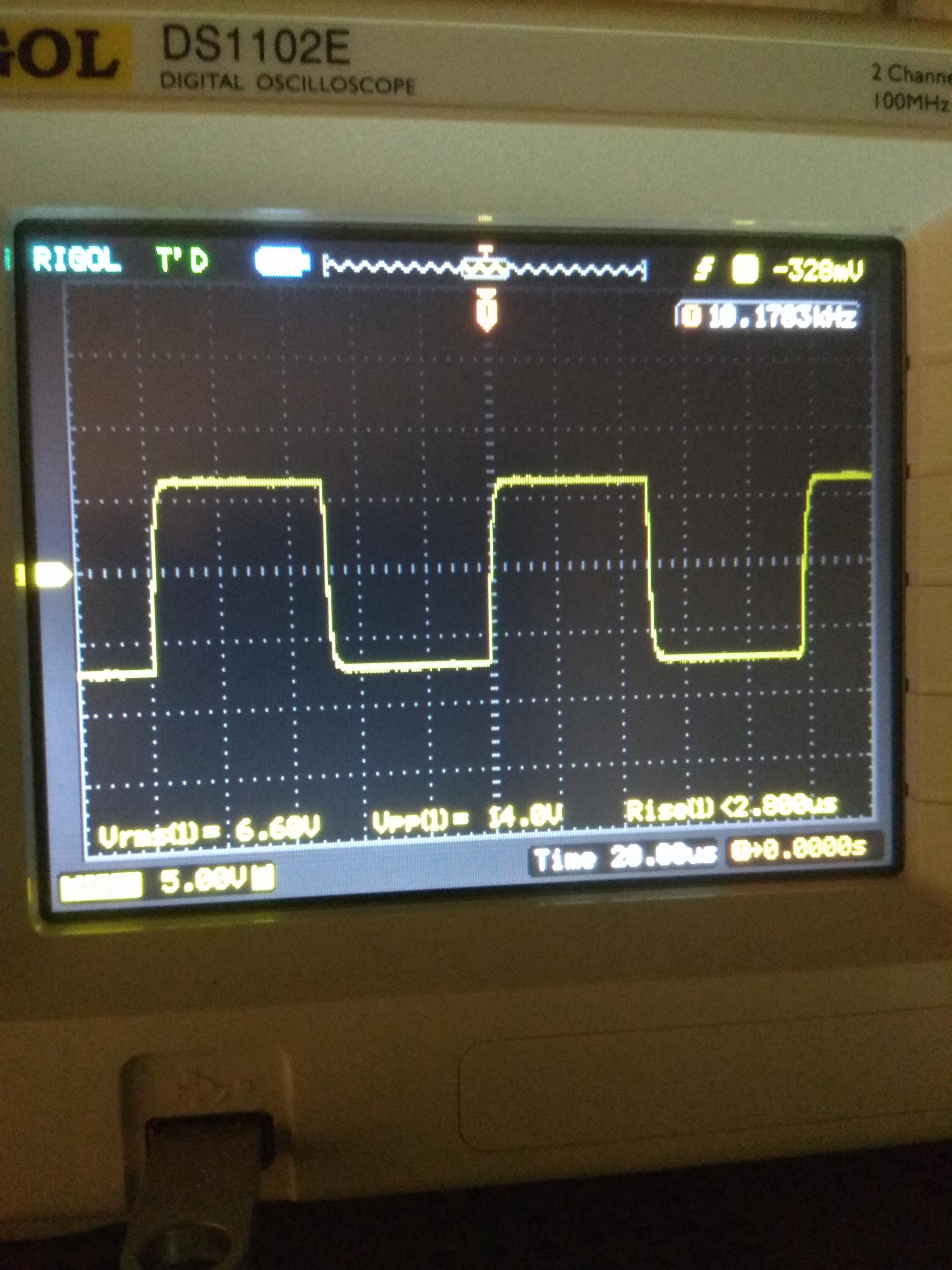

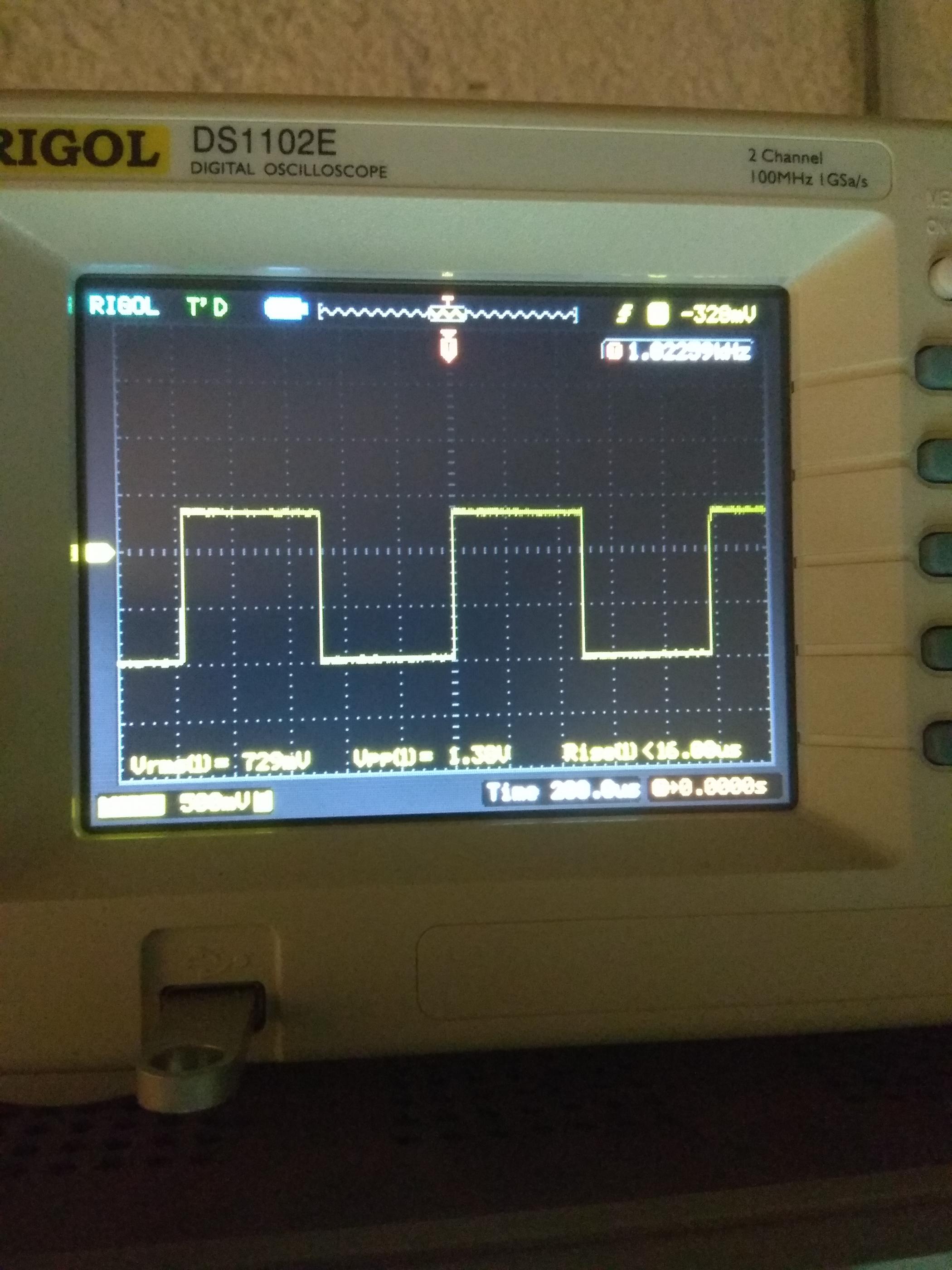

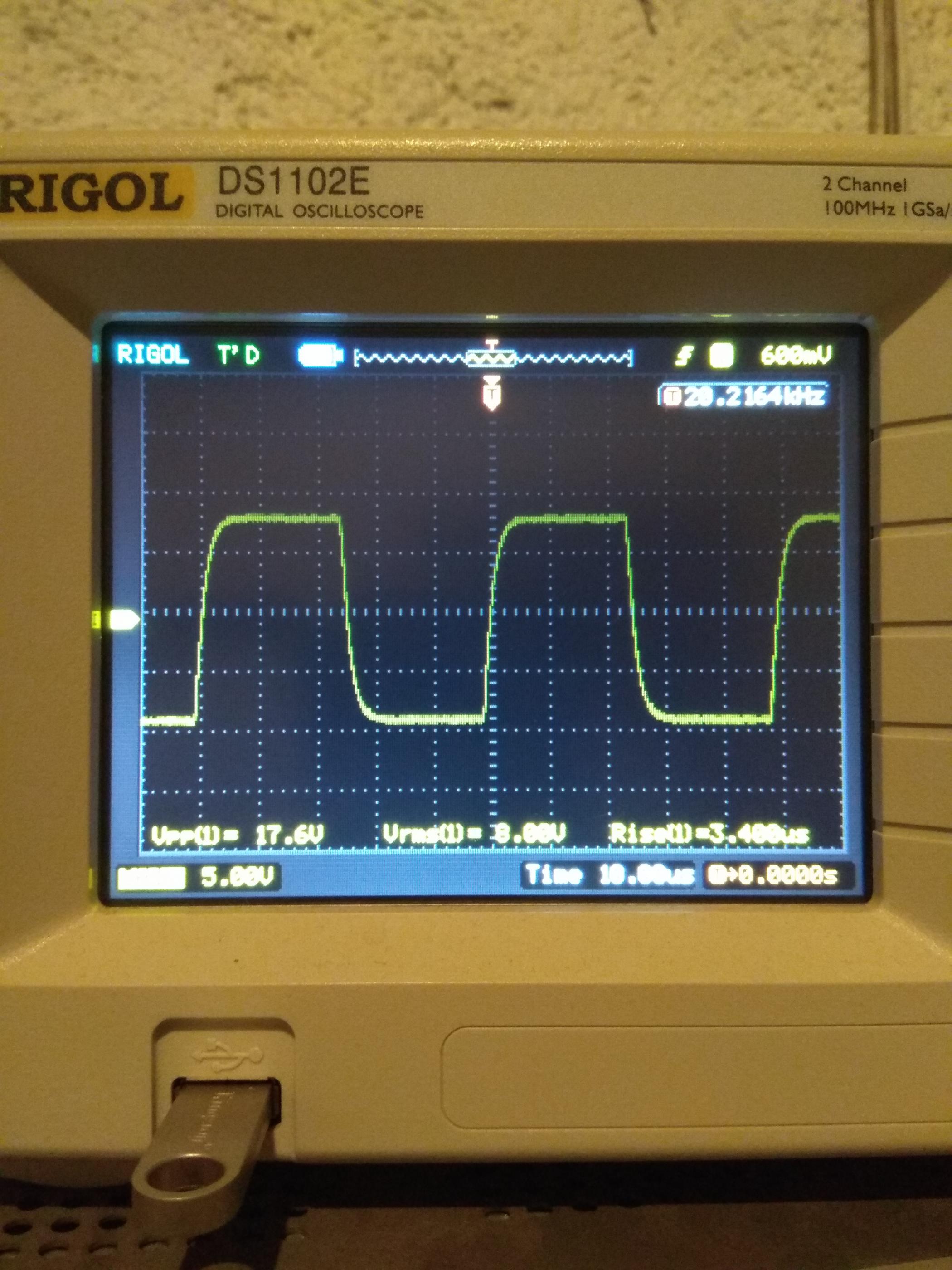

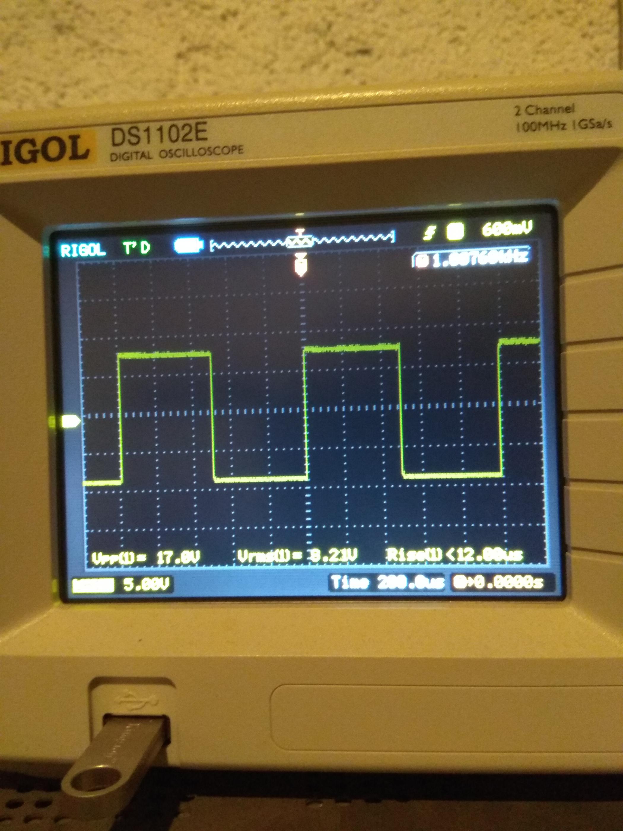

Scope test on the red board using TTC5200.
Are you still think that using fast transistors in this circuit is a bad choice?
Personally i can't see any reason.
Please feel free to ask for other test because this still is on the test bed.

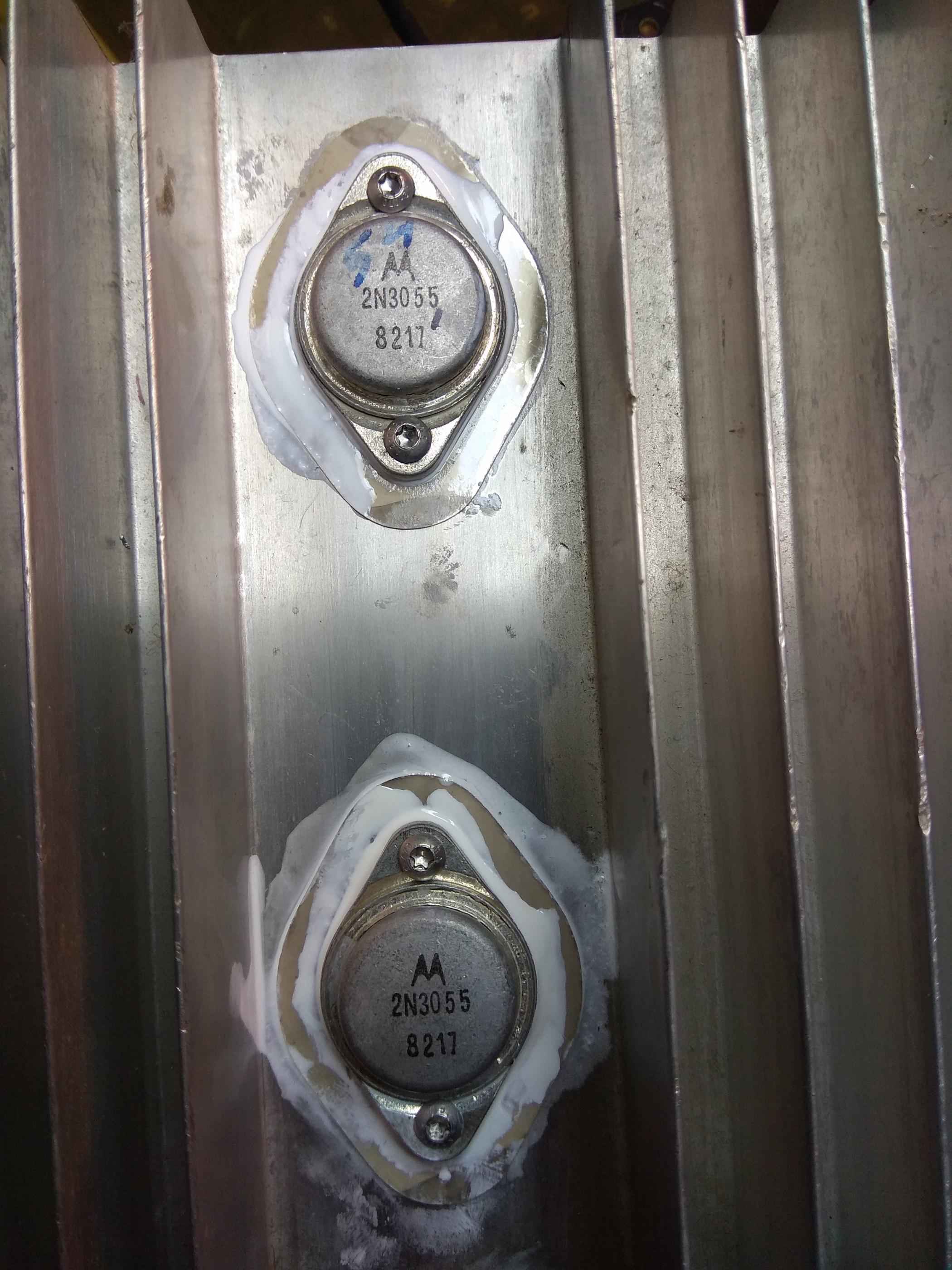

What is the 2N3055H.
This is a good question. Originally RCA made their 2N3055 which had good second breakdown (1.9A at 60V) but 800kHz fT. When they changed the 2N3055 to epi base the original device was renamed 2N3055H.
When Motorola produced a 2N3055H they spec'd the same Is/b and fT, though as I suspect it is an epi base device from a process line that has good Is/b and probably an fT around 2MHz. What it actually is I do not know.
But all devices I have measured with 2N3055 label are the high frequency types and perform much better than some seem to think (who may still be thinking of the old slow device).
But I think ON Semi may have recently obsoleted their "H" device anyway.
John. I have come to the conclusion that many transistors are honest fakes. The old TIP 3055 seems to be one. It's not quite the same device as in T03. I speculate that wafers are sold where the company is happy to do that whilst not happy to make up complete devices. MJ15015 is sold as 2N3055 if it fails higher voltage tests.
My Indian 3055's were able to give similar results.
Well, there are "me too" devices which you might call "honest fakes" and fakes out there too. When TI developed the TIP3055 they appeared to be cashing in on the 2N3055's reputation with a similar name, but this was an epi-base device from the start. It never was an RCA 2N3055(H). They had a spec. of 70V Vceo which matched the Vcer of the original. But as other manufacturers copied the device the spec changed slightly e.g. some offer TIP3055's with Vceo=60V.
I seem to have been fairly lucky in having found only one or two fakes in the devices I have seen. In one case a power transistor (I can't recall exactly but I think this was a 3055) gave up unexpectedly. Checking the device it turned out to have a small chip, suspiciously looking like someone put too small a device put into TO-3 to make it look like a bigger one.
But the newer (RCA) 3055 (epi) chip (also now obsolete) is smaller than the old (hometaxial). Approx 3.5mm instead of 4.5mm square.
Your Indian 3055's could well be good epi-base devices. I note that at least one well-known manufacturer is producing devices in India. This just reflects the changes as manufacturers consolidate, come and go, and move their production lines around the world.
A good test, apart from the usual run of tests like measuring capacitances and Vbe's etc for Ic which will give a good idea of where the transistor's operating range is, would be a second breakdown test. RCA and Motorola published IS/b test circuits, but I suspect it would now be better done with a MOSFET switch to turn the device off the instant an irregularity is detected. I've never quite got round to that as I've thought that any slight irregularity in the characteristics implies non-ideal behaviour which may still indicate some local damage in the transistor, even if this was stopped early enough not to cause destructive damage. That would apply if measuring the Is/b, but if checking to what is a "known" safe value then maybe would still be worth it where the actual Is/b is not tested for but checked within an acceptable characteristic.

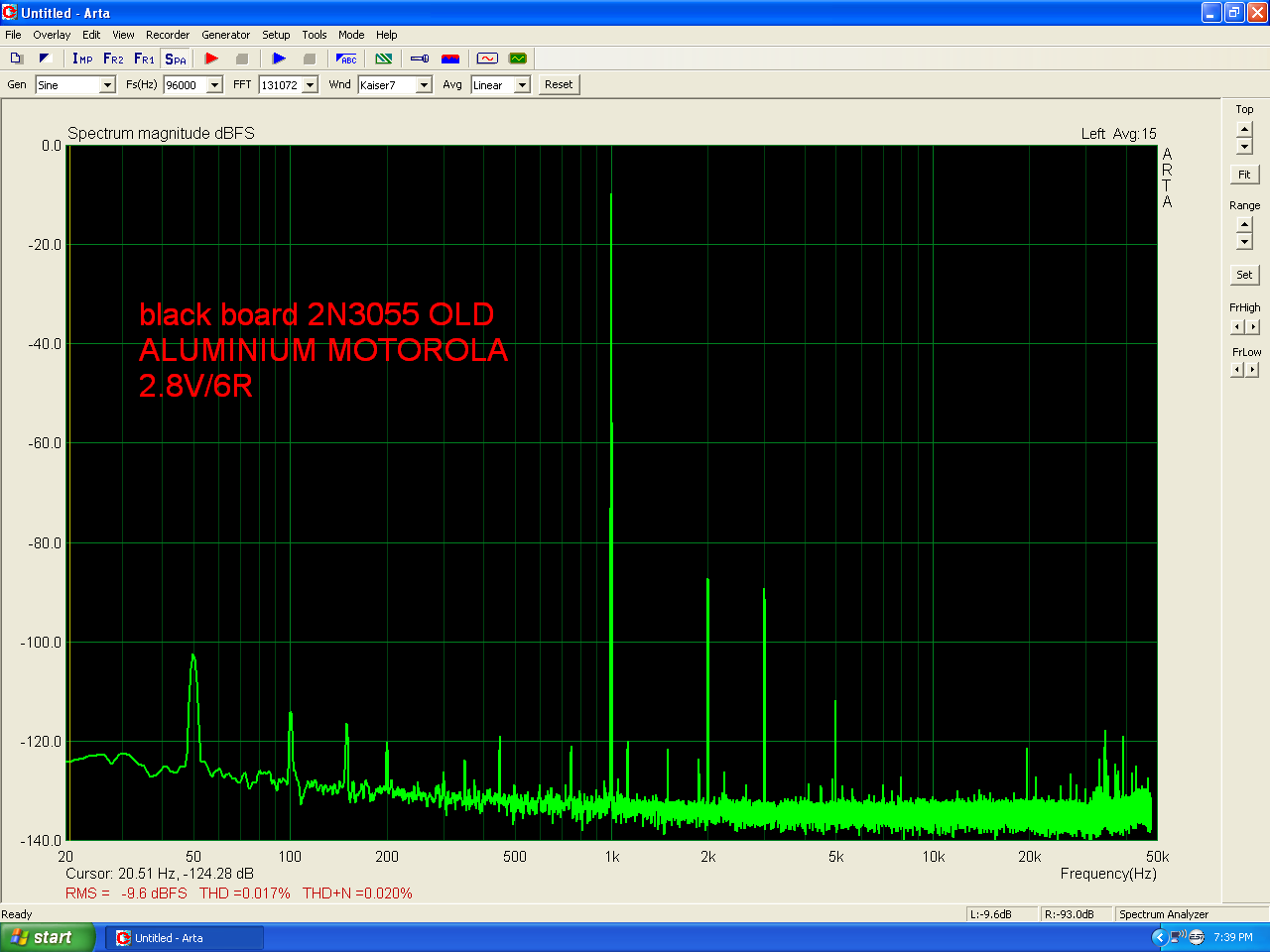

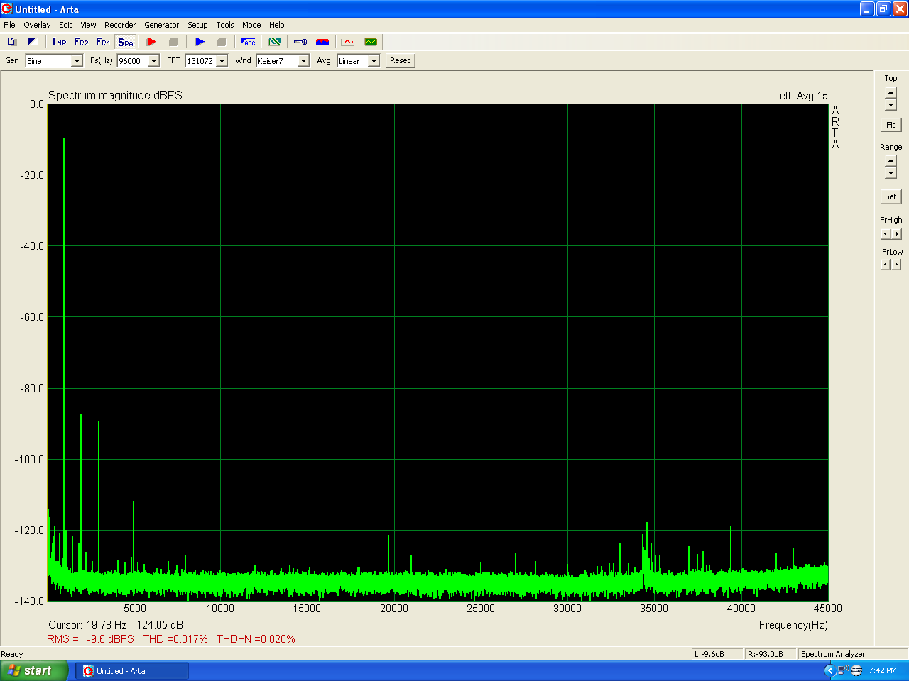

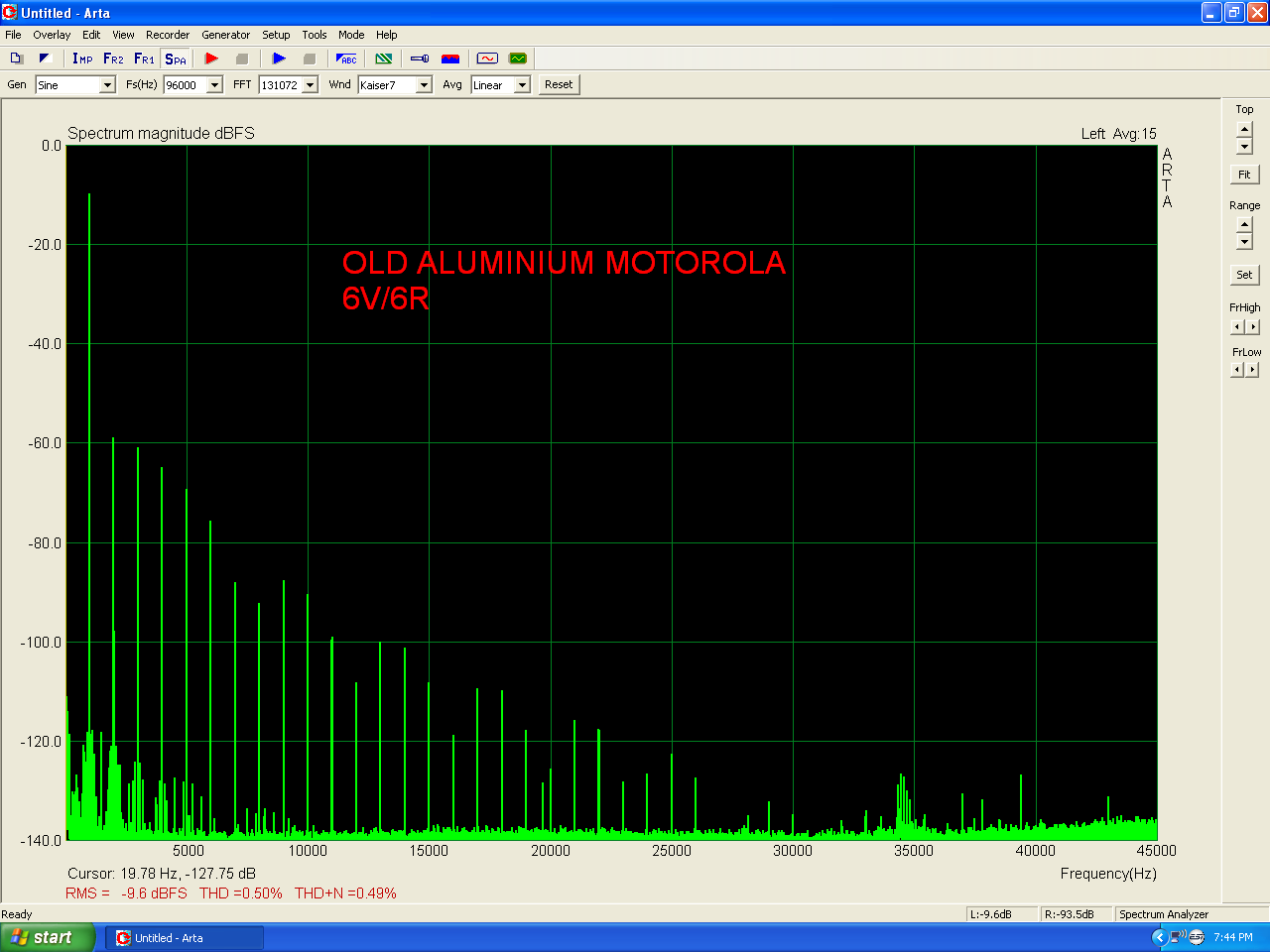

Black board 2N3055 MOTOROLA
IMG_20181128_192951.jpgOld aluminum Motorola original for sure!

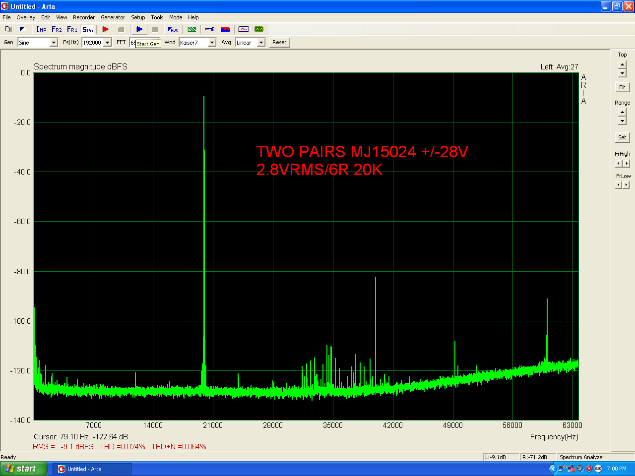

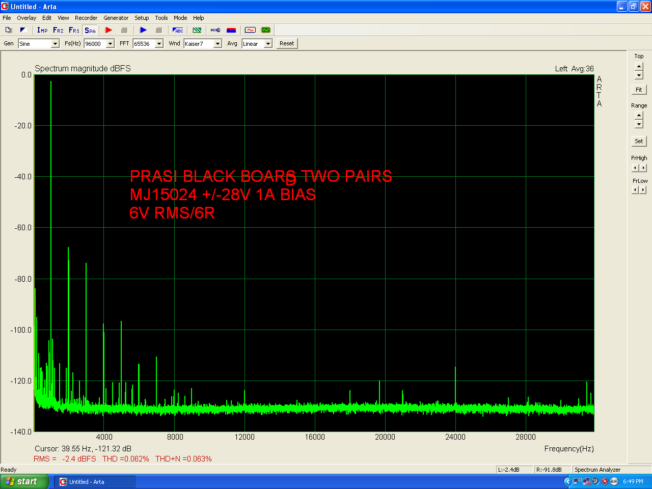

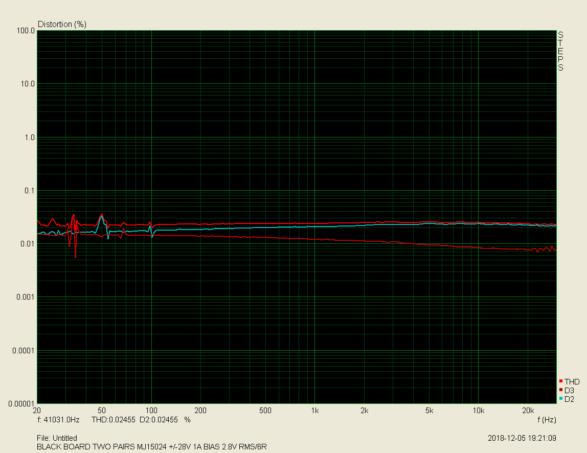

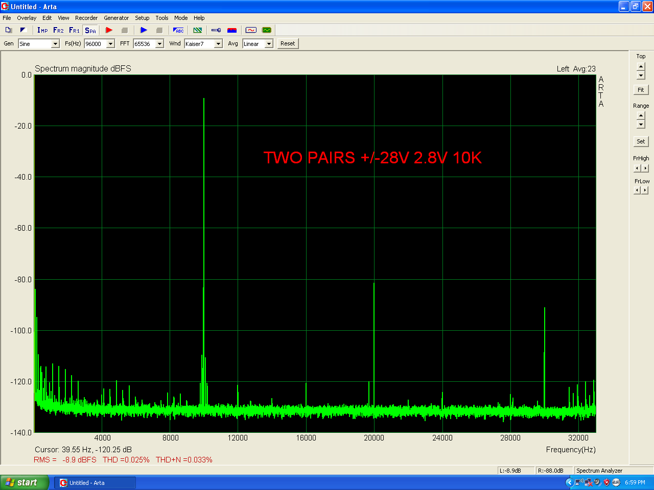

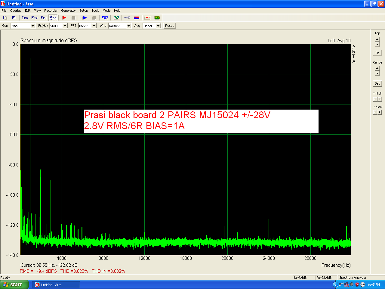

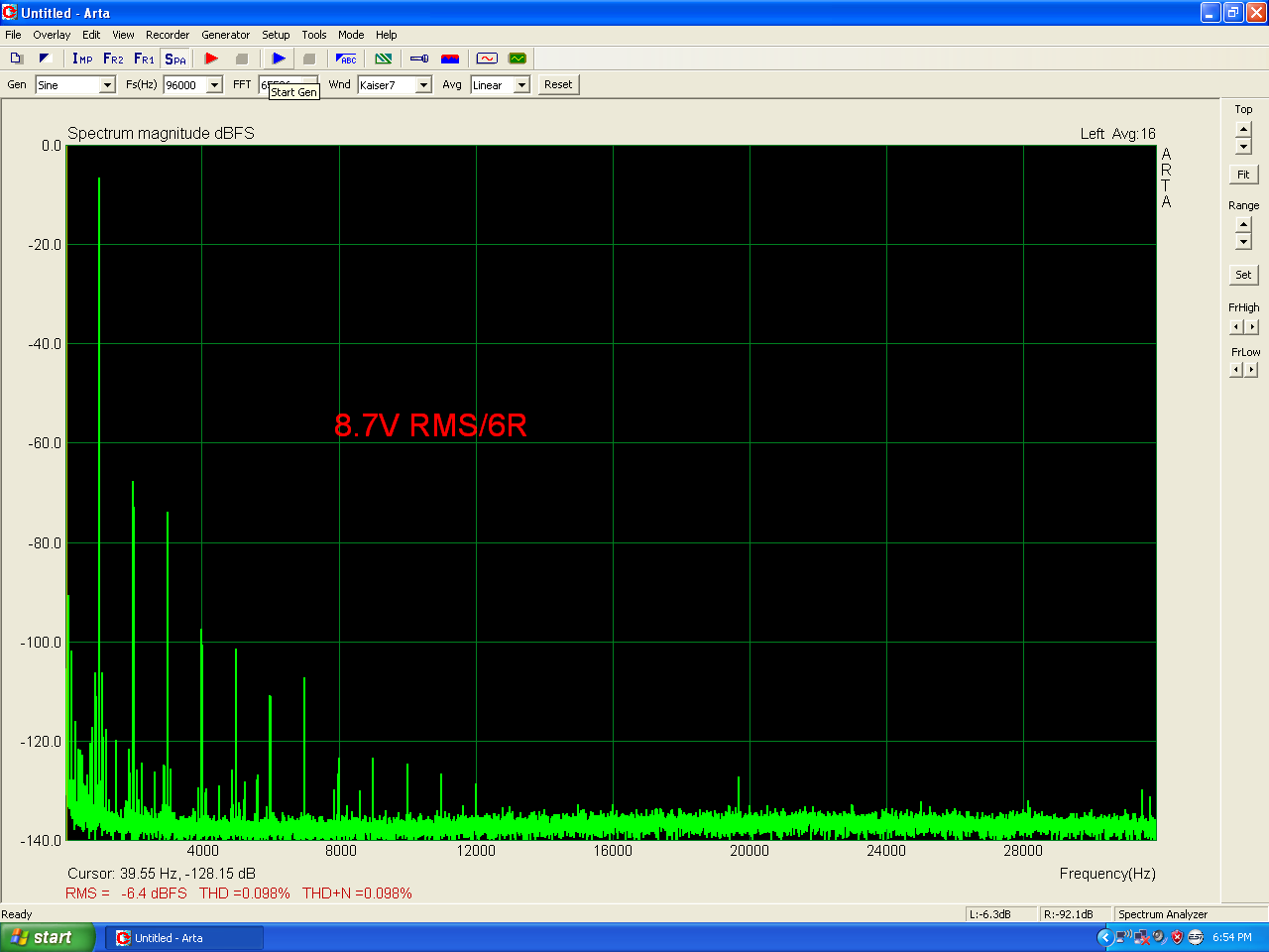

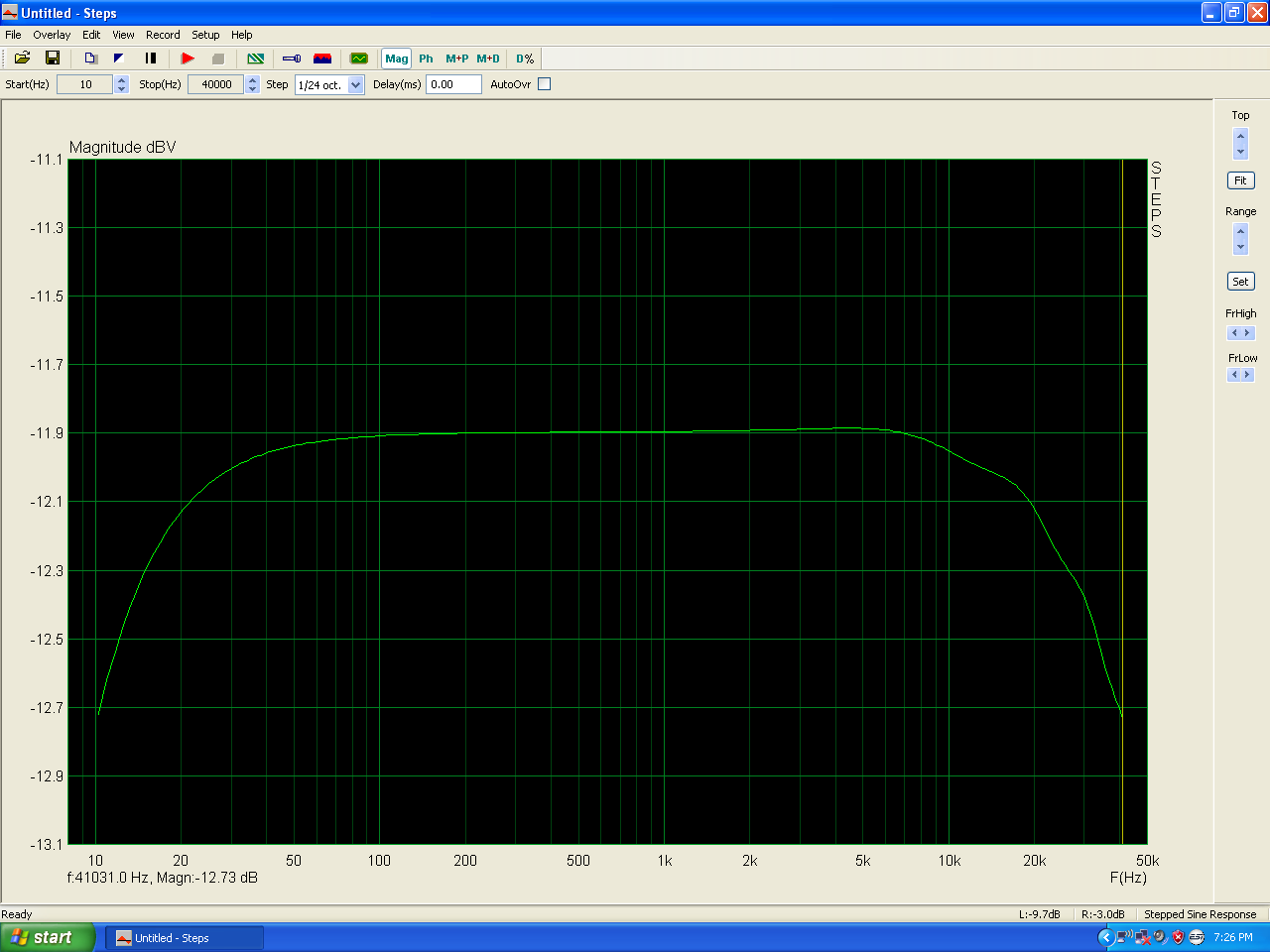

Black board two pairs MJ15024
Prasi's black board using MJ15024 .
Power Supply=+/-28v
Bias=1A.
