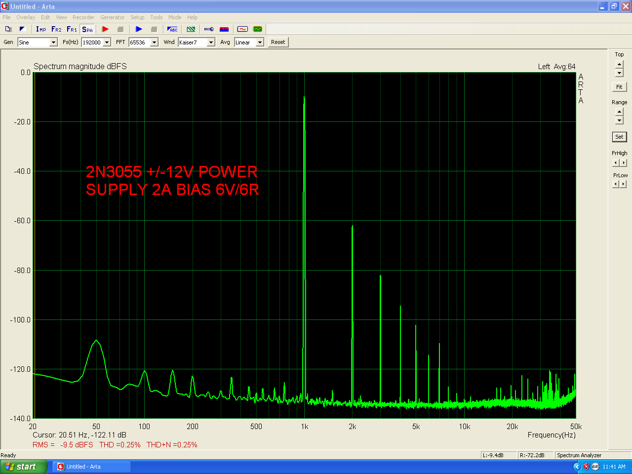

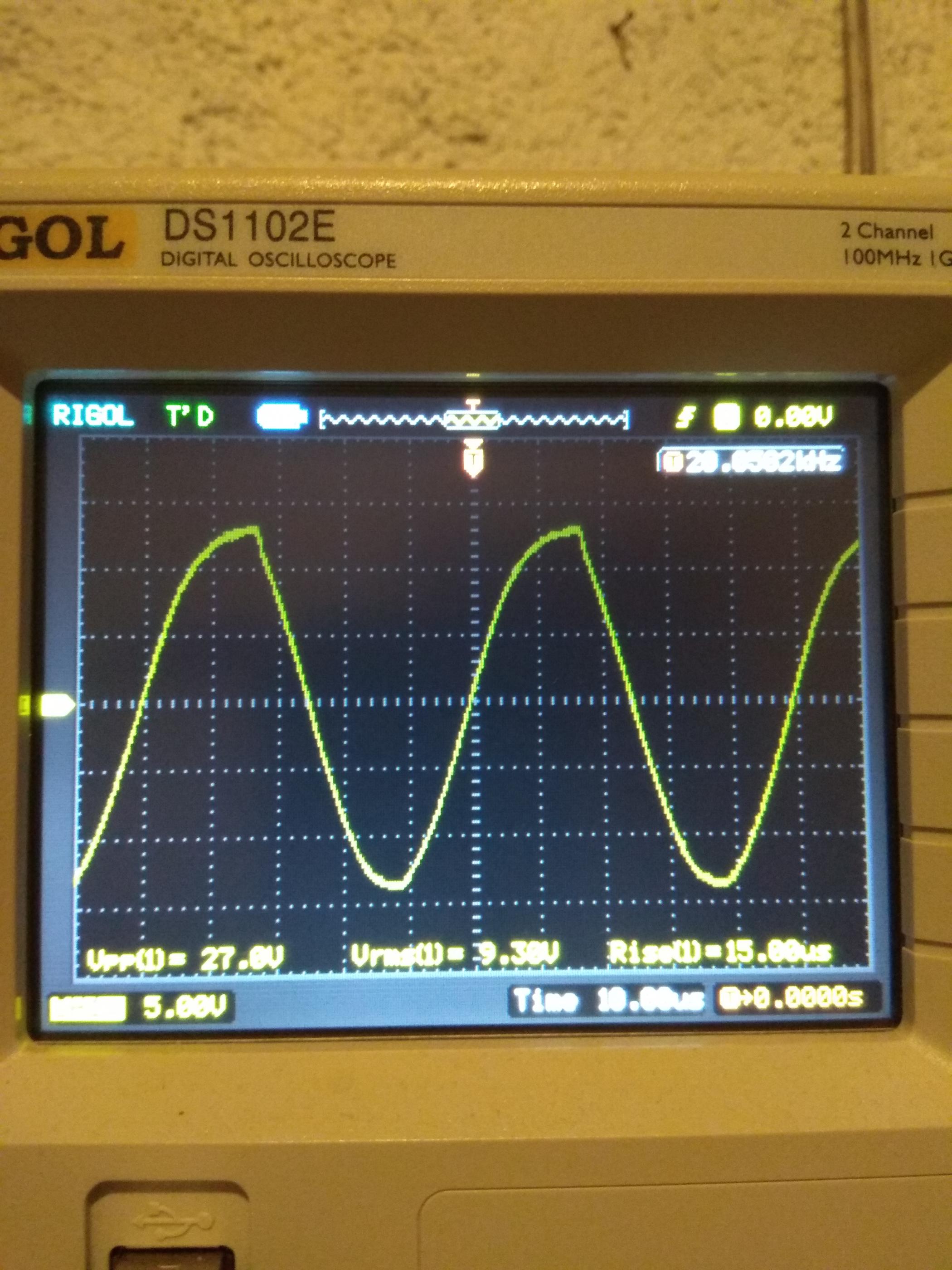

JLH 2N 3055H

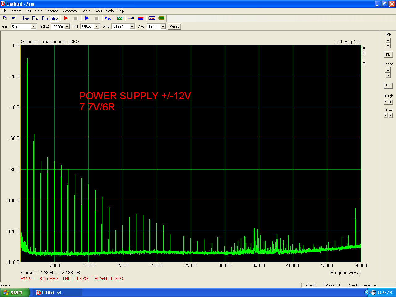

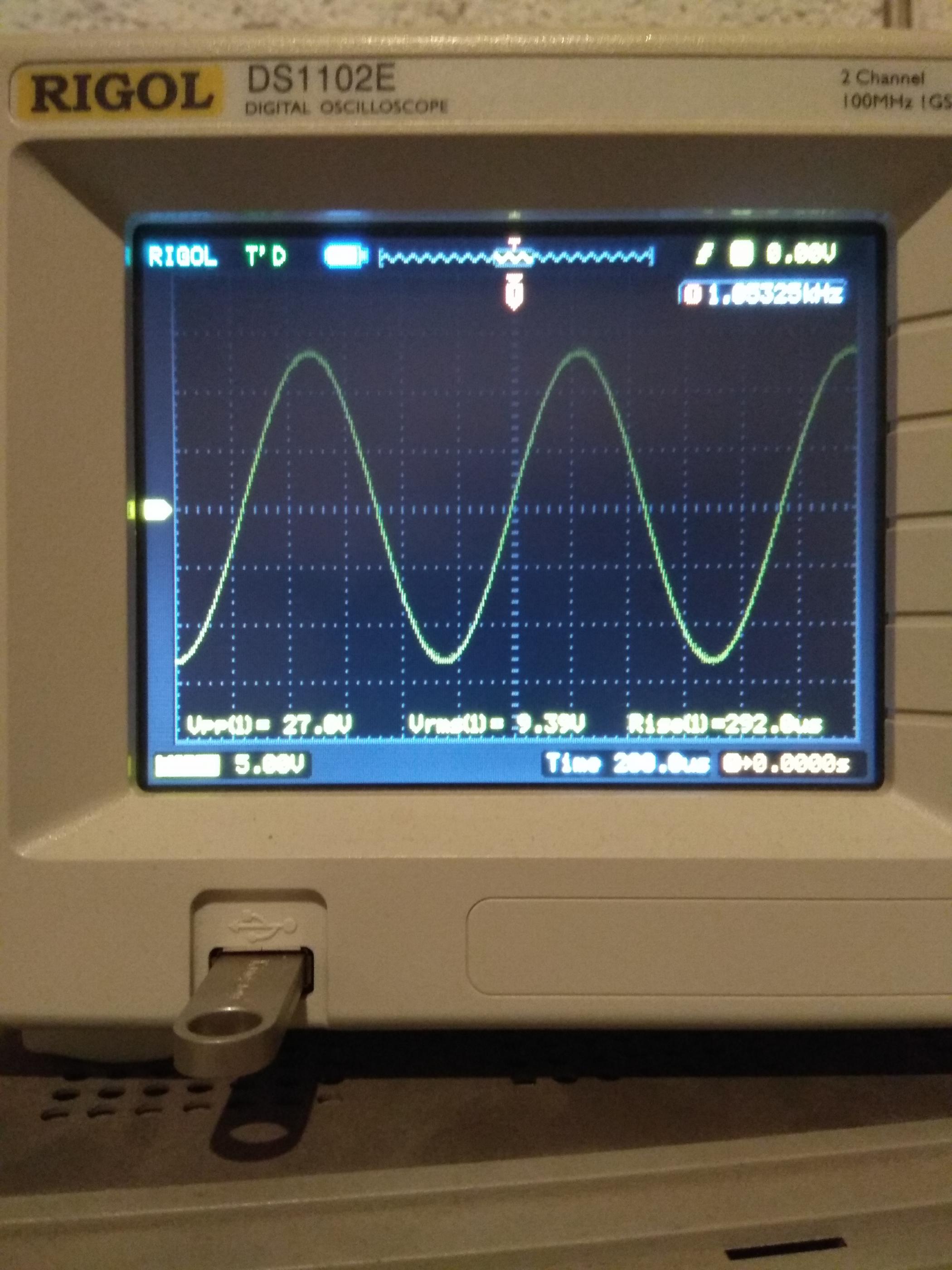

Here is the Prasi's red board using 2n3055h and +/-12v power supply
Last photo scope when out =7.7v/6R

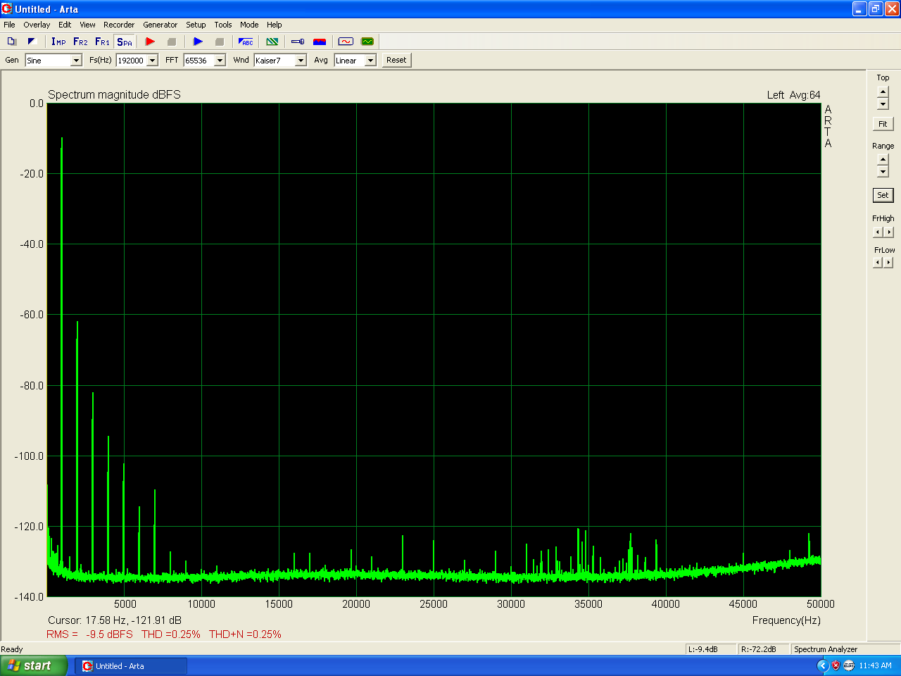

Yes i see.Thank you thimios for posting 3055 results . I was waiting impatiently . I am still hoping for mj15015 results . There is 20db difference 2nd/3rd harmonics with this one .
Are you like this difference?
Sorry but i haven't any mj15015.

+-12V ( or 0 24 V ) 2 amp looks good.

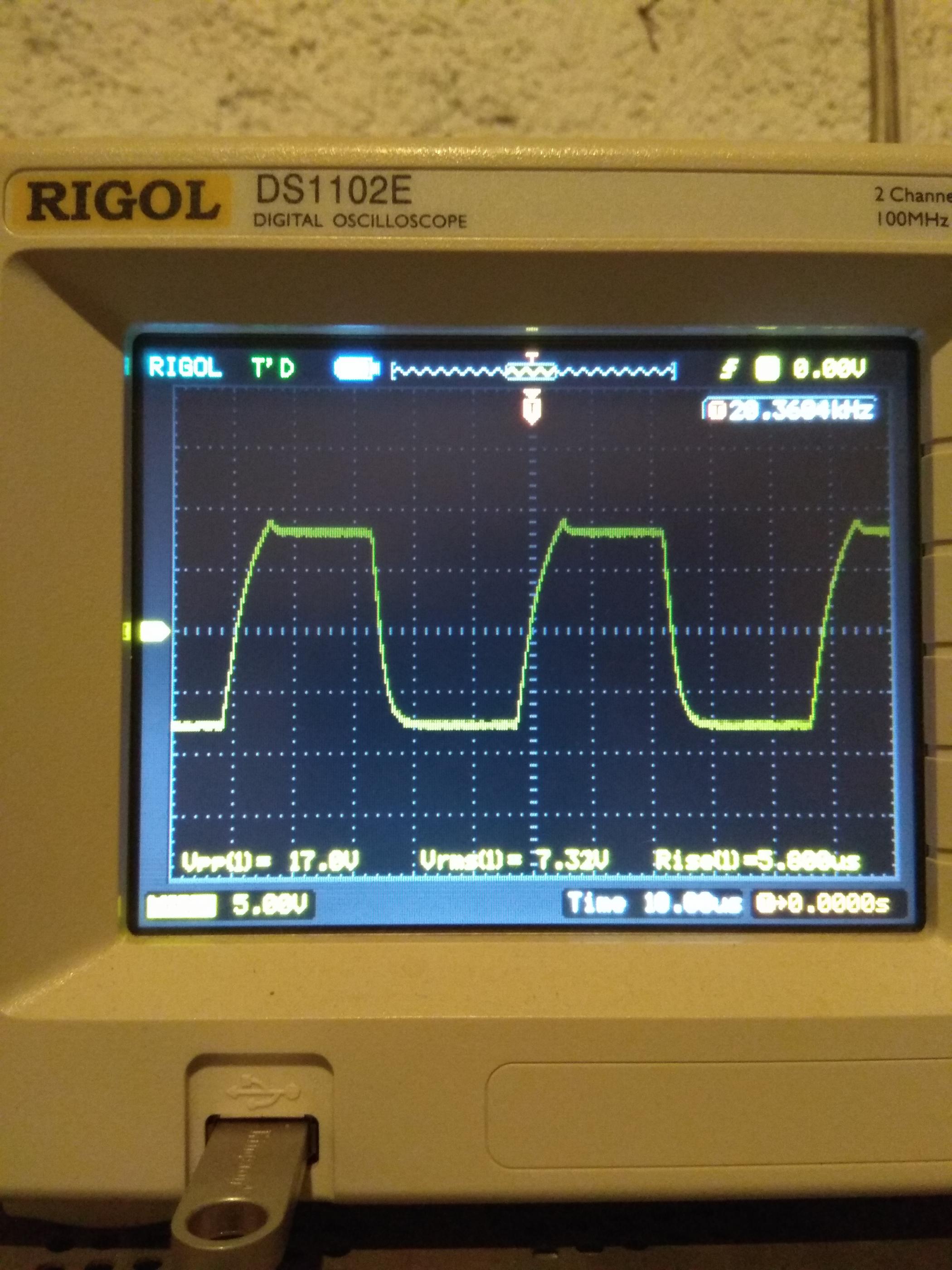

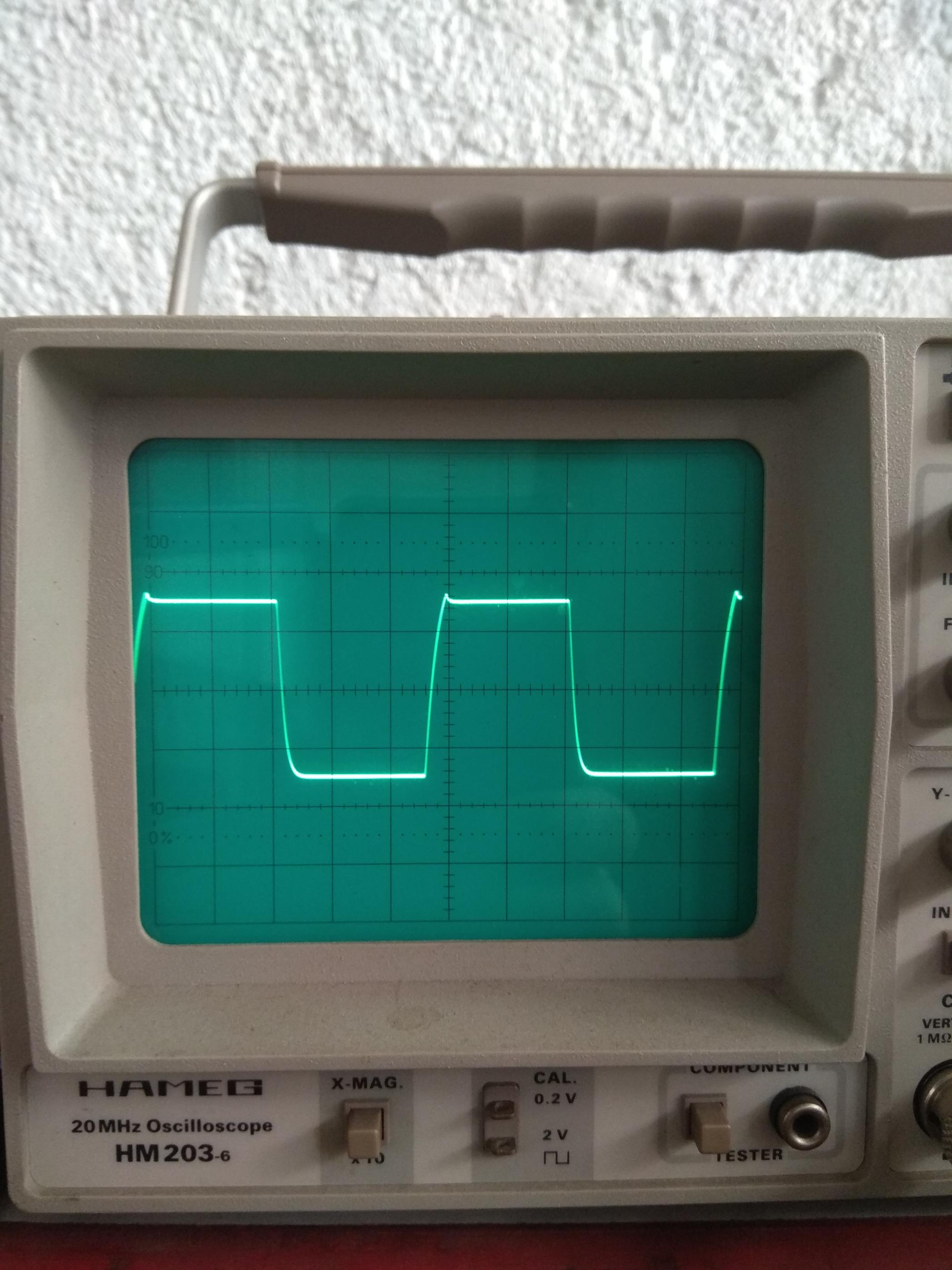

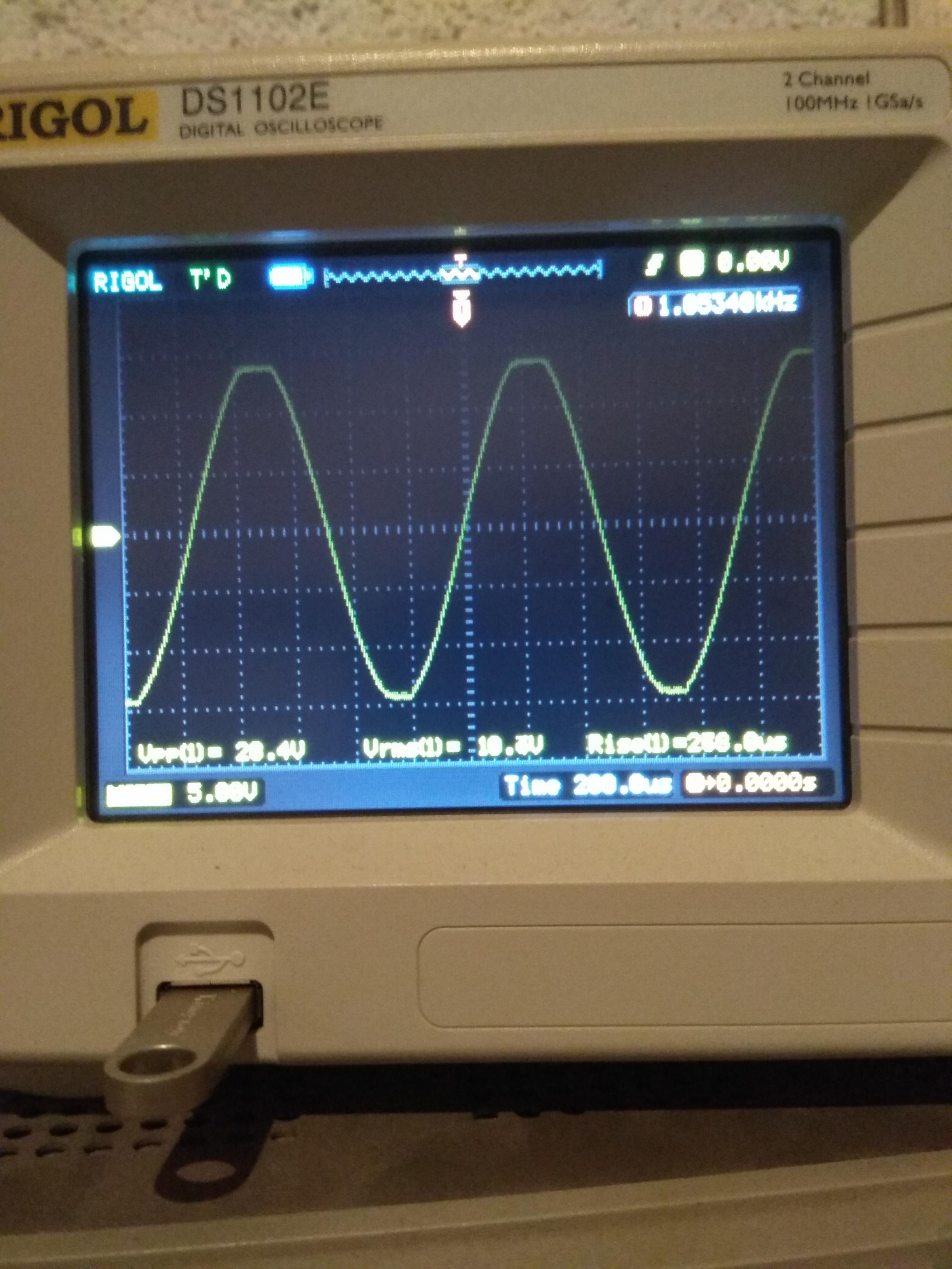

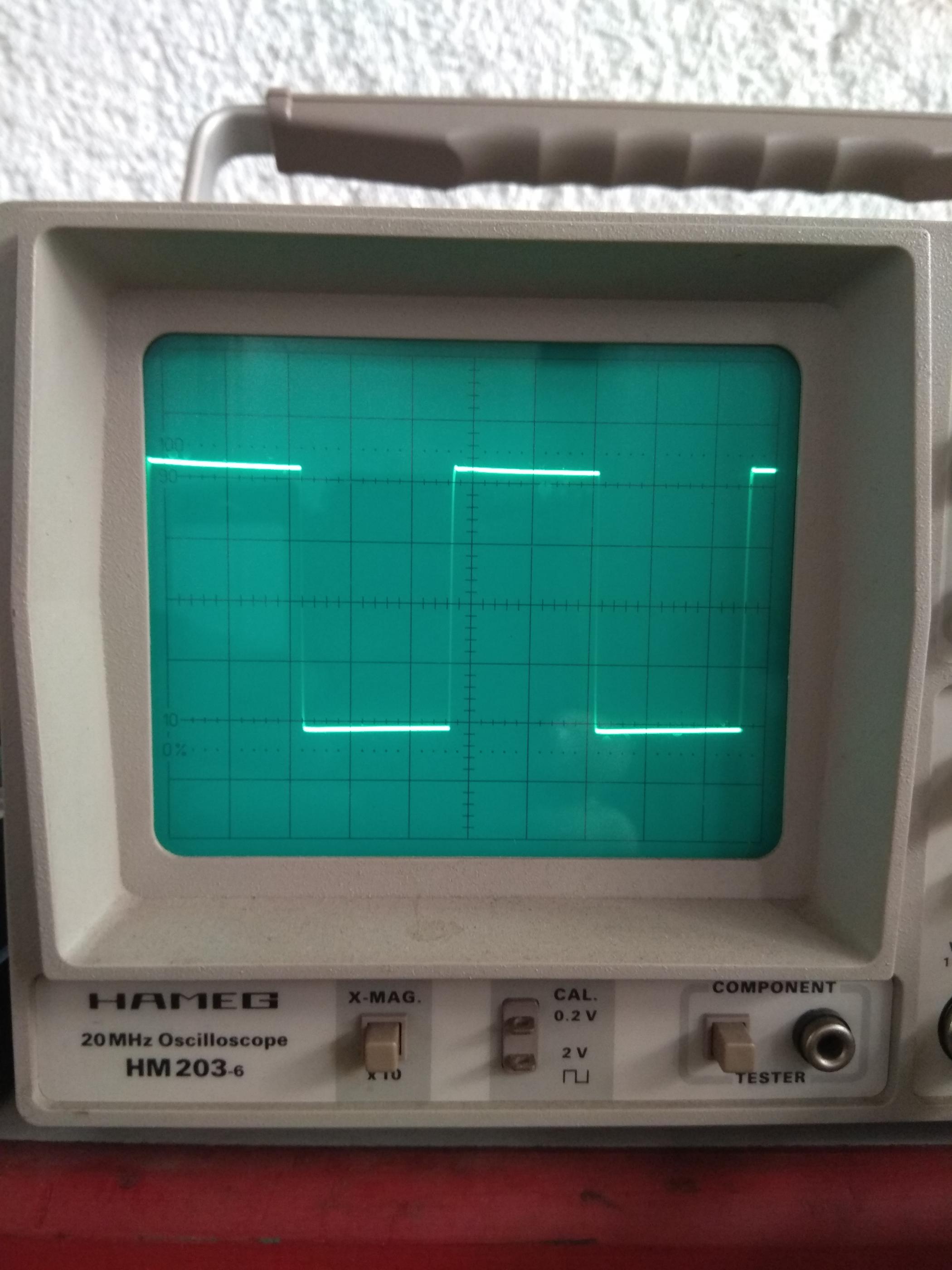

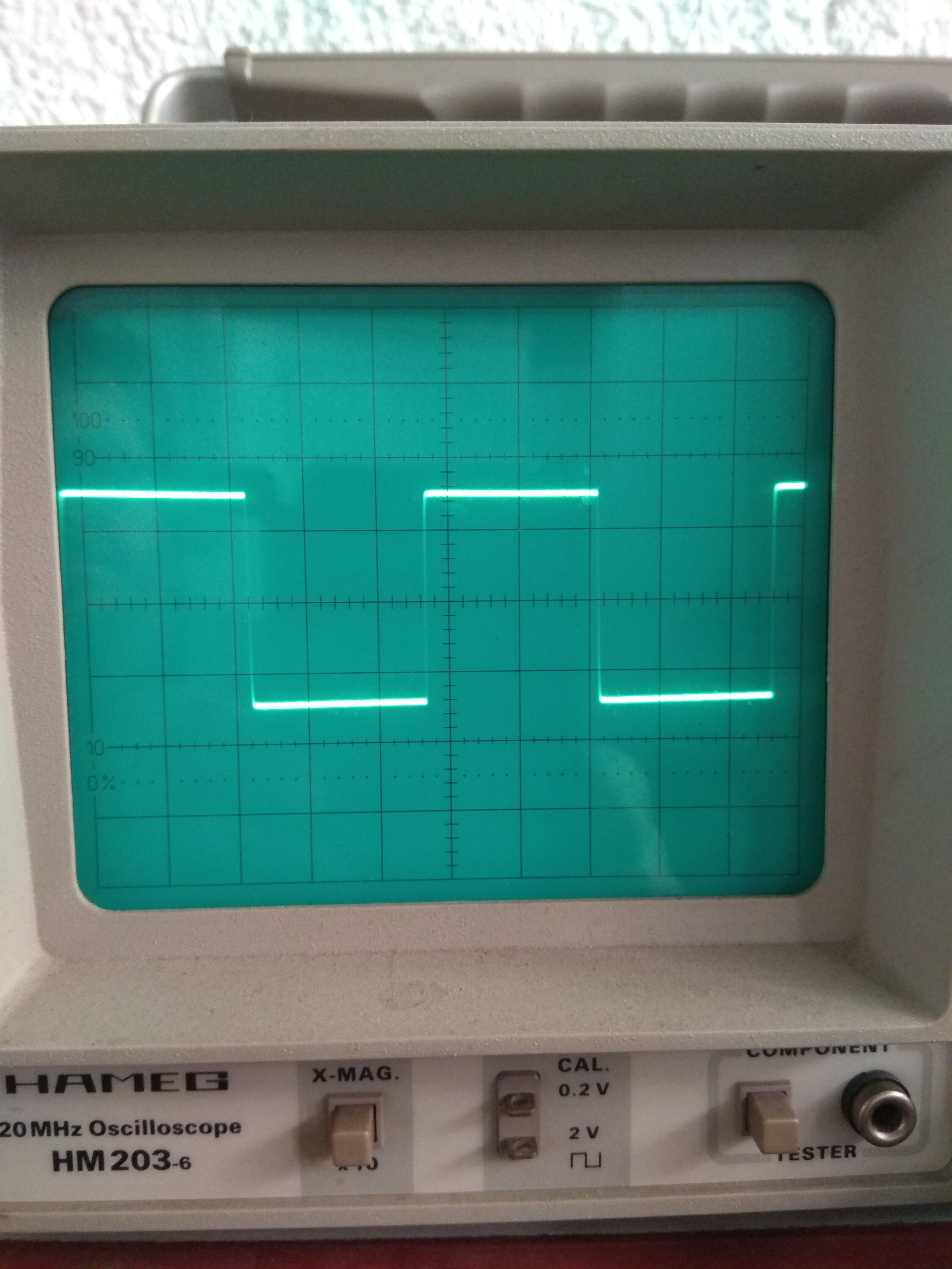

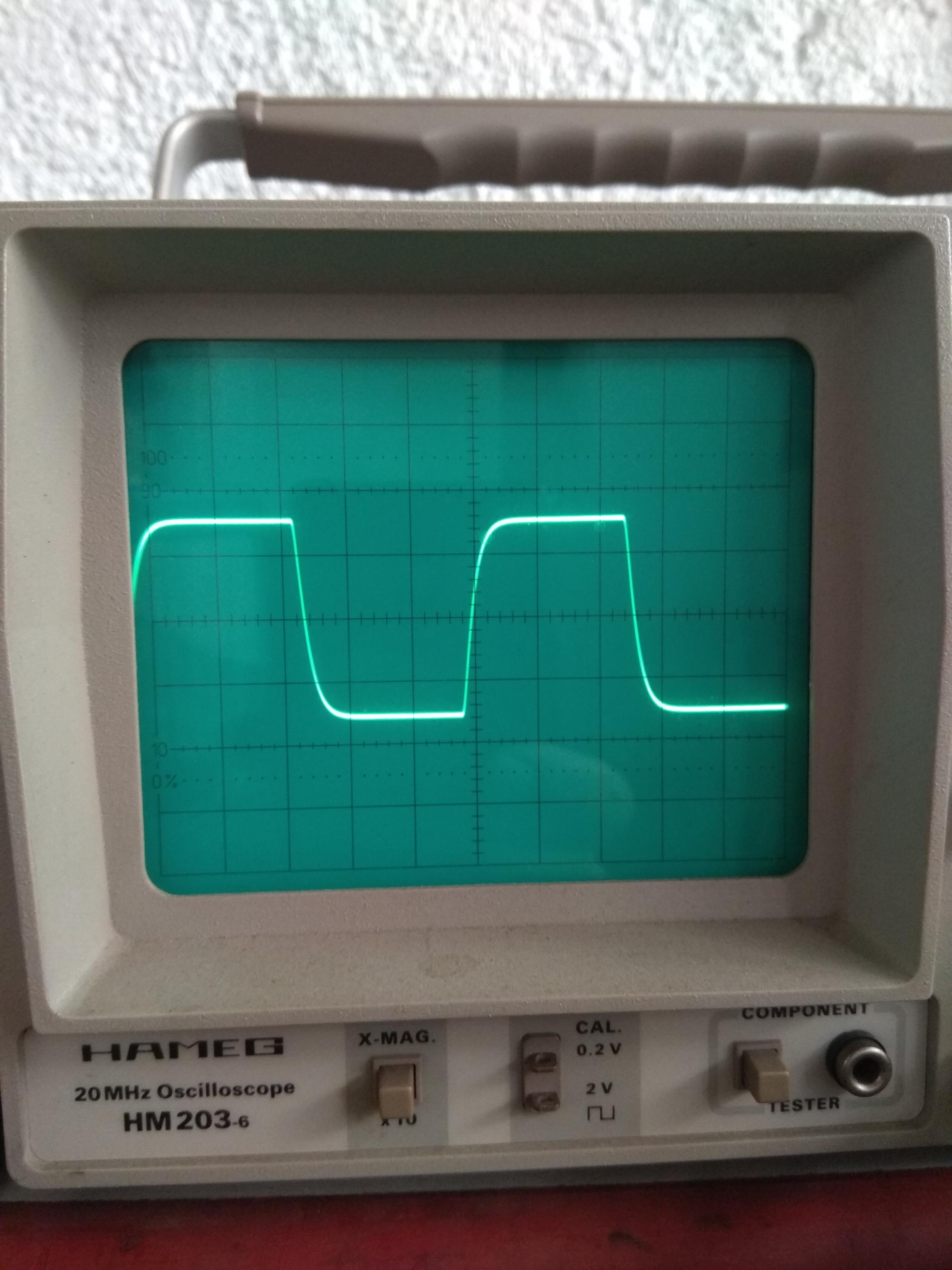

10kHz
20kHz

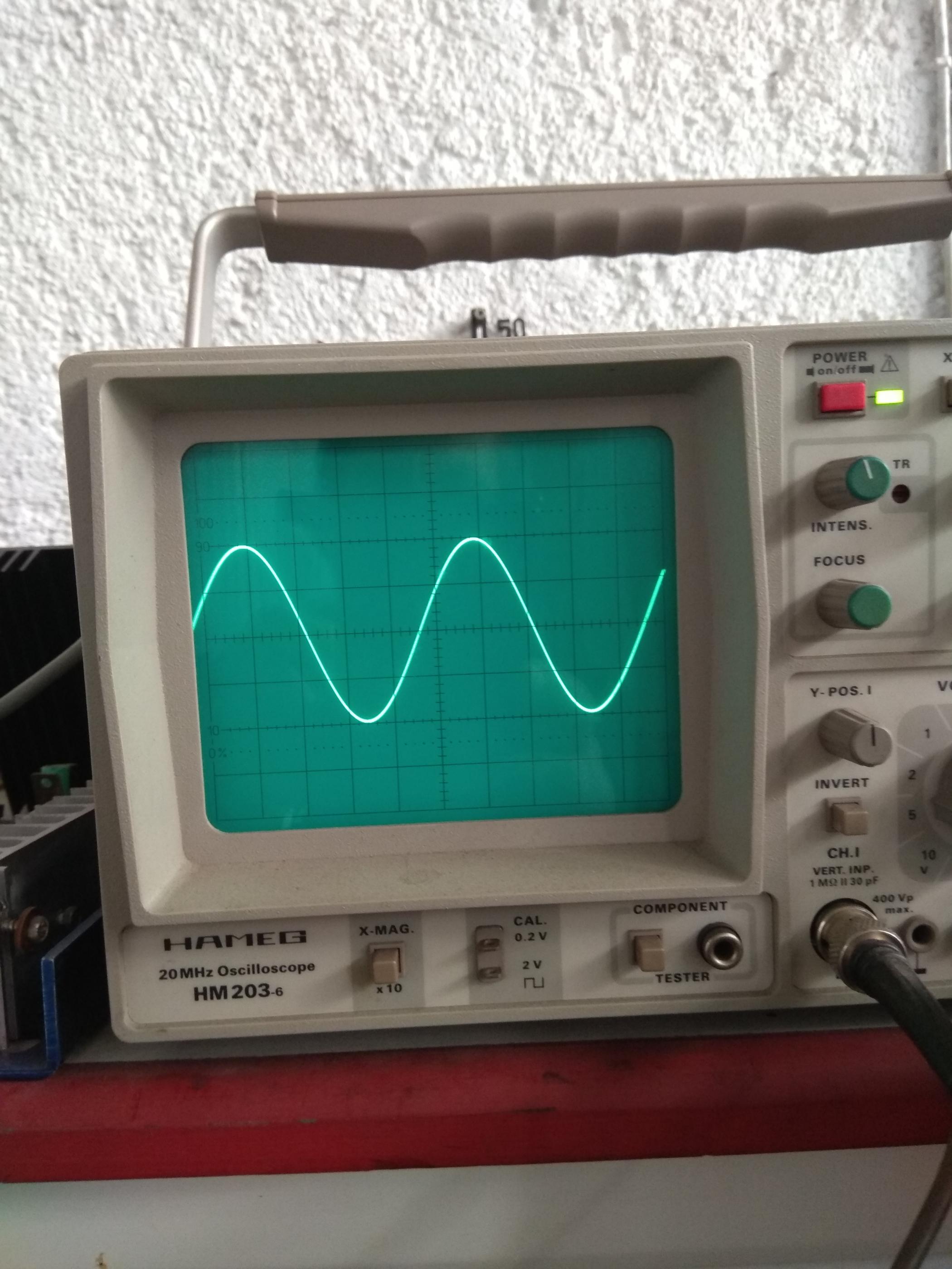

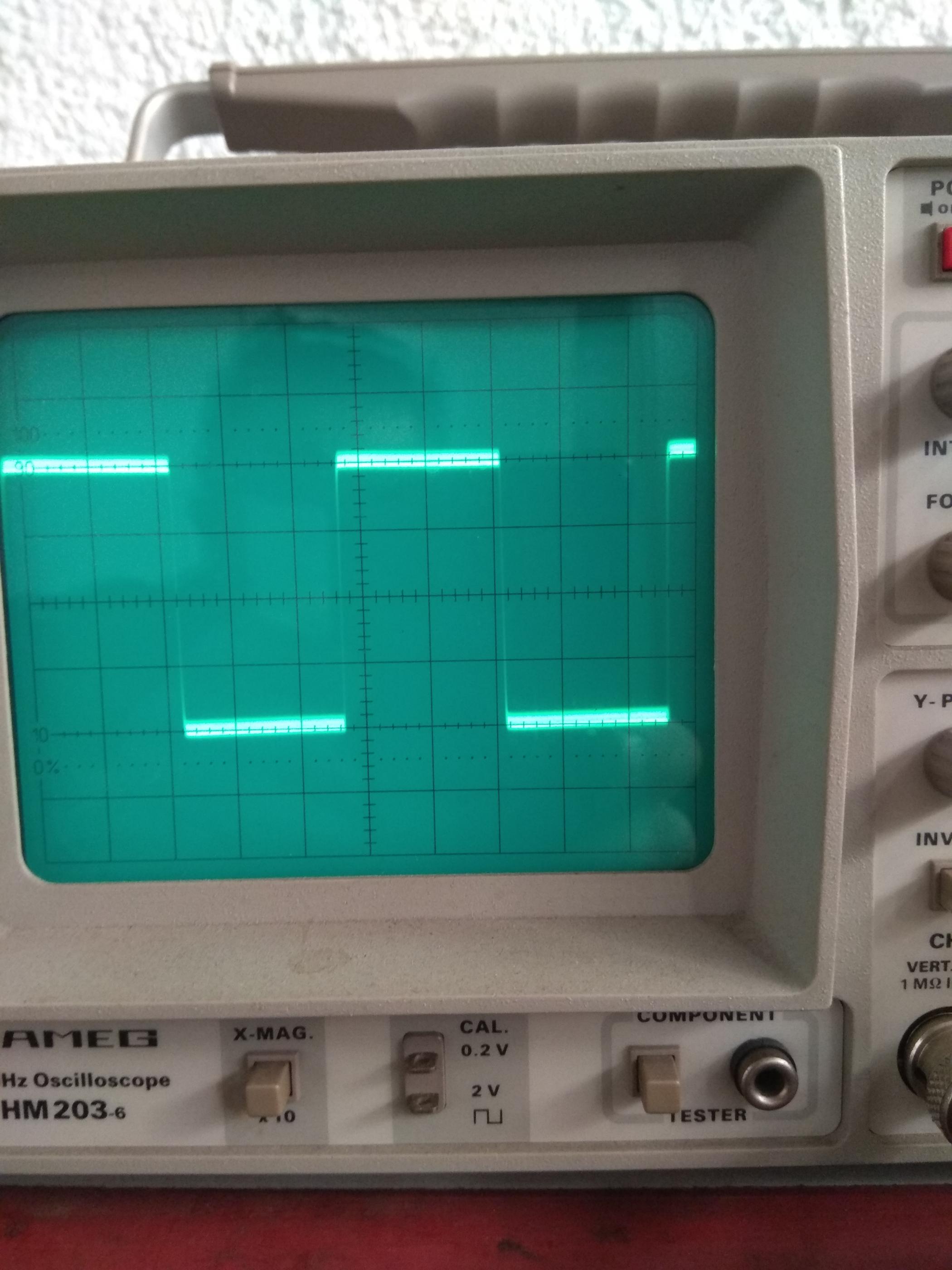

Very good. 10 kHz needs circa 190 kHz bandwidth. Looking at this one it's slightly less. The slight overshoot looks OK,
Hi thimios

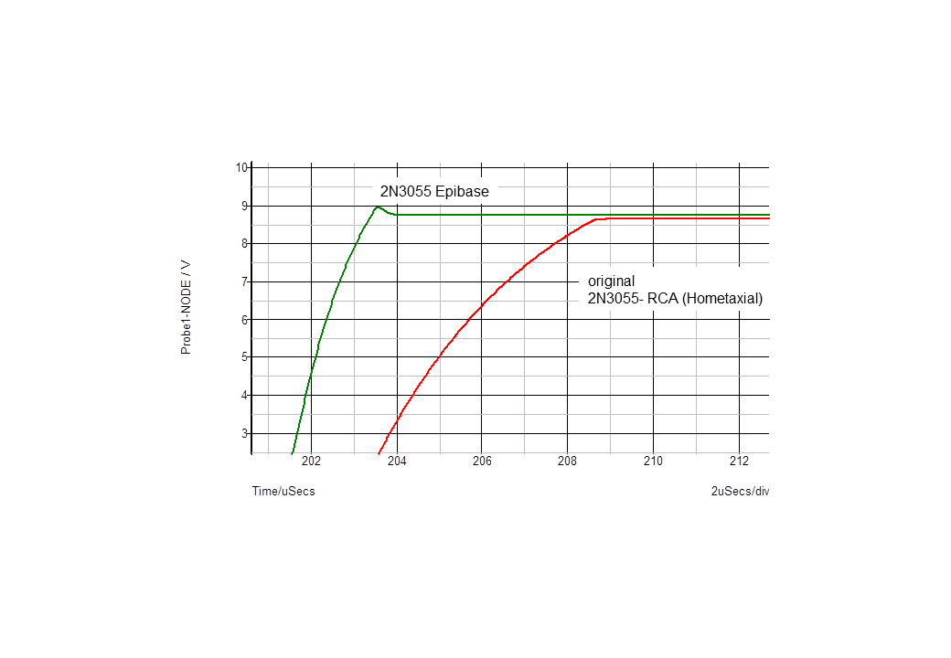

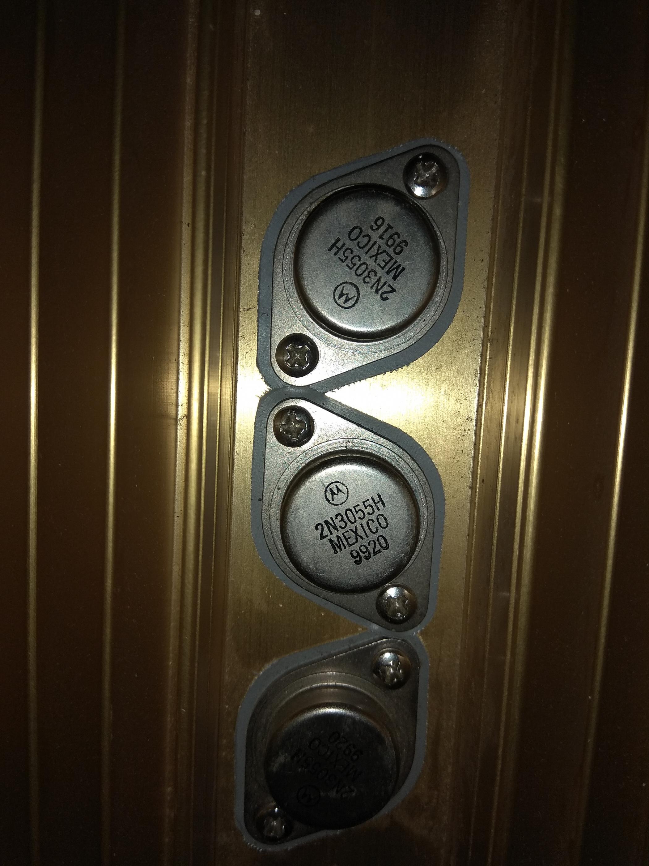

Your results are good for a 2N3055H. In a simulation of the JLH with original (RCA hometaxial) devices and an epi-base device, I get much worse performance with the RCA than with an epibase, which also shows your slight overshoot.
I suspect that although your transistors might be labelled 2N3055H they are actually an epibase type from a process that gives a good second breakdown performance. I am sure ON Semiconductor have several choices of lines (MJ15003, MJ15015 etc) that they could use to provide an "H" -like second breakdown device.
I have also had to generate a model for the RCA device as most models available use a tf parameter that is more like the epibase. But it is a moot point as the RCA original is no more.
What is the 2N3055H.
