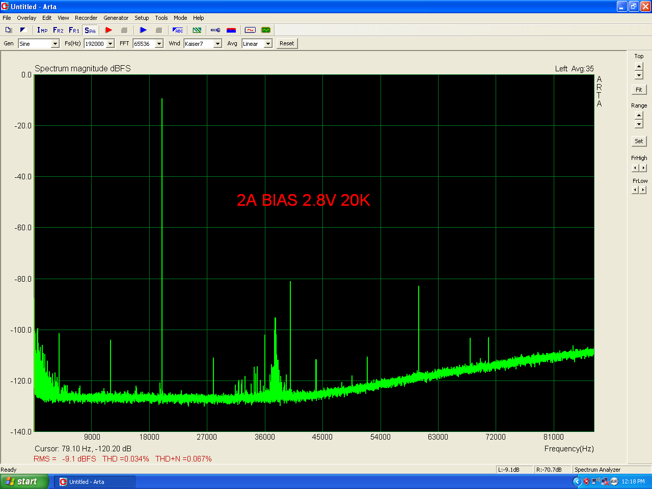

Thimios. What spectrum analyser are you using?

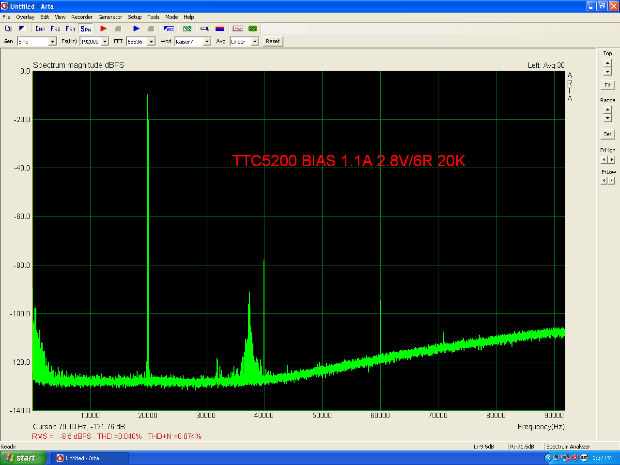

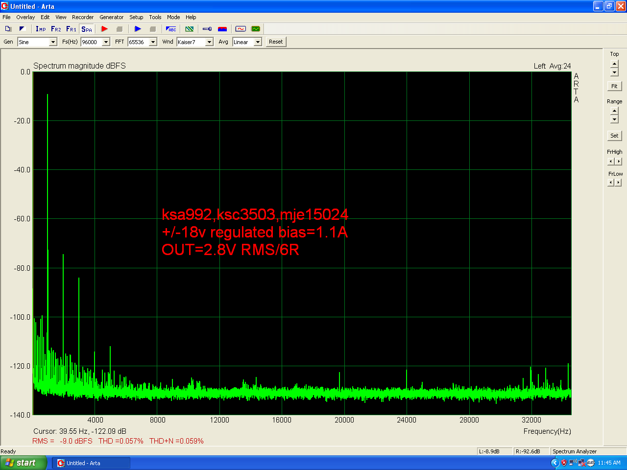

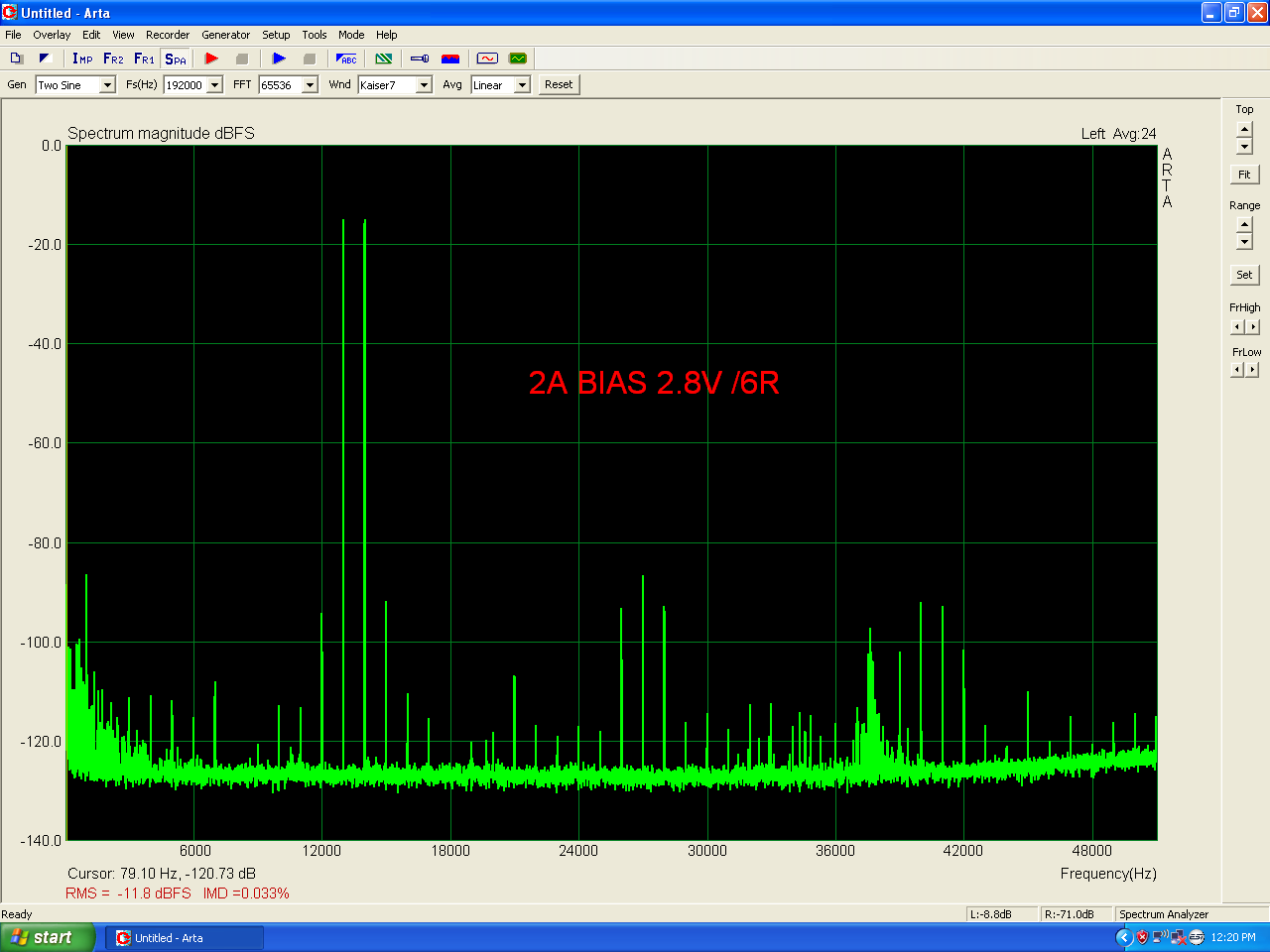

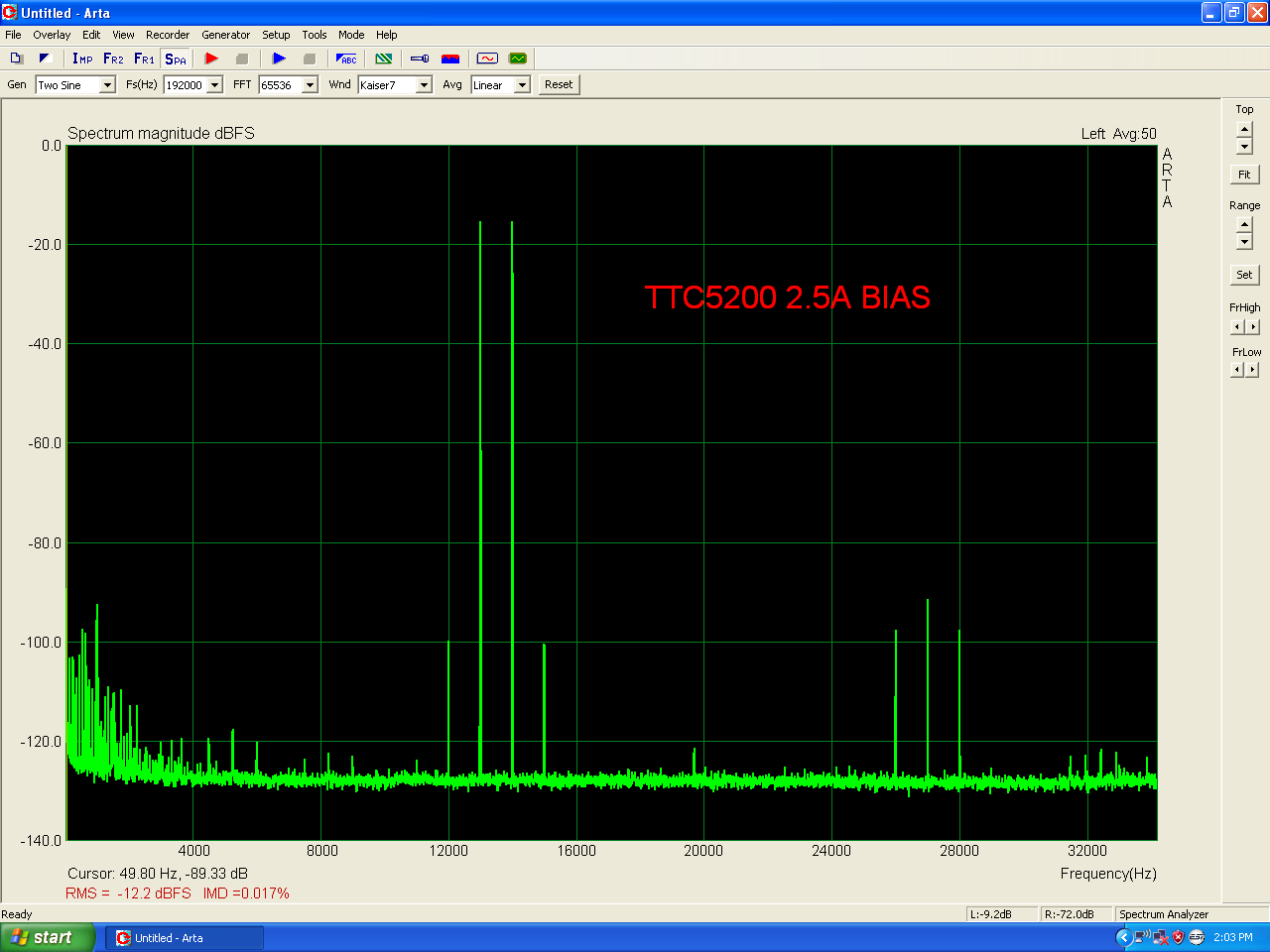

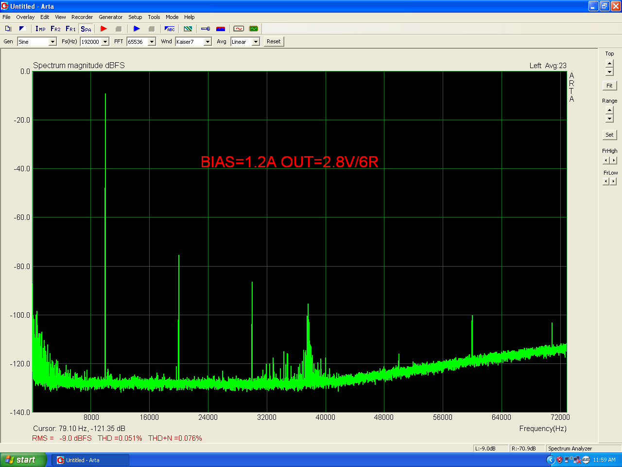

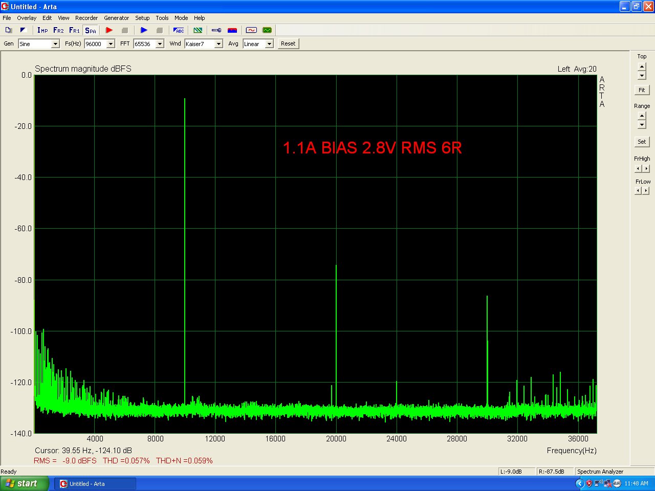

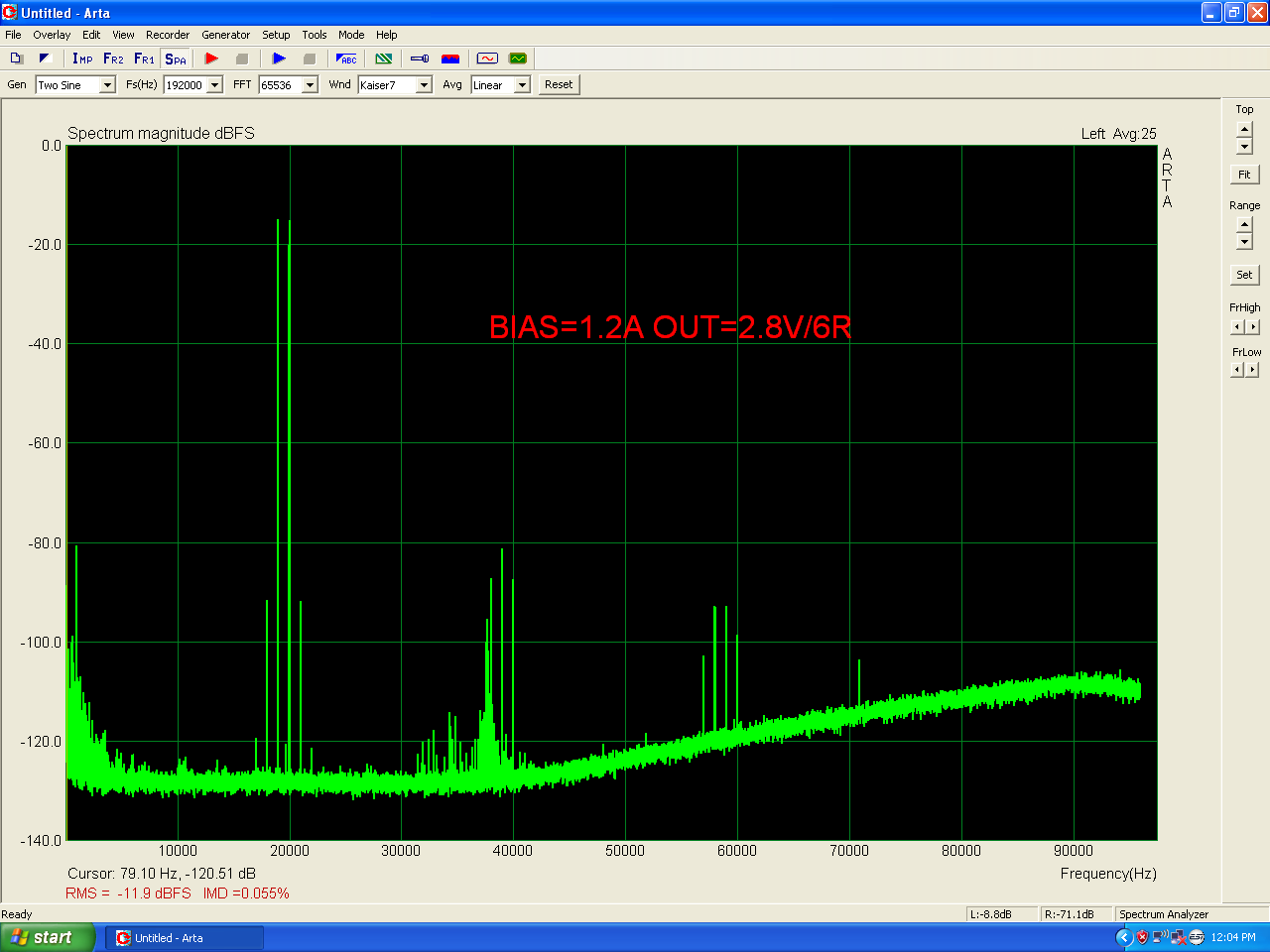

A p.c based fft analyzer has been used.
Sound card is an EsiJulia.
Software is Arta.

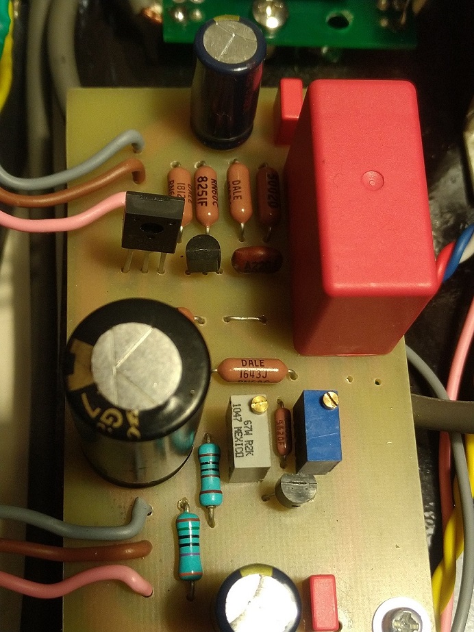

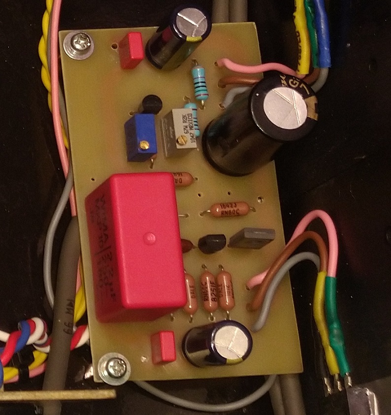

I have two version JLH.
One using bc 560c, bd139-16,ksc3503d,TTC5200 (prasi's red pcb.
One using the same but 2N3055H.
Second, using"tsca970,bd139-16,ksc3503d,TTC5200(prasi's long black pcb).
The last one same pcb but with ksa992, bd139-16,ksc3503d,MJE15024.

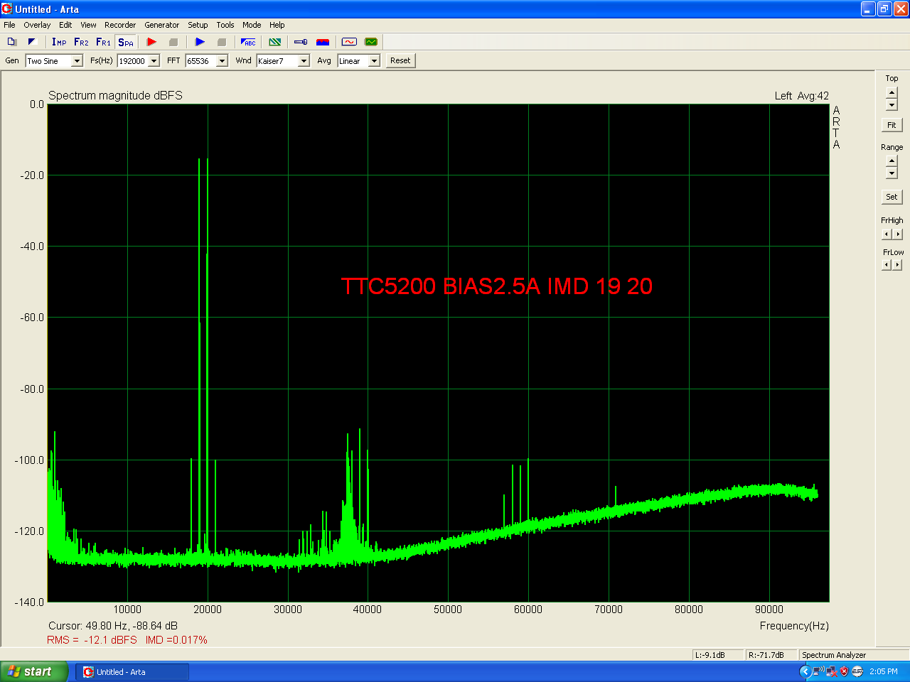

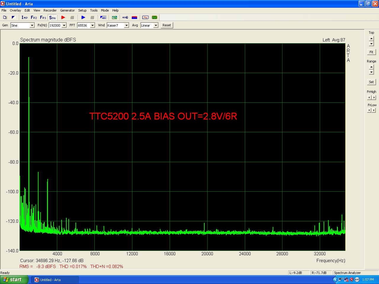

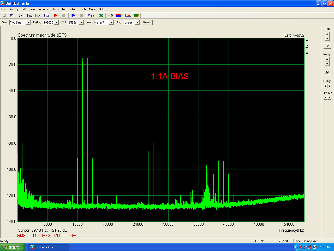

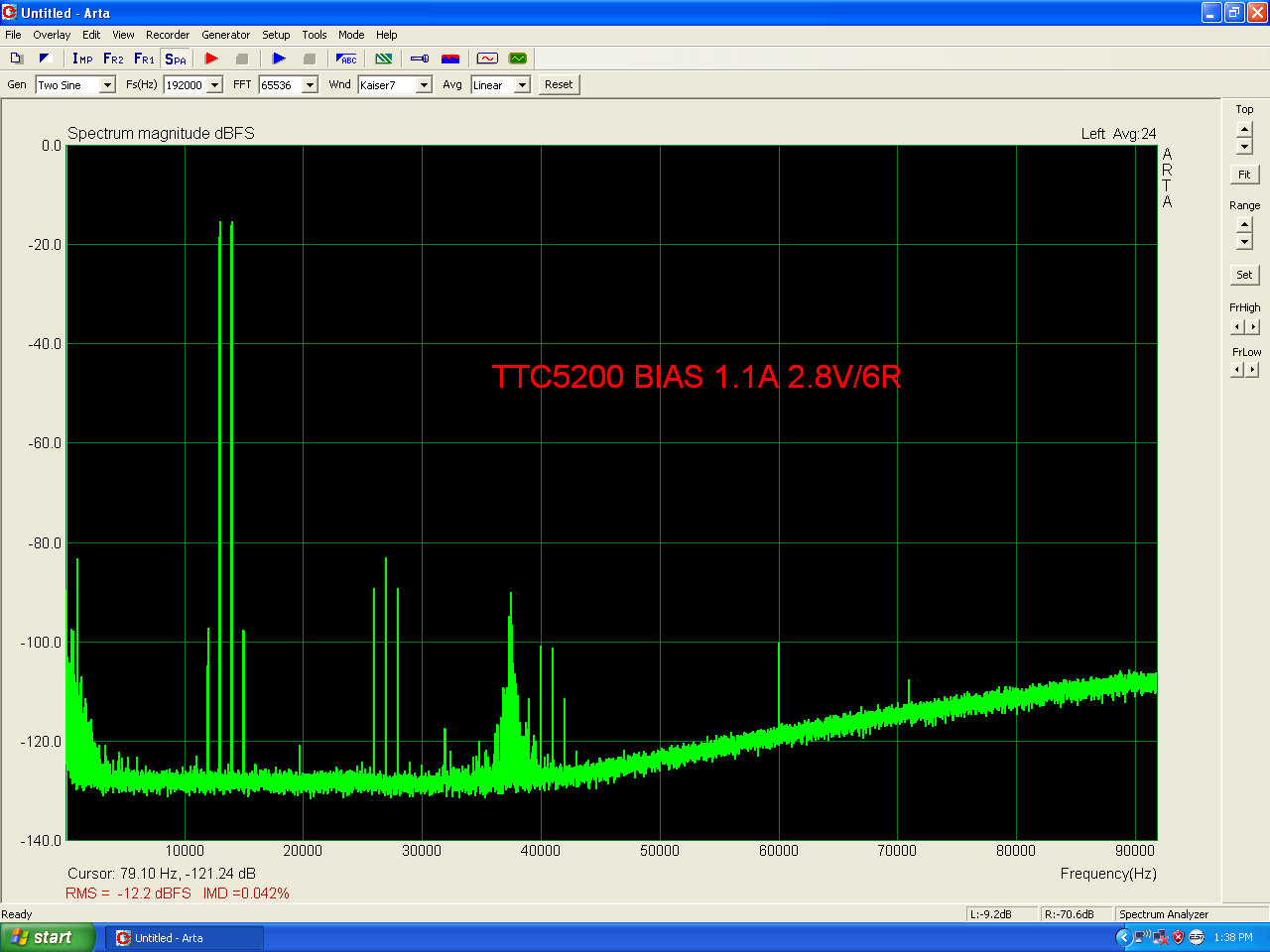

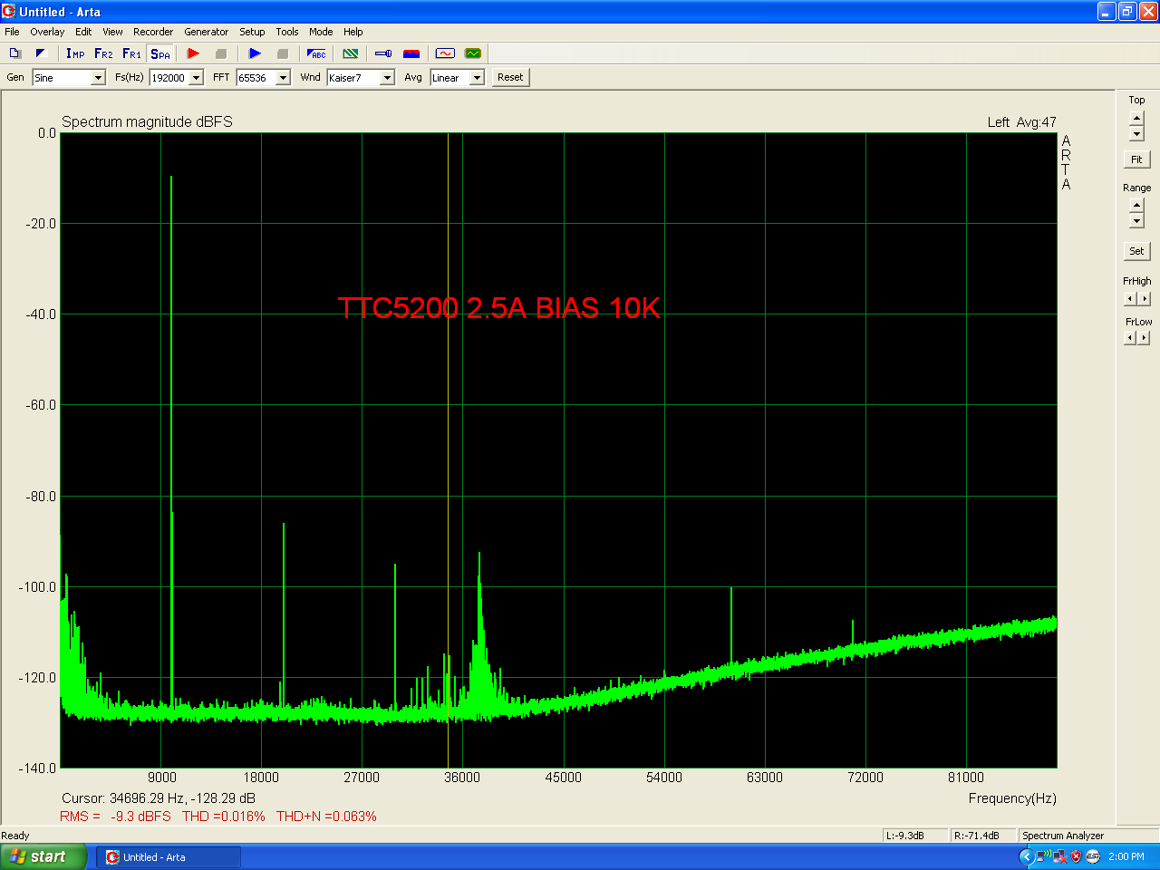

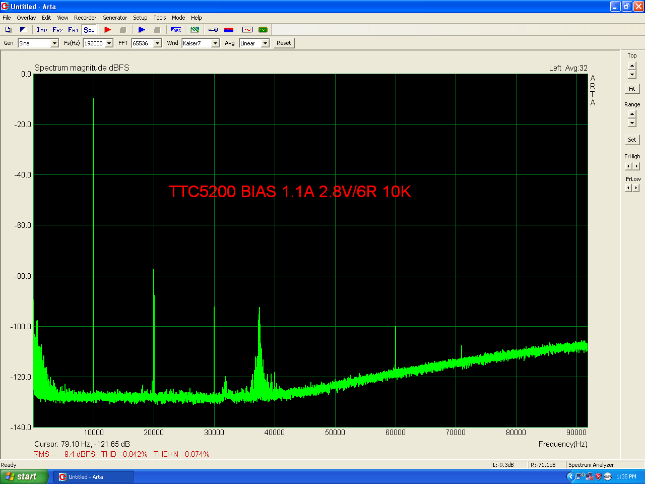

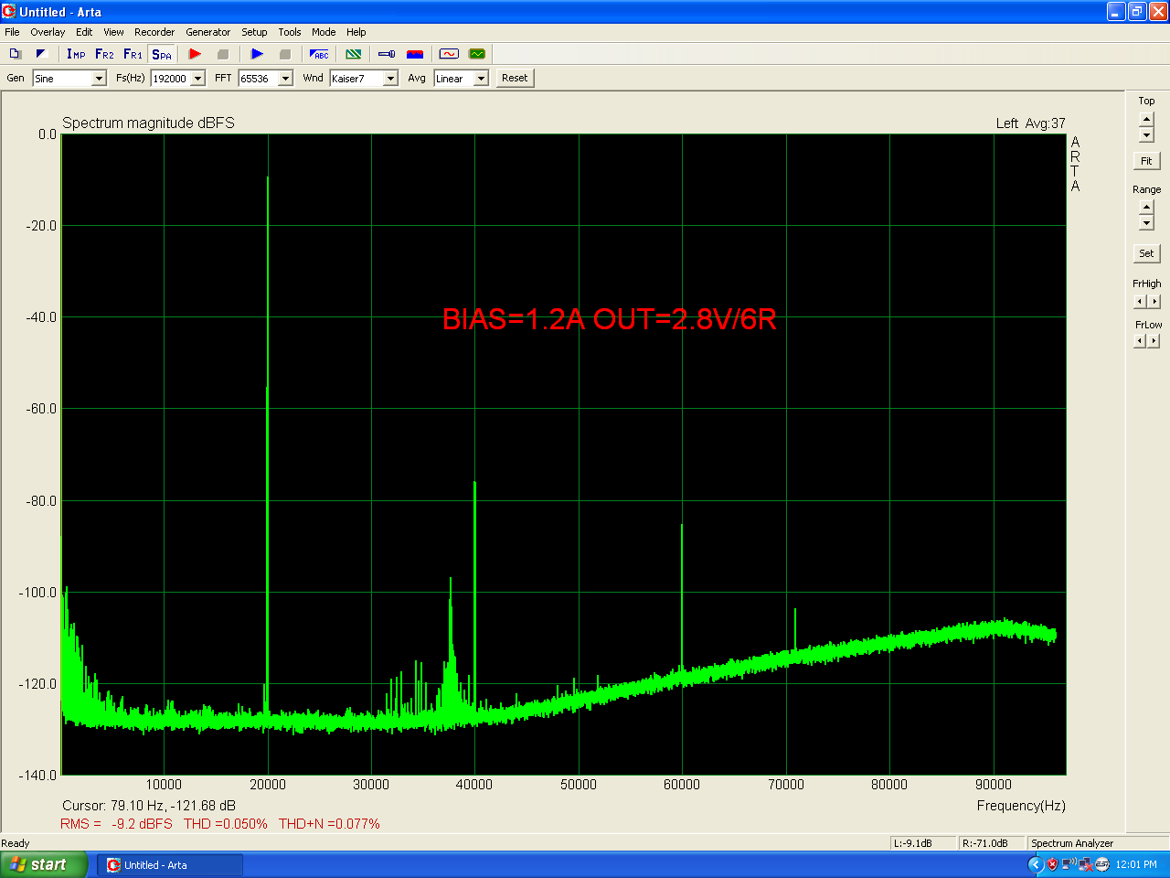

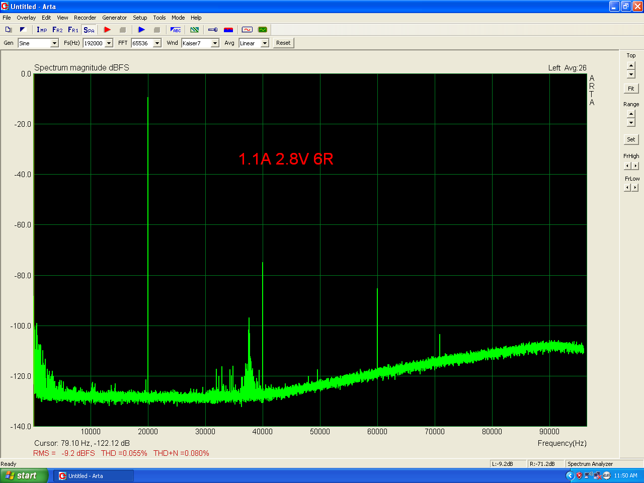

LOOKING FOR OPTIMAL SETTING
I will post some picture when trying finding the optimal bias setting.
bias=1.1A.
POWER SUPPLY IS REGULATED+/-18V
bias=1.1A.

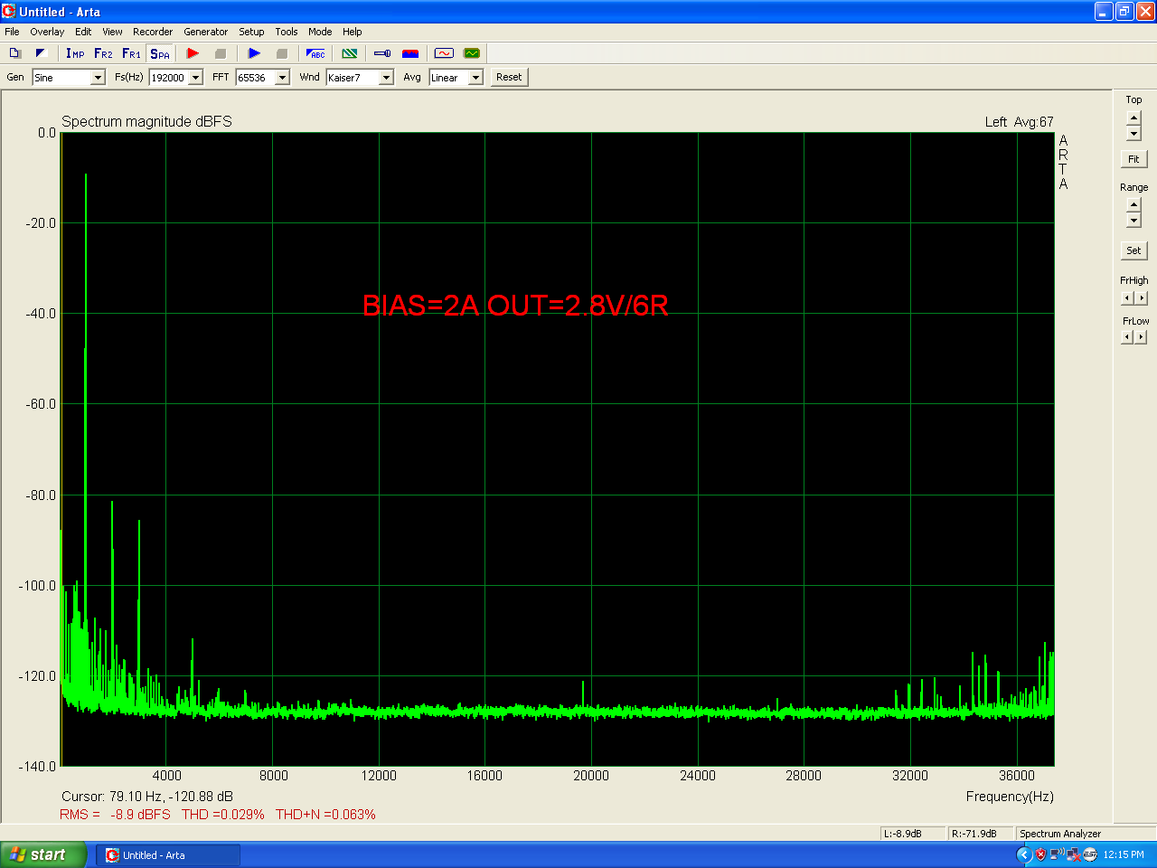

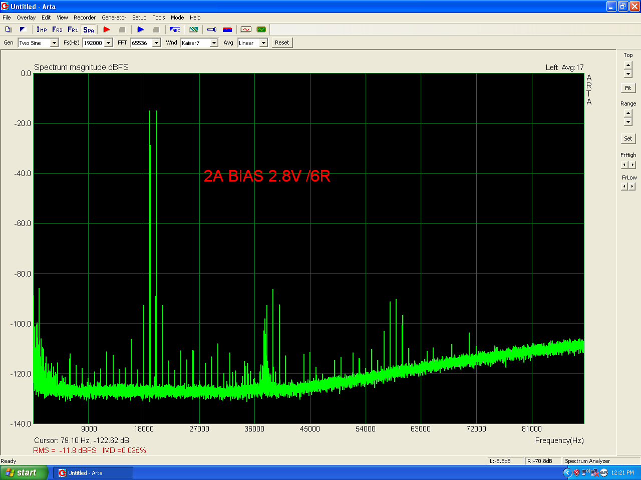

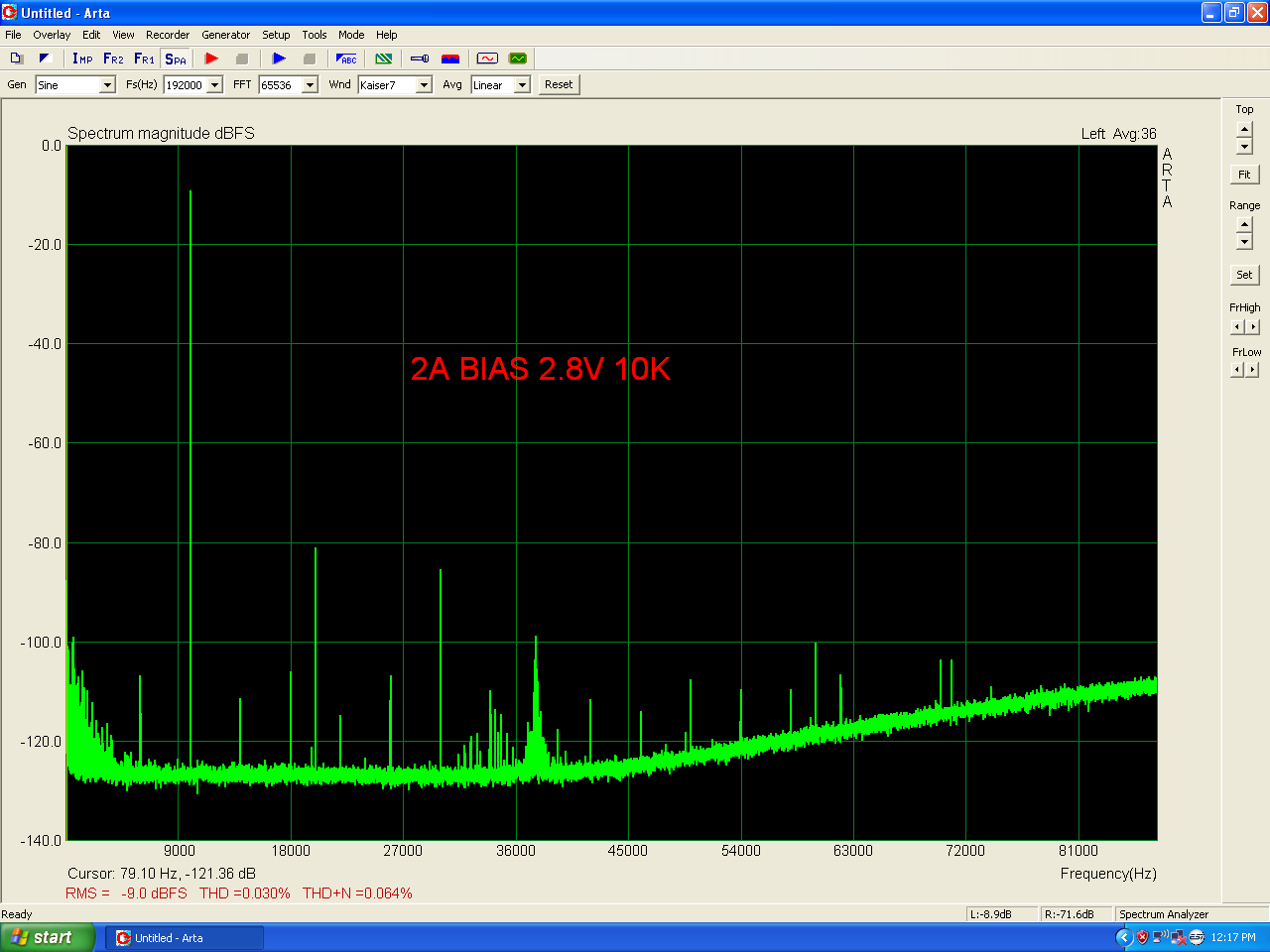

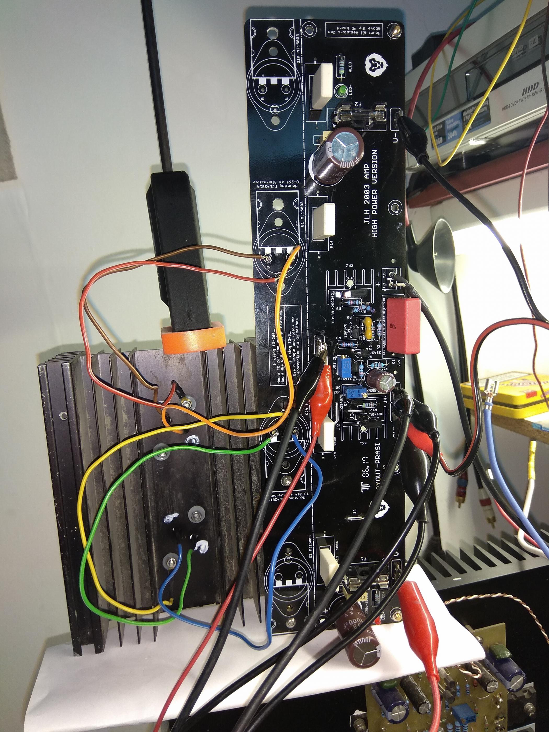

Now bias=2A.

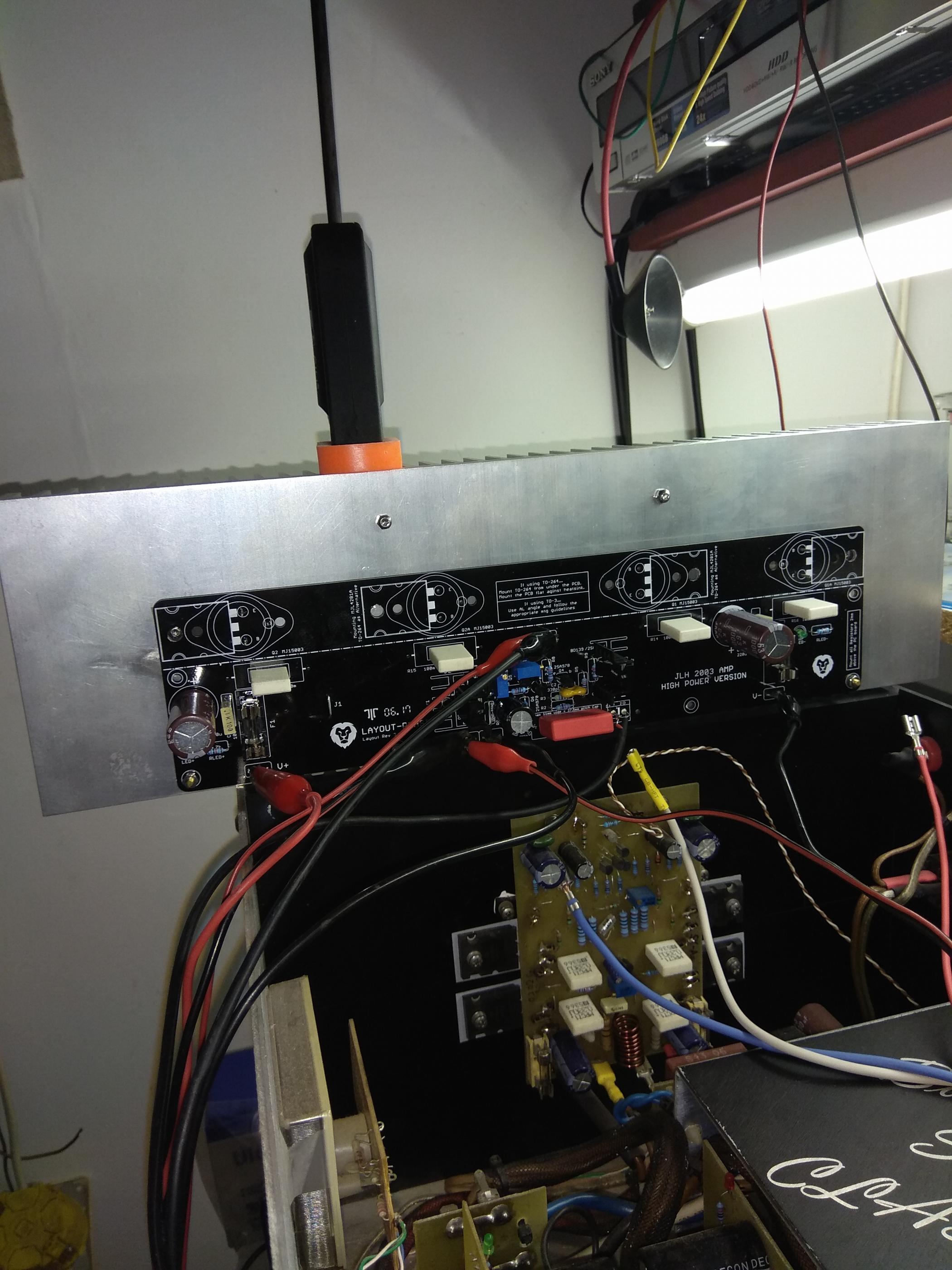

In all cases this is the board under test.
Now bias=2A.

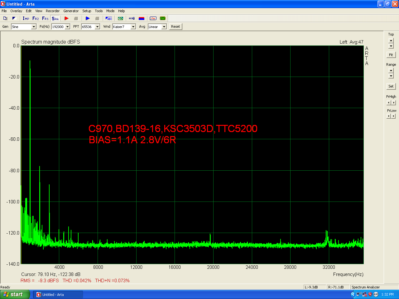

Now using a970,bd139-16,ksc3503d TTC5200.
thimios
those long wires between the PCb and the heatsink do affect the performance of the amplifier, especially at Class A bias.
Hi Gaborbela,
could you kindly quantify that statement as I have built several amps with wires from the PCB to the heatsinks with no problems whatsoever.
Regards
Mike
Regards
Mike

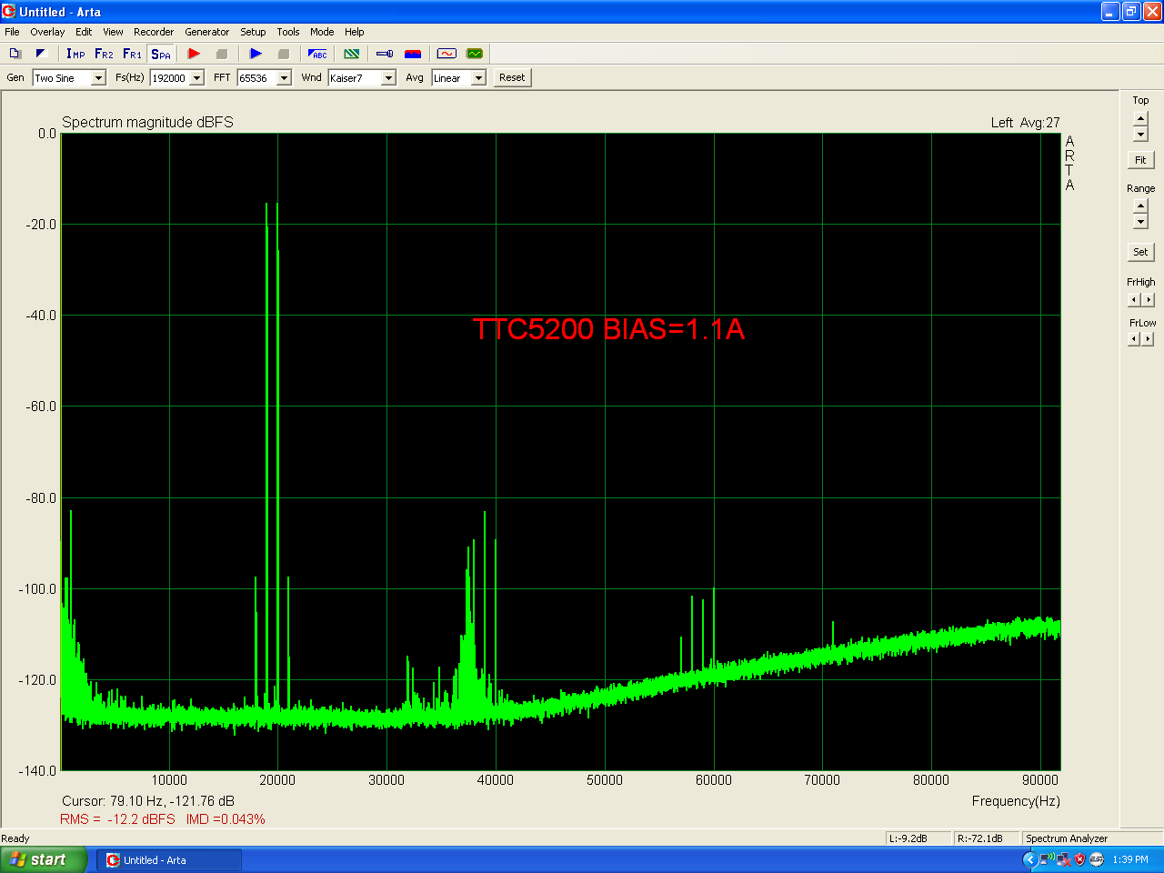

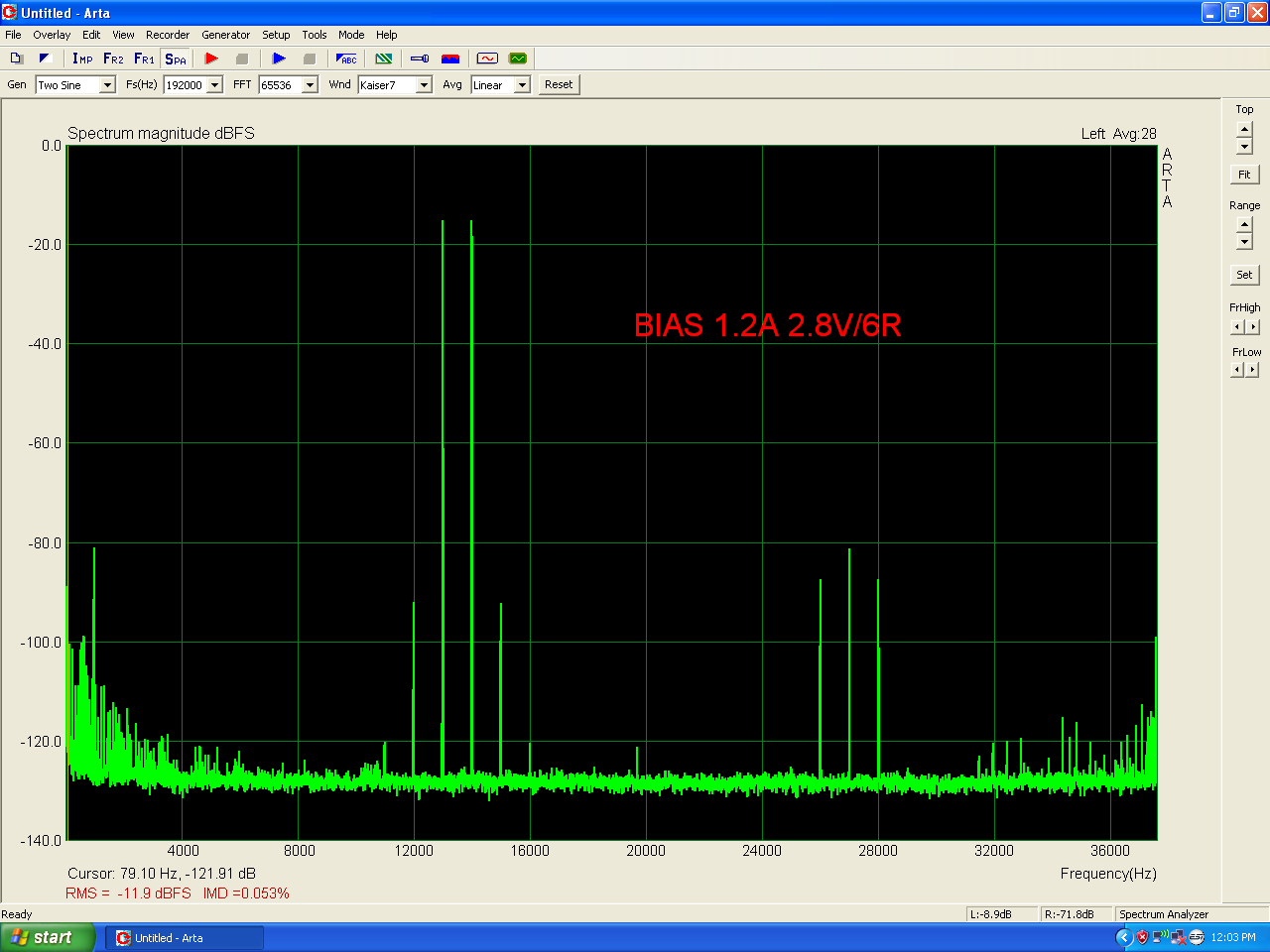

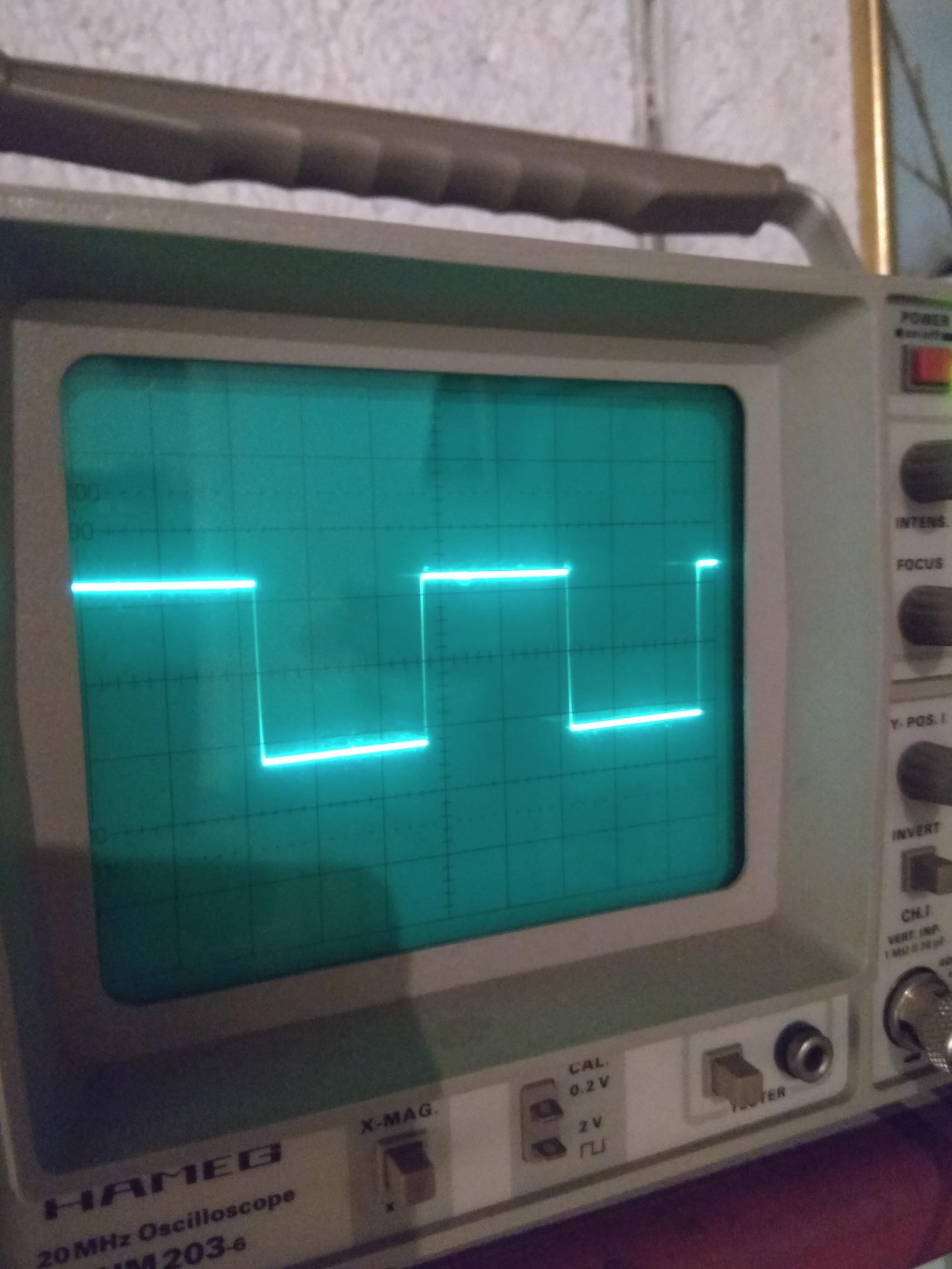

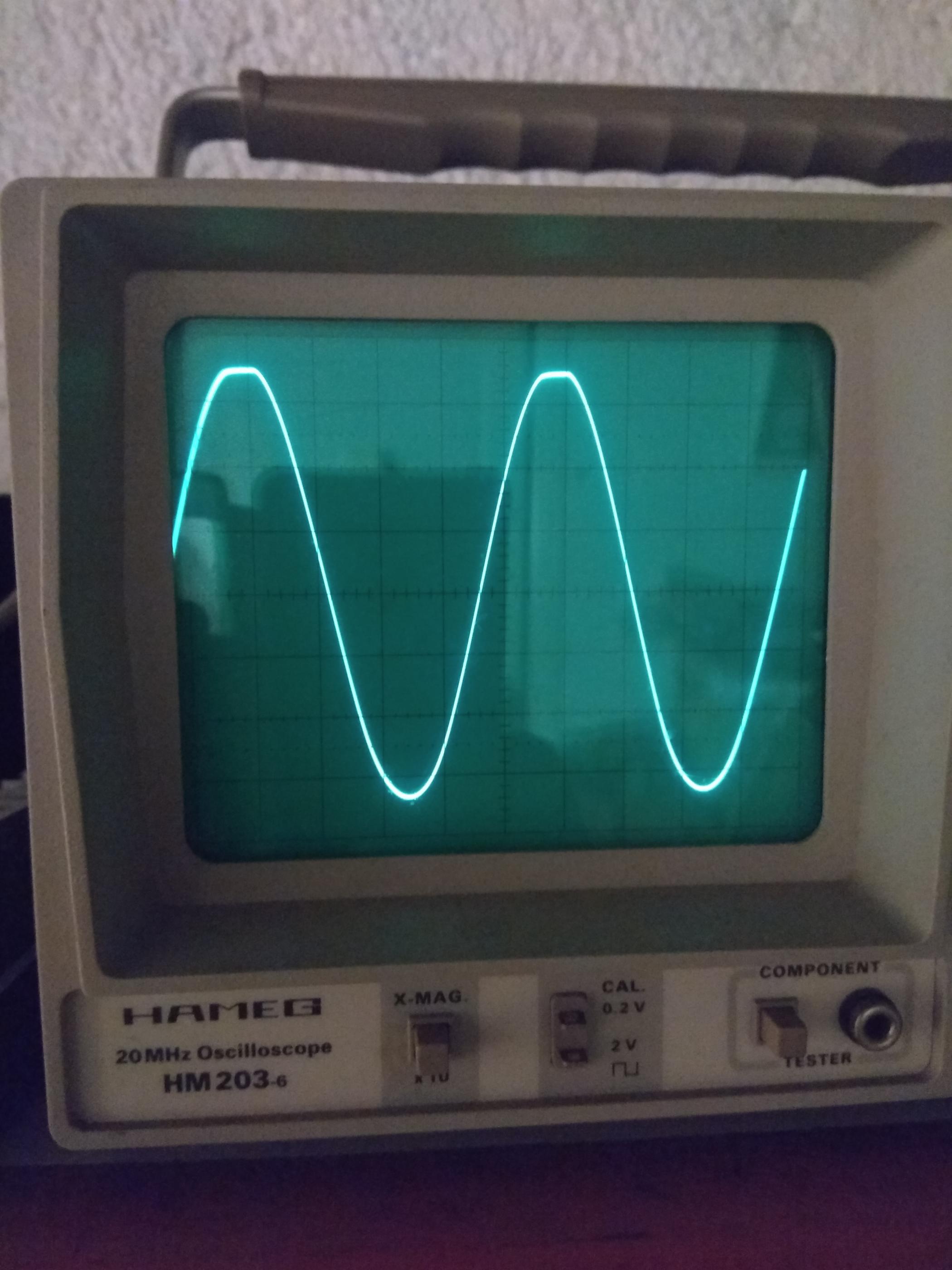

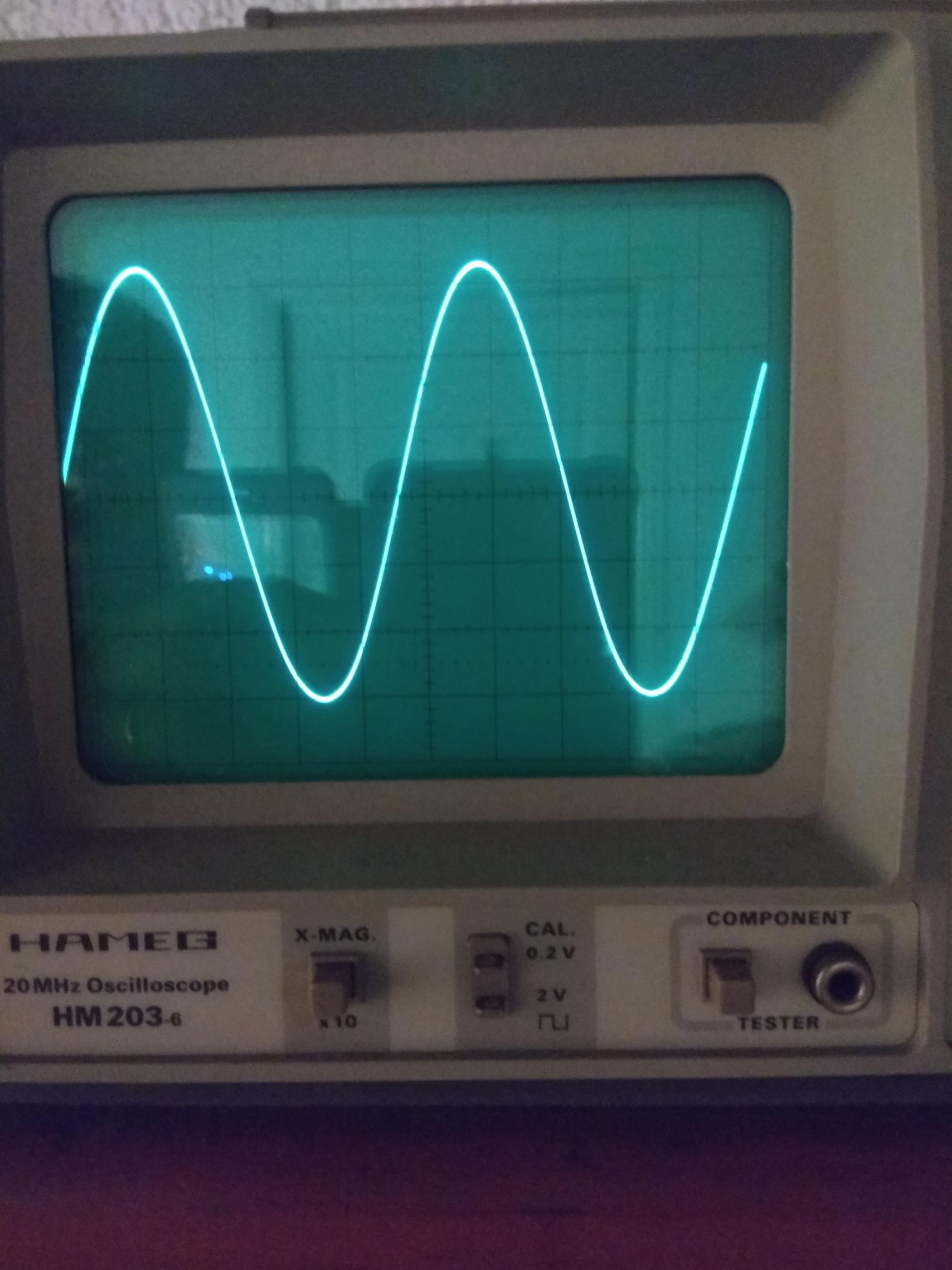

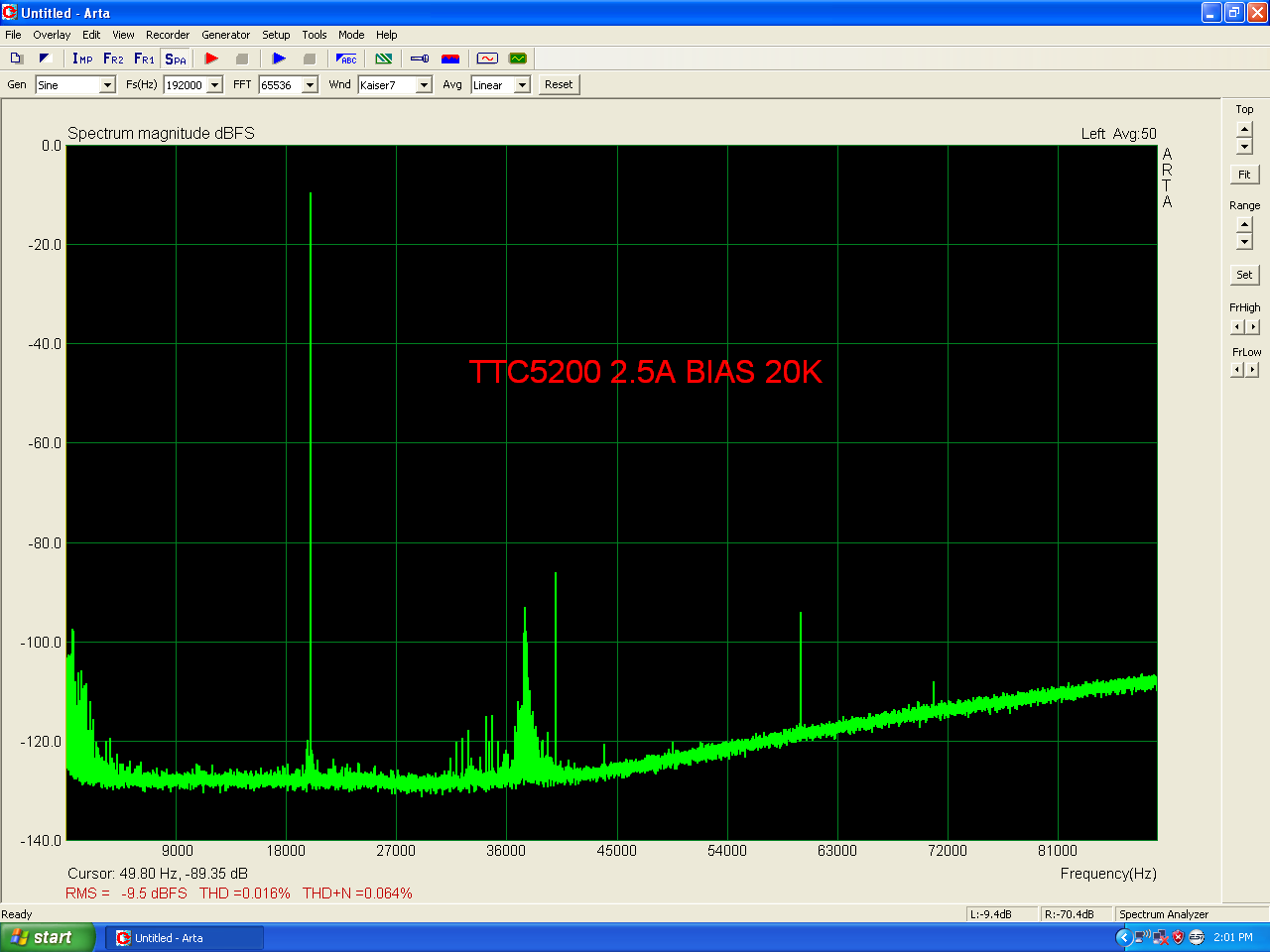

Sensivity and power measurment
Inp=919mV
Out=11.5v RMS before clip
Rload=6R
Power=22w RMS.
Power supply=+/-18v
Bias=2.5A
Tested at this board.
And some early scope pictures
Inp=919mV
Rload=6R
Power=22w RMS.
Power supply=+/-18v
Bias=2.5A

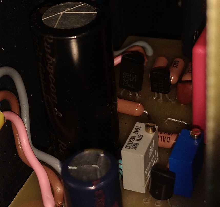

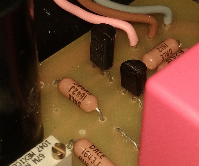

JLH69 I made ten days ago with the BD139-16 PHI for Q3 and sounded great to me. Then I tried Japanese transistors.
I have 2SD468, 2SC2383 and TTC004, I've tried them in the last three days. Unfortunately, 2SC2383 that I have is version O (hfe 170). 2SD468 has hfe 300 and TTC004 hfe 220.The amplifier was stable with all three transistors.
2SD468 is my favorite, 2SC2383 is also great, while the TTC004 is disappointed (at least for now).
The TTC004 does not have a lot of work hours so it will get another chance. This week I will try to do some measurements with 2SC2383 in the amplifier.
I did try BC337-40. It seemed to cope. I had to fit 33 pF to get complete stability. I think if I had tried 12 pF it might have worked as the instability was only just detectable. I am in the process of moving house so will restart building a JLH when my new workshop built. For an 8 ohm version it seemed happy. BC327/337 are easier to get and seem genuinely able to to do more other common choices. I would imagine a genuine 2SD756 would be very good. BC327/337 are very low noise, high gain and good current. Distortion using BC337-40 seemed to better common examples. I think below 0.05% 5 watts is possible even at 10 kHz.
I tried BC337-40 in LTspice, and at 14W there are distortions about 0.04% of 1kHz to 20kHz. Input transistor is 2SA992 and output 2SC5200, bias 1.75A, +/- 21V.
I only feared endurance as it was only 625mW

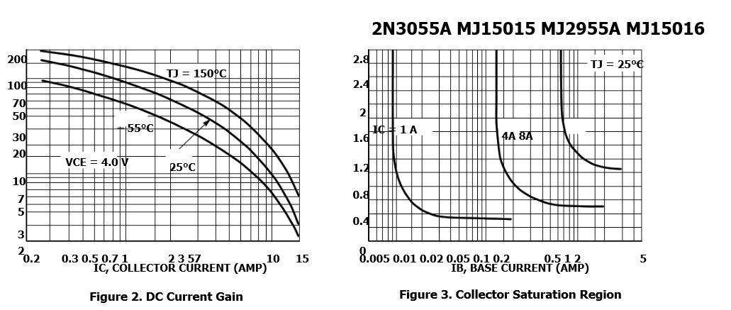

mj15016

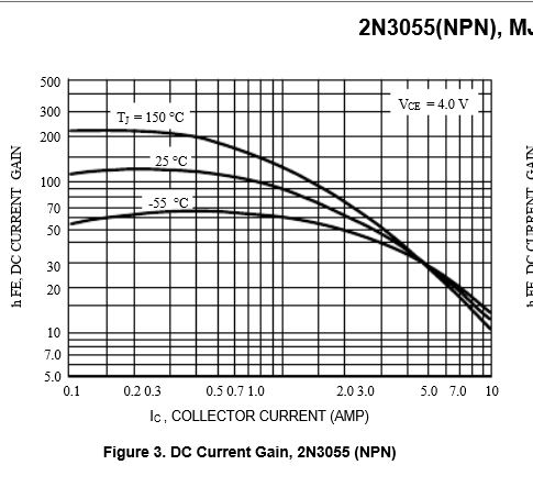

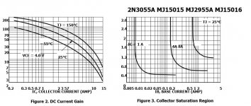

thimios , what is the difference of 2n3055H , the ON datasheet gives the same . If you look the Hfe curves , the mj15015G=2n3055AG is continuously decreasing where the 2n3055 stabilizes . This means at 1.2A bias the mj15015 has less odd harmonics . Have you ever tried it ?

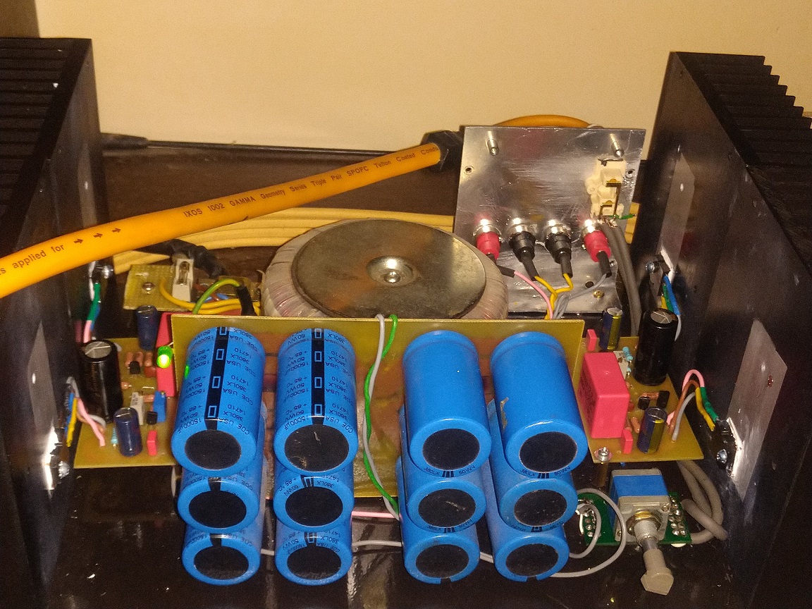

I would say as good as it can be... Nice vintage logo on the PCB, suits well😊..
Congrats on successful build and thanks for sharIng here...
Regards
Prasi
Very interesting. It's not 100 % certain 2.5 amps is better. The 1.1 A version has it's harmonics in a very nice order. OK the 2.5 amp version is better in an absolute sense, both better the JLH intended < 0.1% THD. The KEF LS50 speaker has 0.8% THD and the Quad ESL 63 0.1%.if not listening at maximum with full bass. Most speakers exceed 2%. Some say harmonics > 10 kHz don't count. Hard to say. When class AB I prefer not to see them.
