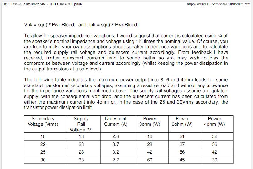

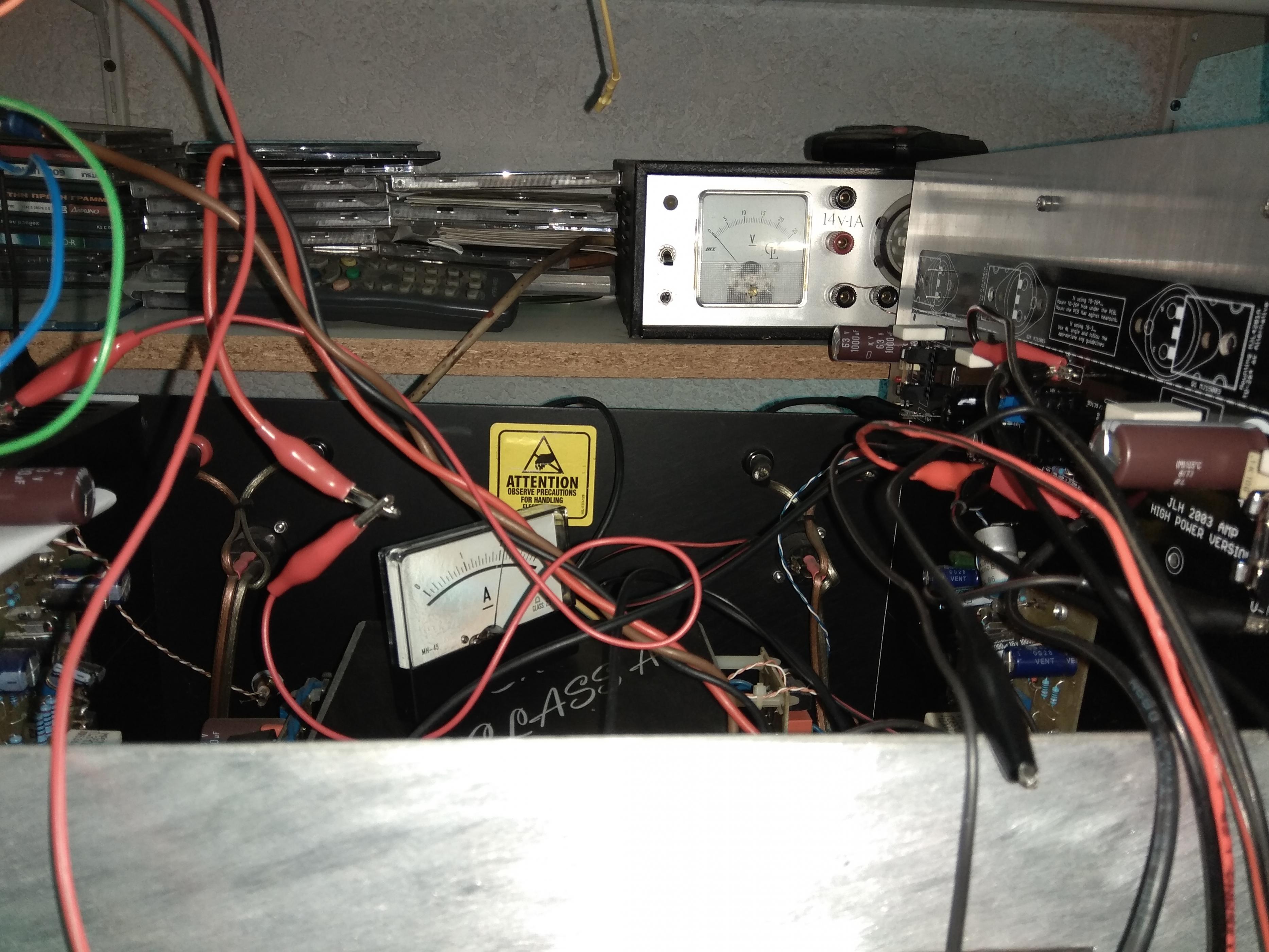

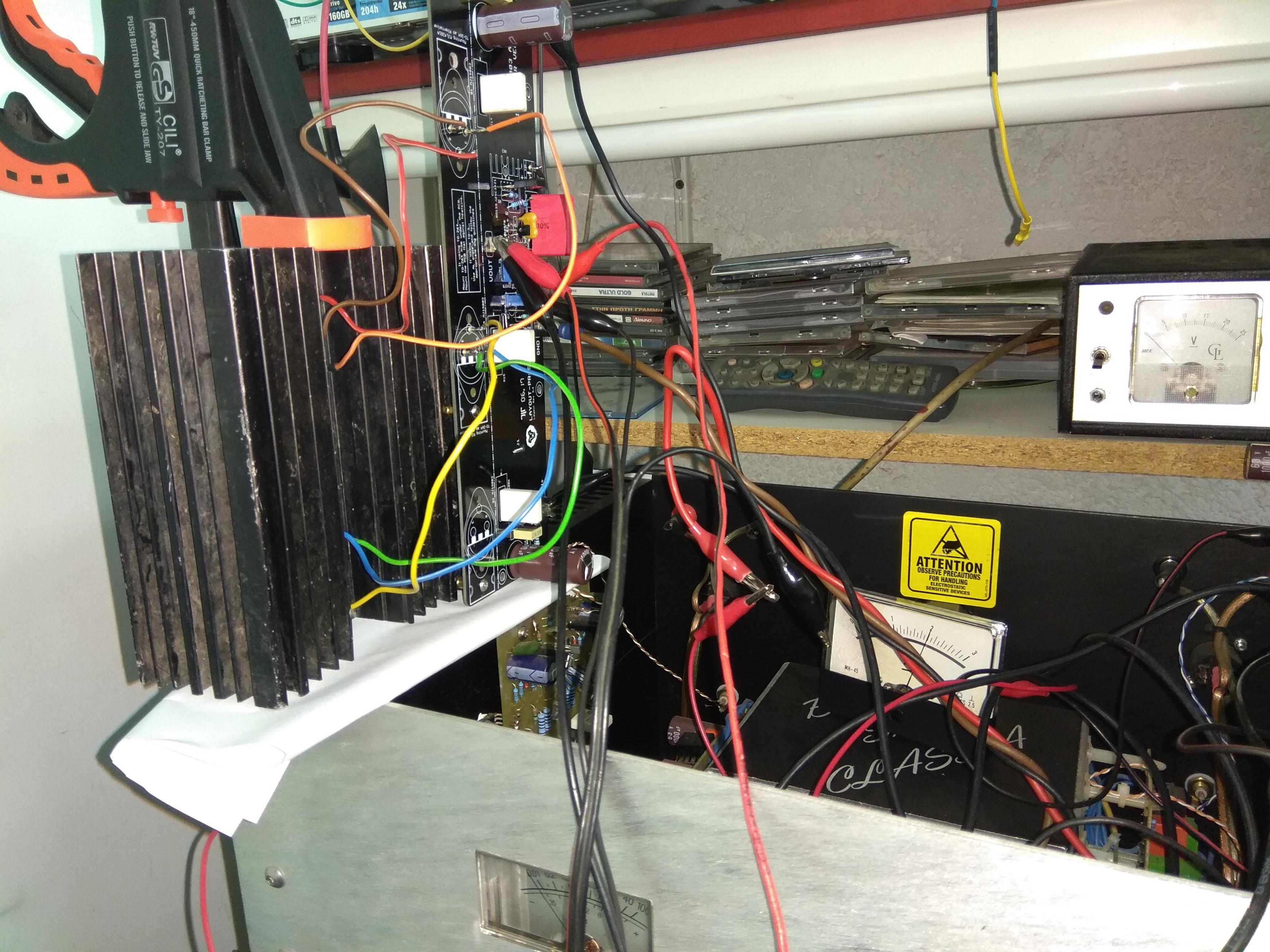

If you use 18V rail voltage and lowish bias try to use one pair of power transistors.
Please take a look at the bias settings table, those power transistors to perform in Class A, to bring out the sweet point they need certain bias level. Sometimes better to use only one pair than two. For example, if the transformer only can handle low power etc.

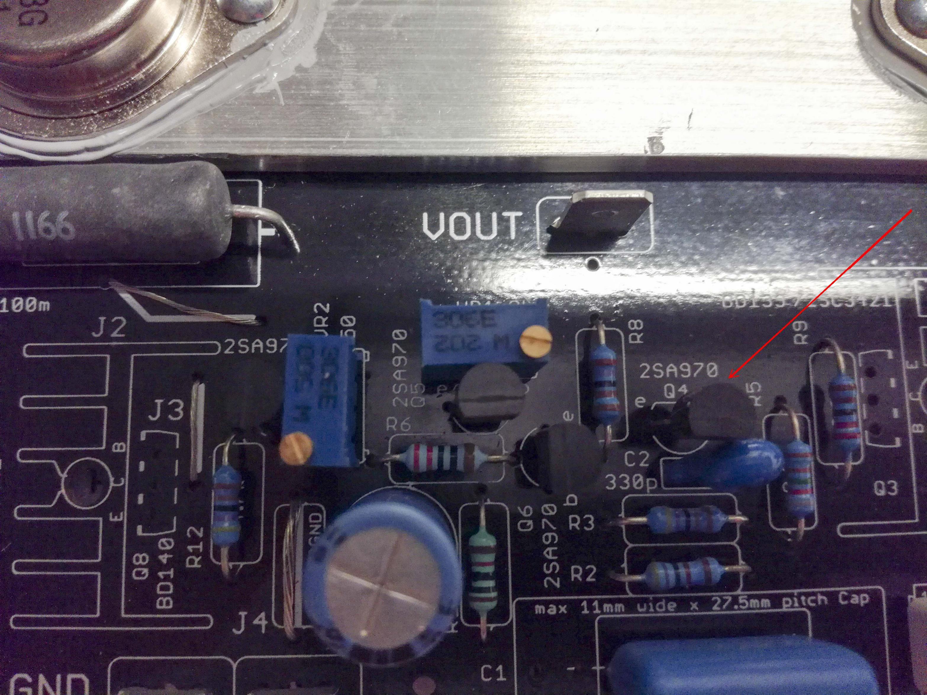

Prasi: the 2SA970 transistors need to be rotated 180 degrees?
Thank you.🙂

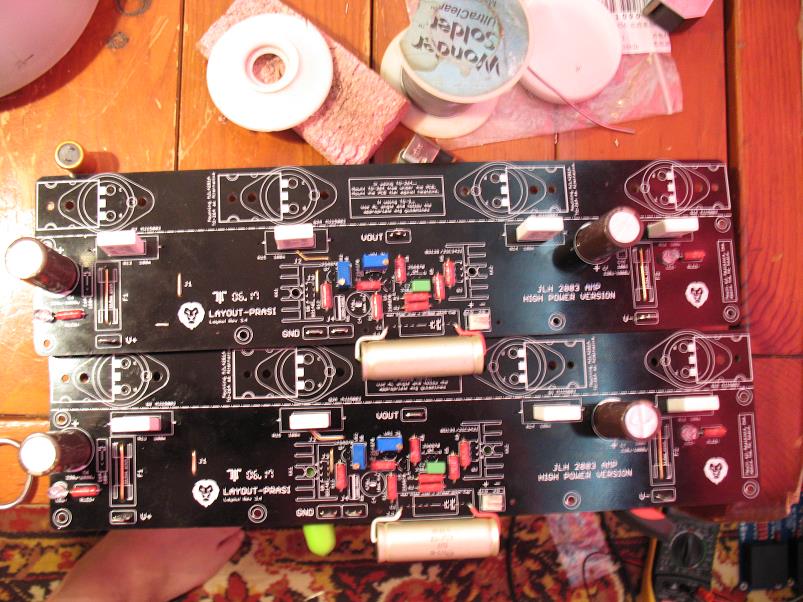

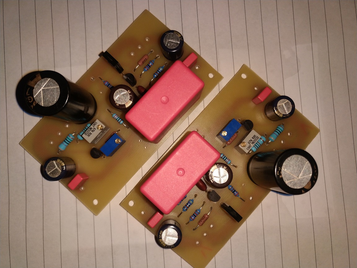

Here is my progress, please do not laugh at my input cap solution.
I ordered Clarity caps but they are huge so I use these Russian type, the same problem with the 1000uF 16V Elna Silmic they just too big. 😱

Hello Gabor,
yes, the 2sa970 transistor need 180 deg. rotation, like you shared the pic.
i/p cap mounting looks perfectly alright, it couldnt have been better. I have seen people use 2u2 jupiter caps, so big and expensive Copper Foil Paper & Wax Capacitors | Jupiter Condenser 😱
regards
Prasi

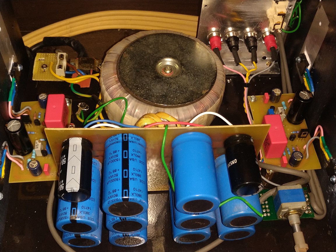

So, in order to drag it down to my level again, I have a question on power supply and one on DC protection.
Power supply question #1. I think I'm settling for 18v on the secondary side, so will be feeding the board with something like 26v. (details on AliExpress says 12-35v, but as a beginner, no need to push my luck). Now I've read somewhere in this here thread on a 2x20w model run off a single 160VA toroid (just, if I remember correctly), so the question is: How low can you go, not that I'm going to, but would it be possible to run a single 10w channel off a 60VA core?. 50?. Did I miss the formula for it somewhere in the thread?.
Keeping with the PSU question: How much uF is the absolute minimum in your power supply (again, not going there). My manuals tells me the 2 x 20w NAD 3020 has 2 x 4700uF. The "100w" NAD 2200PE has 4 x 10000uF but I assume Class A does things differently.

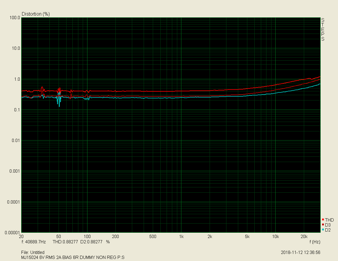

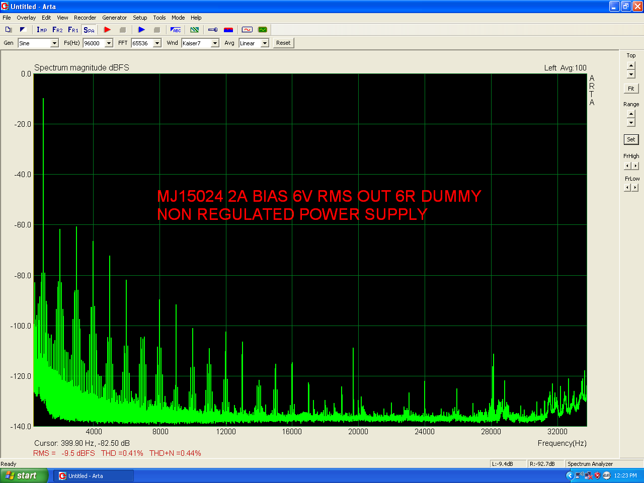

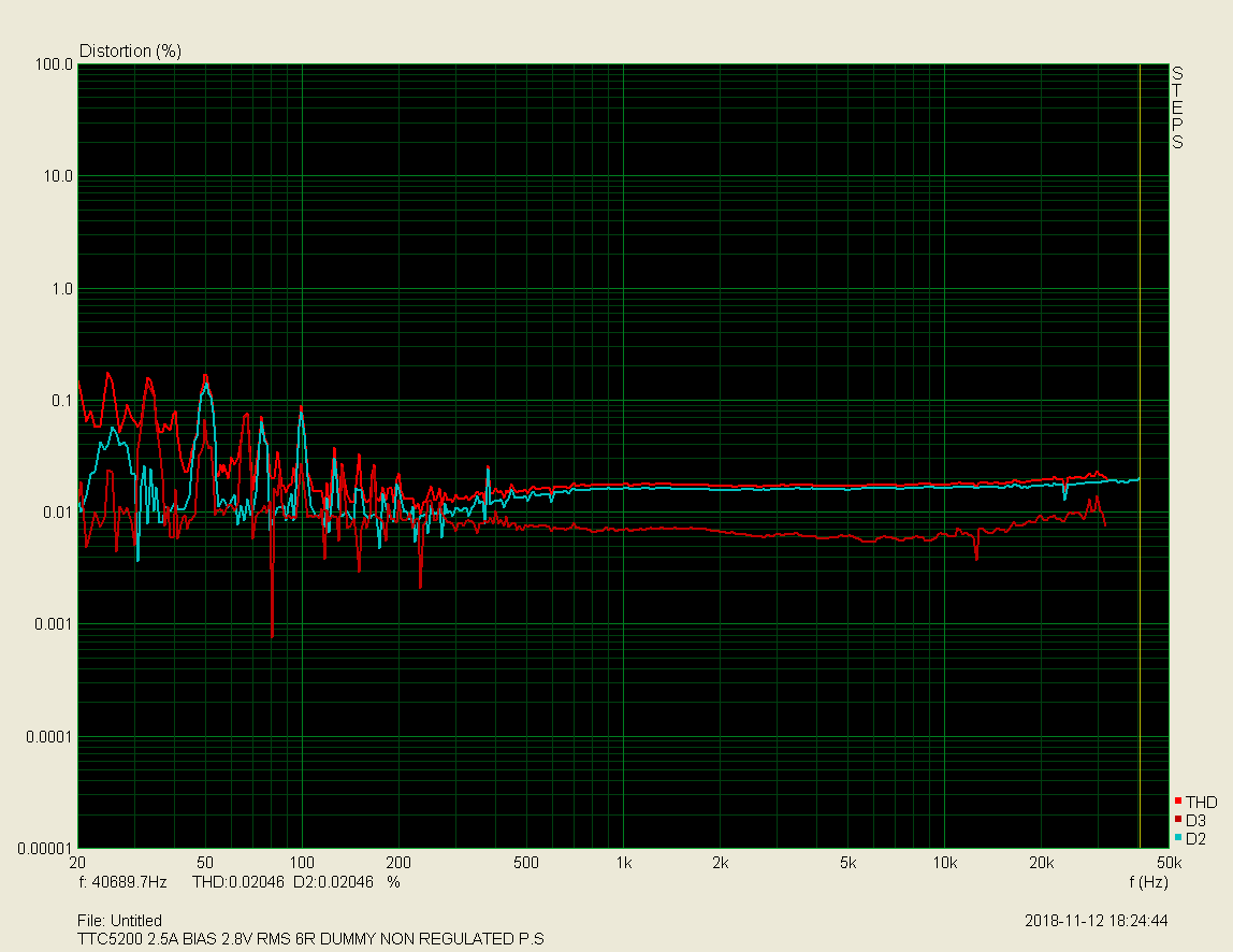

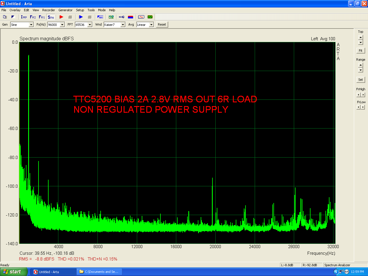

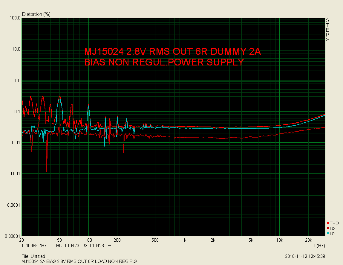

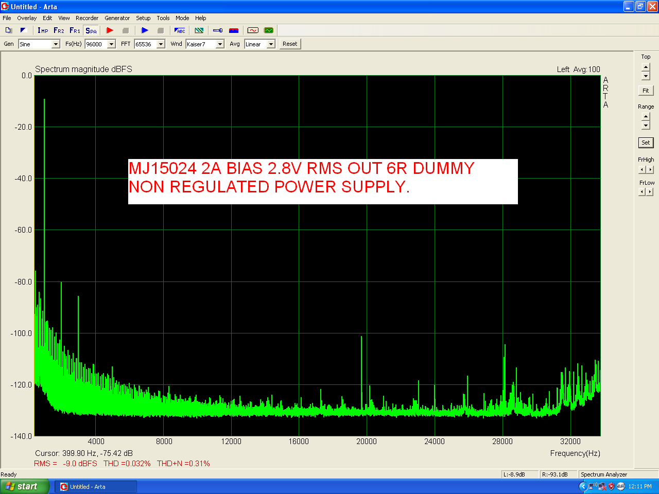

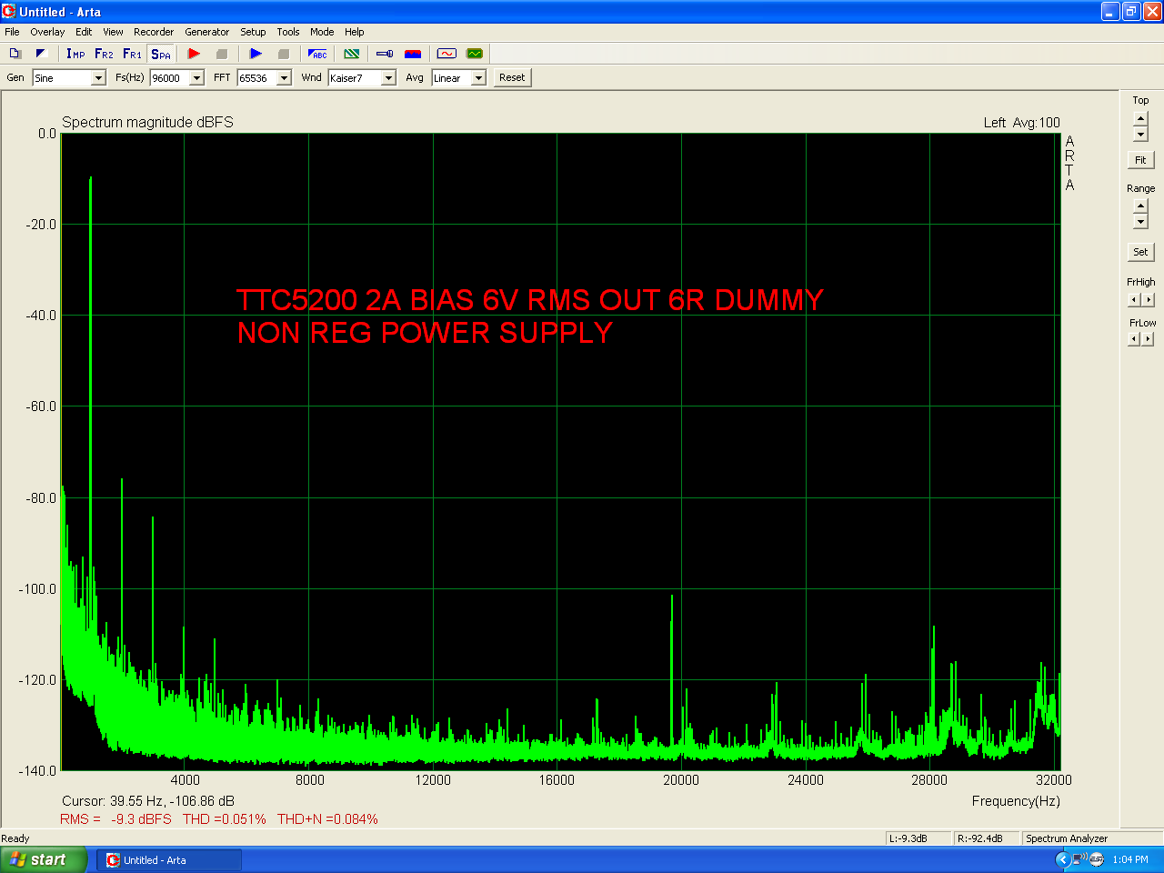

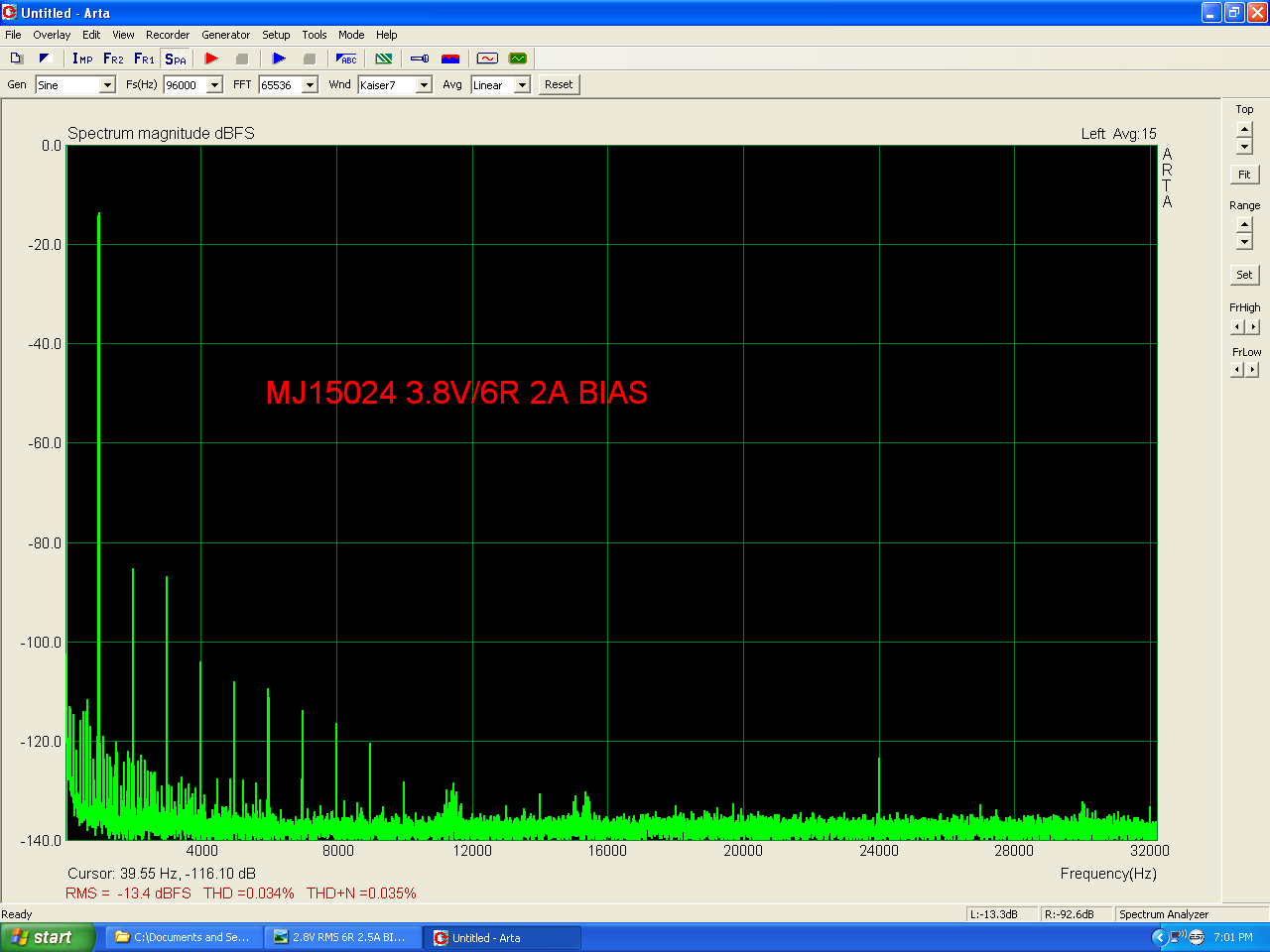

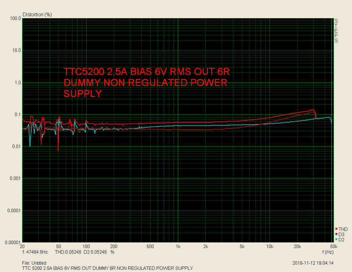

JLH output adventure
I will post here some measurements using different output transistors.
First using the long black Prasi's board.
Power supply=+/-18v
One pair out transistors.
picture 8 is the MJ15024 BOARD
picture 9 is the TTC5200 BOARD

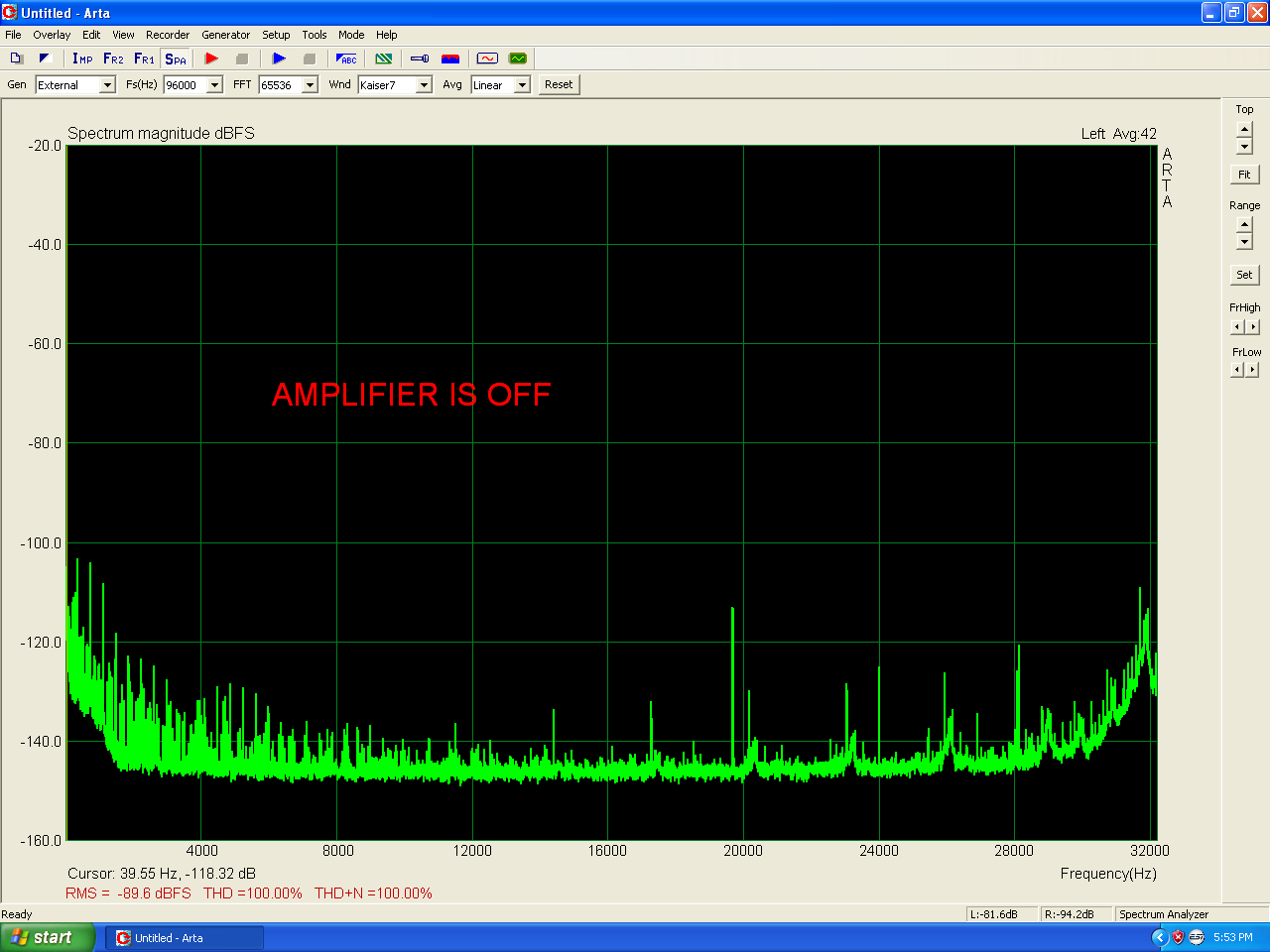

The 19 kHz might be something I wouldn't like.
One thing I forgot to say is if no AM band oscillation is happening the JLH should show the same distortion curve as another JLH clone. If gain is optimum the overal THD will be lower. The final harmonics should be lower in a more ideal way. A lot of that may be lost due to the need for stability. Self argues external capacitance is better if needing stability of a VAS ( cb capacitor of the driver ). That feels to be correct.
One way we can make THD look better is to remove second harmonic distortion. With a JLH this would be easy and a disaster. Why? The distortion is very low and as is rare the harmonics are in an ideal order. Douglas Self " seems " to say, if distortion is very very low any discussion is wrong. Whilst unhappy with that I side with him a bit. As he rightly says if there is a problem something of that problem will show in simple tests. Music is nothing like that testing. The JLH should not cause these problems from any point of view. Ironically the Self test works well with the JLH. Anything that seems wrong is wrong and most likely is layout, grounding, decoupling, excessive HF gain. One problem can be where a speaker is returned to the PSU and how. In very rare cases the obvious place will not work. The Quad 303 causes this problem as a performance upgrade. A very odd and sage design. The 405 isn't my cup of tea. There is a lot of absolute nonesense said about valve and transistor designs. Both Quad and Leak went the extra mile to make their transistor designs good. They were not stupid and did realise transitor amps were not easy to design. Even though they did hear things they were very unwilling to say so. JLH was the one who had no trouble saying it. He was also respected as technically able to state facts. I never knew anyone laugh at him, that's unknown for most.
That 19kHz is a little curious, as it does not seem to change with output (much). I would suspect it might be pick up from somewhere?
Perhaps an old FM radio nearby?

19 kHz

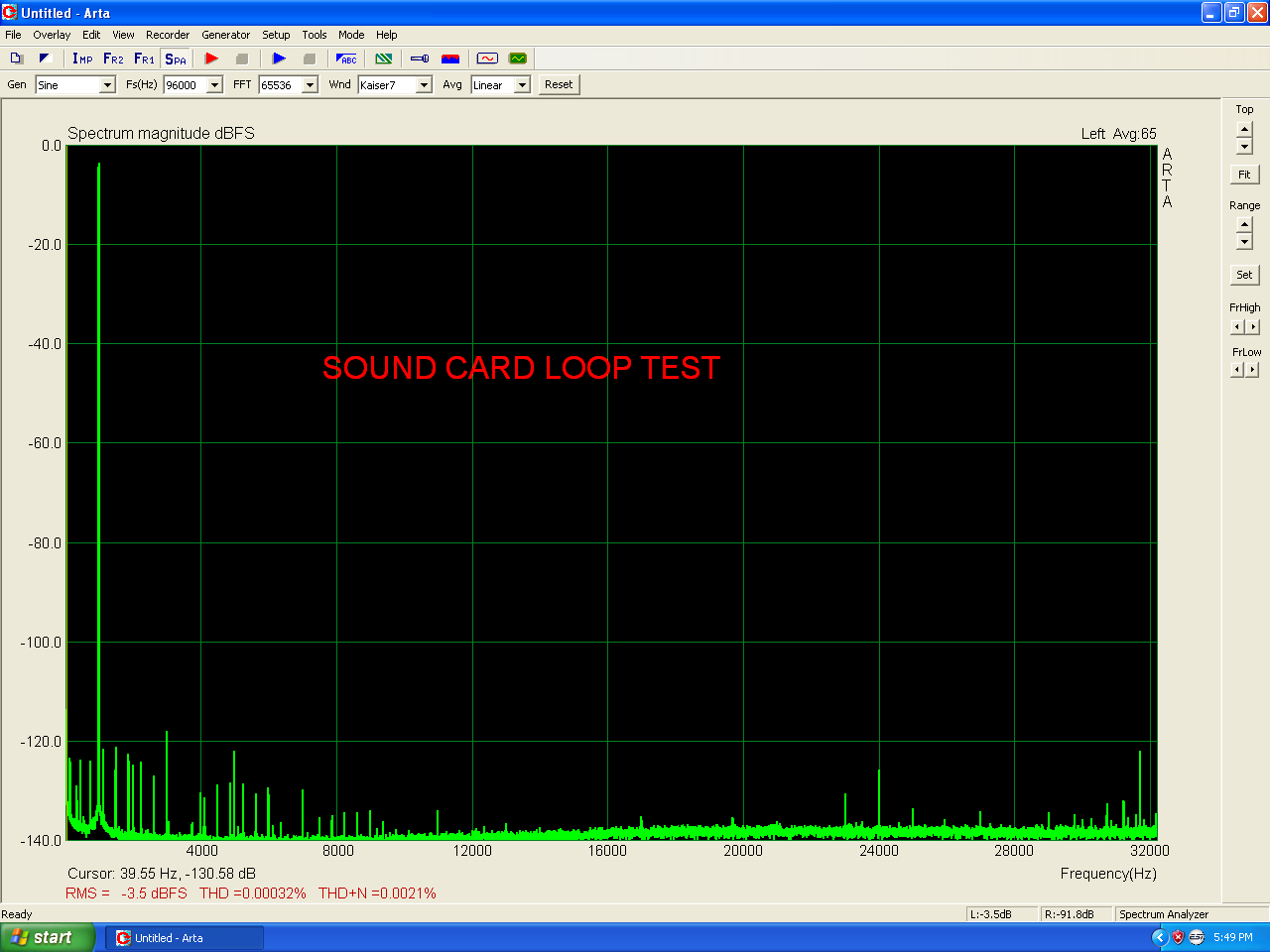

Last picture a sound card loop test.
Yes agree,just to be more clear look this measurement when amplifier is off.That 19kHz is a little curious, as it does not seem to change with output (much). I would suspect it might be pick up from somewhere?

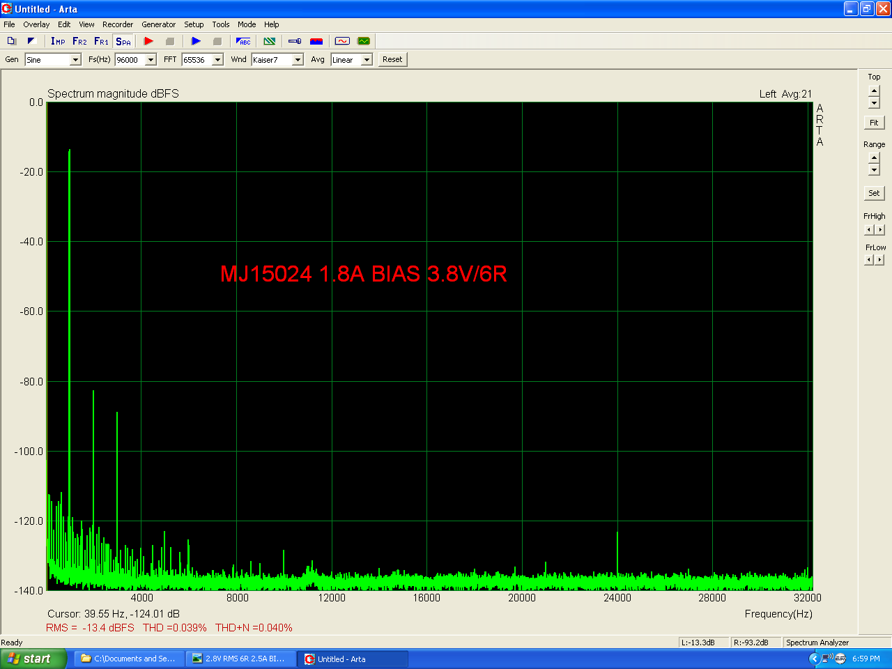

JLH 2003
How different bias affect THD & THD PROFILE.
Power supply=+/-18v stabilized power supply.

On the graphs above, both are good. It would be interesting to know which sounds best. The second might sound more open and faster. Neither should sound bad.
