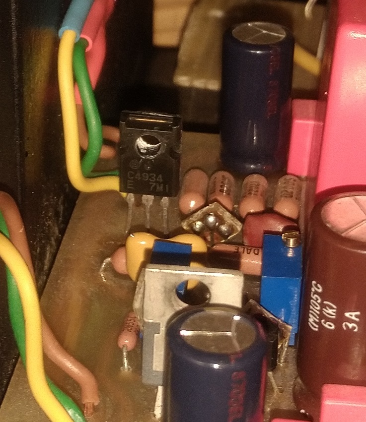

Today I soldered Hitachi's transistor 2SC4934 into a jlh amplifier (position Tr3), ft is 350MHz, hfe 400-800, cob 3.5pF at 30V. This is another of the fast video transistors I've tried as a Tr3 that sounds pleasantly surprising to me.
It may lack a bit of attack and precision like the 2SC1941 or 2SC2682, but the amplifier with it is very comfortable to listen to, I would particularly point out the lower part of the sound spectrum that really sounds powerful for such a small amplifier.

From what I built that's a good move. I had a gain of 450. I had to add 33pF base to collector. I have 2SA970 2SD756 and 2SB716 I could try. The distortion was 0.03% at 10kHz 5 watts. Outputs were Indian 2N3055 E.
The 2SD756 and 2SB716 have an even lower cob than the 2SC4934, only 1.8pF at 25V so they may need some compensation. Unfortunately I failed to get the original 2SD756 for the test so I would be interested in the results.
I listened to the amplifier all night with 2SC4934 and I can say that the sound is great, for my taste maybe too nice and pleasurable, I wish there were more attack, but overall it is a good choice.

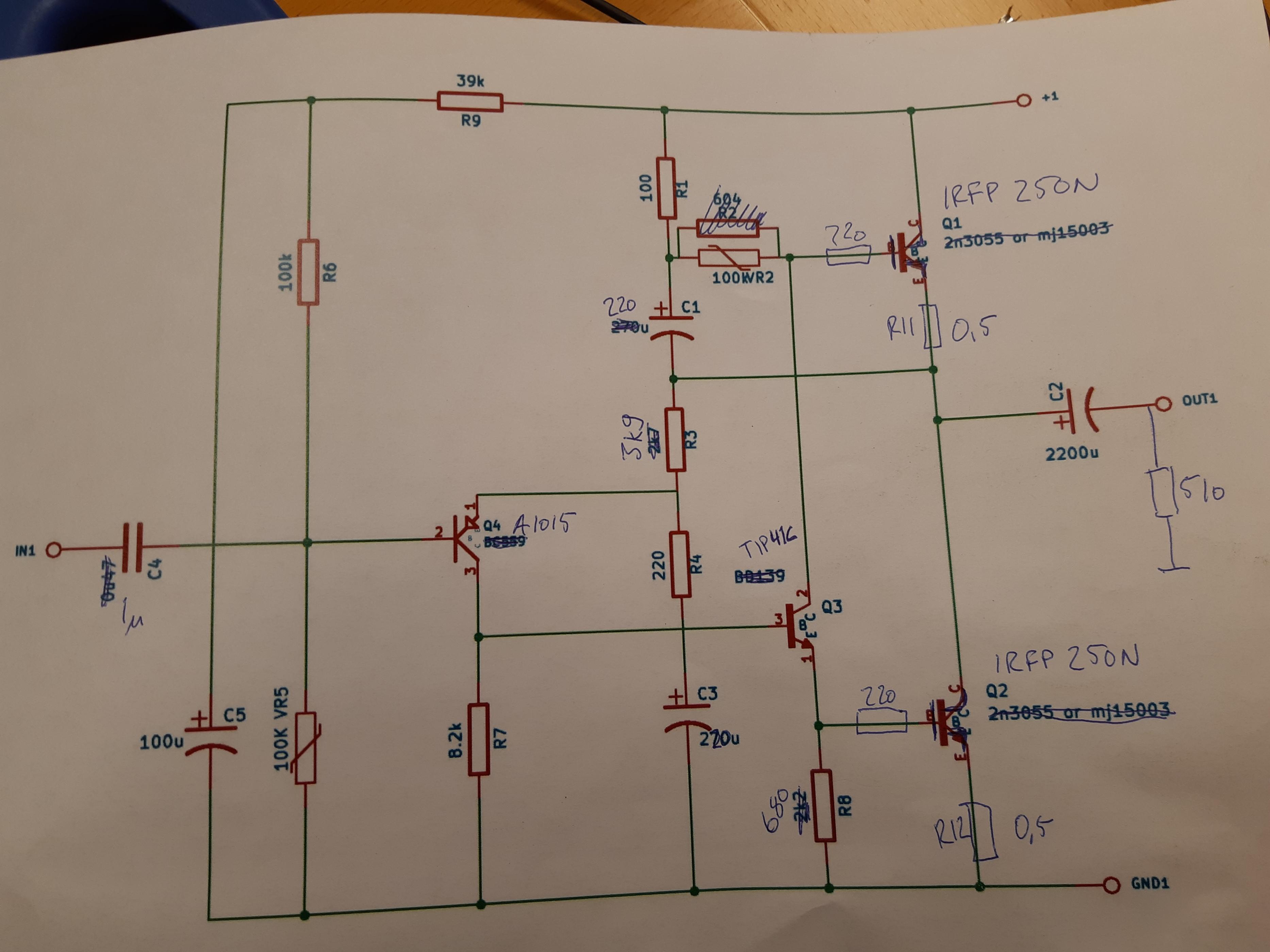

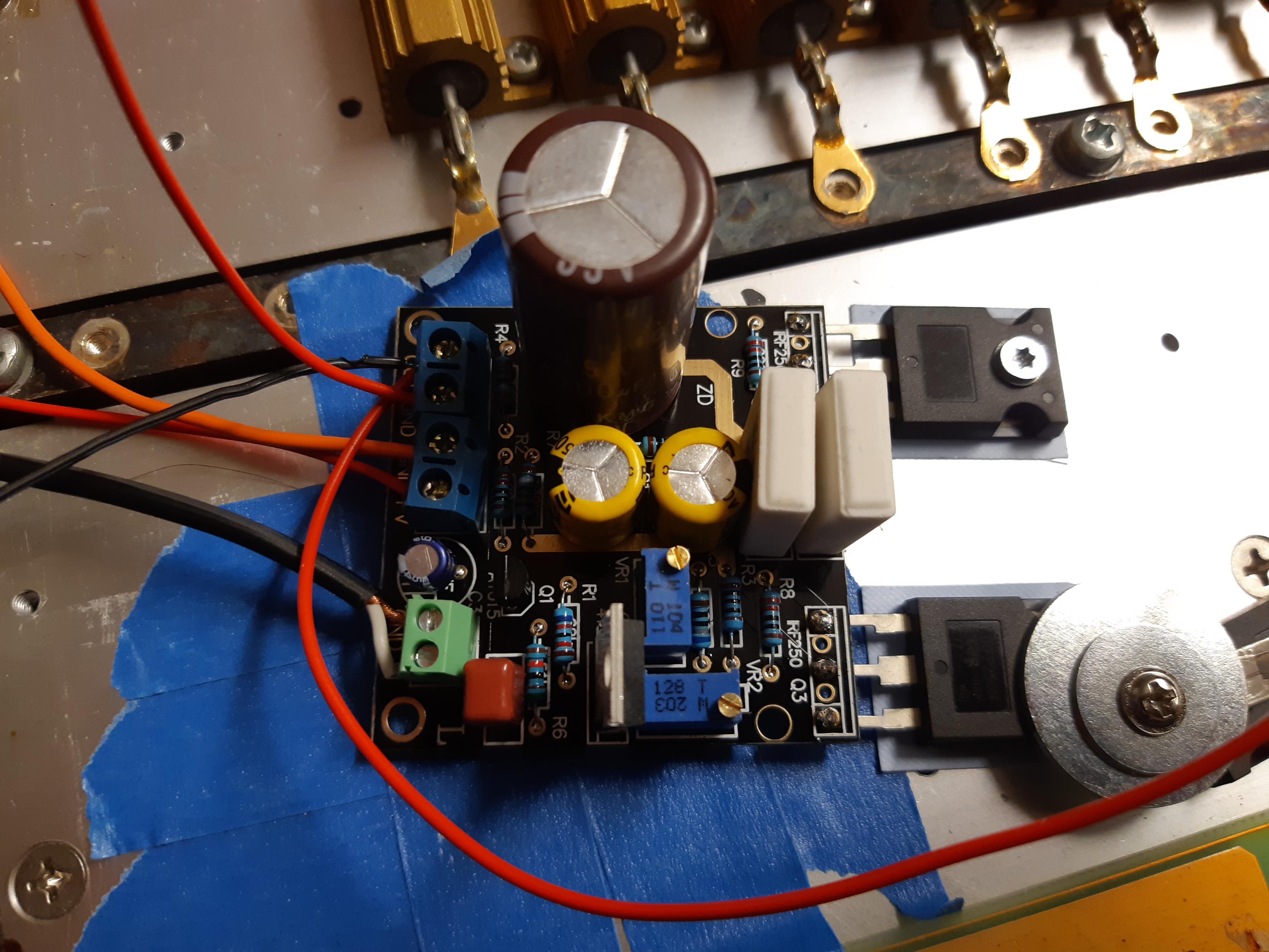

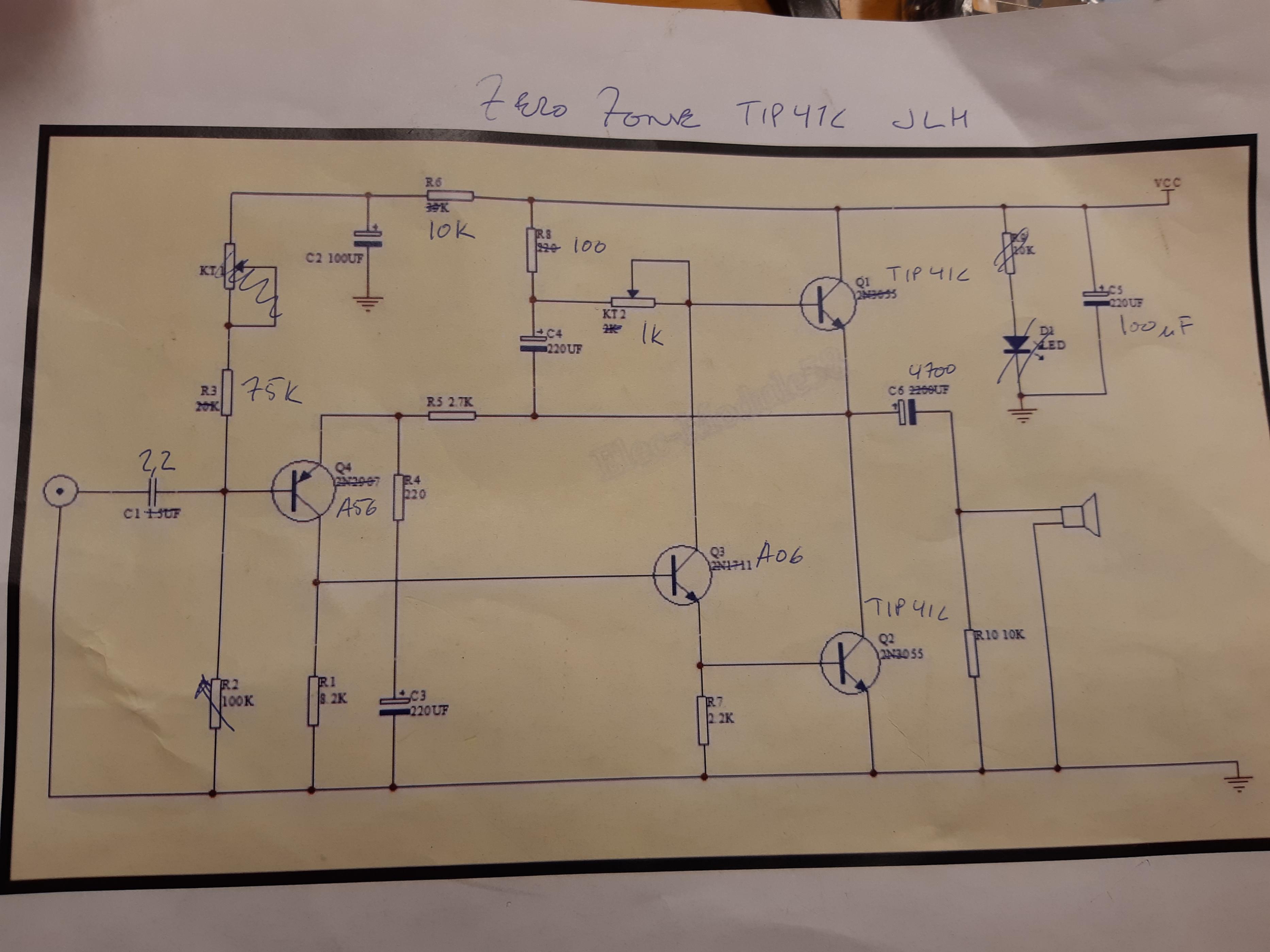

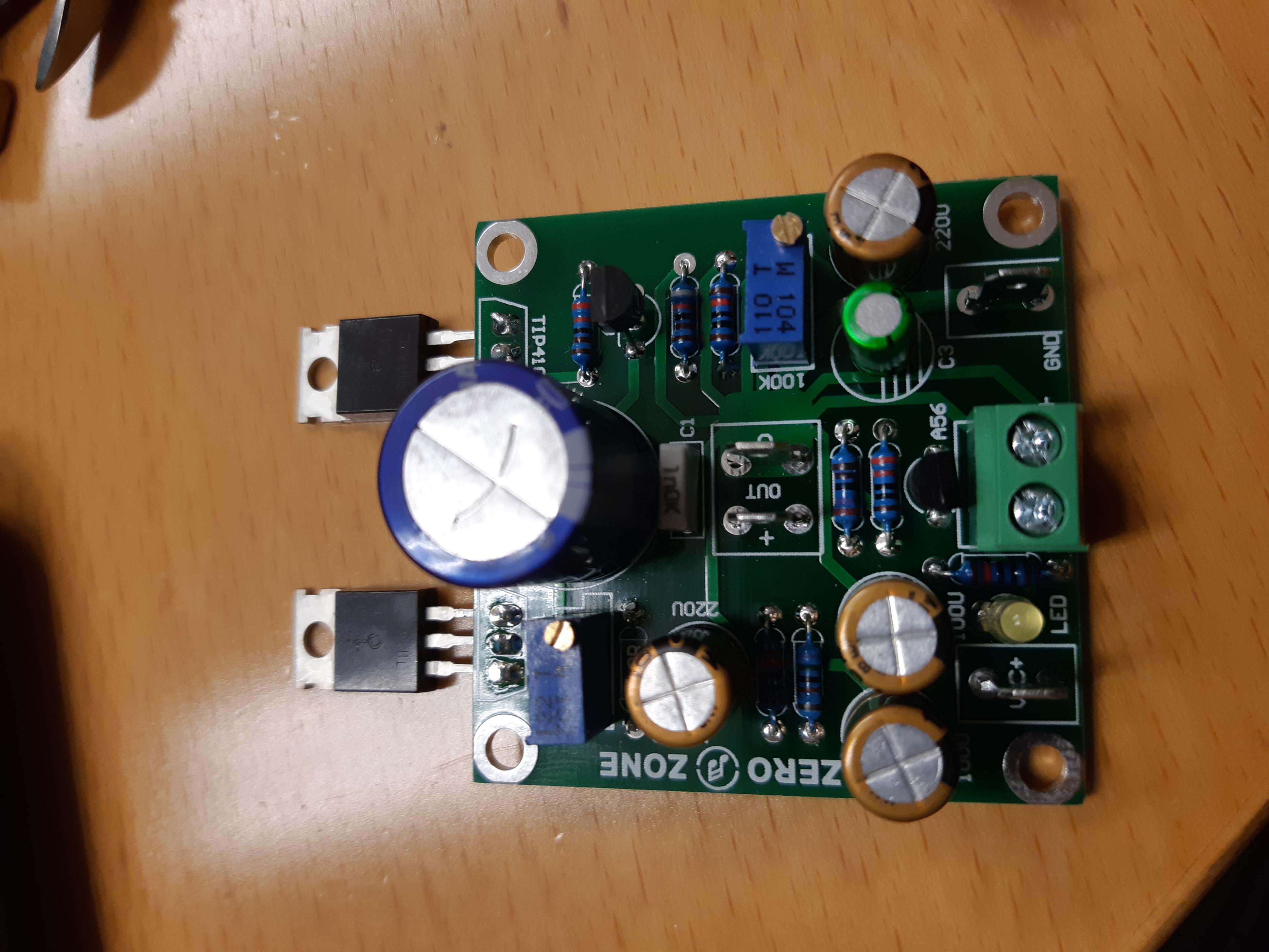

I have built two more versions of this amp and done some basic measurements. One is a TIP41C version from Zerozone, and the other a noname (Sen yuan) kit that I found out had mosfet outputs after I got it..
TIP41C Zerozone: Measures ok, high load impedance and high(ish) supply voltage improves distortion measurements. Seems to be happiest around 0,7-0,9A. Nothing special when it comes to measurements, and have not listened to it yet.
FET output version: Actually a little bit better in measurements than the one above with low impedance. I actually got lower distortion at 5,6ohms compared to 8ohms.. Seems to improve whith higher Iq and higher supply voltage. Relatively low distortion in 5,6ohm, but nothing special at 8ohm compared to bipolar outputs. However, current seems rather unstable, it's jumping around for no obvious reasons, and lab supply limiter kicks in even if limit is a lot higher than Iq setting etc.
No oscillation problems etc noted even with square wave in and 0,5u cap in parallell with load. Some ringing on the TIP41-board, but not much.
Attached some pics of the boards, and some 'notations' on schematics with some component values.

I replaced the TIP41C outputs with 2SC5242 (100% genuine) on one of the zerozone boards, and it looks promising. Distortion is clearly reduced (THD/IMD abt 10dB lower), and it also seems stable without any compensation added. There is actually no visible ringing now with square input and the 0,5u parallell with the load, there was a little overshoot and ringing with the TIP41C.
The distortion is still not as low as the zero zone PNP boards, but better than a standard JLH with MJ15003.
A 'hybrid' would be an interesting idea.. FET & bipolar, but I'm a bit reluctant to play with the FET-based boards, because traces are hard to follow on them since the PCB's are black. I asked for a schematic, waiting for reply..
