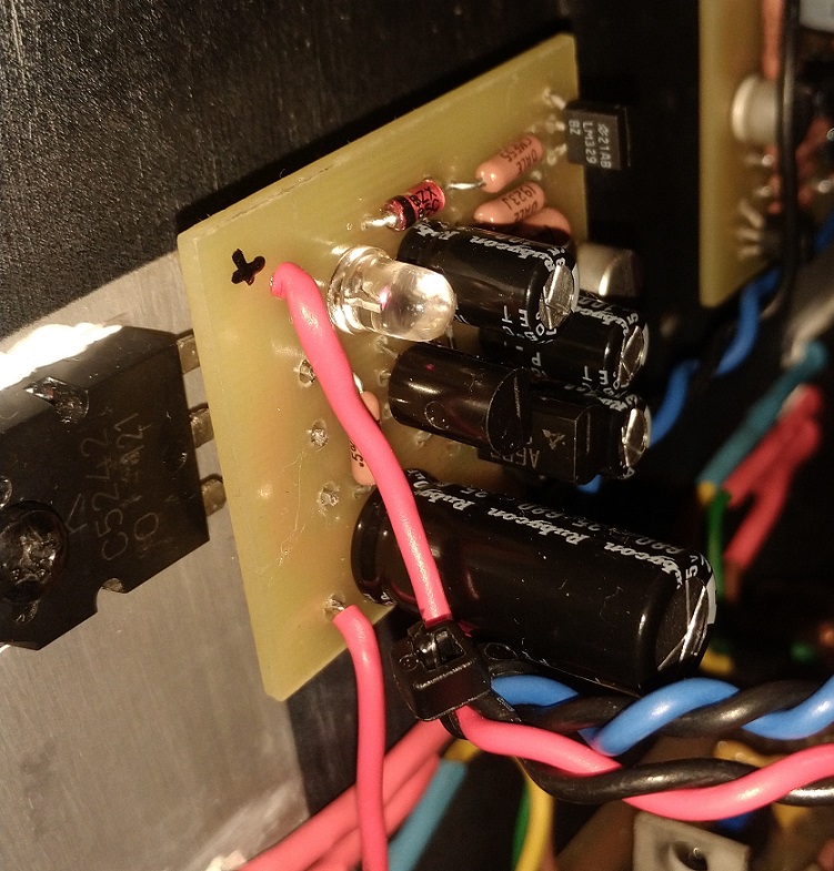

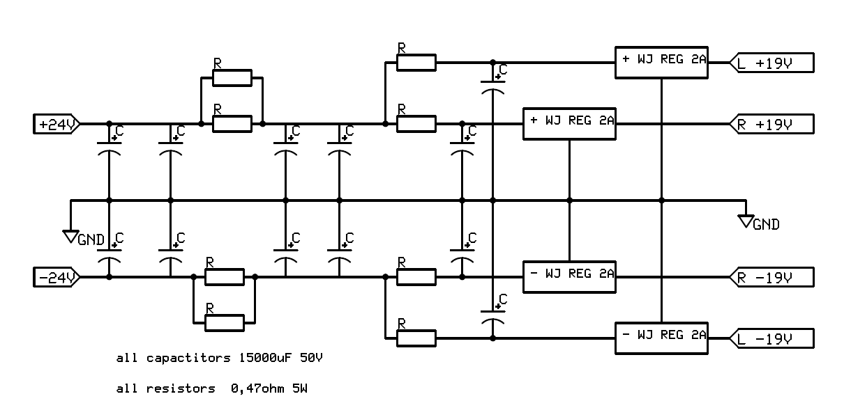

This is a simplified power supply for my JLH69.
The regulator has 2SC1383 / SA683 as drivers and KSC5242 / KSA1962 as output transistors. I found 2SC1383 / SA683 in my stock and they have great features, the only bad is that they have a small Vce, that's why they are left unused.
