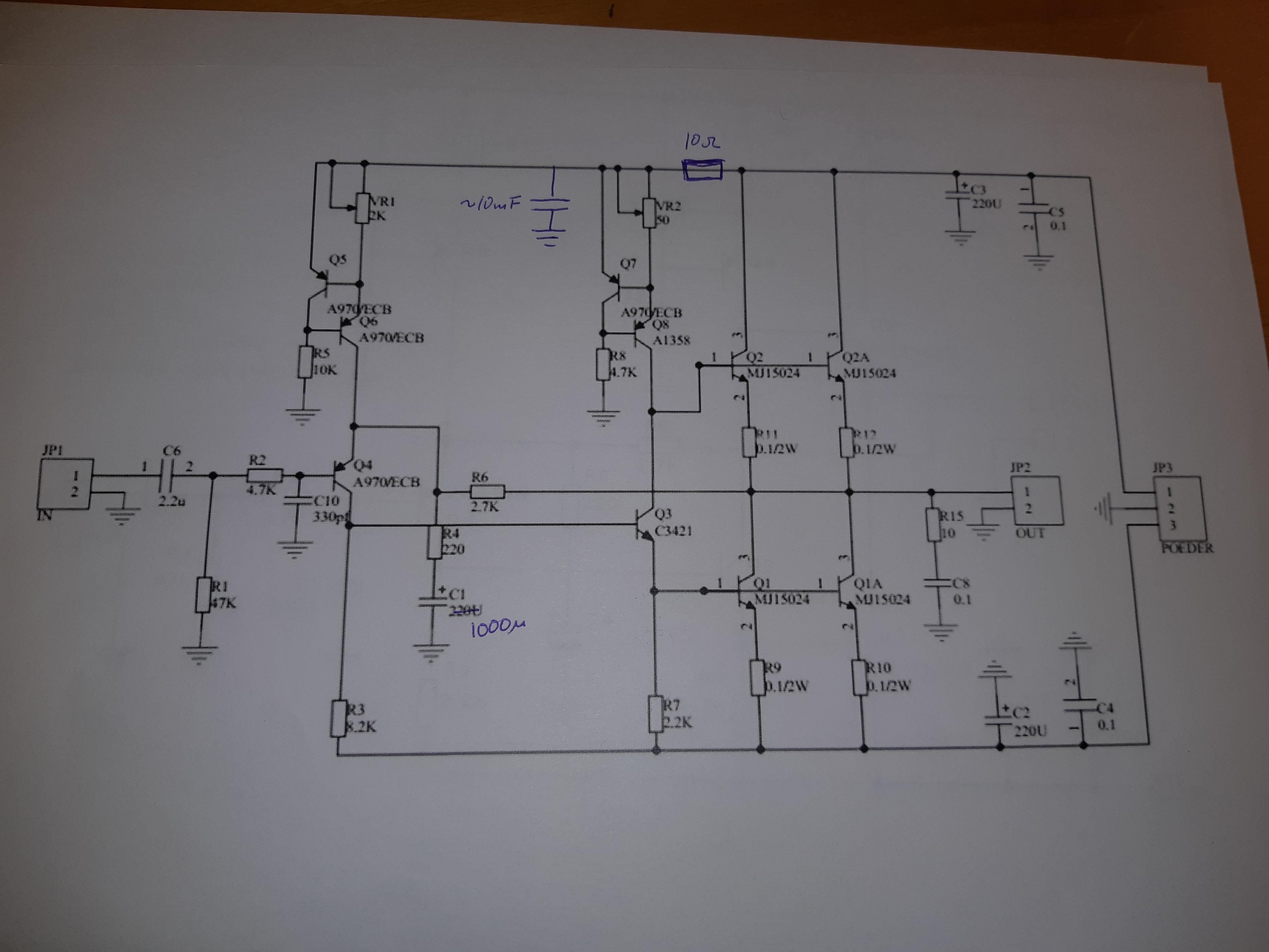

I tried some simulations on the dual rail, dual ccs version to see what I could do for hum reduction.
It seems that 100Hz hum can be reduced abt 25dB by adding 10Ohm and 10mF to the positive supply rail for the ccs:es. That is 10ohm in series, and a 10mF to GND. This is the best I have found so far. Connecting the capacitor to negative rail makes it worse, and trying a similar filter on the negative side also makes it worse. Just to clarify, the outputs are not filtered, only the low current part.

So far there is only simulations, no modifications done. See the attached picture of what I have found so far.
When I compare the ripple voltage in my simulation, it goes from abt 28mVpp to 2mVpp when I add the RC.
I also tried filtering only the ccs for the input transistor by moving the RC 'one step to the left', but that did not do much.
Just now, I also simulated the start of a 20Hz sine, and it seems the feedback cap to GND has some impact on the transient behavior here. With the standard 220u it takes a few cycles to get the full amplitude, but it's a lot better with 1000u, so I marked that one for modification too. I think there is some more simulation to do here, I also see some settling time when the sine stops abruptly.
Seems there is a small DC-offset created, so the first positive peak of the sine is lower, and the following negative is also lower. So there is a small DC offset in the beginning when the sine input starts. How it affects the 'punch' in the sound I have no clue..

The phase splitter, Q3, current source is not decoupled - that's another improvement. You can try a cap to ground from the base of Q8 but the usual way is to split R8 into to two resistors and take a cap from their junction. It is sometimes better if that cap goes to the +Ve rail instead of ground depending on whether a source or sink.
Some input from people with more simulation experience would be welcome
It's been too many years for me to offer useful advice in your simulation, beyond suggesting a period of calm for the model to settle before you whack it with a signal.
Back in the real world, clipping events can cause DC offsets which (particularly as you bump capacitor sizes up) can take a long time to return to normal bias conditions. It's a common failing in high-loop-gain/high-feedback amps.
@Rallyfinnen, The schematic I found for the PNP version still uses a single positive supply rail. The one notable change I see is the cap to ground in the feedback network still is tied to ground. Have you run any simulations using a single negative rail ?
thoglette: I did let it settle before about 3s before starting the sine. It seems to be pretty stable at that point. I have not simulated clipping more than by mistake..
Loudthud: I'm not sure I understand the question? I have not simulated the Zero zone PNP at all.. I only modified it to floating ground, and adjusted some resistor values in the current source to reduce distortion, and added some HF filters (RC)
I posted the schematic for it somewhere in this thread.
