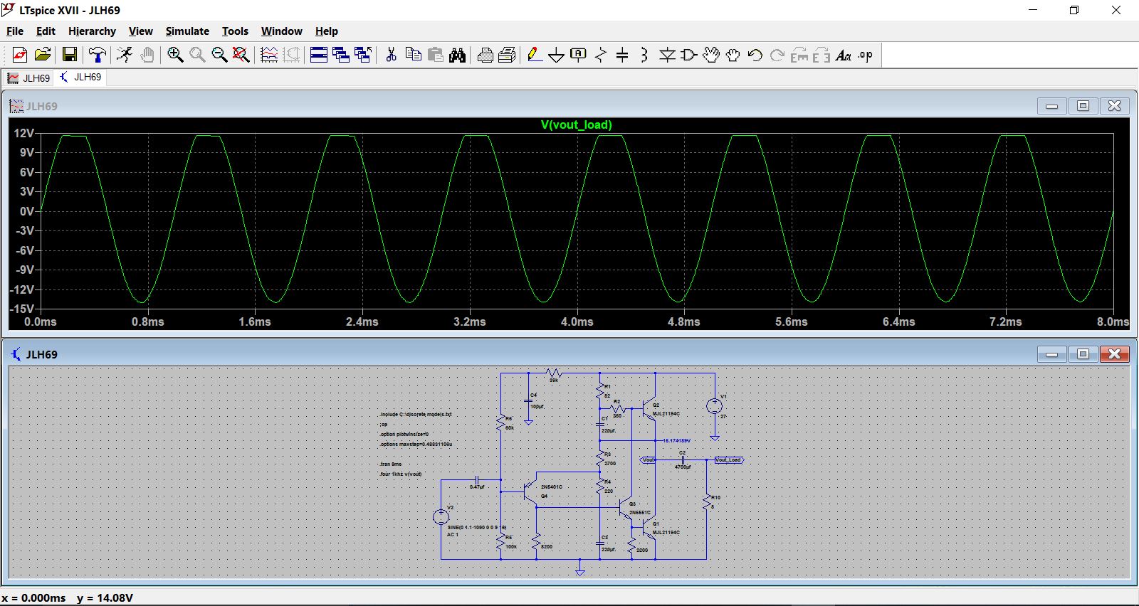

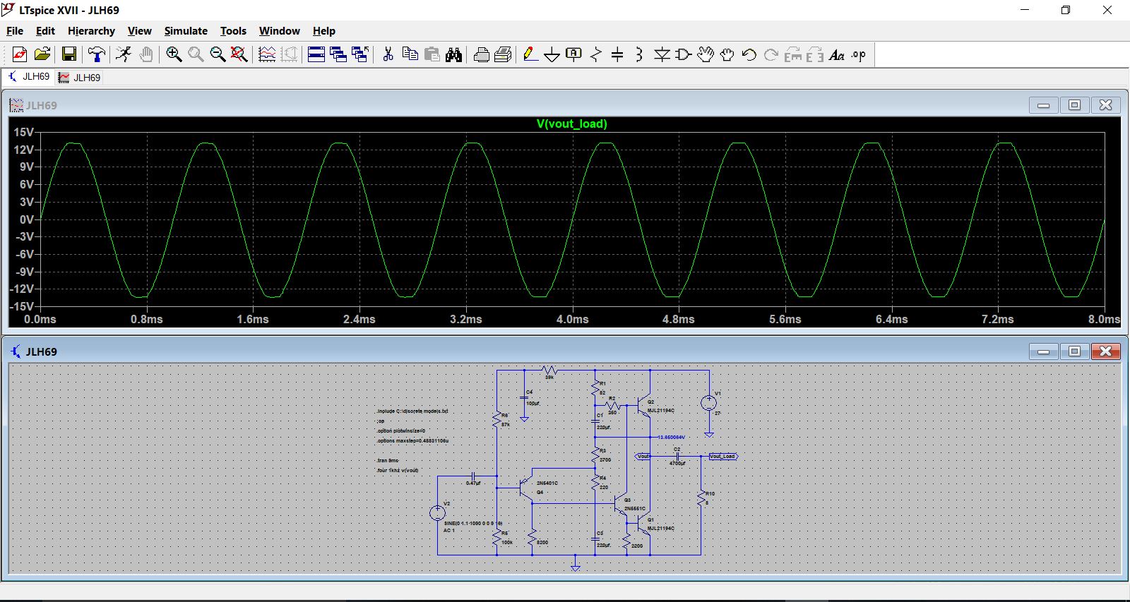

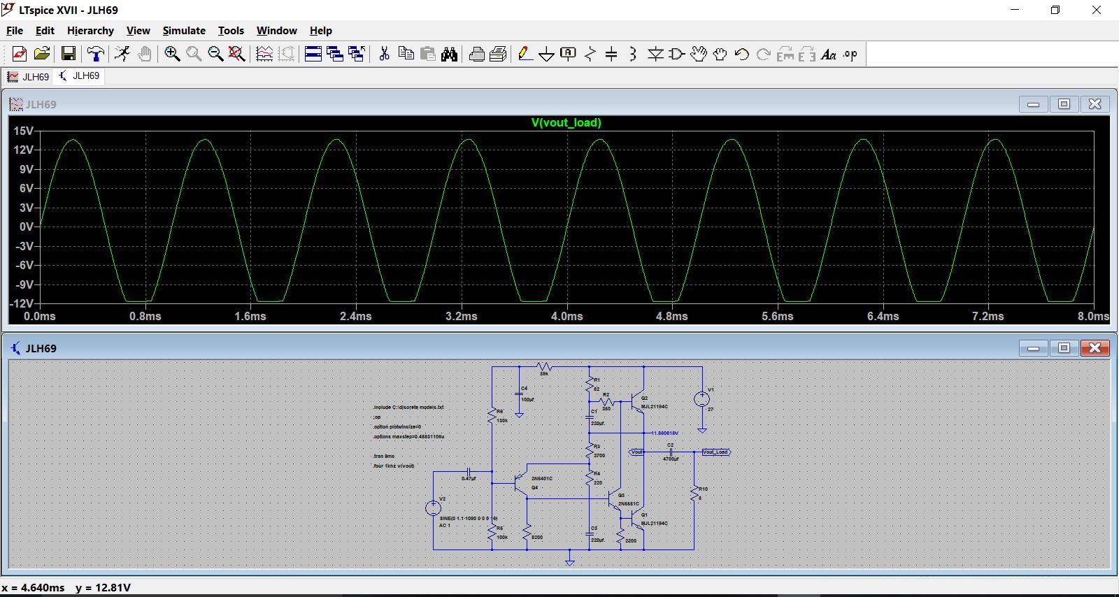

This shows what happens when the midpoint voltage is incorrect (this is on a 27vdc rail). First image is at around 13.5v, second image at 16.5v and third image at 11.5v.
You can see how it affects clipping and consequently the maximum available undistorted output voltage.
