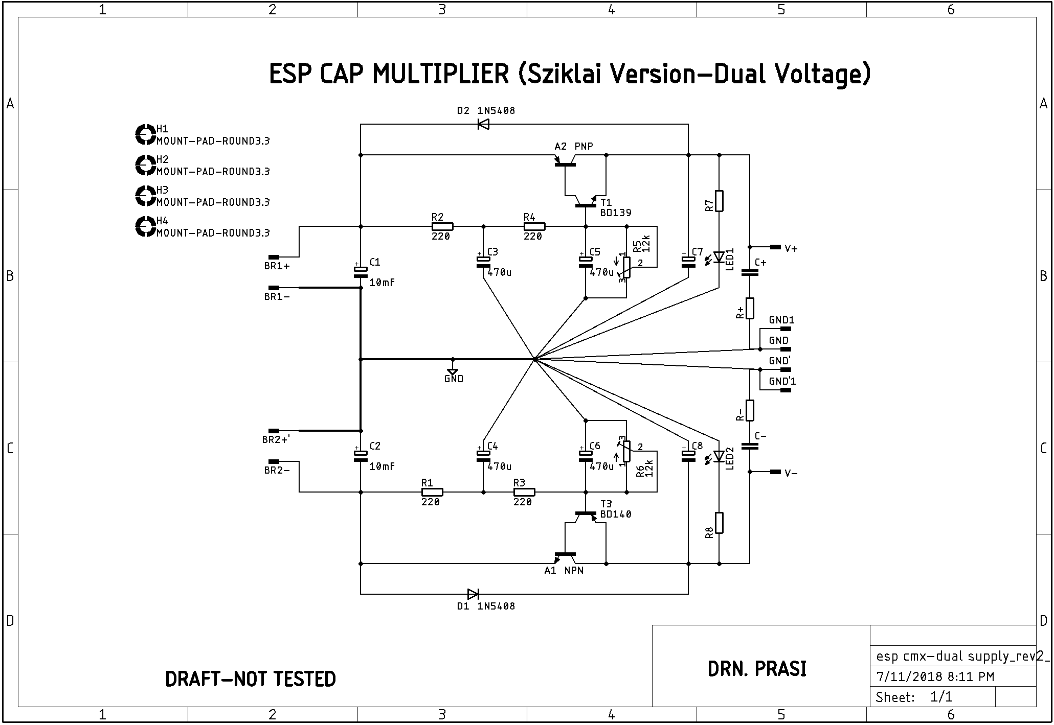

Hello Nigel,
thanks for the info.
I have made an attempt to adapt the Sziklai version of ESP Cap MX for dual voltage for JLH2003. Could you suggest any improvements/ corrections?
Also suggestions regarding components choices. For the big ones, I am thinking about On-semi devices like MJL21194/93.
I have read somewhere / informed by someone (cant really remember which), that Sziklai Cap MX's are prone to oscillations. If so, Is there a way to tame it, so that its stable .

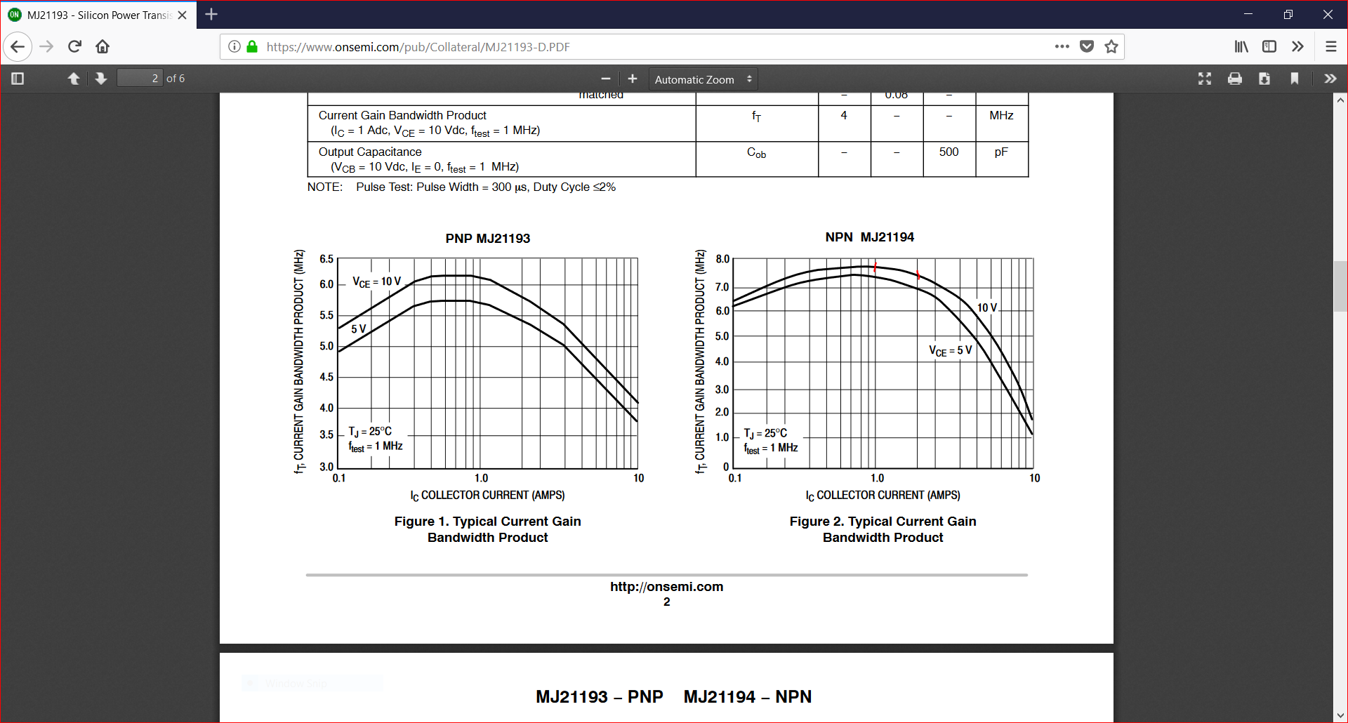

There are no compensation capacitors in this circuit because the dominant pole which ensures stability is the output stage which uses the lowest transition frequency transistors of all those in the circuit. Output ones where the gain decreases to 1 at 2MHz are best suited the need such as 2N3055 and MJ15003.
MJL21194 is a good transistor but unfortunately with a current of 1-2A the transition frequency is in excess of 7 MHz and there is no significant reduction in this performance if the current per transistor is halved by using two sets of output pairs.

You might consider replacing R5 with a zener. I used a fast modern pair of transistors as they cost the same as TIP2955 or 3055. As far as I can see for a class A amplifier even slow devices are fine. The thing to remember is the strange ideas of class AB are not put to the test as the JLH amplifier never switches of. Thus any problems is restricted to the unlikely need for 20 kHz high power music.

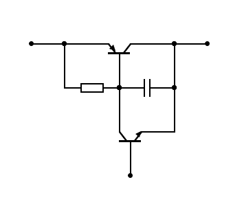

Sziklai in the PSU. I had no problems because it isn't in a complex feedback circuit. You can try a capacitor from base to collector of the input transistor or output or both. If so you have bought yourself a slow transistor. I would more warn you about the LM317. This can use a bolt on PNP to make Sziklai type layout with the internal LM317 NPN. This can allow a massive current upgrade. I have always been able to detect some oscillation as the feedback is more complex as my best guess. LD1084 is a better option.
The two options I would look at is standard Darlington and two single multipliers in cascade. Sziklai offers the lowest loss.

You could do it like this (just the actual cfp shown). The R could be 220R like the rest, should make the npn "on" at all time running a couple mA's. The C should be made to limit the BW to a couple hundred kHz. Or try a 1nF and go lower until the problems start - if there are any to start with.

however I would like to point out that the type of Bjt is MJ21194 in TO3 format, old school Ft = 4Mhz as it was, even more the previous MJ15003 that I consider suitable for thermally demanding engagement as that in class A. But the problem persists and I still have not indications of solutions, maybe over the weekend I will read the bibliography concerning this project ...

I have a liking for TO3 packaging for the purposes of the JLH I regard this as a 7MHz device. If using this is a 'must have' consider fitting a zobel network at the output 8R plus 100n and possibly a 0.22R buffer resistor in series with the speaker load.
