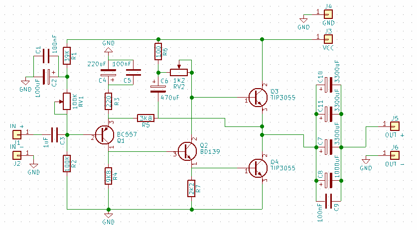

That rca amp is funny. What are trying to accomplish with these diodes in output?
Thermal tracking of the bias current in a circuit like this is not very good and bias current has a huge effect on THD below 1W. Note there is no adjustment of idle current and it will drift with changes in mains Voltage. The 1 Ohm resistors R13, R14 help minimize the change. The diodes reduce the losses when the amp is delivering power and R13 and R14's power requirement.

hello Cerniu,
I would suggest you to join all all i/p side and NFB grounds together (by a plane) then run track to the star. I would also suggest you to keep an option of lifting this ground with a 10ohm resistor, that can be shorted by a jumper if resistor is not required/desired.

edit:also 100nf bypass cap on the o/p is doing any useful job? i would use at least a 2.2u or parallel 2-3 such caps to get it to pass audio.

The guy I quoted from post 4839 didn't understand the reason for the diodes, that's why he ask the question. There are many here that do not have the experience or education that some of us take for granted. Tech schools today don't spend much time on analog circuits. When members such as the one I quoted ask questions, they deserve a polite, concise answer and not to be made to feel like they are being talked down to.
That design was never intended for class A operation, just look at the rating of the transformer. And in case you can't find a listing on the output transistors, they are TO-66, Vceo=35V, Pt=29W. I think it was mentioned earlier that the design was from 1959 (post 4838). It looks more like mid to late 60's to me. In those days you would have been lucky to find 1 Ohm 1 Watt resistors in stock anywhere. Those 5W or 10W wire wound square ceramic resistors were not available. Special order at best if the manufacturer would even talk to you. Hard for a DIYer to do much with solid state in those days. (Note the JLH doesn't use low value emitter resistors.) I remember in 1969 it was still hard to find anything to use as emitter resistors. Allied Radio and Lafayette had nothing in their catalogs except these wire wound axials that looked like carbon comps and were rated at 2W. Best you could do was run two or three in parallel.

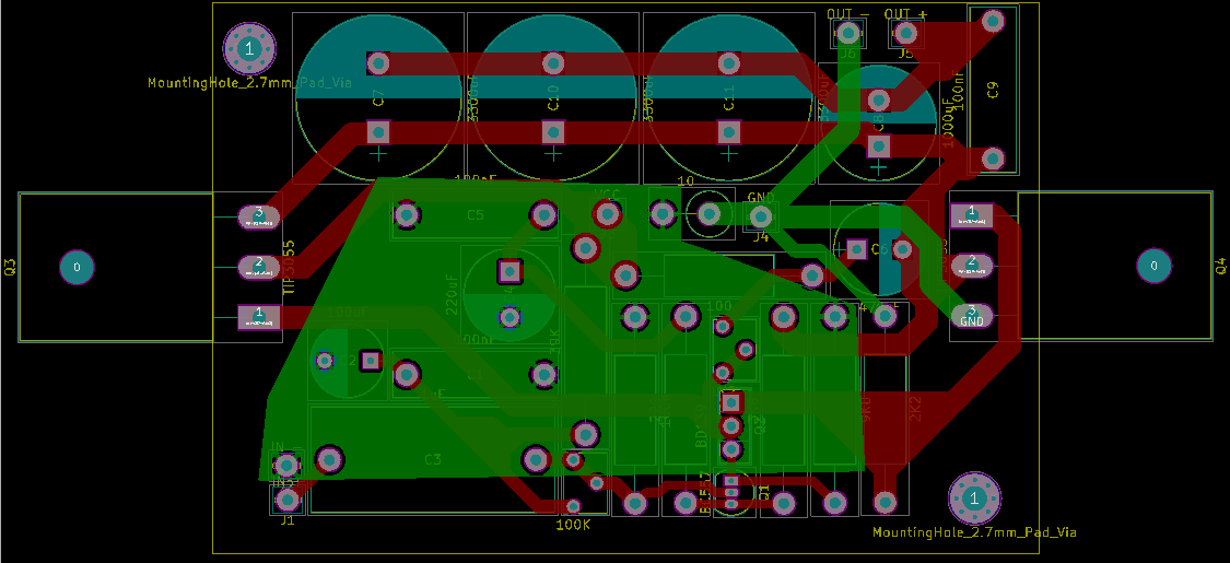

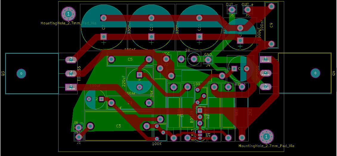

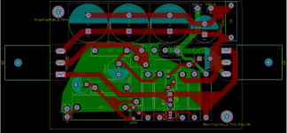

Not sure if I done it correctly but I modified version1 (both pictures are of the same pcb, but with emphasis on different pcb layers for better visibility) of the pcb acording to your suggestions. Could you elaborate what such a plane improves and what are the benefits of that 10ohm resistor.
As for the small cap on the output, I have moved it slightly so a bigger cap could be put there (though not MKP, atleast not any I have found).

Trace the signal side ground from IN-, R2, C2 , NFB-C4, etc. I also used an optional resistor to lift this ground from Power ground (IGND-PGND).
The ground lift resistor is as per https://www.updatemydynaco.com/documents/GroundingProblemsRev1p4.pdf
and is generally accompanied by two antiparallel diodes. See the initial layout of honey badger posted by ostripper😎

Thank you. So I have done the signal ground plane right?

Layout:
What is meant was
1. keep all the signal traces short
2. connect their grounds with a common plane
3. This area (area covered by signal traces and their grounds) should be as compact as possible. Although it is not always possible due to mechanical constraints of PCB mounting and general chassis layout, etc.
4. run a trace from this ground to PGND with an optional lift resistor
However there are different views and best is to build one and test.
