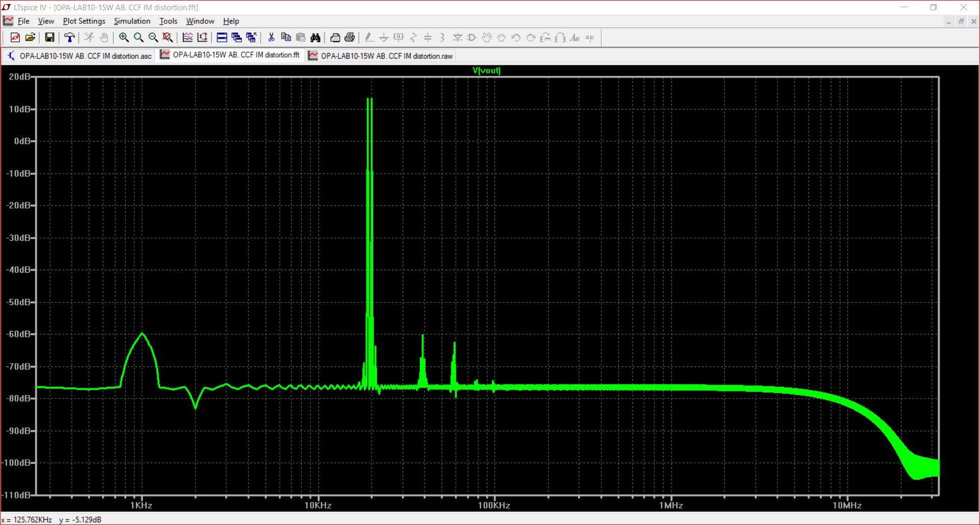

The MC33078 op.amp a favourite of Nigel's uses an all NPN output stage to to avoid the dead band at crossover. This has been a fairly common strategy with op.amps for a couple of decades now.
To date I have not seen this used in a power amplifier which is presented with much lower impedance loads presented by amplifier inputs or headphones. There is still a limit on output current but it is possible to extract a little more than it needs for Class A running.
In this example I have kept the singleton input, a single supply rail and the split phase drive - I had no luck with making a stable version using a bootstrap collector load and had to use a Constant Current arrangement.
The aim is for 15W into 8R where the power consumption is about half that of my 1996 circuit. The circuit can be adapted for lower power.

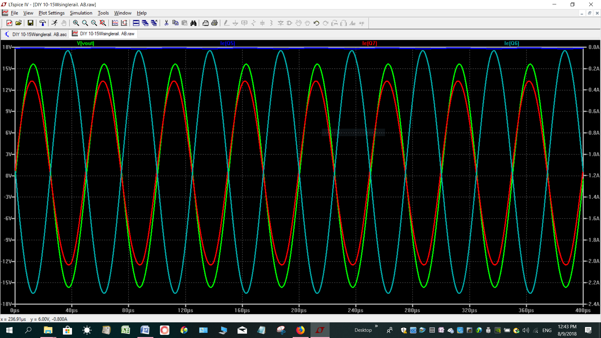

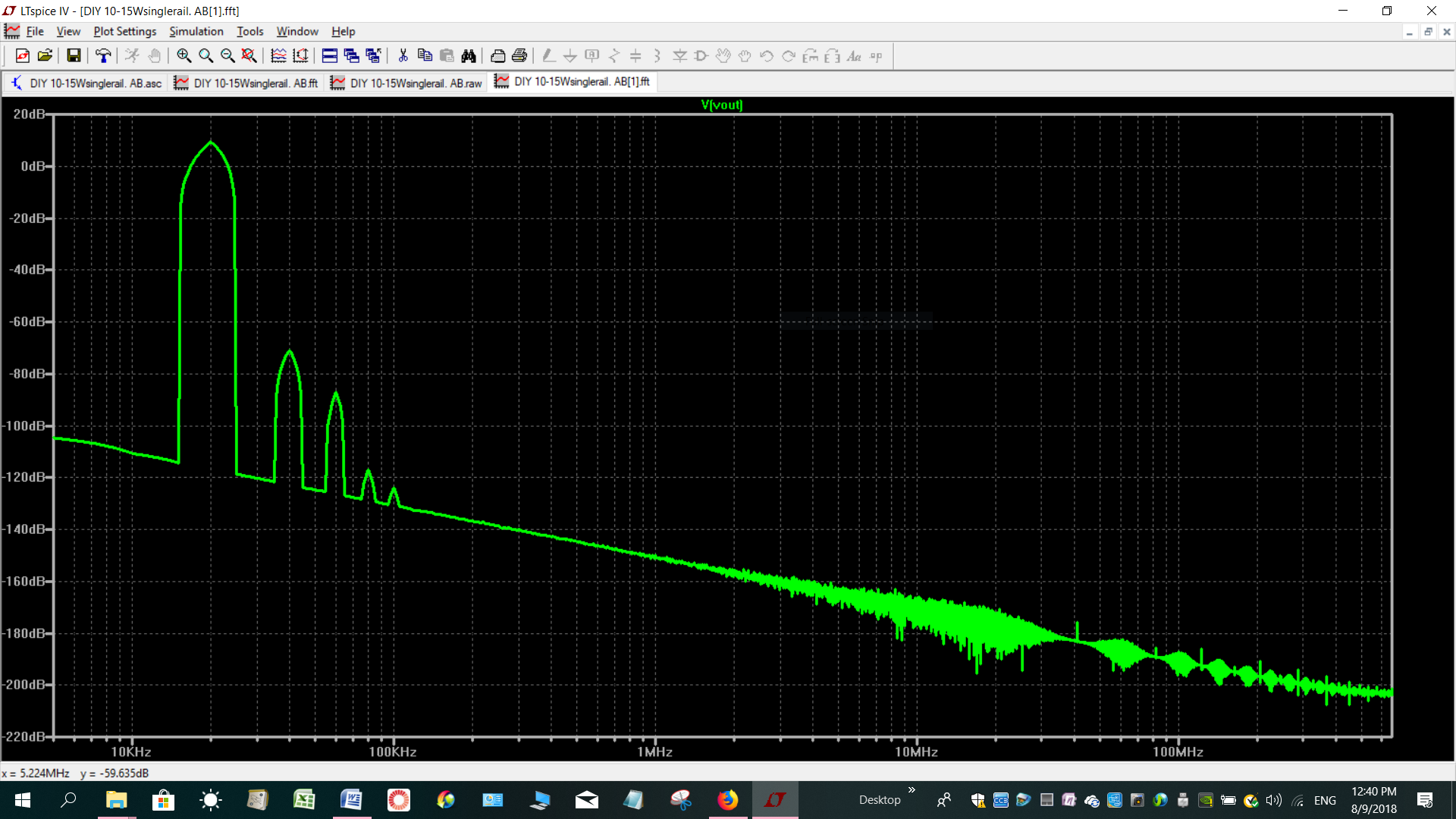

The attached images show FFT's at 1 Watt RMS output at 1kHz and 20 kHz and a display of peak currents at 15W - Q6 and Q7 are the NPN outputs and Q5 the supplementary driver.
If there is sufficient interest I will post the full circuit.

"In this example I have kept the singleton input, a single supply rail and the split phase drive - I had no luck with making a stable version using a bootstrap collector load and had to use a Constant Current arrangement.
If there is sufficient interest I will post the full circuit."
Please !

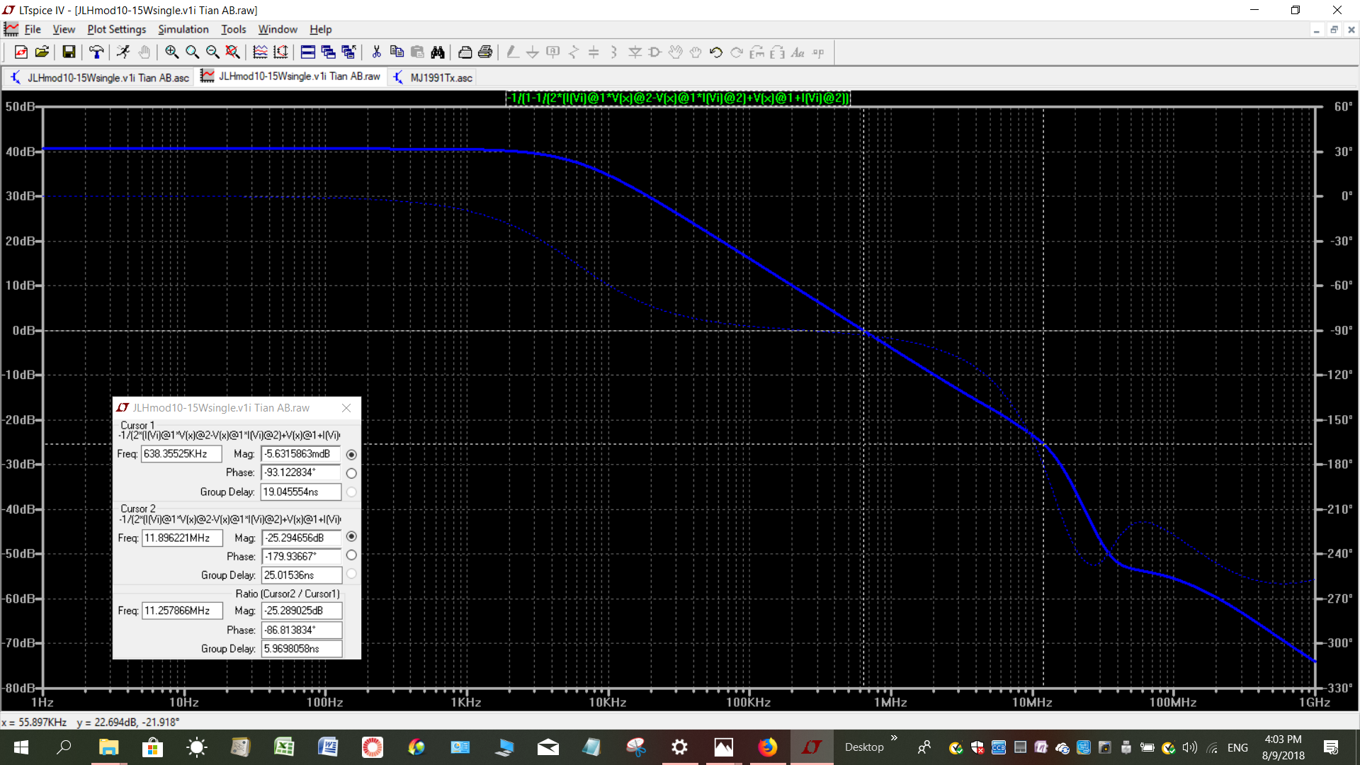

Soon - meantime some more simulation images.
For comparisons with 10W JLH Class A the CCF IM plot is at this power output level. The stability margin is at close enough to 15 W both results into 8R.

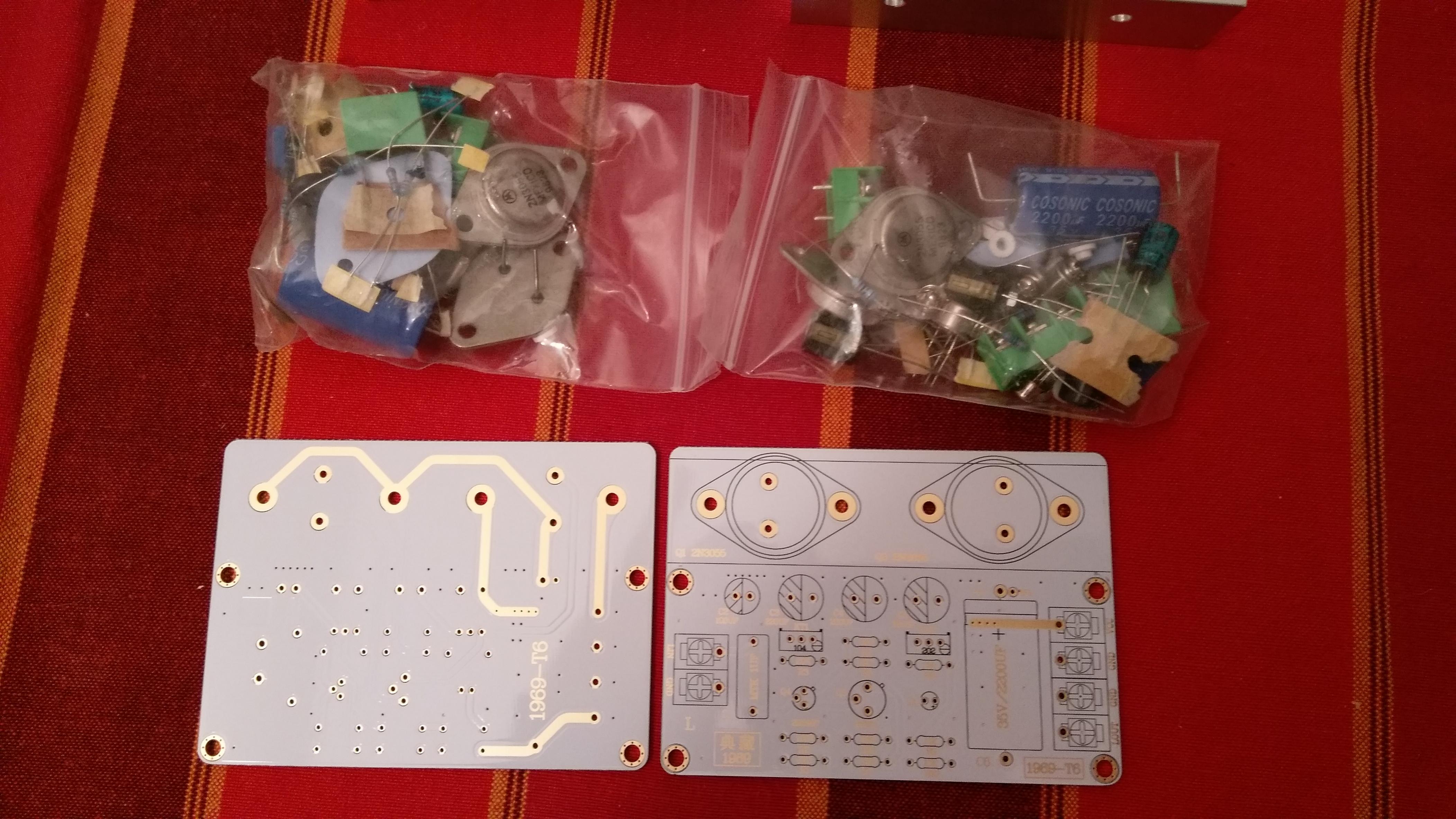

I have bought such a kit. Wanted to try it just out of curiositty. But, due to family issues I don't have the time now to build anything. But, one day I'll do it 🙂
it's not quite the same, this one has bias potentiometers and voltage balancing.
mine (actually the simplest and cheapest) works with resistances that must be changed to adjust.
I have yours too and I still have it, it serves me the aboratory to try
to3 power transistor that I collect for years
