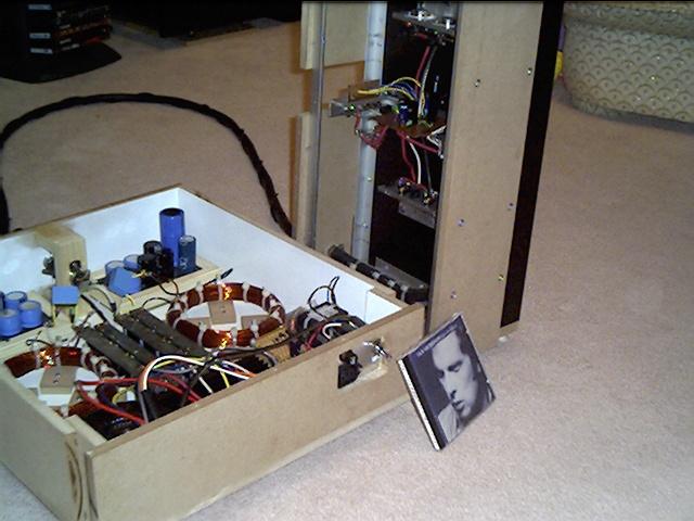

The reason I had to use blow torch was that I did not know thick copper bus bars do not go well with snap in type capacitors. I learn it the hard way. I already bought, cut, drill and tinned all eight copper bars before I realised my 35W, 40W and 80W solder irons did absolutely nothing except cold solder joint for sure. Being stubborn I went and bought the blow torch, heat up the copper bars, pre load the holes with solder and place it on the caps pins, but with five caps in a row, when one pin goes in the other ones already cool and harden and prevent it to line up all 5 pins with 5 holes the same time. Like I posted in another thread before, I skinned the caps amoung other things, not on purpose to try different sonic results 🙂
And waving a blow torch flame inside the PSU box had a lot of accident because you can not really see the true end of the flame!
Never use thick copper bar unless the caps are srew-in types!!(For Newbies like me)

Remote PSU Pic
Left Channel

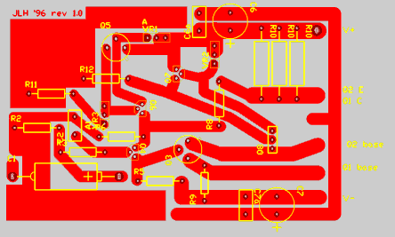

PCB layout
He Calebay,
Obviously something went wrong when you tried to upload your file. Anyway, I have completed my layout for this amp. Look at one of my previous posts for the schematic I used. The PCB are already made and they will be tested in the next couple of weeks. I will post the results when I've got them.
For now, here is the layout I made.
Ps1: I haven't really checked the correct pins for the transistors. So I will post a rev 1.1
Ps2: Have a look at the Hiraga articles for grounding and layout tips.
Ps3: If you would like to upload an image, you will to use the browse button at the bottom of the screen to select and upload your picture to the remote server.
If anyone has any comments about my design, which I can incorporate in rev 1.2 design, feel free to post them.
They traces appear to be very close to each other indeed. The PCB I made is actually 10% bigger, so it doesn't seem to be a big problem. I will make the distance bigger for a next version, thanx for the point.
I used circuitmaker and traxmaker for the design. Because of my lack of experience, I like to simulate every circuit that looks interesting. Circuitmaker has proven to be a very easy and clear program to do the job for me.
Would you be willing to share your artwork? Well, I know you already have, but a version without the silkscreen that I could use directly for making my own PCB? I have all the parts for this amp but haven't built it yet. I was going to do it on Veroboard, but a PCB would be nice.
Paulb,
You can find the Traxmaker files here.
Note: This is not a tested PCB and I am not a experienced PCB designer (actually this is my first ever ); ) so use this at your own risk.
I would be interested in any changes that are made on these PCB, so feel free to email the traxmaker files to me.
The PCB will be tested soon and I will post the results, so you may want to wait for that.
