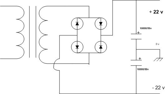

renjiish said:can i use the schematic like this for dividing the value of the voltage.please give the valuable information
sorry - you need a centre tap on the secondary of the transformer to make the earth held solidly halfway between the rails.
mike

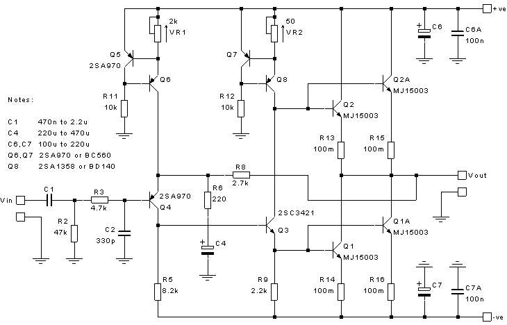

mikelm said:
Hi chris,
I think because this amp has no compensation it is very easy to end up with some very high frequency oscillation which I would guess is what is happening.
Although there may be other methods of curing this ,in circumstances like this a small cap across the i/p can often make the difference between oscillation or no oscillation.
The lead that you plug in is providing that capacitance. If you put a cap of about 20pF across the i/p it might cure the problem. If not you could try slightly higher values, polystyrene would be best I guess.
hope this helps
mike

Hi chris.
yep I that should do OK or some where nearer to the i/p tranny.
I was just looking back at the pic that you posted on page 22. Is this the amp that we are talking about ?
If so I remember that in one of the early articles JLH says that having separated o/p and return leads of about 6" from the amp before introducing any capacitance ( for instance by using regular twin speaker cable ) may be necessary to achieve stability.
It might be that your leads are a bit shorter than this and therefore may be contributing to the problem - just a thought.

also I just noticed that your i/p & o/p leads are running paralell to each other quite close. This could also contribute to the phenomina by o/p currents inducing signals into the i/p leads. best to have i/p & o/p either in different places, or at 90 degrees to each other. mind you if the i/p leads are screened it should be OK.

2x22volt rail whit 2x18v trafo?
Hello
i have 2 trafos. 2x18 volt, 250VA
will i be able to get 2 x 22volt rails using the updated power supply. and how much voltage drop will i get over LM338K
tnx.

nope 2 x 22 volt rail was not posible whit 2x 18 volt trafo, tested it last night.
what voltage will be optimal for me to those on a trafo if i want
2 x 22 volt rail whit the regulated power supply.
and how do i calculate the unregulated voltage volt from a trafo after diode bridge and caps?
Tnx

Calebay, the voltage after diode bridge and caps is app. ((Vtransformer * 1,41) - 1,4V). The optimum voltage for 2*22 V would be 20V, since this provides the lowest voltage drop across the regulator. The power dissipated is your LM338 is the diffrence between the input and the output multiplied by the current you are drawing (i.e. if you have a 20V transformer, you'll get ~26,8 V after bridge and caps. If you've set your output voltage to 22V and you quiescent current to 2A, each regulator will dissipate ((26,8-22)*2) = 9,6W!!)
One option could be to lower the rail voltage to 20-21 Volts, Then you'll be able to use the 18V trafos without problems. Which JLH-version will you be building?

tnx for the info.
but i dont understand 100% if i calculate ((18v*1,41)-1,4) i get 24volt but yesterday when i mesured it under load i got 22volt, after bridge and cap.

The voltage drops when you load the supply. 22V from an 18V transformer sounds a little low, though. The output voltage is usually specified at full load. How big were the load? What does the transformer measure without the bridge and caps?

the load was 4x 12v 20w spotlights in serie. 60watt i think
i didnt mesure the voltage from the trafo whitout bridge and caps. and the test setup is all desoldered now.
gues i just keep my trafos and run 2 x 20 volt tnx alot for the help.

MJ21194
I have just finished with the amps today. Except I have to lift the ground on one amp, no other noise I can hear. No ocillation I hope since I have no scope to check it. Dead quiet.
CLC- PSU, cheapie surplus caps, 8 x MUR860, 400VA 22-0-22
All BC559, BD139, BD140, 4 x MJ21194 not matched, 4 x ohmite 25W 0R1 power resistors
C1 is 5 x 100n, yet to find a replacement.
Bias set at 150mV across R13, DC offset 1mV
